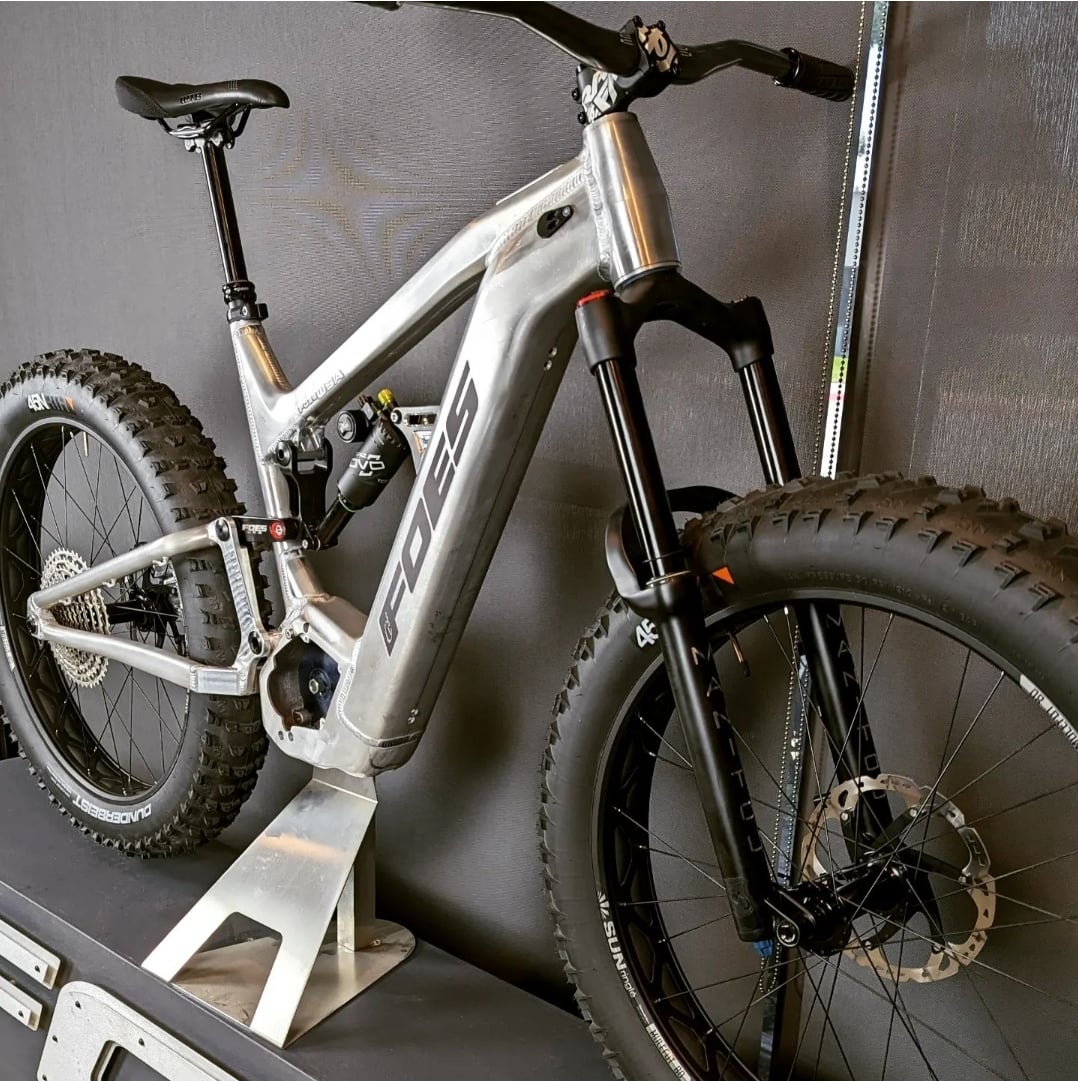

Pre production shot of the Foes.

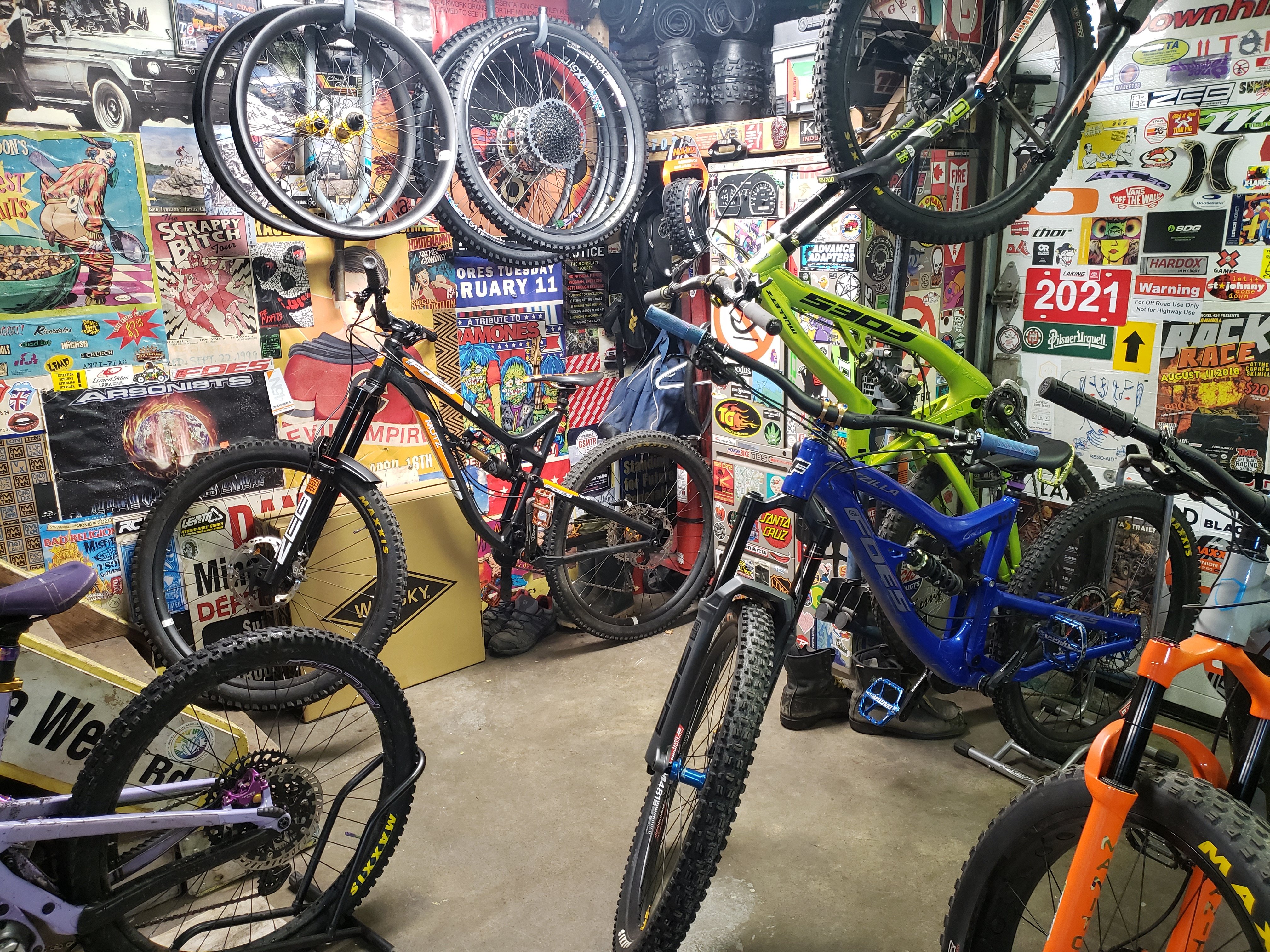

Front/full suspension will all depend on where and how you ride. If you're doing groomed stuff all the time and your trails aren't rough then you absolutely don't need fs. I for one would always opt for a front suspension fork on any bike but if your trails are smooth then thats not really needed either.
Our group rides groomed trails less frequently, we ride the same rough, rocky and technical trails we ride in the summer. The rough trails eventually get smoother the more the snow gets packed but there's always still drops and jumps and suspension just makes that funner. The suspended bikes also deal with the, not enough snow or melting snow, in-between times better than a rigid fattie and we really have no off season because of this.
The preferred frame is the 150mm travel Foes Mutz. You can fit 4.8s on it with the right rims but it has 177 rear spacing so the q isn't as crazy as a 197 spaced frame. In the winter we run 150mm mastadons but the in the summer we all swap to skinny wheels and 180mm travel rock shox or dvo forks. I know youre still compromising a little when compared to a dedicated skinny bike but these things rip in both configurations and are the ultimate quiver killer if you want only one bike. I'd consider a Lenz fattilac right up there as well but I'm not sure if he makes an e version..
If the Foes is out of op's price range, in my opinion, the Bigfoot vlt or Rocky are the only real options. I don't know much about the rm motor but I haven't heard too much complaining. The shimano on the new bigfoot still clunks a bit but the more you ride it the more you don't notice it. I don't know if its a different tune or just the fact that the norco is a hardtail but it seems more powerful and quicker than the ep8 on my sc bullit with similar km... I rode the bigfoot on the same trails as I ride the bullit in the summer and besides missing the rear suspension on rougher sections and being 10lb heavier the thing absolutely ripped.. drops, jumps and all. I did throw a 3" dhf on a skinnyfat wheel up front but with a full skinny setup it would be even better for summer..... if you can tolerate a hardtail.
Anyways, my advice is to be honest with yourself about where and how hard you ride. Thats the starting point. Second, stick to known brands be they boutique or mass produced because you will ultimately regret getting some no name abortion.

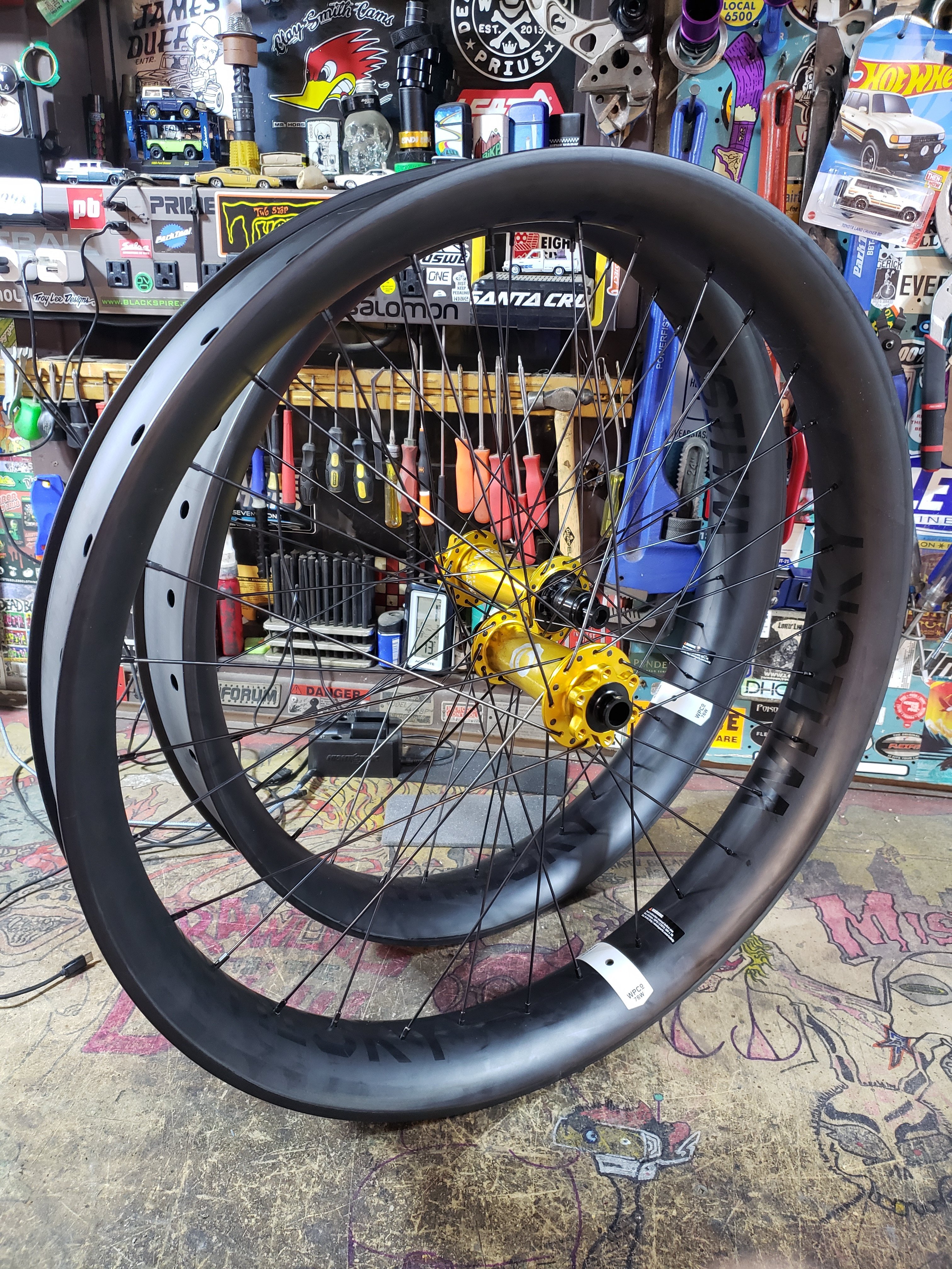

A picture of a quiver of Foes Mutzeses in skinny mode and the new Whisky/i9 fat wheels for the bigfoot vlt for good measure.

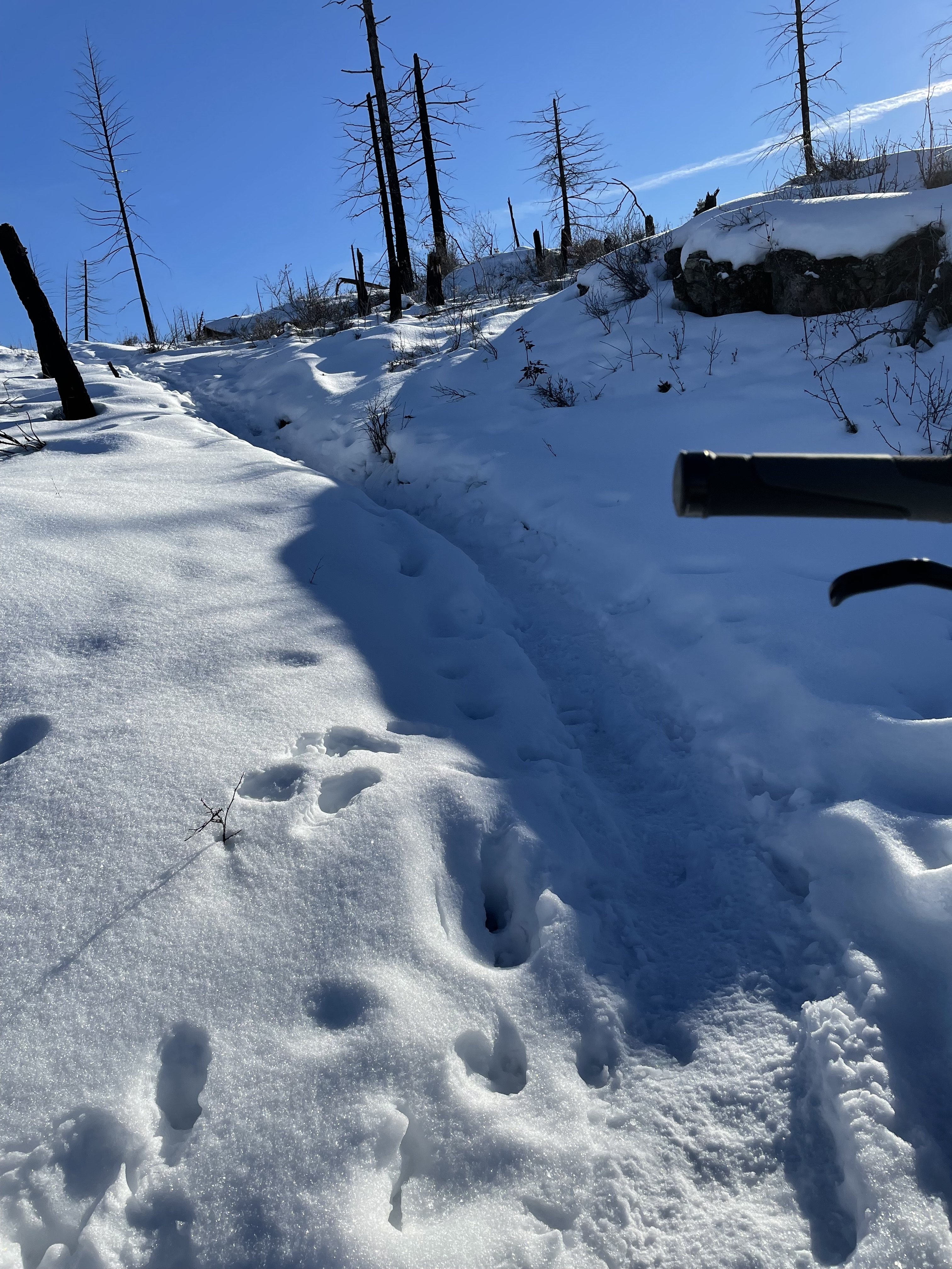

Darwink1 great advice I will continue to dig deeper into your post. Here in BC The only groomed trails you will find is on ski hills. I too ride the same parks/ mts year round either coming up or going down. Unfortunately, for some crazy reason whenever I reach a Ridgeline, I’m always looking for the next highest.
A typical ride out here luckily the trail is broke kinda … cheers

Well I have found my Perfect bike except one thing, it's not a class 3 ☹️
I need/want a higher powered fatty than this but try to find a alloy one. Seriously there doesn't seem to be any top end class 3 fattys, everything I have looked at is pretty much carbon fibre made in China and are boats made for getting groceries. If anyone out there knows of a fully suspended class 3 alloy fat ebike that isn't just a rebranded dud please share !!! 🙏
