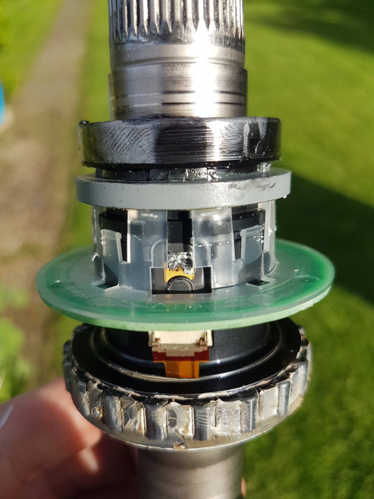

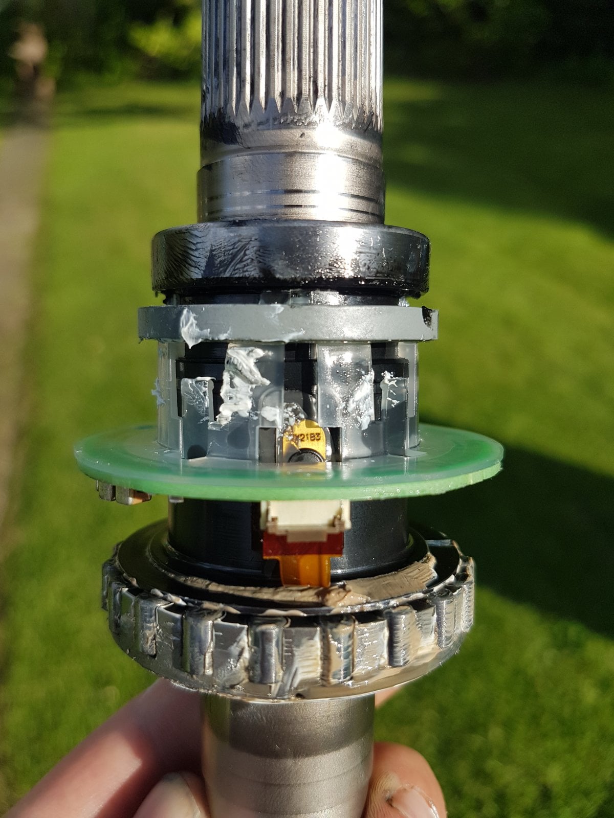

Took my motor apart to solve this issue today. Intermittent e10/ occasional w013.
Seems to be corrosion on the torque sensor connection. Must be a manufacturing issue, both sides are similar.
The rest of the motor is spot on, no abnormal wear or water ingress. bit of a shame really, 4 months out of warranty!
