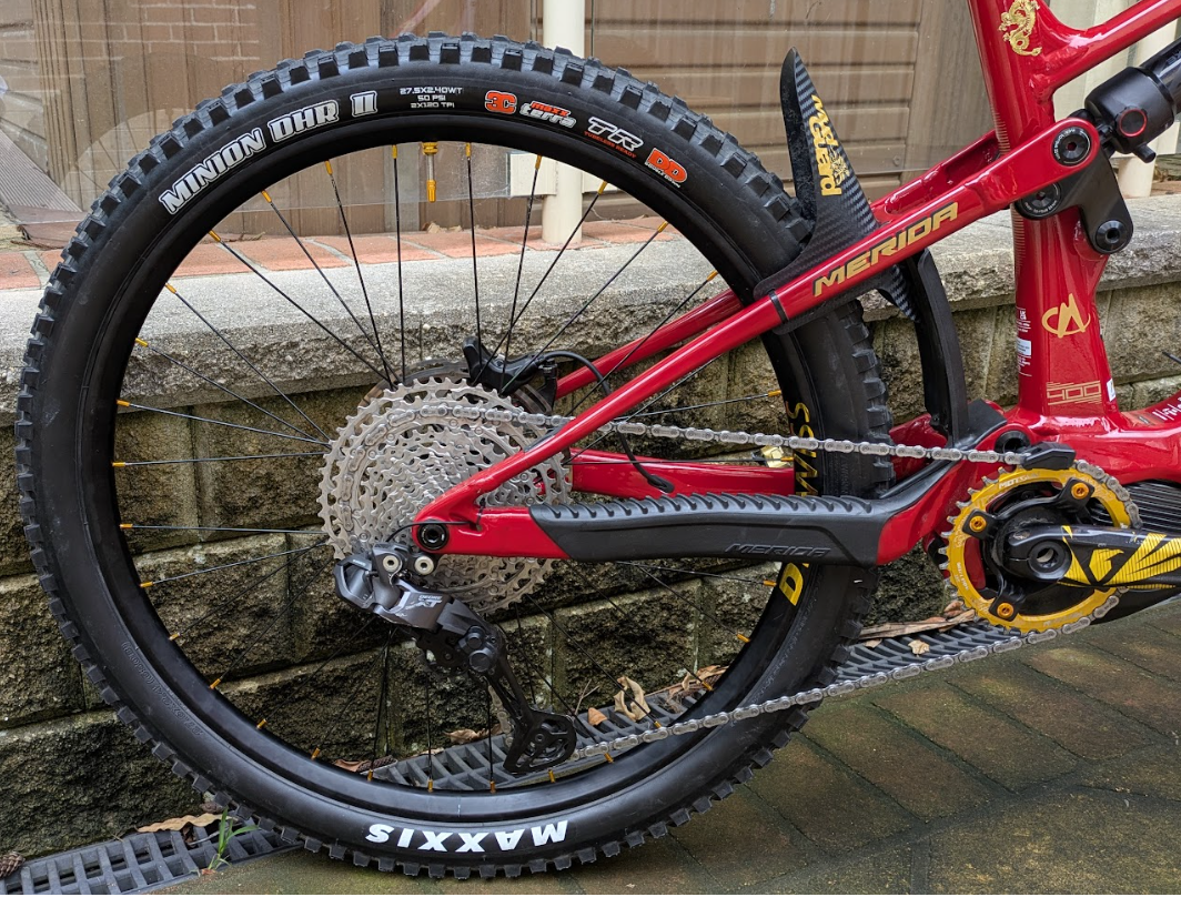

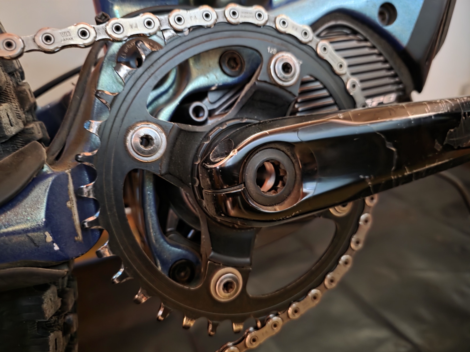

Is there any way to add a BB spacer behind the SM-CRE80-12-B 53mm chainring to fit 38T?
I added some spacers behind & in the front between the spider and the chainring, and managed to get 36T to fit instead of the stock 34T.
SM-CRE80-12-SB would have 56.5mm chainline but there's no 38T option. Any other options?
The gap of the chainring to the chain stay, at any chainline distance, is fixed. So the only way to to add larger chainrings is to shift the chainline outward. Then the bevelled chain stay end creates more gap.
This comes with cross chaining repercussions, that effect shift quality, chain retention and transmission life.

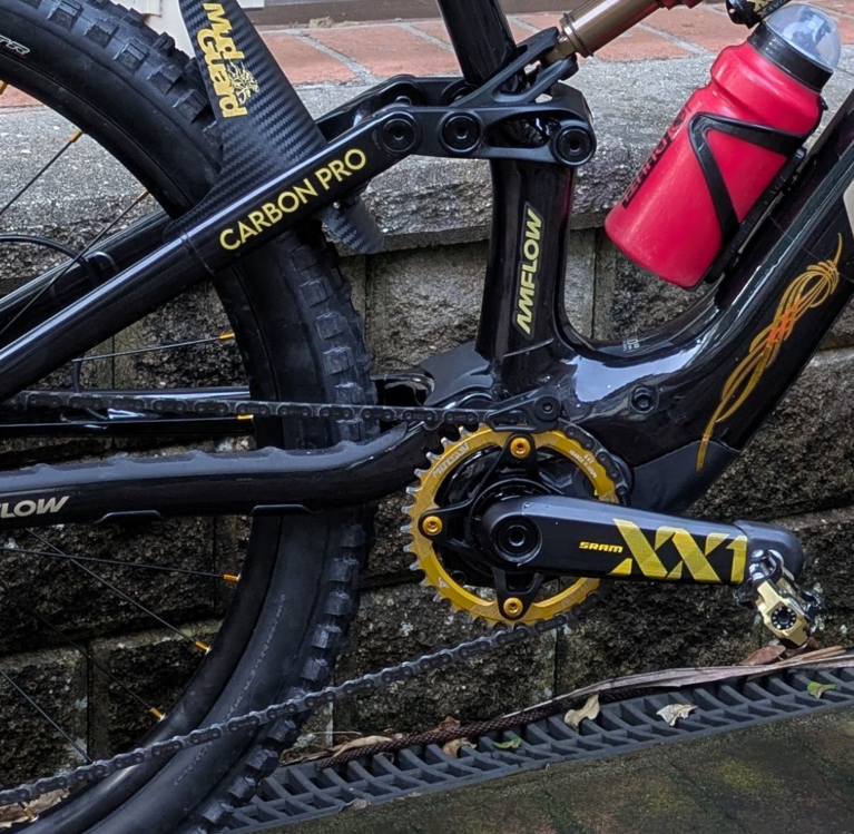

There are definitely 104BCD 38T chainrings available on Aliexpress. I have used the 34T and 32T. They have been hardwearing.
My Marin Alpine Trail E2 came with a 38 as stock, when it wears out its gone I'm going down a size I think
Sizing down is more the usual, as with EMTB riding, you normally want more torque, rather than more speed, especially if speed restricted.
That said. On my Amflow I replaced the chainring with the Aliexpress chainring of the same size. Torque is not an issue on the Amflow ...... :ROFLMAO:
BTW. The Aliexpress Chainring is performing nicely on the Amflow, even with the ridiculous power and torque the DJI motor produces.
