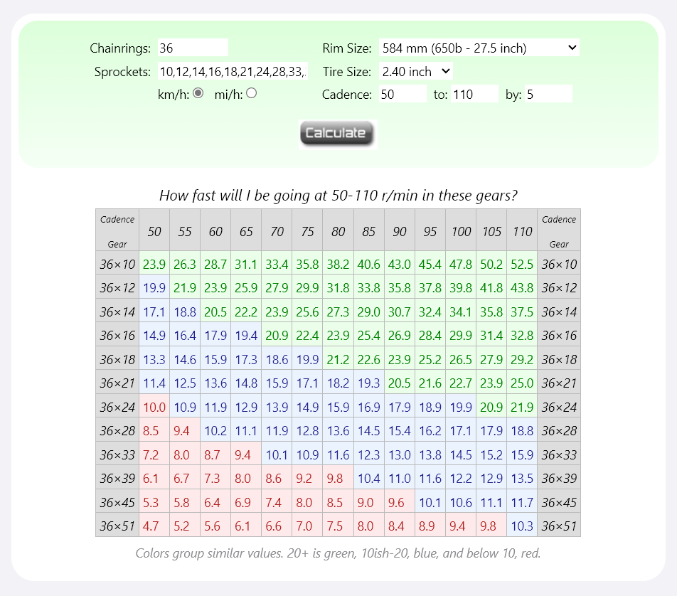

Just to add some calculations:
My EP801 driven bike has the following parameters:
wheel circumference: 2300mm (29")
smallest rear sprocket: 10 teeth
chainring size: 34 teeth
This configuration will result in a cadence of 85rpm when going 40kph, which is easily manageable with the 600W max. peak power and max. 85Nm of the EP801.
The calculation for this is quite easy: 40.000m / 2,3m / 60 / 3,4.
Unfortunately the bike frame is limiting me to use a larger chainring size.

So what cadence would you say you need to hit to do 31mph/50kmh on 27.5 wheels and a 38t chainring?
It´s not a question of what I´m saying - it´s just a simple calculation.
However, there are some parameters missing for the proper calculation:
- missing size of the smallest rear sprocket (which for sure will and shoud be used in this case)
- real size (wheel circumference) of the 27,5" wheel => A 27,5" wheel can easily have a wheel circumference of less than 2150mm or more than 2300mm, depending on air pressure, type of tire and curent state of tyre.
So, let´s assume you are also using a smallest sprocket with 10 teeth and your real wheel circumference is 2200mm, so then the calculation for your cadence is: 50.000m / 2,2m / 60 / 3,8 => exactly 100rpm, which is quite a lot but 50kph is quite a lot too. :D

@Backflip is correct.
If your cranks turn att the same speed as your chainring the calculation for speed and cadence is easy, and his calculation checks out.
If you are doing 110 cadence at 18mph on 29" wheels you should be at around 36T front x 22T rear.
For the calculations to be exakt you need to know size of both rear cog and chainring as well as the exact tire circumference. Tire circumference do vary for same size wheels depending on what tire, rim width, air pressure, your weight, temperature etc...
There are plenty of online calculators that will land you close enough and make it easy for you to do the calculations.

I find this calculator fast and easy to generate a table for speed/cadence for all gears.
This is for my bike and seems correct:
