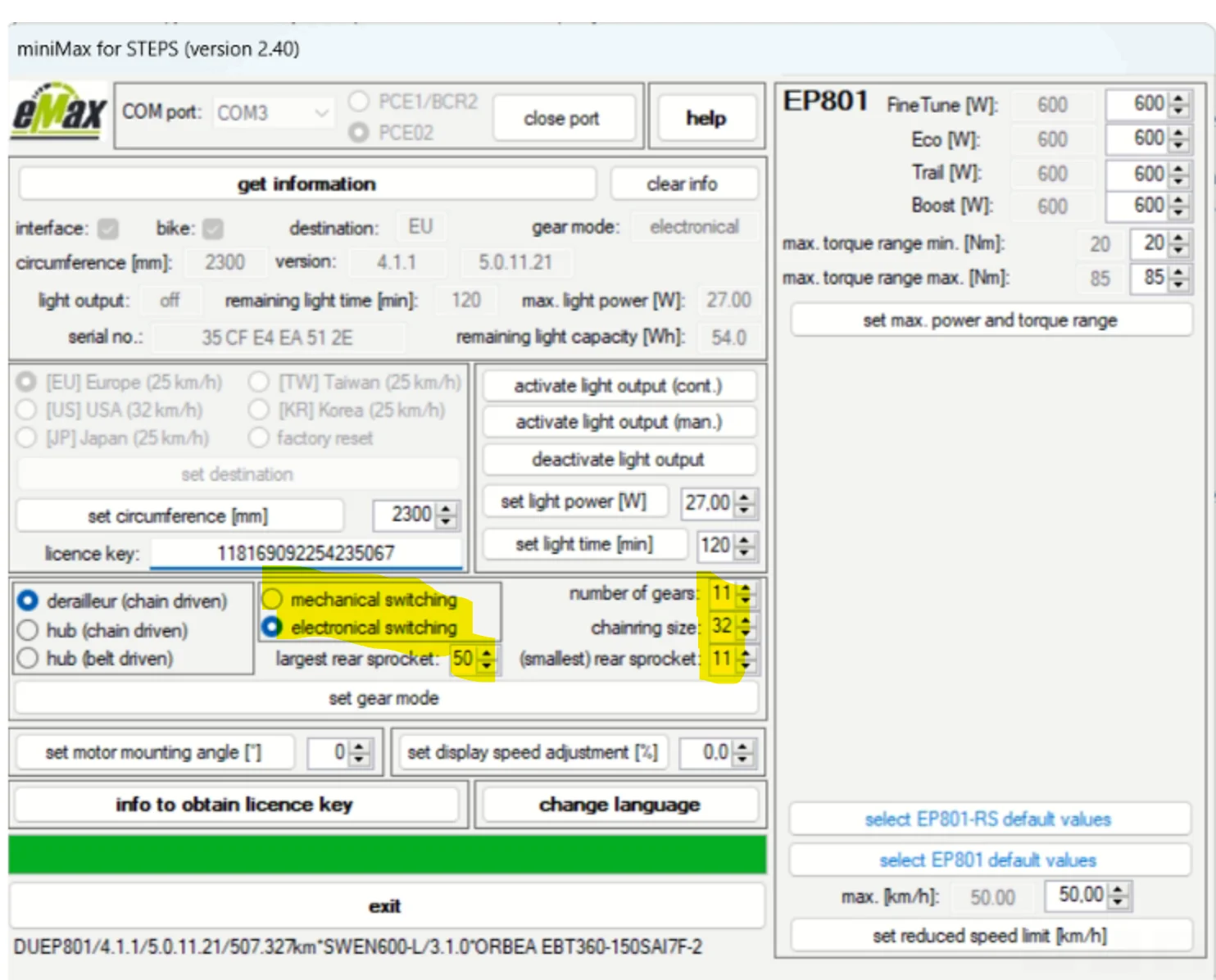

As long as your SCOR 4060 with DU-EP801 uses a real "generation 2" battery (compare page 10 with 11 in this document and check the E-Tube-Project software from Shimano for this), you can use a cable-bound SM-PCE02 interface and the Windows based miniMax - program from eMax-Tuning already in the licence key free (and so free of charge) version to program the correct Di2 derailleur and so avoid the E903. See also chapter 12.2 of this document.
Maybe also this forum post could be helpful.
In summary.
Just get the Minimax software. It's free. Once connected, with in the software is a "Mechanical" or "Electronic" derailleur selection.
Just select electronic. This will clear the 903 error.
In summary.
