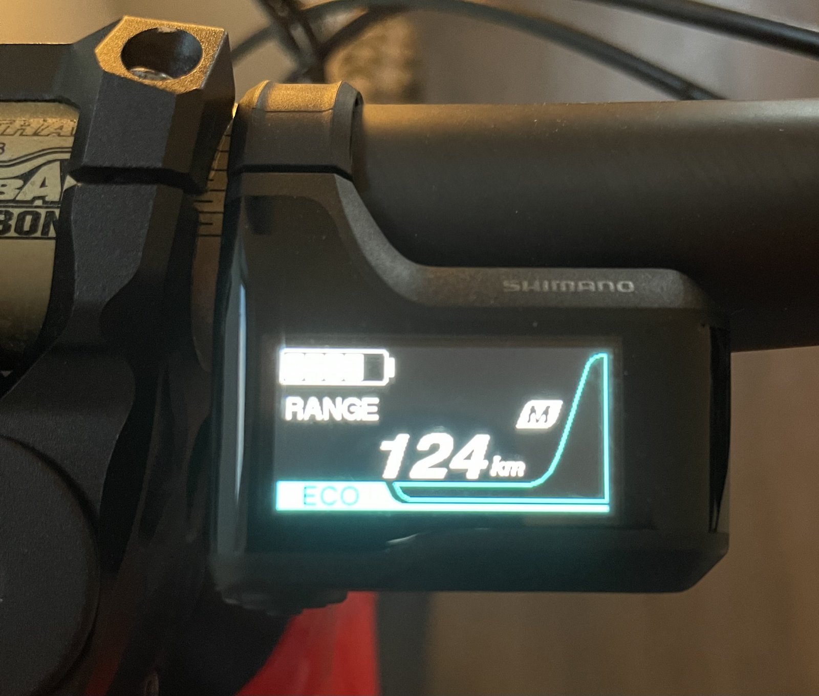

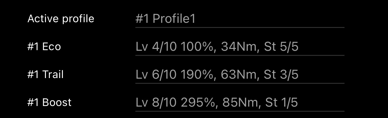

To me all these numbers mean nothing. Test it, will it do that number? Please report if it is accurate or not. When you talk range please mention your weight.
Fair point, my weight is just under 80kg. Also the indicative range is sensitive to effort given, assistance settings and terrain.
My settings are as below… my theoretical range is 170km on #1 Eco and I have done about 120km, but never tested from full to flat.
The other day I have done 40km hard riding on #1 Trail and when I got home I had 35% left, so I should be able to do 60km.
I hardly ever use #1 Boost, so I don’t have an opinion on that setting.
