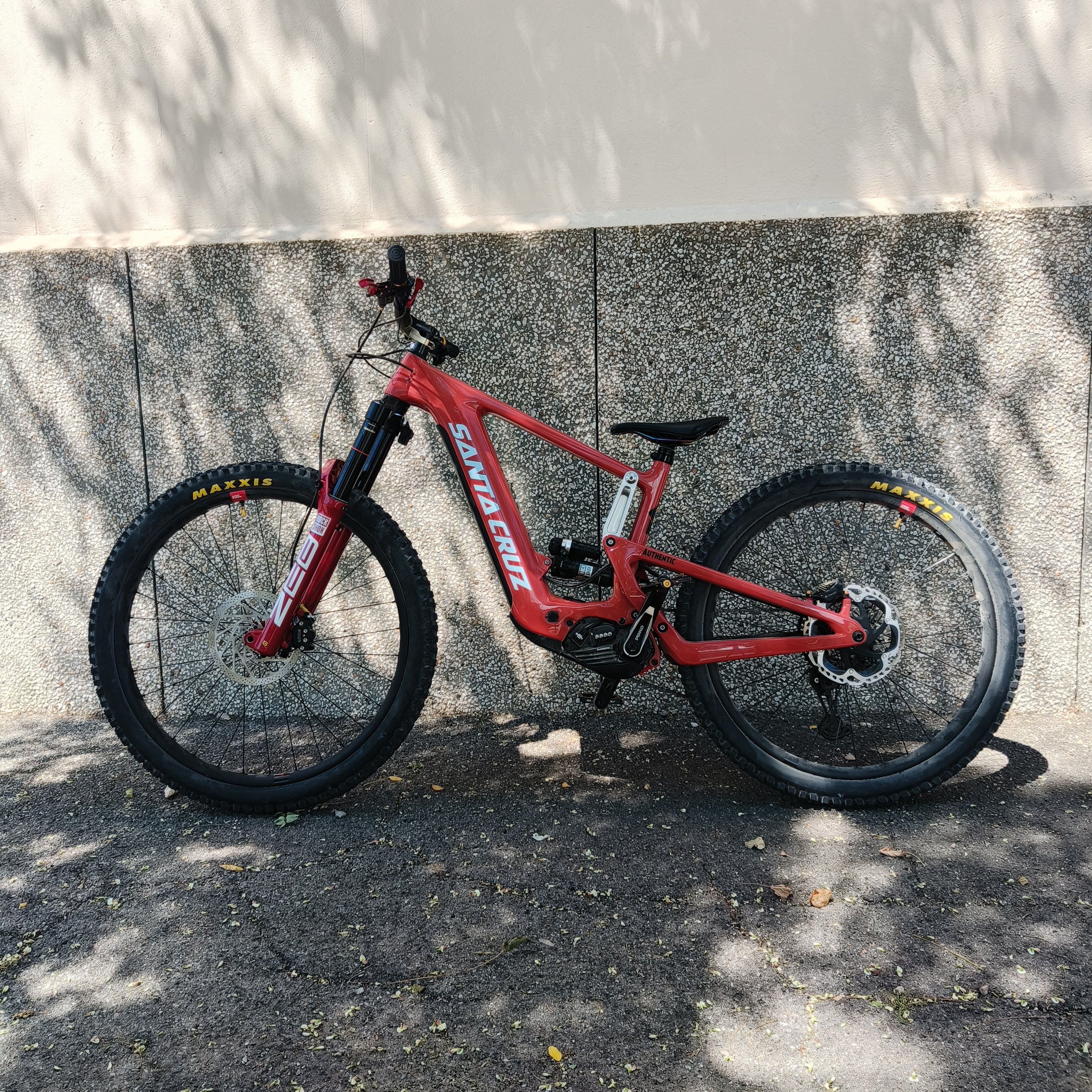

Hi all , I have a 2022 Santa Cruz bullit with Shimano ep8 motor, the motor died so I have replaced it with new Shimano ep8 motor. I also have the emax mini tuning app and in the settings where you can change country etc there is an option for motor angle. Was wondering if if anyone had same bike and was able to help me out with the angle number, many thanks

The mounting angle is not relevant to the normal riding functionality of the bike at all, but only for the "walk assist mode" (pushing the bike, e.g. going uphill next to the bike).
So, the programmed value for the mouting angle normally does not matter really.
However, if you really want to measure the correct mounting angle of the motor in your bike, then the guys from eMax-Tuning should have written some information about this in their email to you (see e.g. this German forum post).
If you still have access to a cable-bound interface, then you also easily can read the value of your old motor by using the "direct connection" functionality with the Windows based miniMax - program (even if the motor is already disassembled from the bike). The motor will then be solely powered from your computer and you can read the data from the old motor easily this way (and then program this old setting to the new motor).

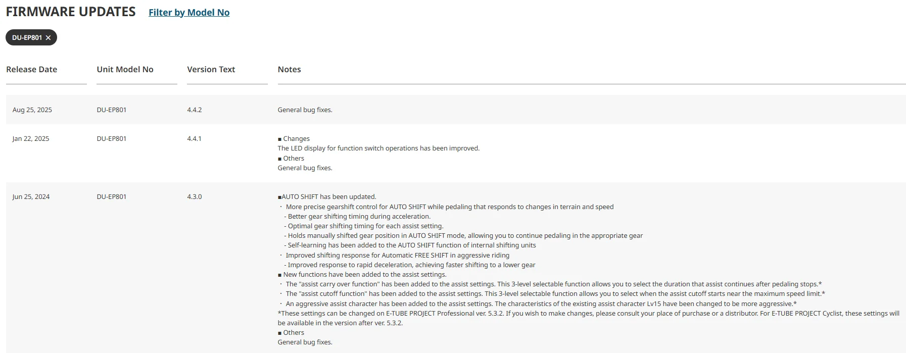

Any experiences with higher FWs than 4.4.2?
This is a quite strange question...
This thread is about the DU-EP801 drive unit from Shimano and currently there is no "higher" motor firmware than 4.4.2, because at the moment version 4.4.2 is the latest motor firmware from Shimano, see here, go down to “Firmware Updates” and then use “Filter by Model No”, then “DU-EP801”:
So what exactly is the intention of your question?
