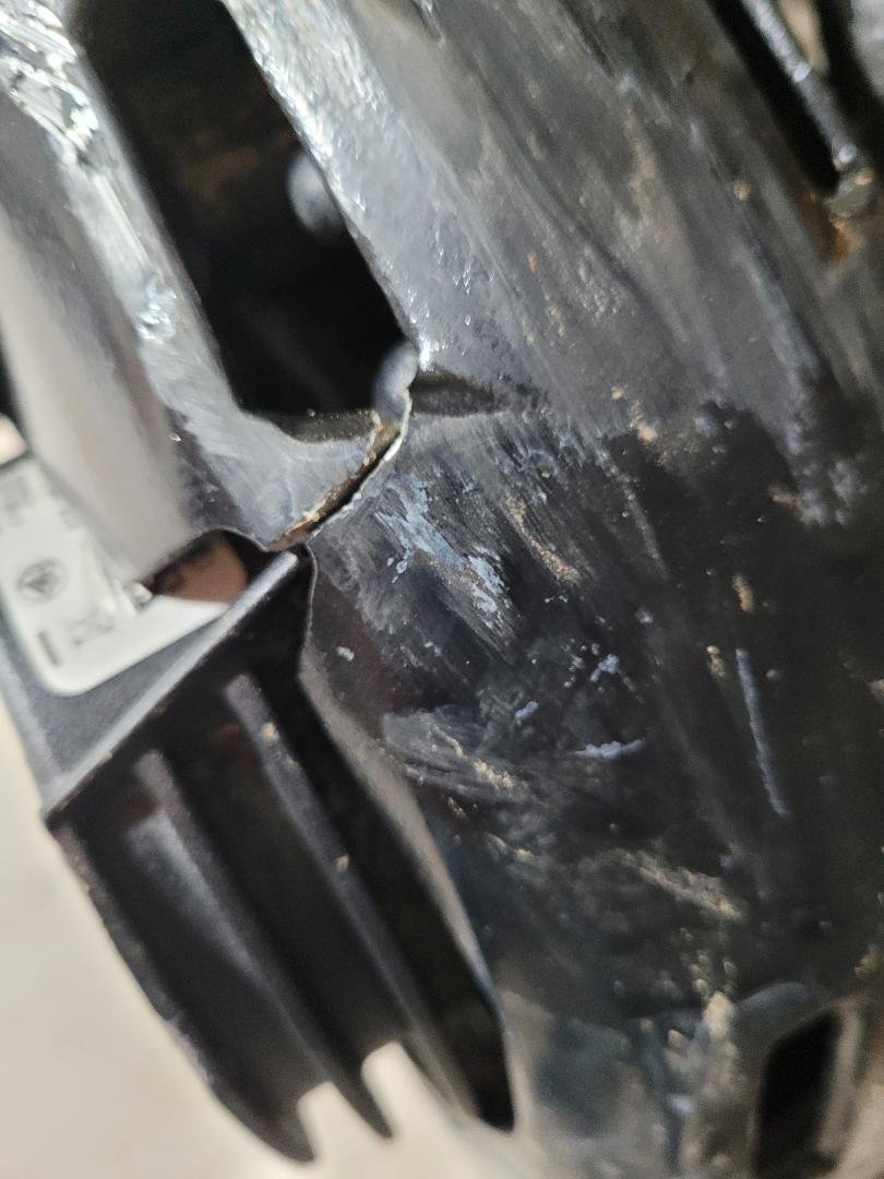

Just bought a Rail7, seem like an accident waiting to happen with the exposed wires under the Armor plate. I am on my 2nd Armor Plate and cracked in in two days of riding. Bad design, same weak spot. The wires to the motor are not protected, who design something like that. Trek really needs to take a serious look at this flaw.
