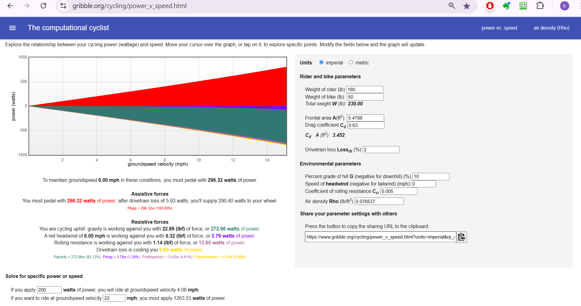

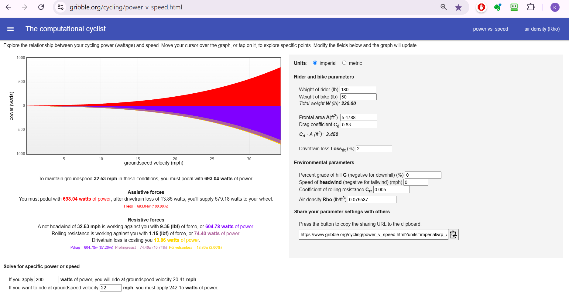

In regard to increasingly high energy use as speeds increase, @Waynemarlow was kind enough to post that formula earlier, which I'd really need to study to understand, but I'm guessing it's pretty right on, and he also made the very good point saying that "One of the scary implications of this equation is that at high speed, the power you have to produce is proportional to the cube of your velocity. So, to increase your speed by 25%, you need to nearly double your wattage! "
What I don't think anyone has explicitly said though, is why power needs to increase proportional to the cube of the riders velocity, and it bears clarifying as it isn't necessarily intuitive or obvious to a lot of people. The reason power needs to increase proportional to the cube is essentially entirely due to wind resistance/aerodynamic drag, or whatever other term you'd like to use. There may be minor other elements of drag that are non-linear as speeds increase, like I'm thinking that the hysteresis losses in tire casings may be greater as the rubber has to flex at a faster speed, particularly if using a slow-rebounding sticky rubber compound tire as are popular in DH and Enduro racing, but for low rolling resistance XC casing tires that is pretty negligible relative to aerodynamic drag at higher speeds. Similarly, drivetrain drag (losses in the chain) are non linear, but that's relative to power output, rather than speed, and is only a few watts either way (assuming you use an efficient chain lube).
When talking about climbing, particularly on steep climbs where speeds are naturally lower (and therefore aero drag is less of a factor), the majority of power output goes into lifting the combined bike/rider mass to a higher elevation, thereby gaining potential energy, which can then be recovered (not by the battery but by "free" acceleration of the bike/rider mass) on the way back down the hill. The energy required to lift the combined bike/rider mass to a higher elevation does not increase proportional to the cube of the riders velocity. It is a linear relationship, and so, all else being equal, when you are climbing a steep pitch and gain 500m of elevation, the same total wattage will go into lifting the bike/rider mass regardless of if you do it in 20min or 60min.
The cycling coach Joe Friel had a formula which to calculate a bike climbing speed based on rider weight and power output, use the formula: Power (watts) = (Rider weight + Bike weight) x 9.8 x Elevation gain (meters) / Time (seconds), where you need to add a percentage (around 10%) to account for rolling and air resistance. Regarding the addition of 10% for rolling and air resistance, this was on road bikes, so rolling resistance would likely be a bit higher than that on a mountain bike. Air resistance would be higher for a given speed on a mountain bike, due to the less aero positioning and bike, but since mountain bike speeds are lower, and we know the resistance drops with the cube of velocity too, I would actually wager that the overall air resistance would be lower, so in the end, I am pretty comfortable with that 10% figure as a rough guideline.
That assumes both speeds are equally in the motors optimal efficiency band, and I would like to know more if anyone has info on that. Given that drivetrain losses are known to be non-linear, increasing as power output goes up, I would imagine the gear drives of the motors are similar, but I could also imagine that some of the losses are fixed, like seal drag, and so those would actually be less of a factor at higher power outputs.
These graphs illustrate what I am talking about in the previous post. In the first chart, which was on a 10% grade, doubling speed is only barely more than doubling power requirements, whereas in the second chart, on a 0% grade, the requirements are sharply exponential as speeds increase. For those who want a quick and easy way to see how different variables alter power requirements, this calculator (An interactive model-based calculator of cycling power vs. speed) is pretty sweet.
