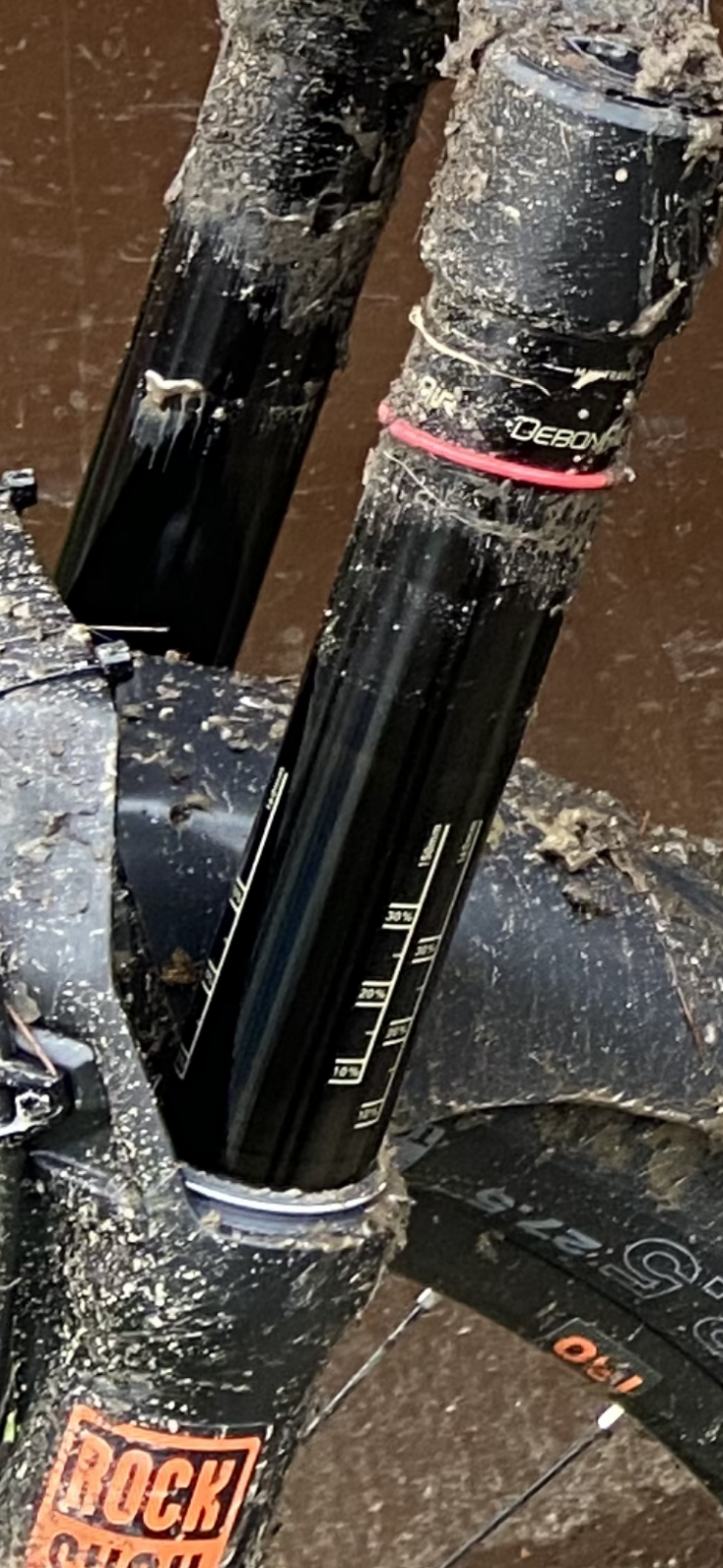

The tune on the basic 160s delux shock, is 2 tokens. That's all.

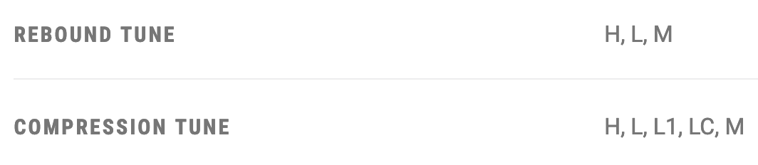

When a manufacturer talks about a 'light tune' I assume it's damping they're talking about. Just checked mine, it's medium rebound and light compression.
I only have rebound adjustment on the basic delux. Combined initially with 2 tokens. There's nothing much to tune. Compression will be whatever it's set at, similarly to the basic zebs.

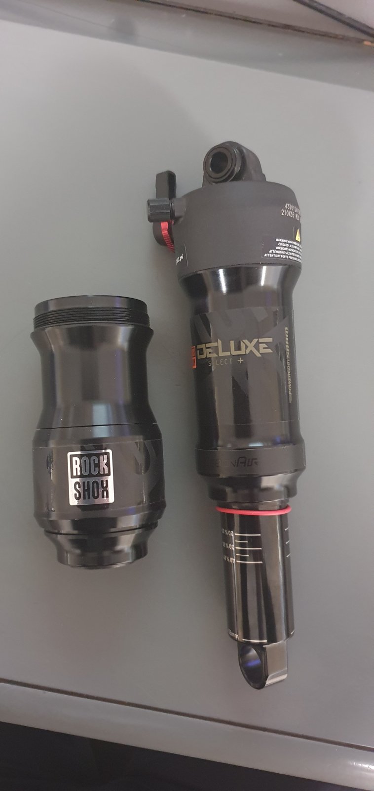

I installed the megneg yesterday. The installation was straight-forward. Anyone who can do a can service would manage it no problem. It was also an opportunity to regrease the piston and renew the oil in the can.
As suggested by Clubby I removed one of the 3 positive tokens, so have ended up with 2 pos tokens and 2 neg bands.
As mentioned previously I am not a light rider - 95Kg in my big boys pants, so around 100Kg fully loaded. I had to put 280psi (before disconnecting the pump) in the shock. That took some pumping. This gave me 35% sag, so I'll probably have to squeeze in another 10psi.
Went to my local trails in the evening for a quick blast and am happy with the initial outcome. The response was very much as predicted by the curve shown on SRAM website, more active on the small stuff, supportive in the middle and I didn't quite use all the travel, so must be ramping up well at the end of the stroke.
For the money I consider it a very useful upgrade. Major improvement over the standard shock.
Will report back again after a few more rides.

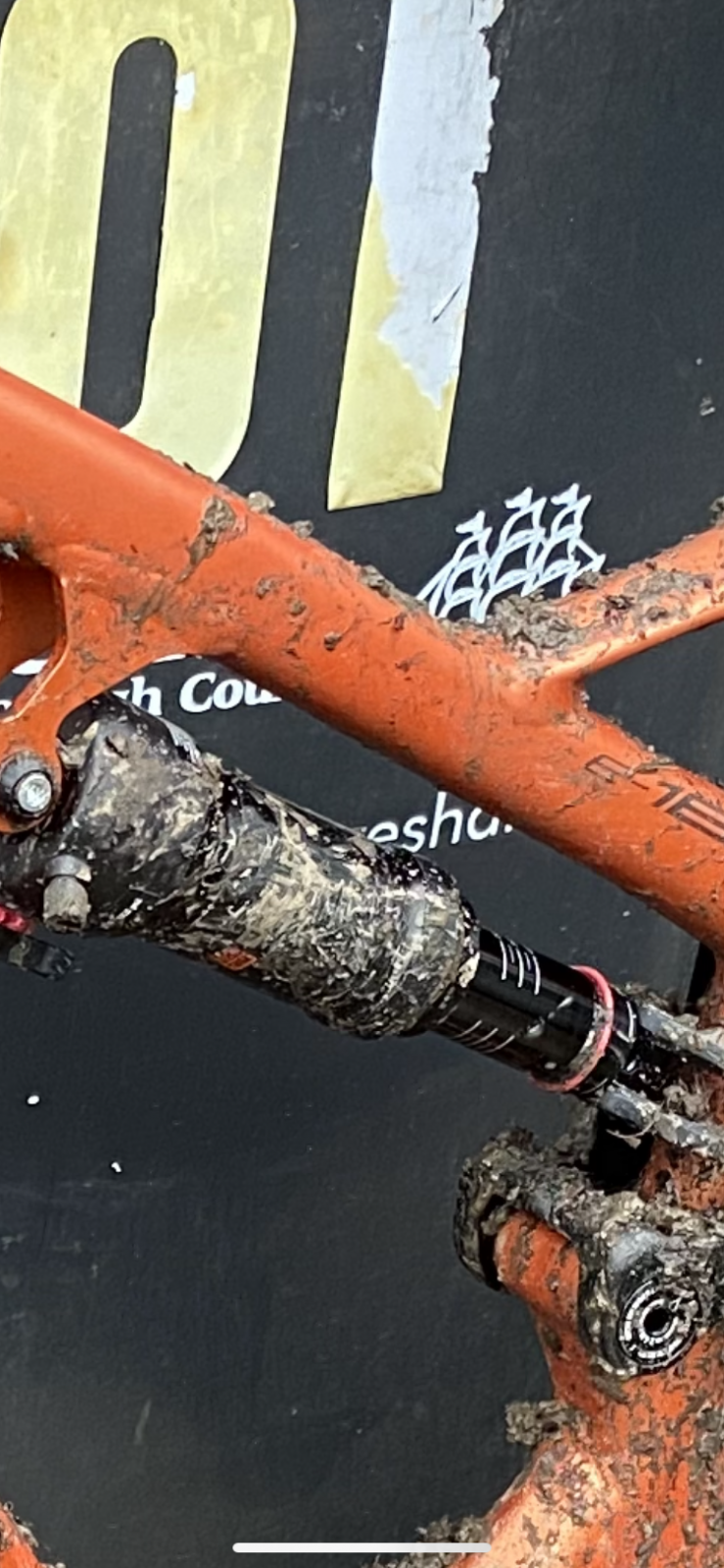

Was up at Comrie Croft today which is very rocky. Fork felt amazing but rear just feels a bit dead. 30% sag with no tokens and just getting full travel on the biggest drops I have the balls for. Not great on small chattery stuff. Any less air and just wallows in mid travel. Still wonder if it’s just a symptom of such a heavy bike and a double down rear tyre but for 80 quid I reckon it’s worth a try. Worst case I stick the original one back on and sell the megneg for half cost.
