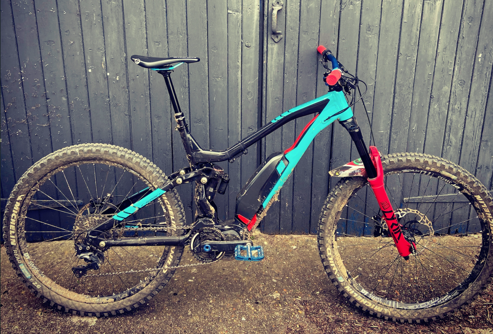

This is my bike, I have a 32 inch inseam, and the 150mm brand X is probably 10mm up form being as far down as it will go. I dont run the saddle as high as I would on a normal MTB, as I find on an emtb you find more time seated when climbing, and it works better with the saddle not maxing out your leg extension, I could prob run the post another 20mm higher. Size large.
