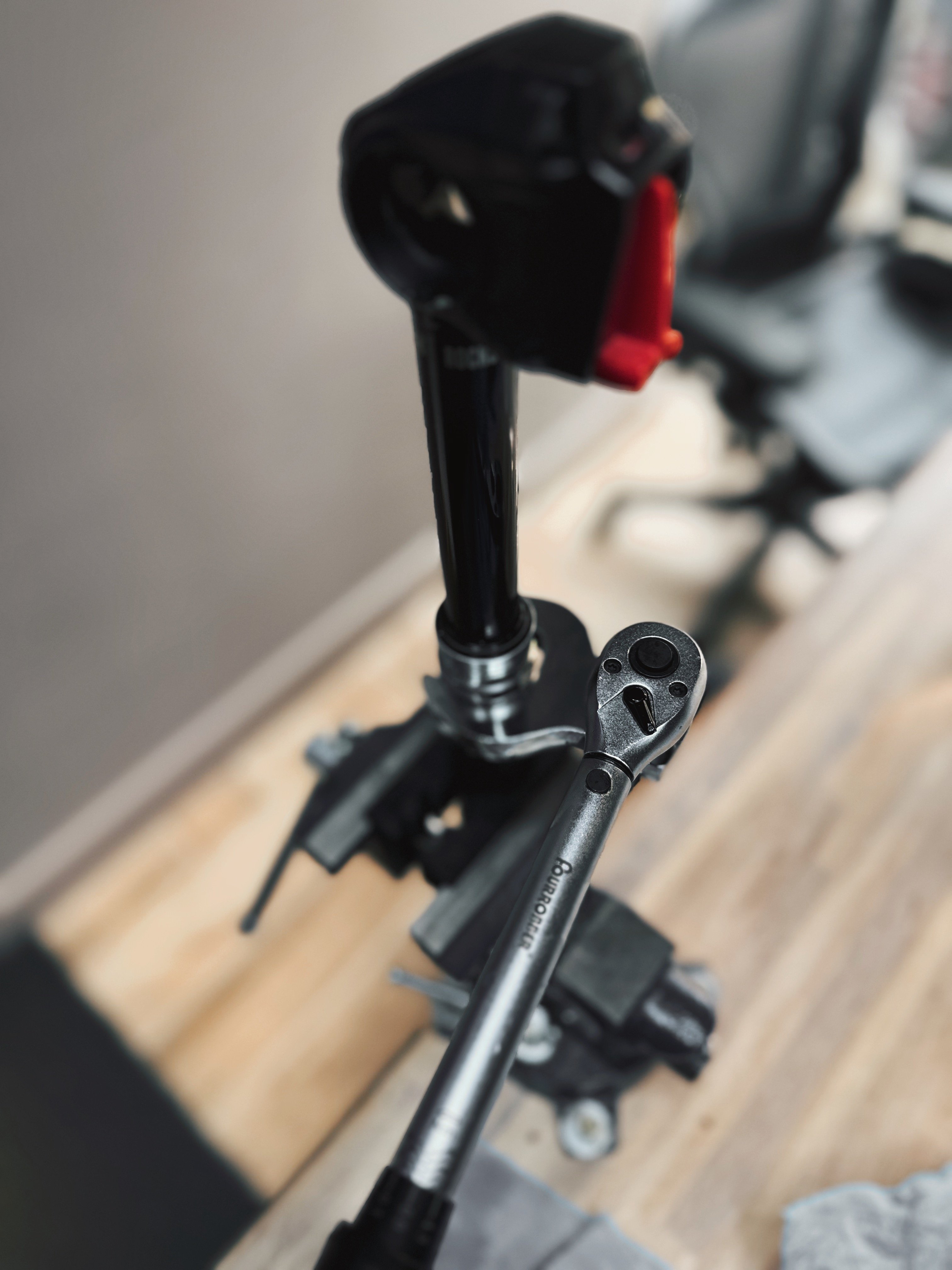

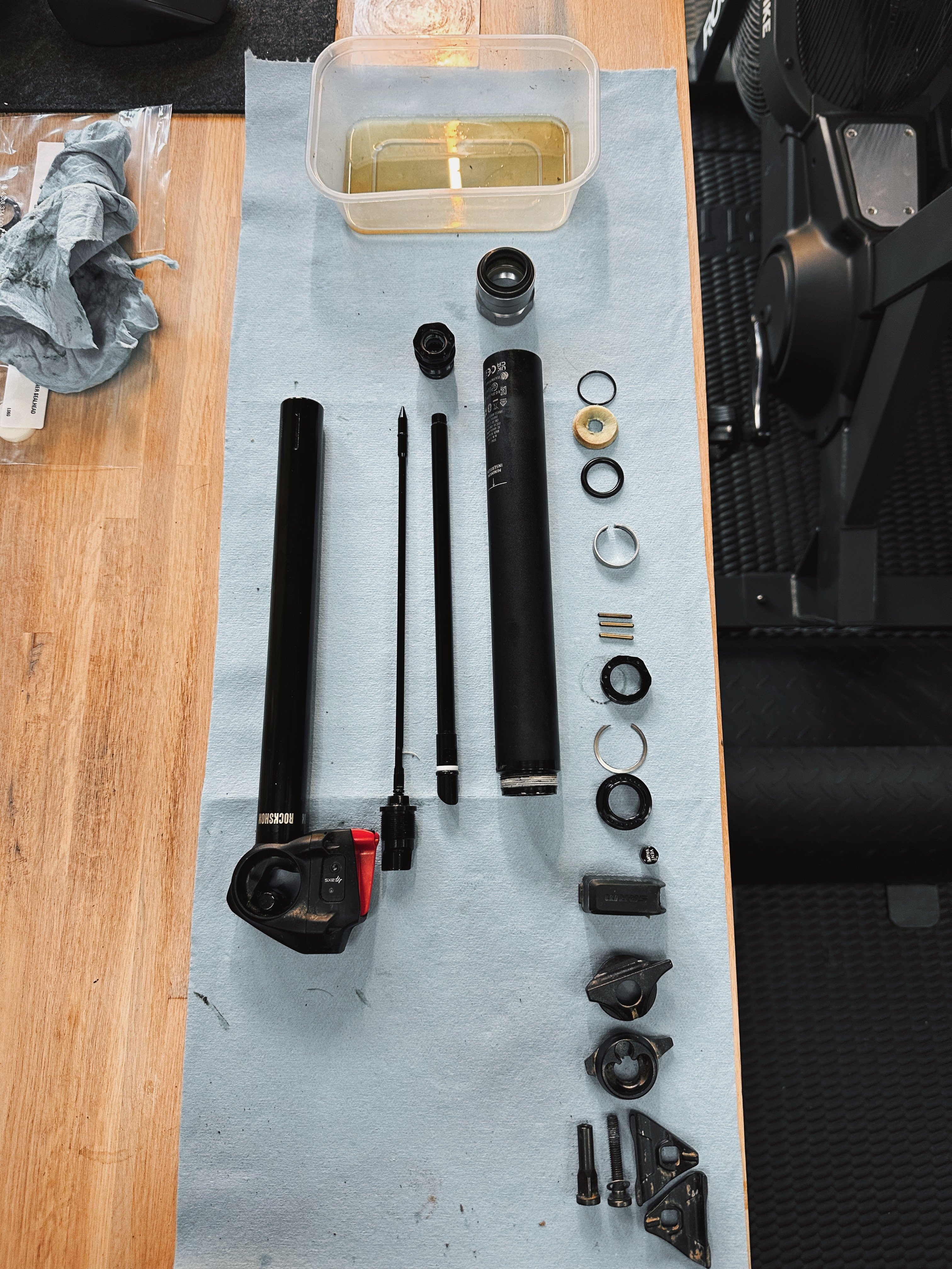

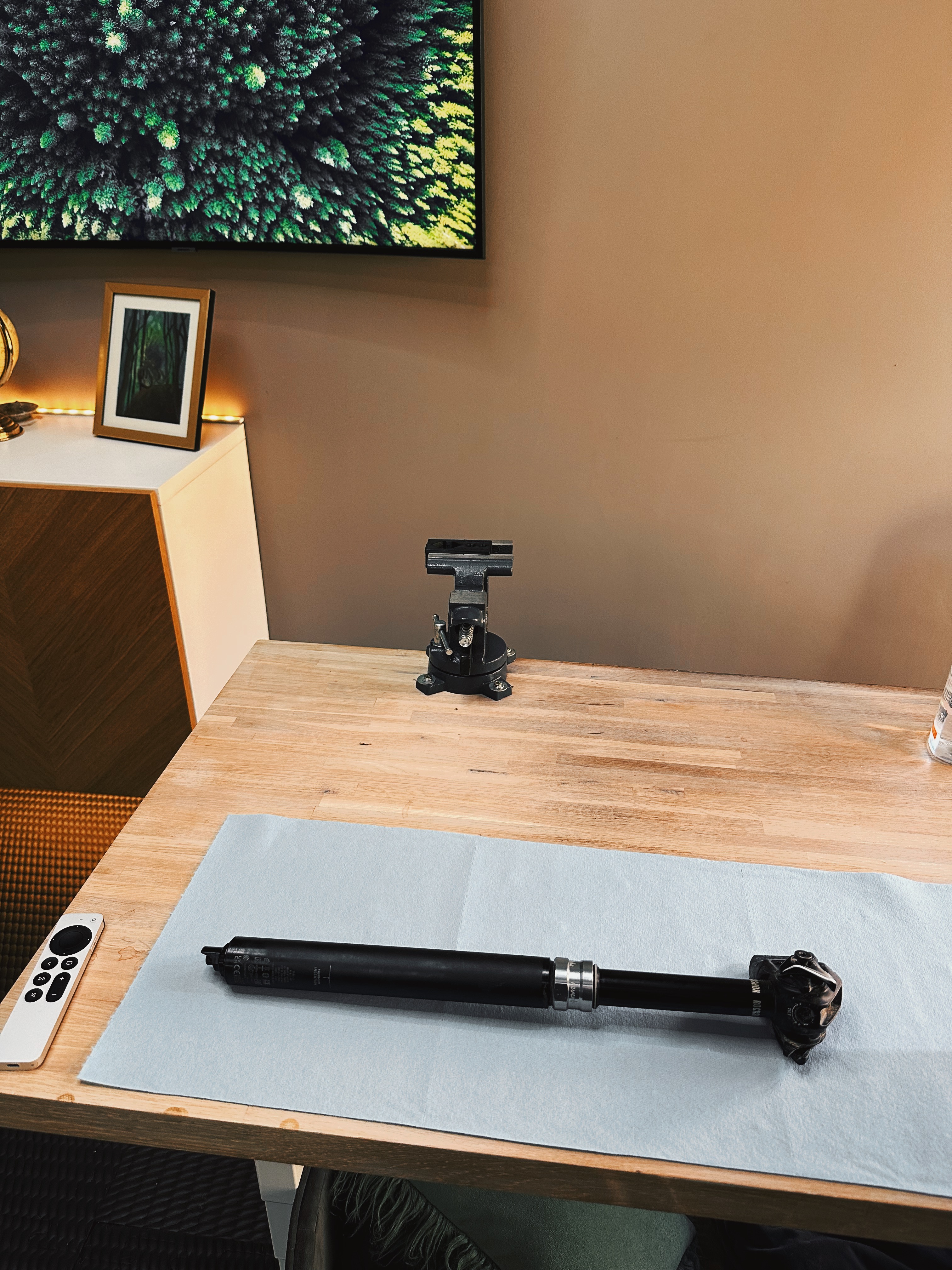

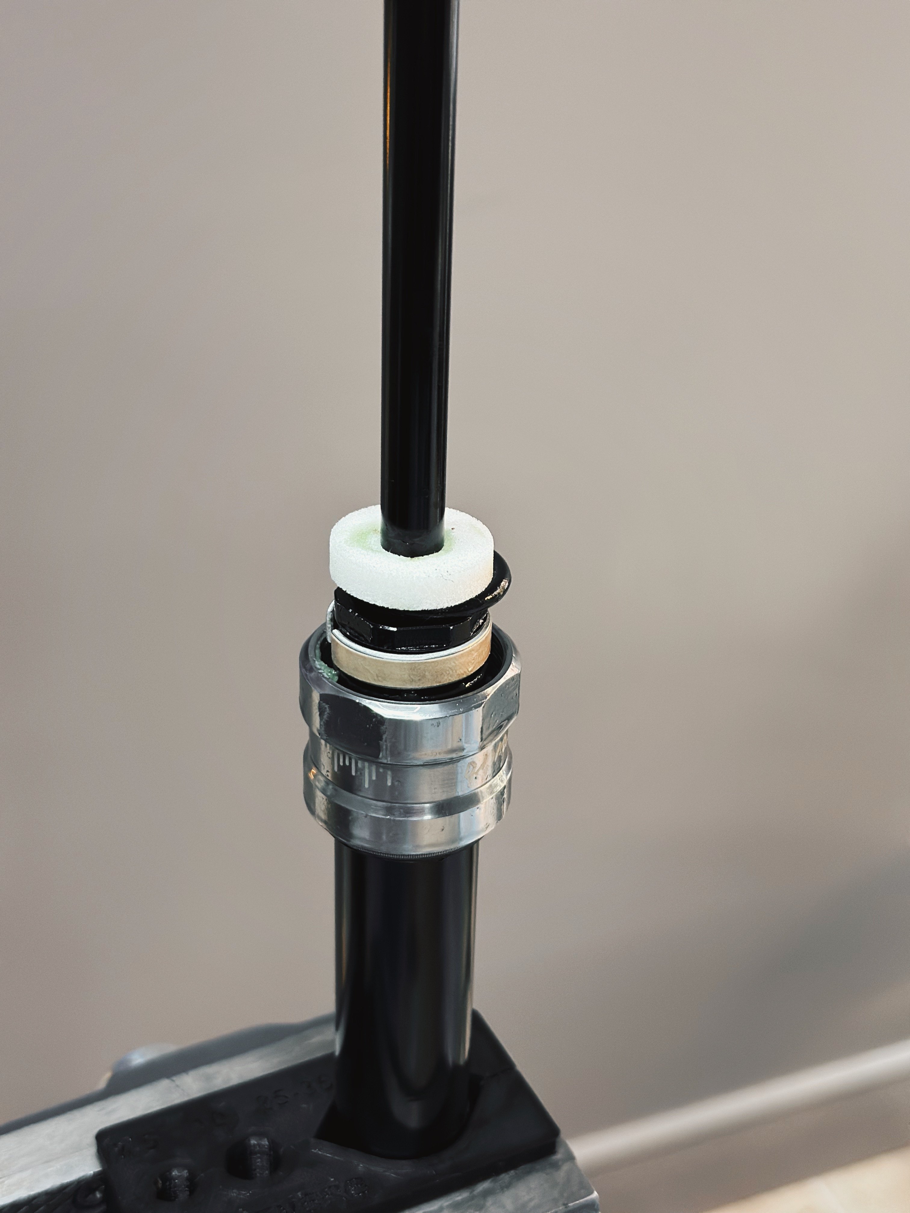

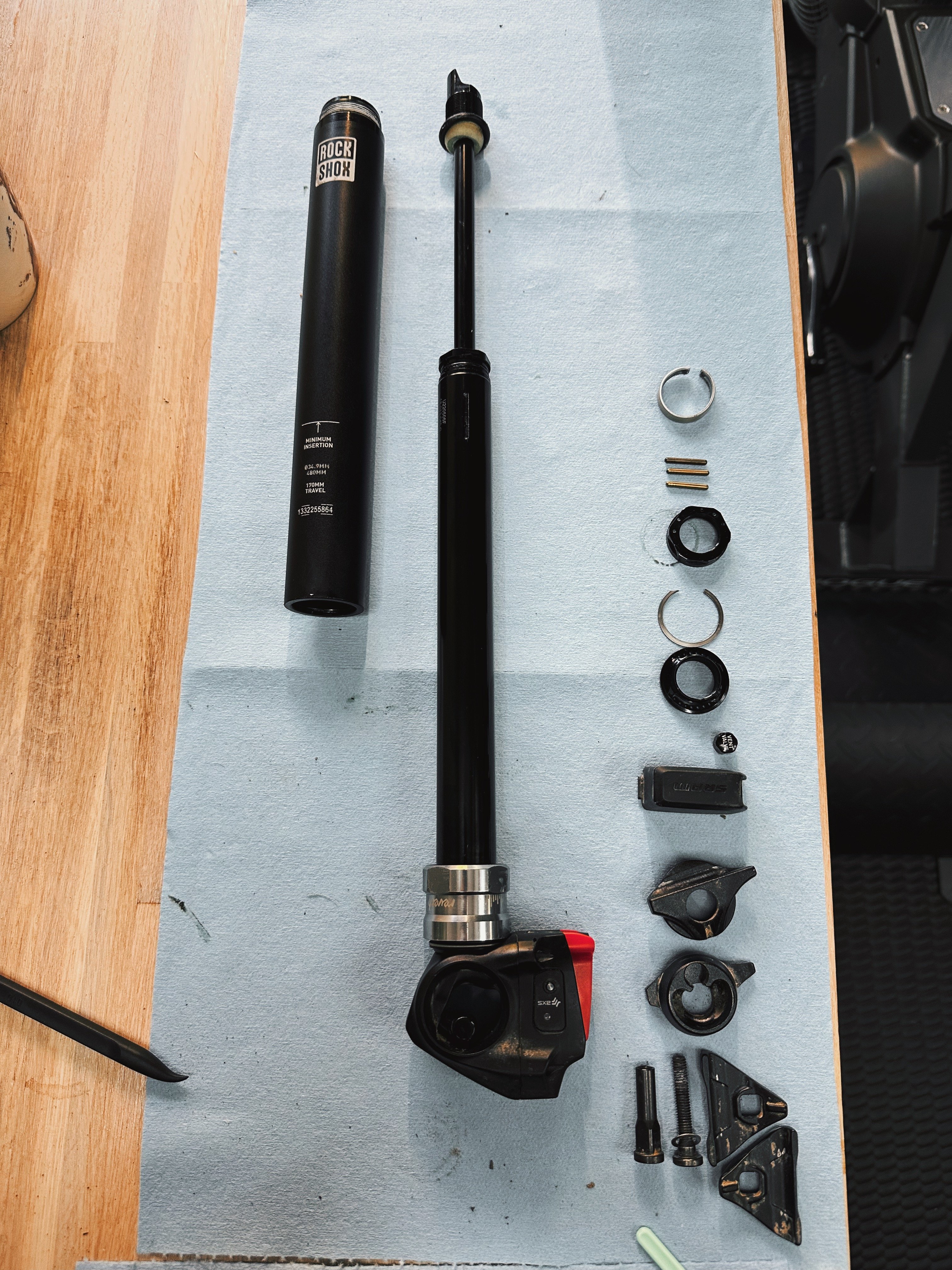

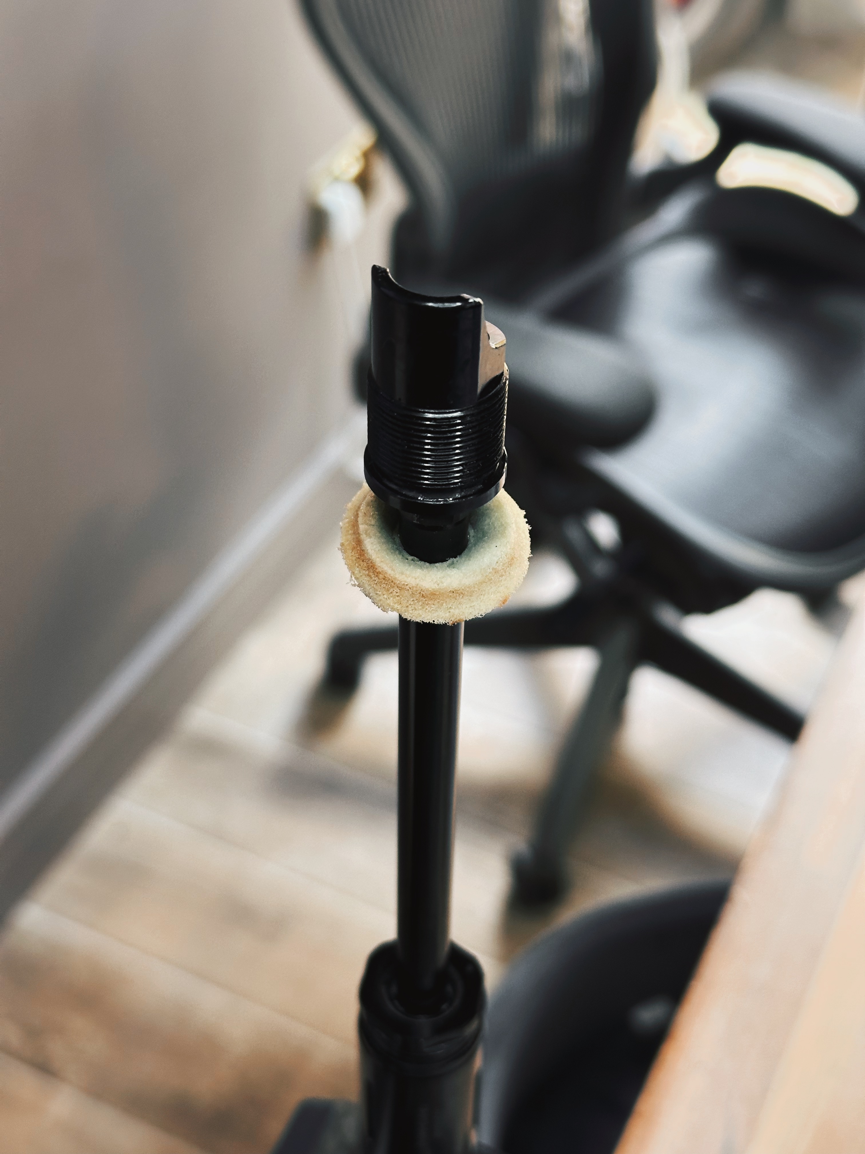

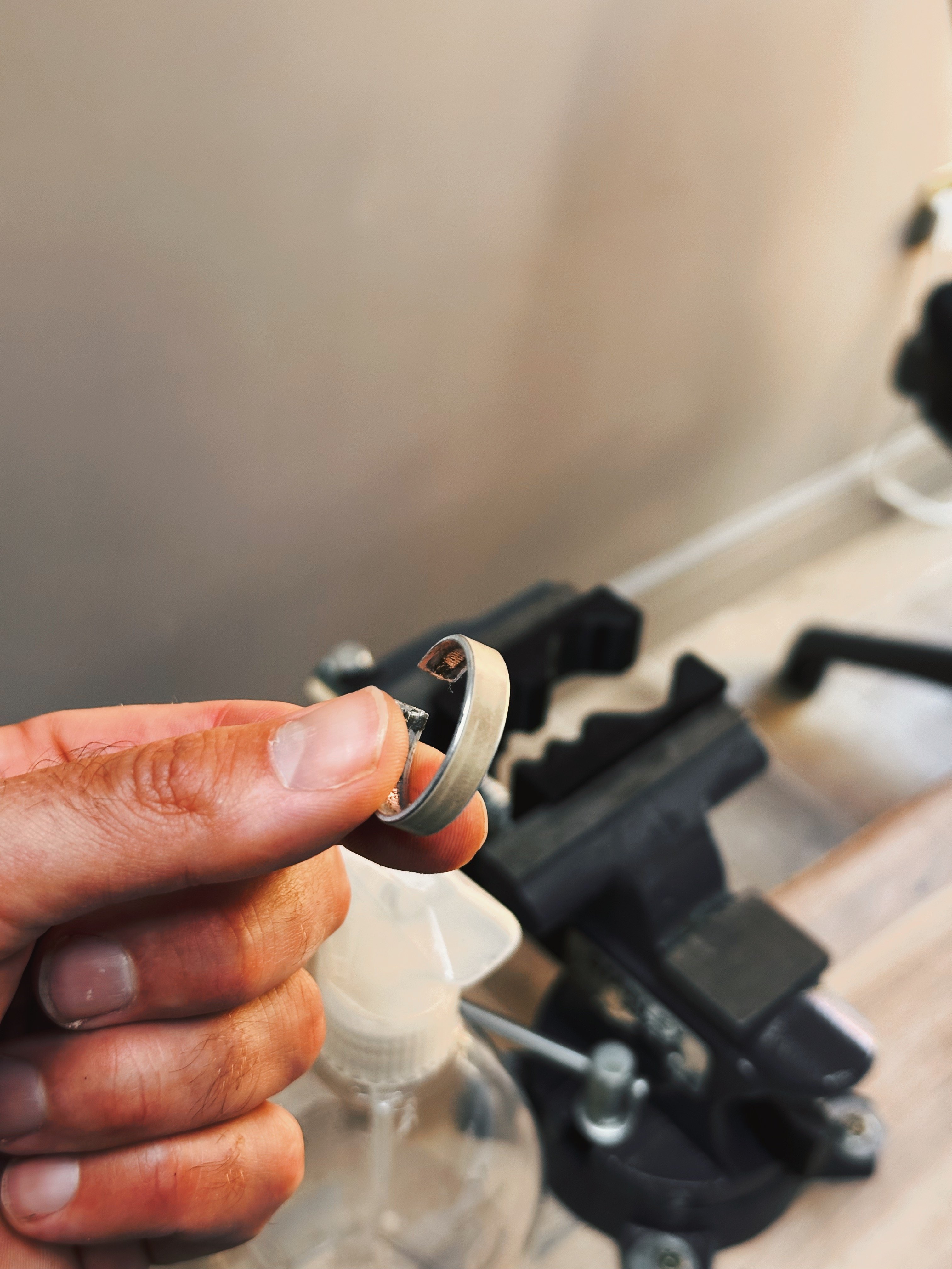

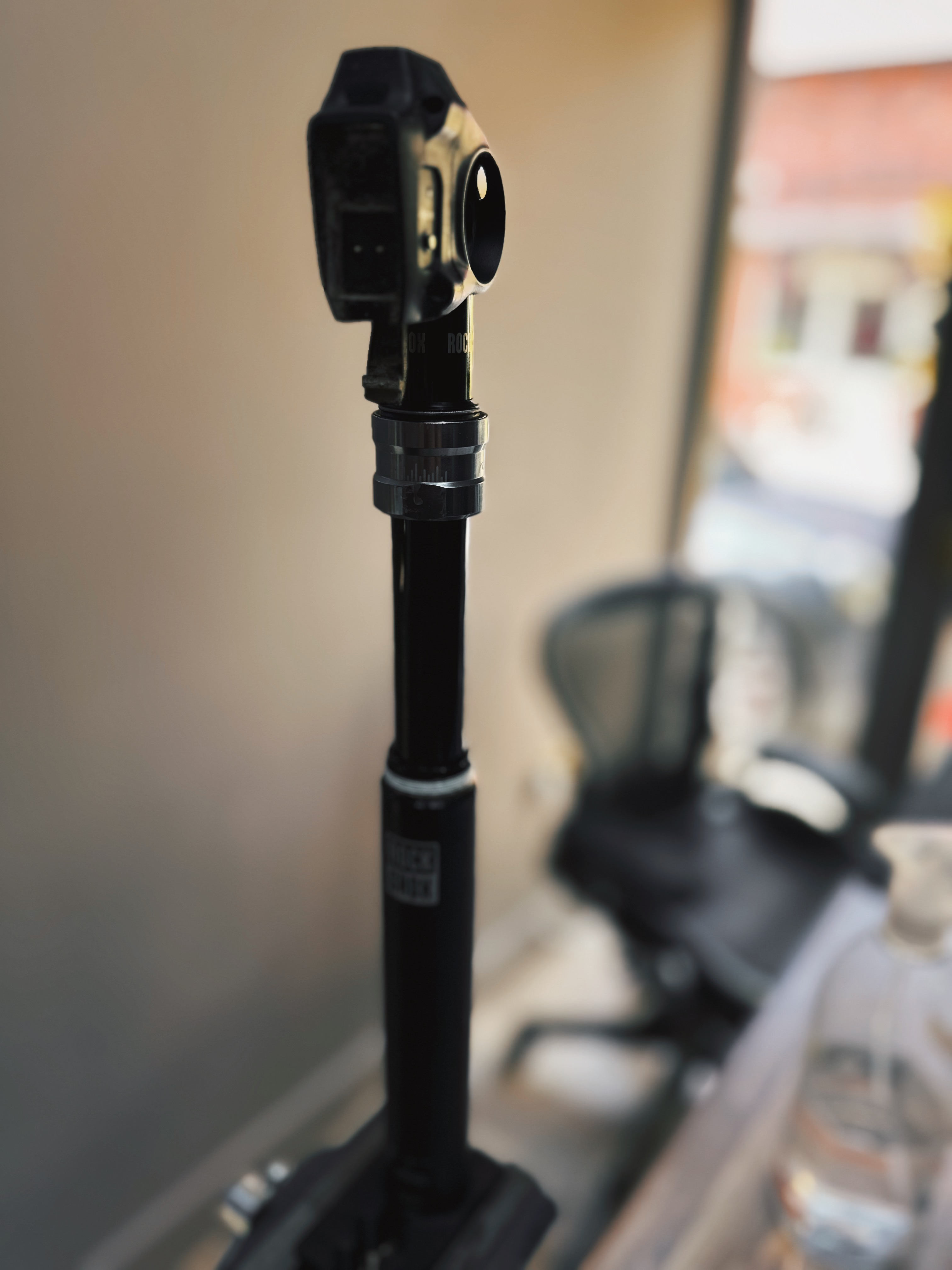

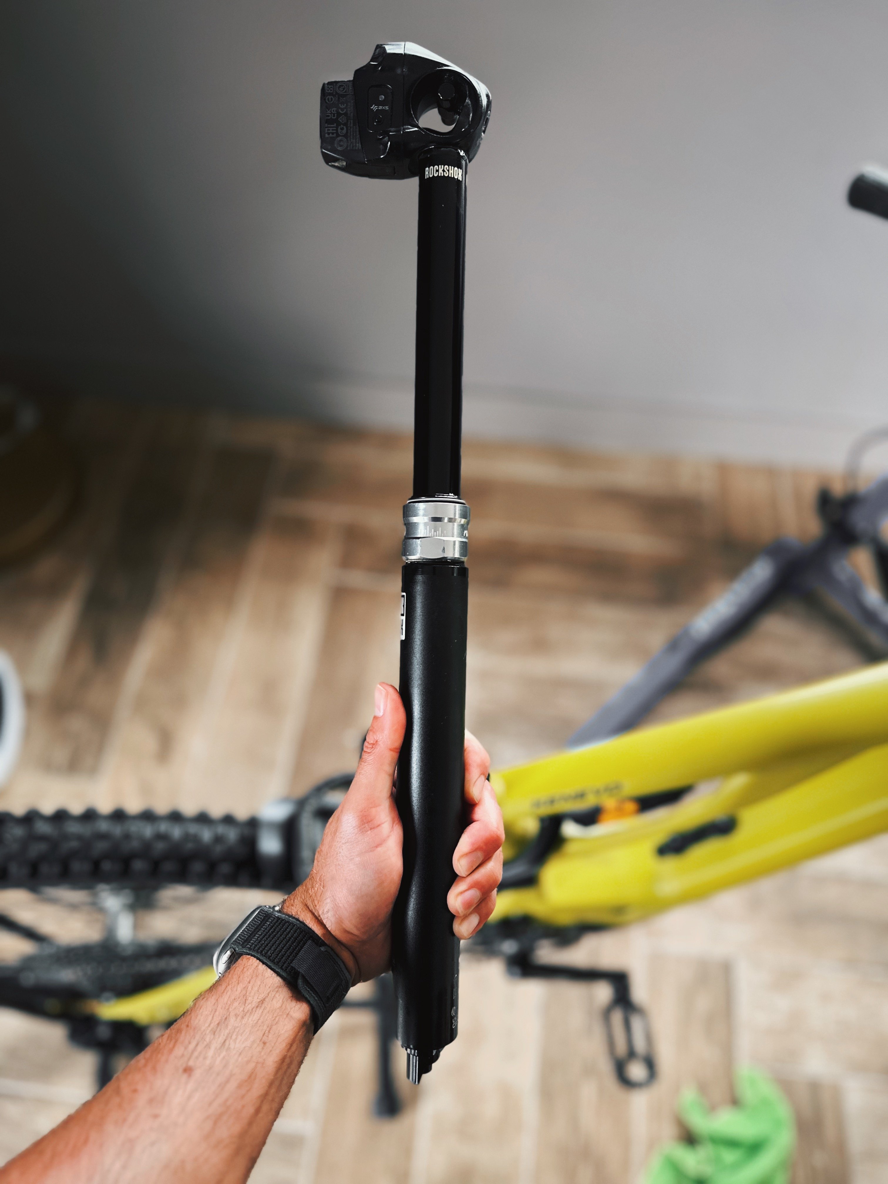

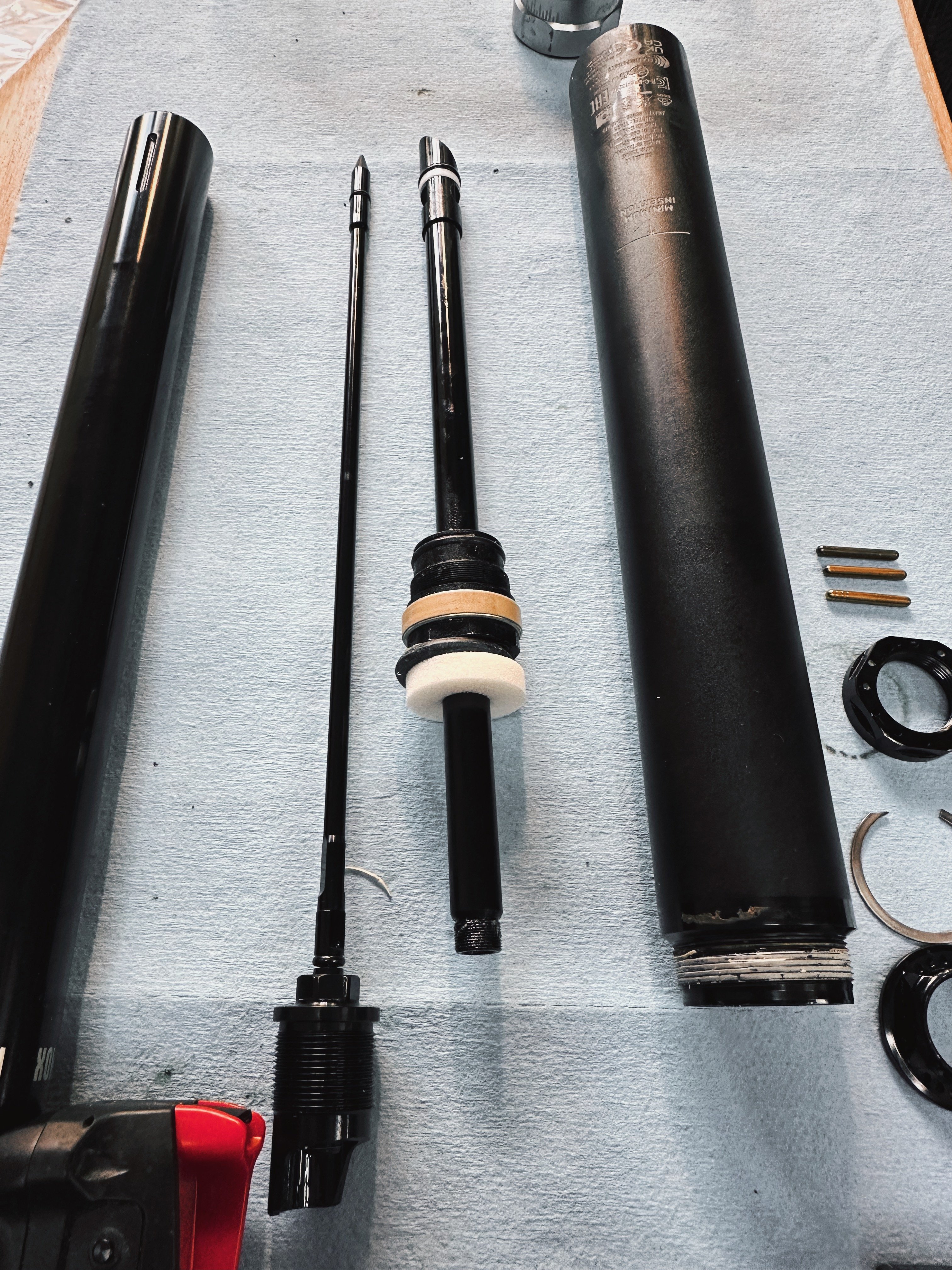

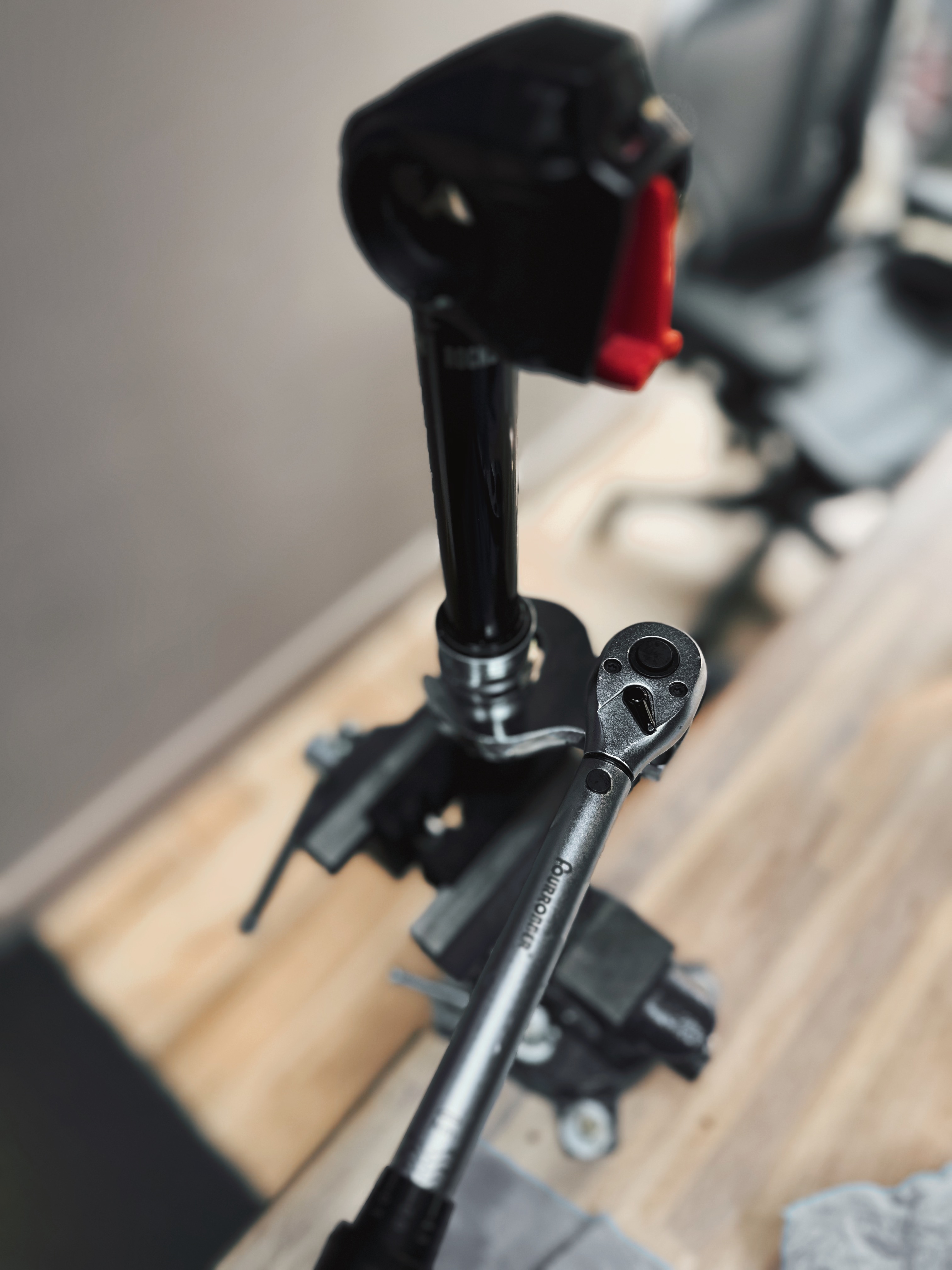

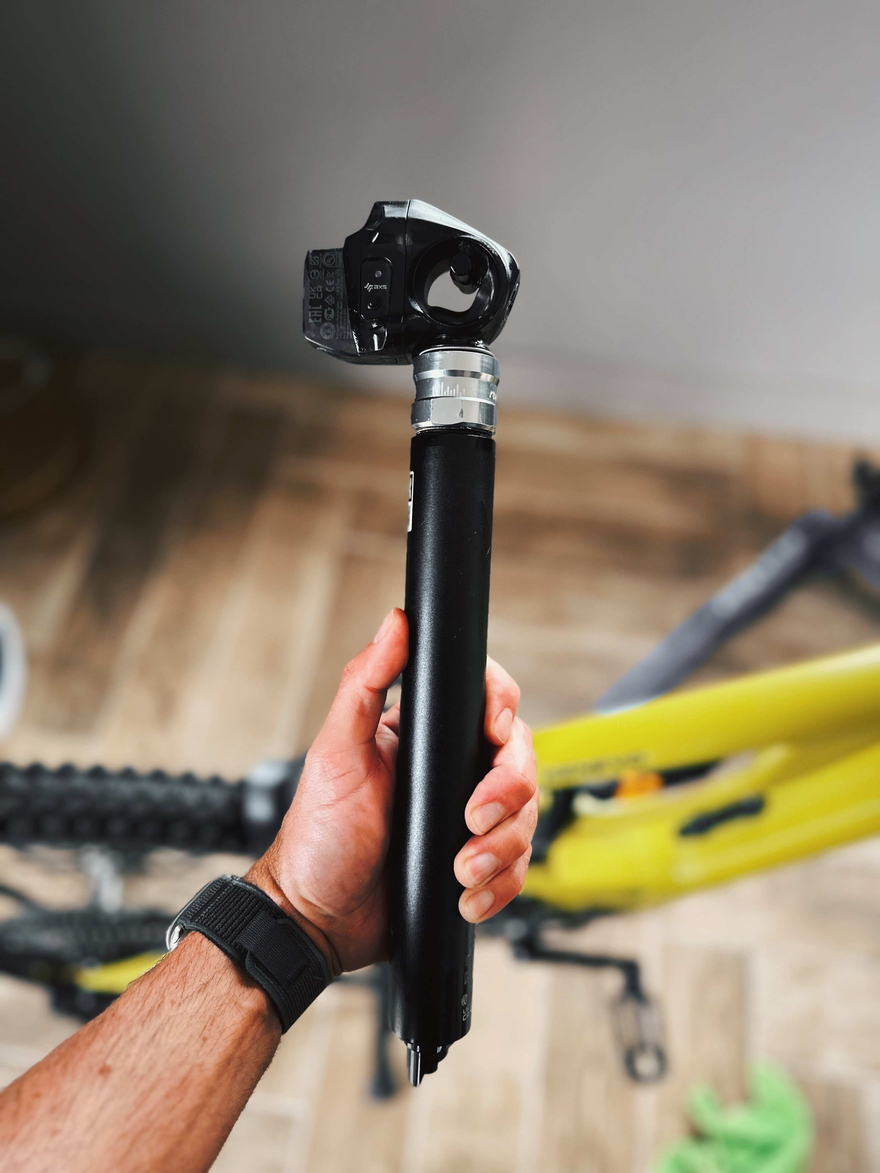

So I managed to get a spare couple of hours today and decided to fix the faulty AXS Reverb Dropper. As said above, I’ve lost around 5cms of height as it won’t fully extend. This is most likely because air has been sucked into the wrong side of the IFP valve, something the simple SRAM bleed procedure couldn’t resolve.
The plan was to do a full 600hr service (even though it’s only due a 50hr). The 600hr service requires a full hydraulic bleed so would fix any issues with air / oil being on the wrong side of the IFP.
I did enquire on getting TF Tuned or J-Tech to do it for me but it was a months wait and £120+. So for something I could do in around an hour or so it’s just as easy to get it done myself.
The process was quite enjoyable, much easier than rebuilding an old Spesh Command Dropper (if any of you can remember them!?).
I had all the tools required (which were a lot!) apart from the IFP depth tool and the service parts.
Here is a view of what you need. This is not including the zip ties you need to try and pull the IFP out of the main chamber…
I also didn’t use the Rockshox recommended Maxima dropper fluid as lots of people have had great results from 5wt suspension fluid. So I used exactly that from Fox - PFTE infused also. This will work better in colder months.
Its works perfectly now. Full extension and no squish at all. Hard as a rock.

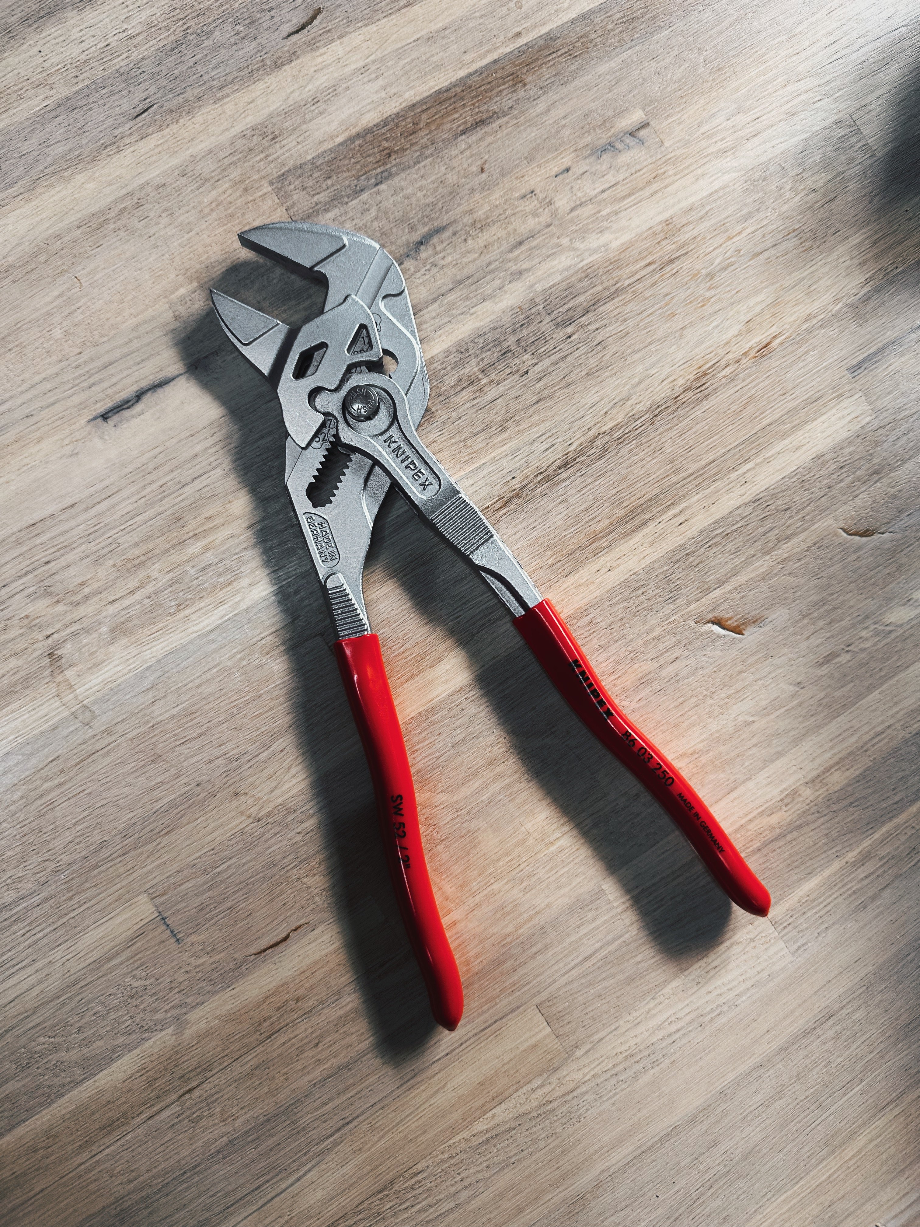

PS…. If you haven’t already, you absolutely should have this tool in your toolbox. The Knipex …. Replaces all your spanners.

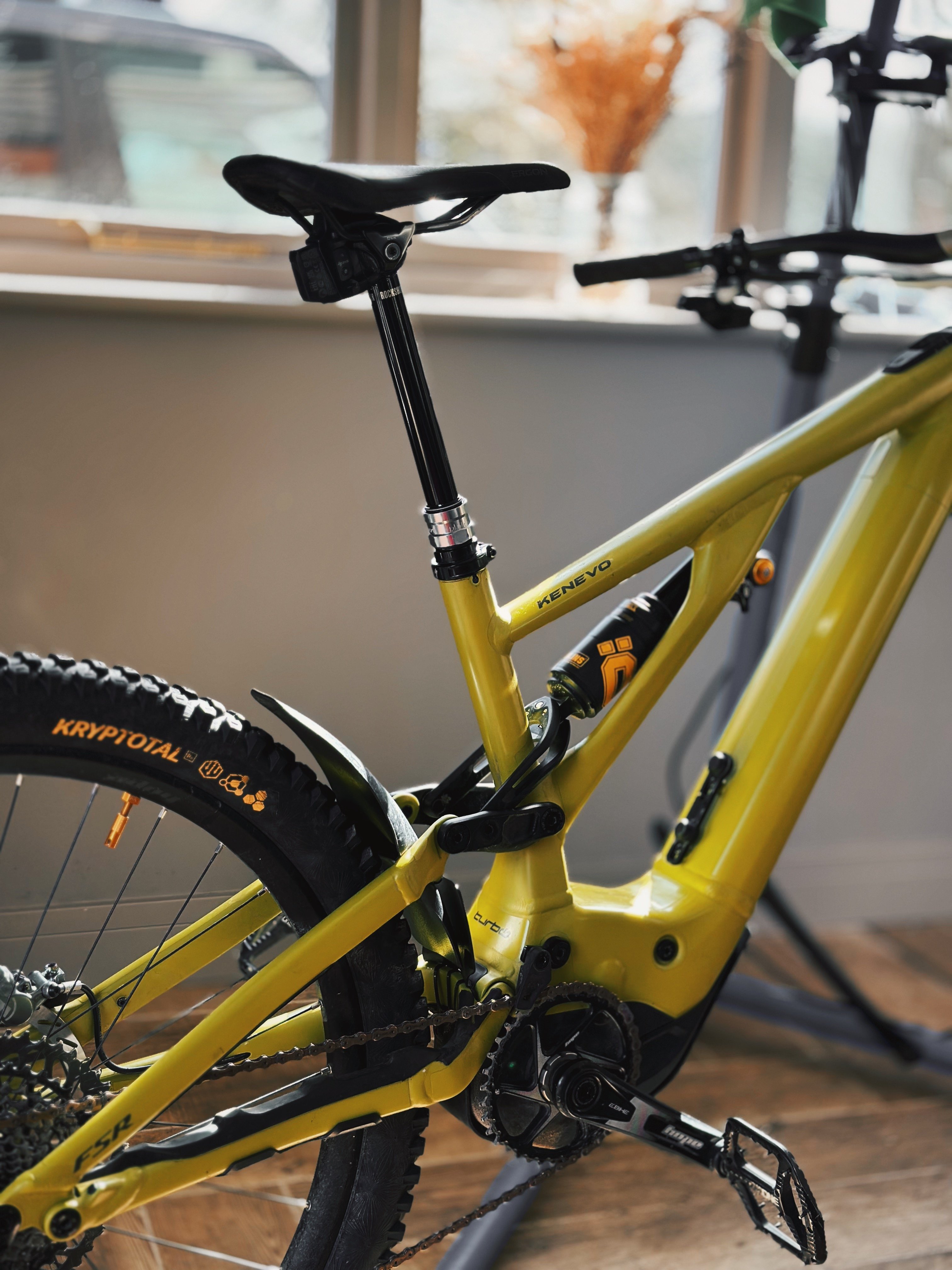

First day out on the Kenevo after it’s 600hr AXS dropper service.
I’m pleased to say it’s never felt so good. Really quick to return to full extension and seems easier to push down.

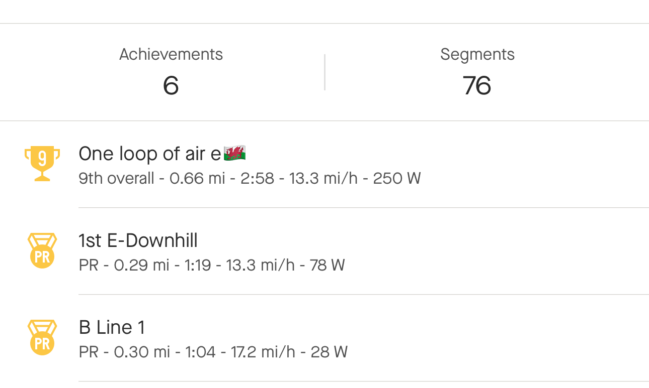

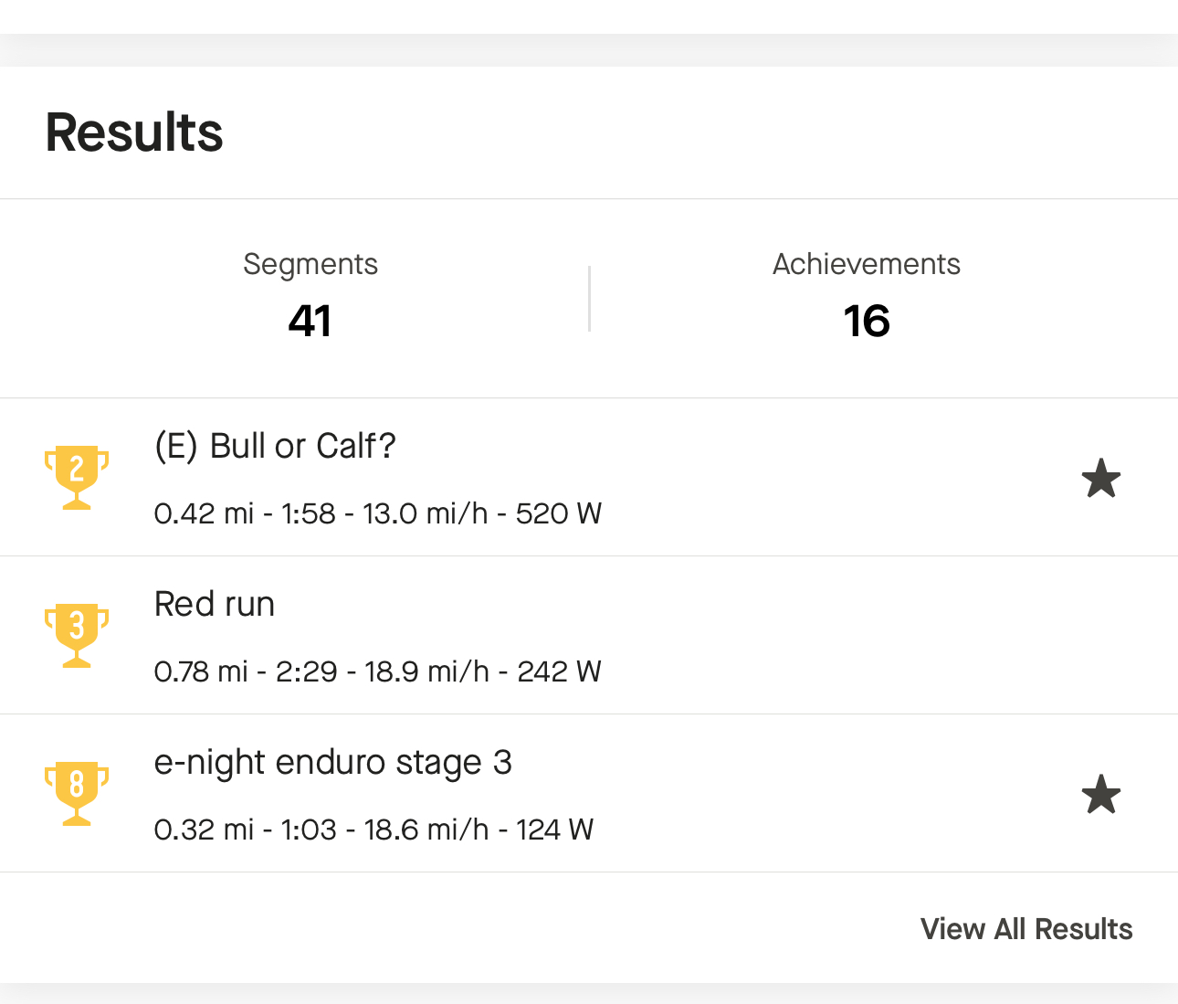

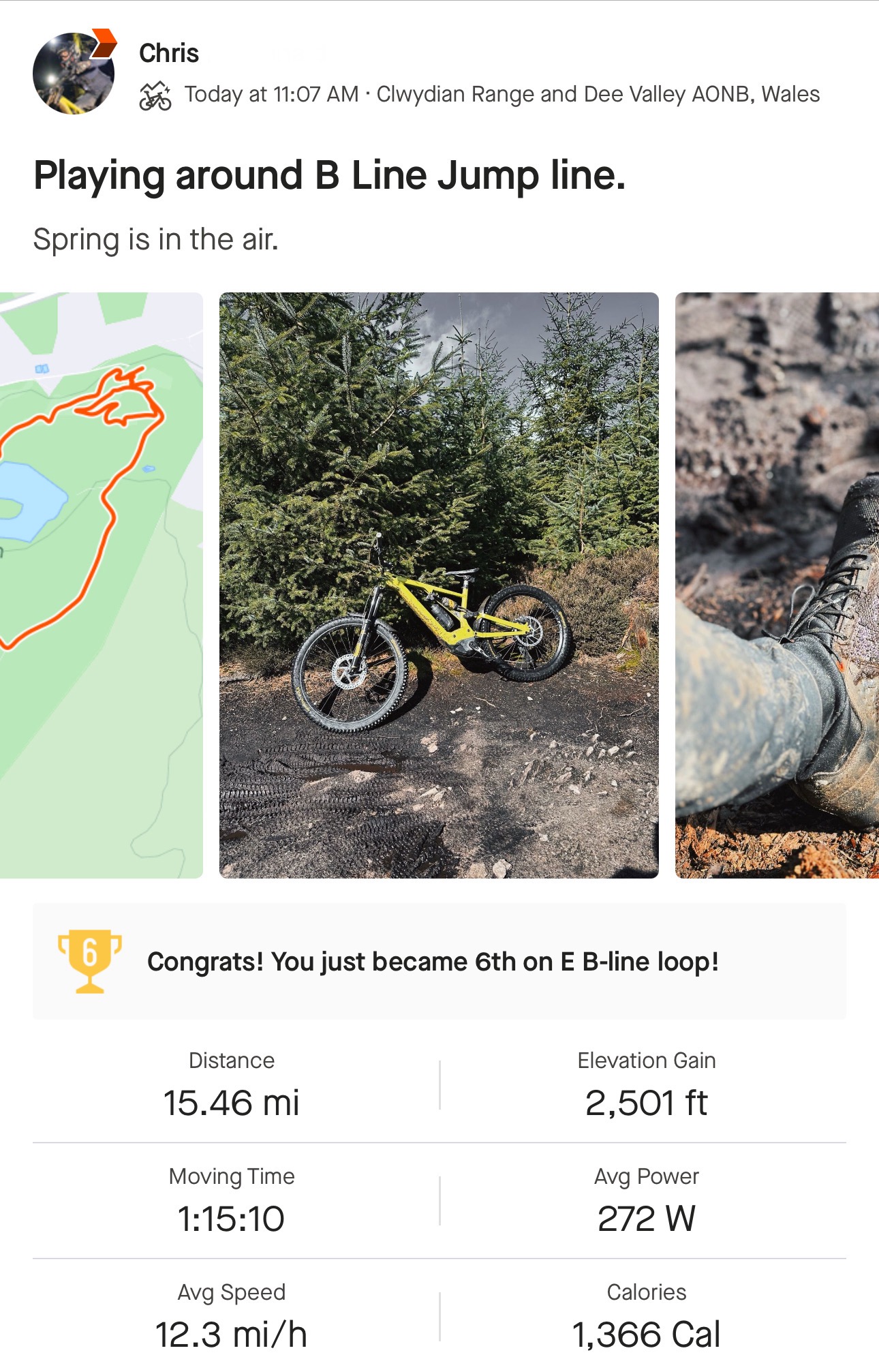

Even though it was really wet and muddy at Degla I managed a top 10 on the B Line jump line.

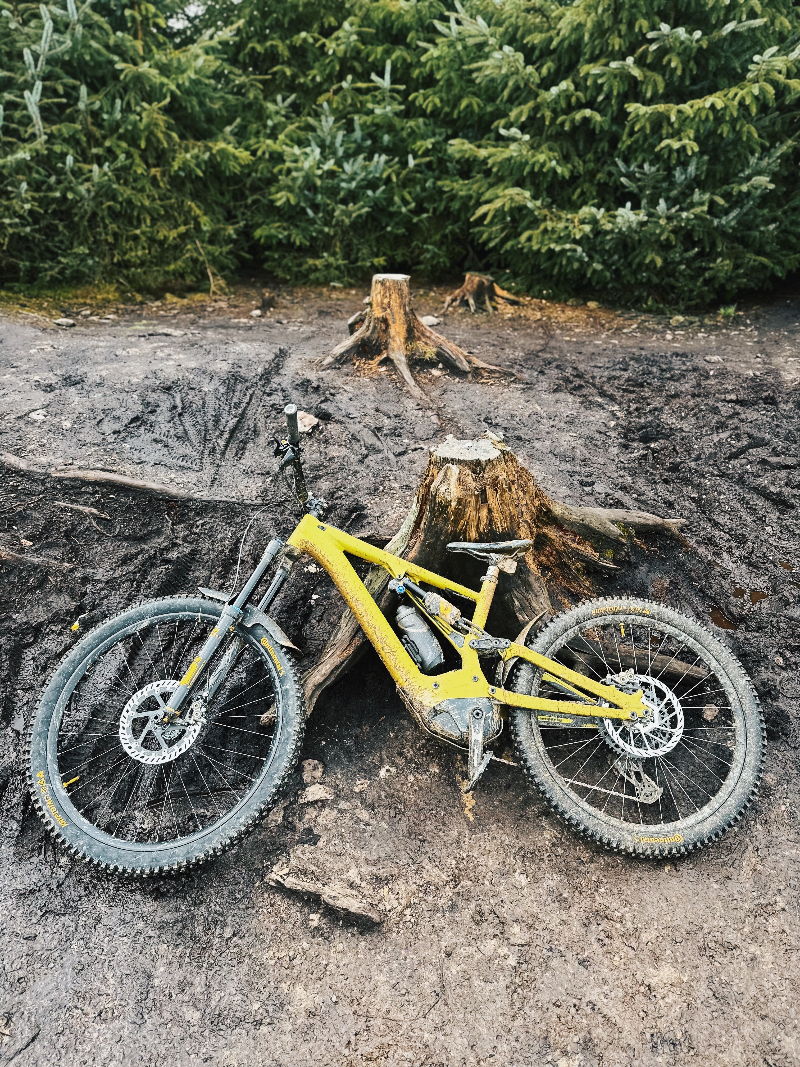

Update - the weather has been pretty bad here in wales but the Kenevo has performed faultlessly since the new parts and service items.
Didn’t go that hard (in my mind) today but came away with some decent PBs at Llandegla.
View attachment 137193View attachment 137194View attachment 137195
PS…. If you haven’t already, you absolutely should have this tool in your toolbox. The Knipex …. Replaces all your spanners. View attachment 137196

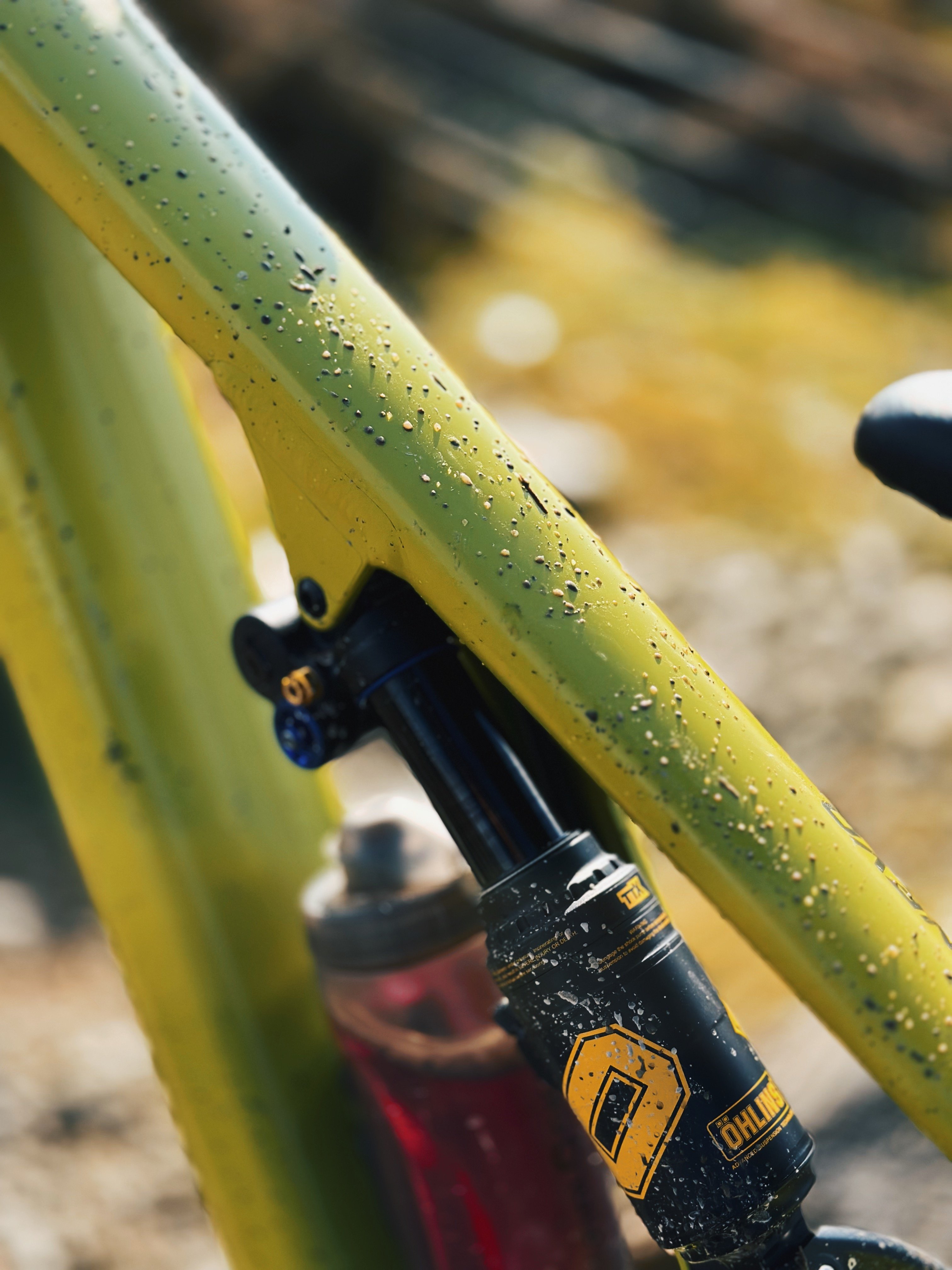

7. Shock - Coil for ploughing air for popping! Standard one is ok so I placed this later in the list.

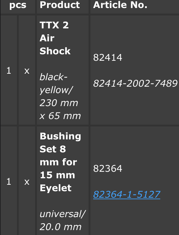

7. Can you give me some details regarding the Ohlins shock you got. I couldn't find the exact model in your posts/photos

7. It’s the Öhlins TTX Air 2 - 230 x 65. It will give you 10mm of extra rear travel too.
