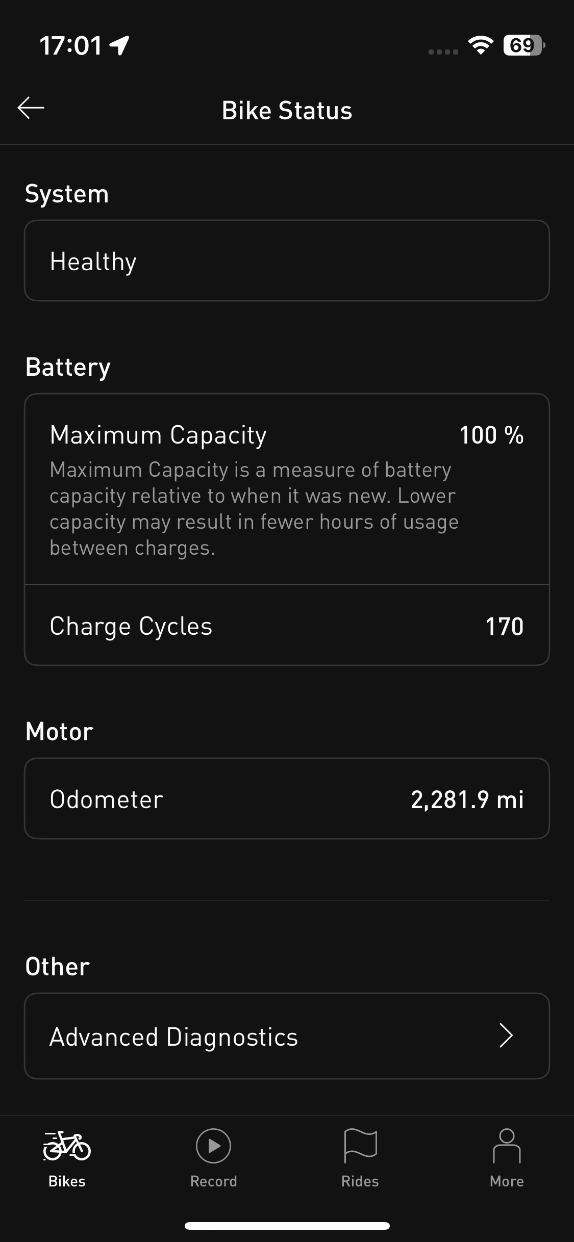

My Levo SL today, 4 years old, no special treatment;
I presume that Specialized must be lying to me, or could it be that they’ve implemented battery management software that looks after the battery so I don’t have to?
80% charging isn’t a selectable option on the Levo SL, and this asset has definitely been sweated.
Besides, when it eventually degrades to the point it’s unusable, for less than the cost of a decent set of forks I can buy another one.

Whatever the reason, the point was that this is a 4 year old battery that has never had that 80% option, is a small one so has frequently been charged to 100% but 170 cycles and 2800+ miles in it’s still 100% healthy.
It’s just been used to suit me rather than the other way around.
The motor sounds like a bag of spanners though, motors are what concern me! I wonder if leaving it turned off wherever possible on a ride, only using Eco and not ever washing the bike would help? 🤔😉 Imagine that!
