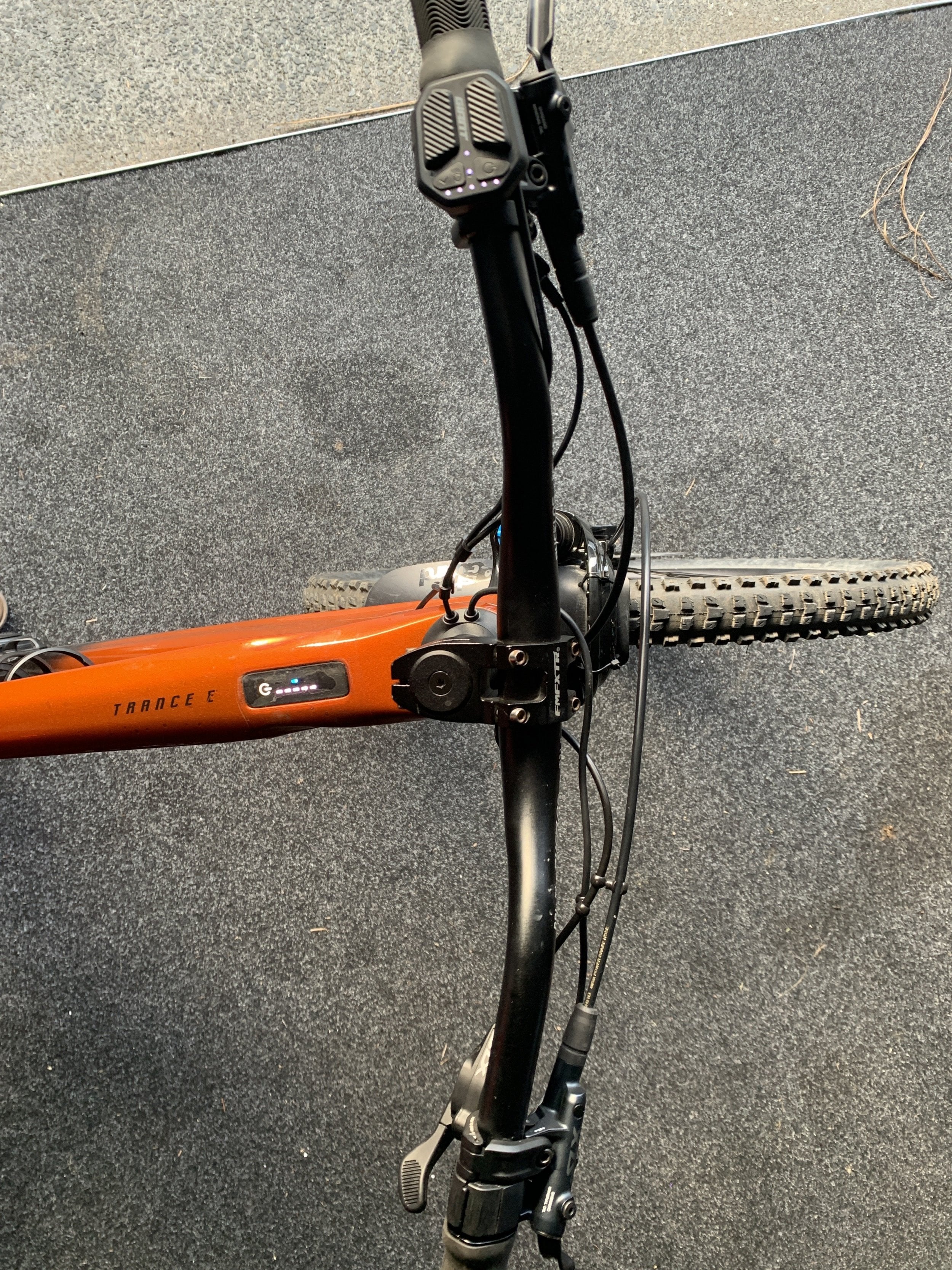

Just upgraded to the Ridecontrol Ergo.
Had to buy a Ridecontrol and a Y connecter cable. Reasonable price in NZ, $95 for the ridecontrol and $50 for the cable.
Shifted the original controller to the other side in case the new one gets damaged { it's pretty ugly but easy to use} and still managed to get the top tube display to work as well as the lights on the Ridecontrol.

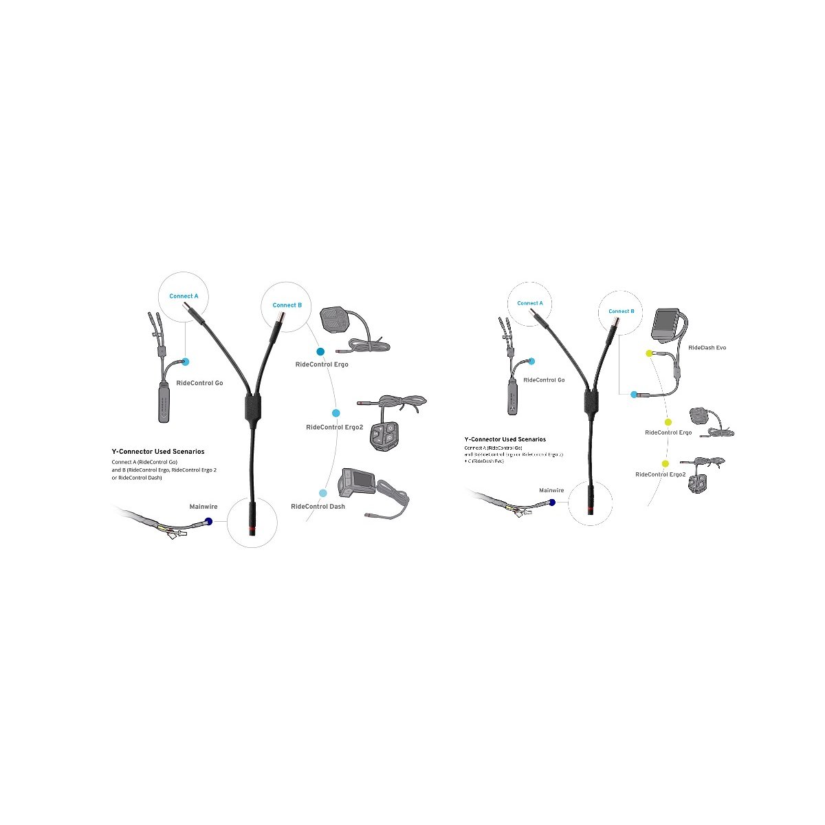

I am still thinking about going to the ridecontrol EVO or ridecontrol Dash. Been doing a bit a research. To go from the Ergo 3/Ridecontrol Go to the Ego, Ergo 2, Dash or Evo you need the Y-connector to connect them to the Ridecontrol Go. Attached is a wiring diagram. Someone asked about how to get to the wires. I believe you need to pull the battery, but I have not done it yet. Note that the ridecontrol Go has two additional wires not used in the below diagram. They are labeled Left and Right. This is where the Ridecontrol Ego 3 plugs in. You can have an Ego 3 on both your left and right handle bars and control the functions of the buttons via the ridecontrol app. Make sure you tape all connections so they don't disconnect on you.
You say still managed to get the top tube display to work. Did you have to do something special to get them to work? Firmware upgrade? Something else?

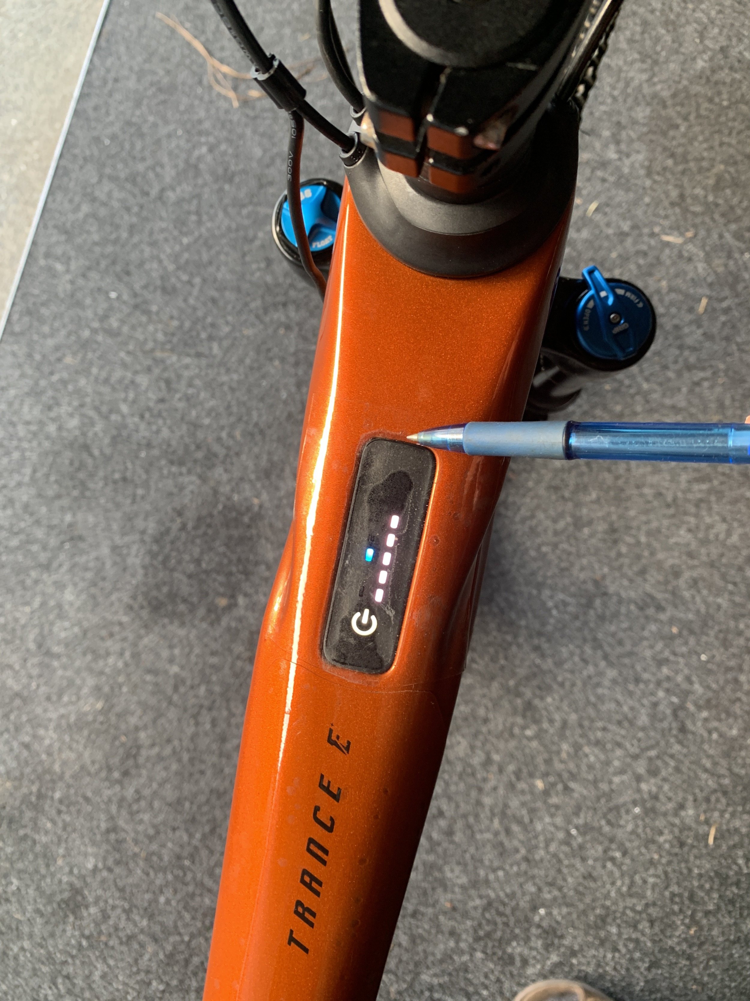

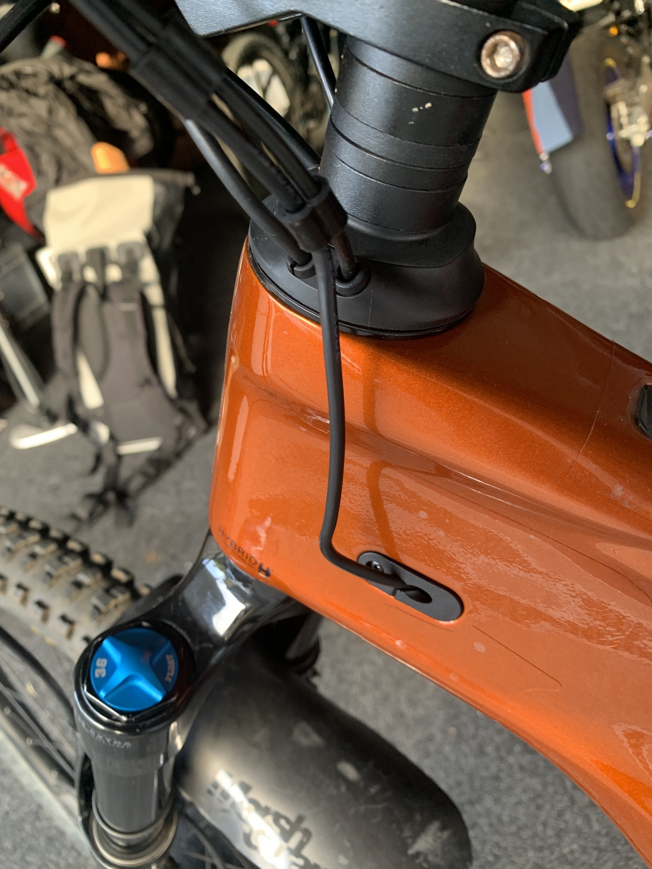

I can't remember what order I plugged the cables in. It took me several attempts but I have both controllers and the top tube display working. I put the Egro wire through the spare cut out in the side of the frame. Use a fine screw drive at the front of the display and a flap lifts up with a screw under it. Remove the screw and the display comes out and you can access the cables, no need to remove the battery.

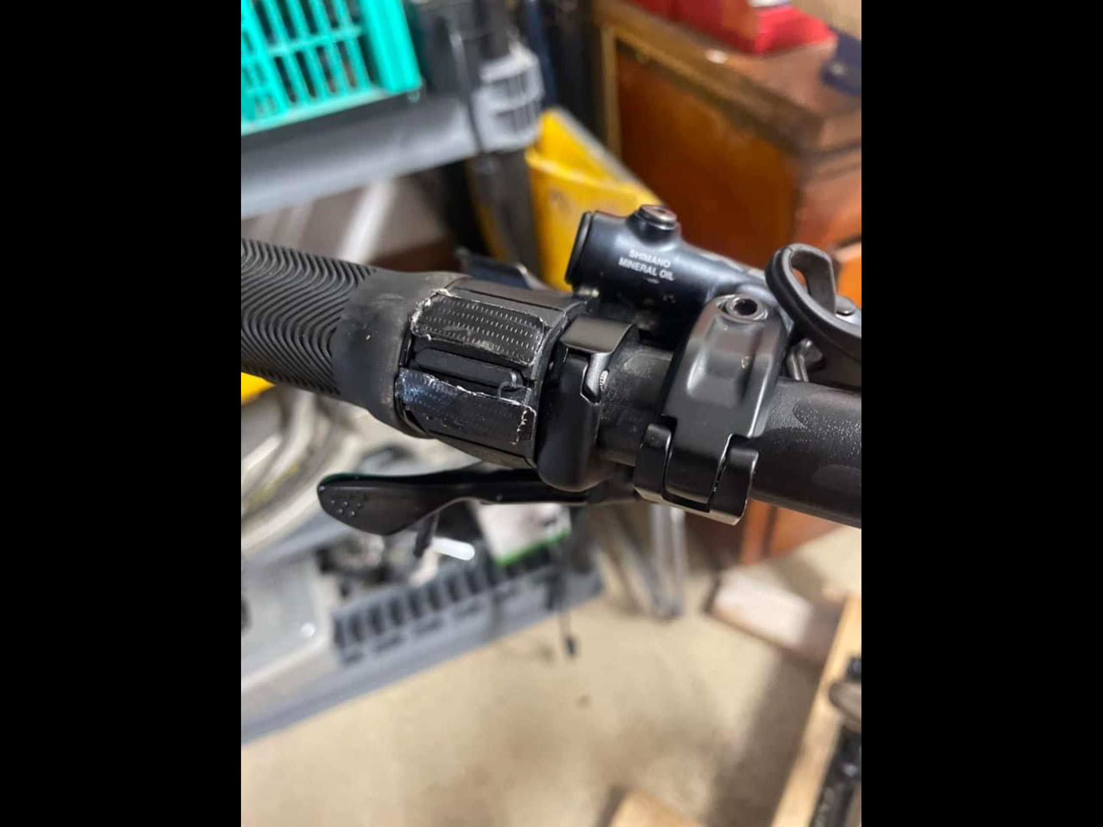

It works well, you can feel the switch and you don't have to look down. The positioning is a bit awkward because it's not designed to fit with the shimano brake lever but it's the best out there at the moment, and it's handy putting the original one on the other side. I thought about trying to fit the Trek EXE switch as that is really compact and a great feel but it uses 5 wires and the Yamaha has 6, I'm sure it could be done but beyond me.
