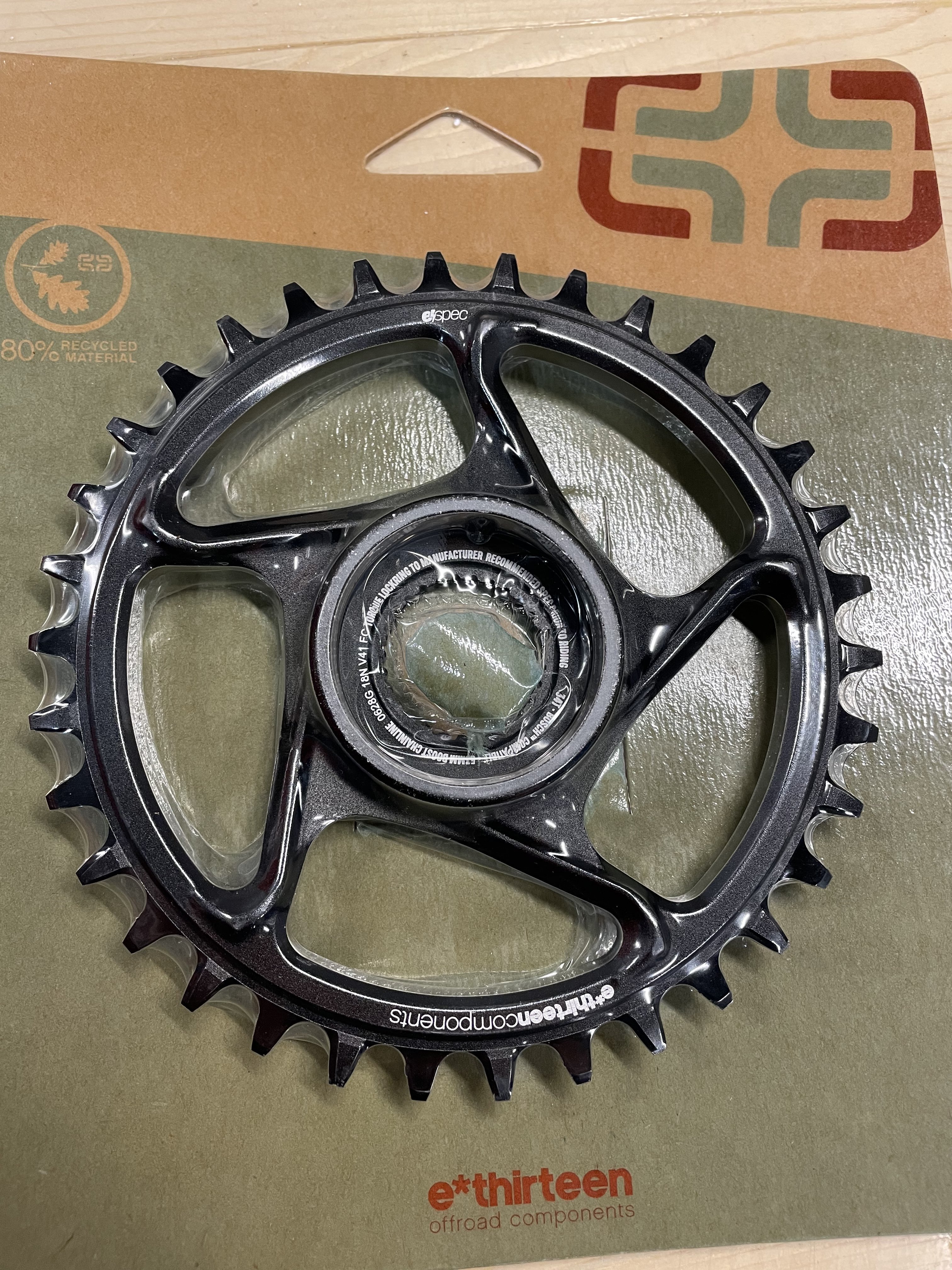

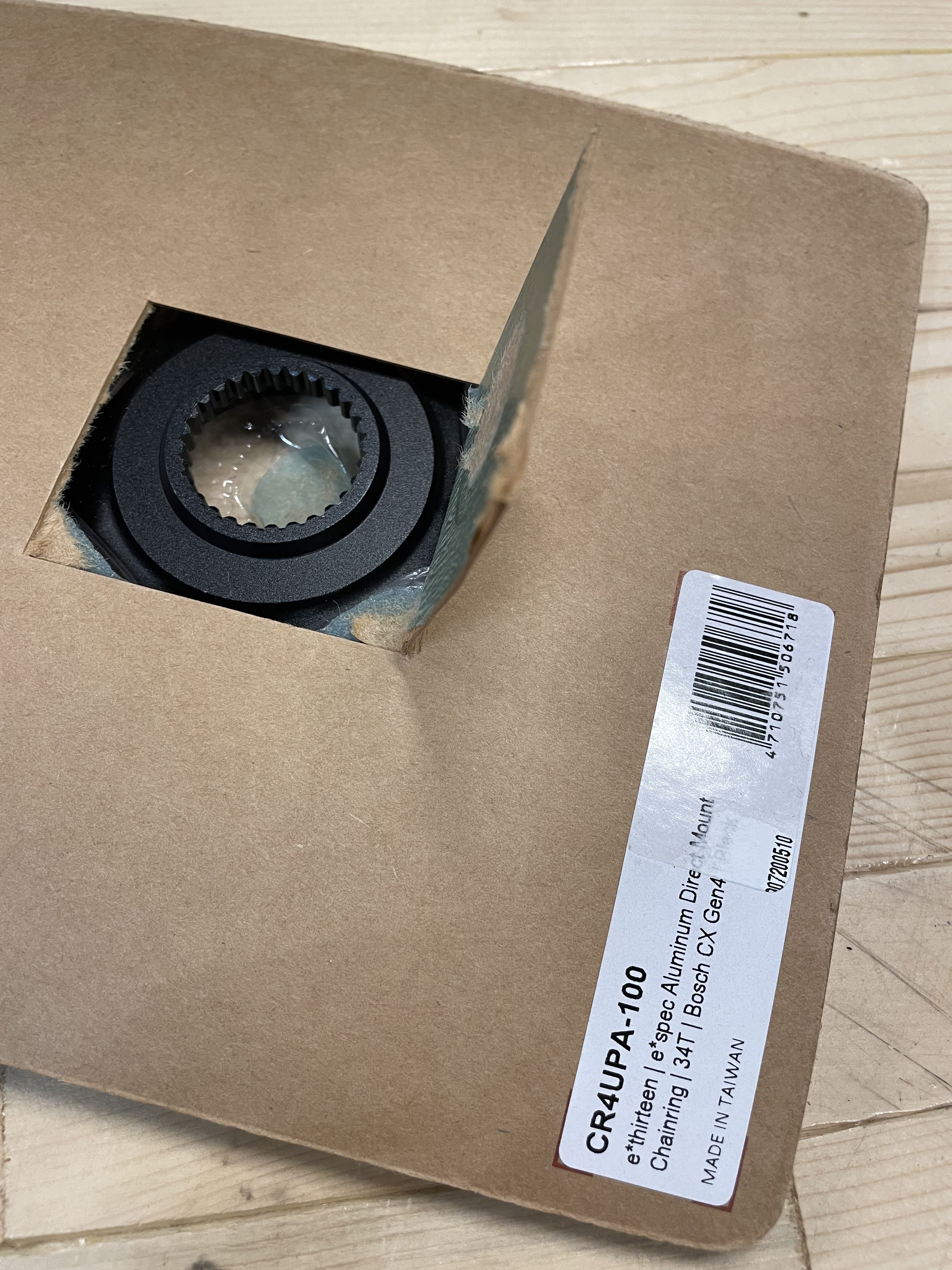

You may want to confirm this but here’s what I can remember when I replaced the chainring;
Once the crank is removed, then the spider nut, then the chainring, there was a metal “O” ring behind the old chainring which likely held a rubber “O” ring in place. With the new e-thirteen chainring the metal “O” ring may not be necessary. (See pics). If the metal “O” ring is used or left in place, the new ethirteen chainring is pushed out too far or may not be installed correctly.
I’ve used this replacement for almost a year now with no issues. I would, however, ensure that this area is properly greased and that the spider nut is correctly torqued.
Note the raised section on the new ethirteen chainring.
