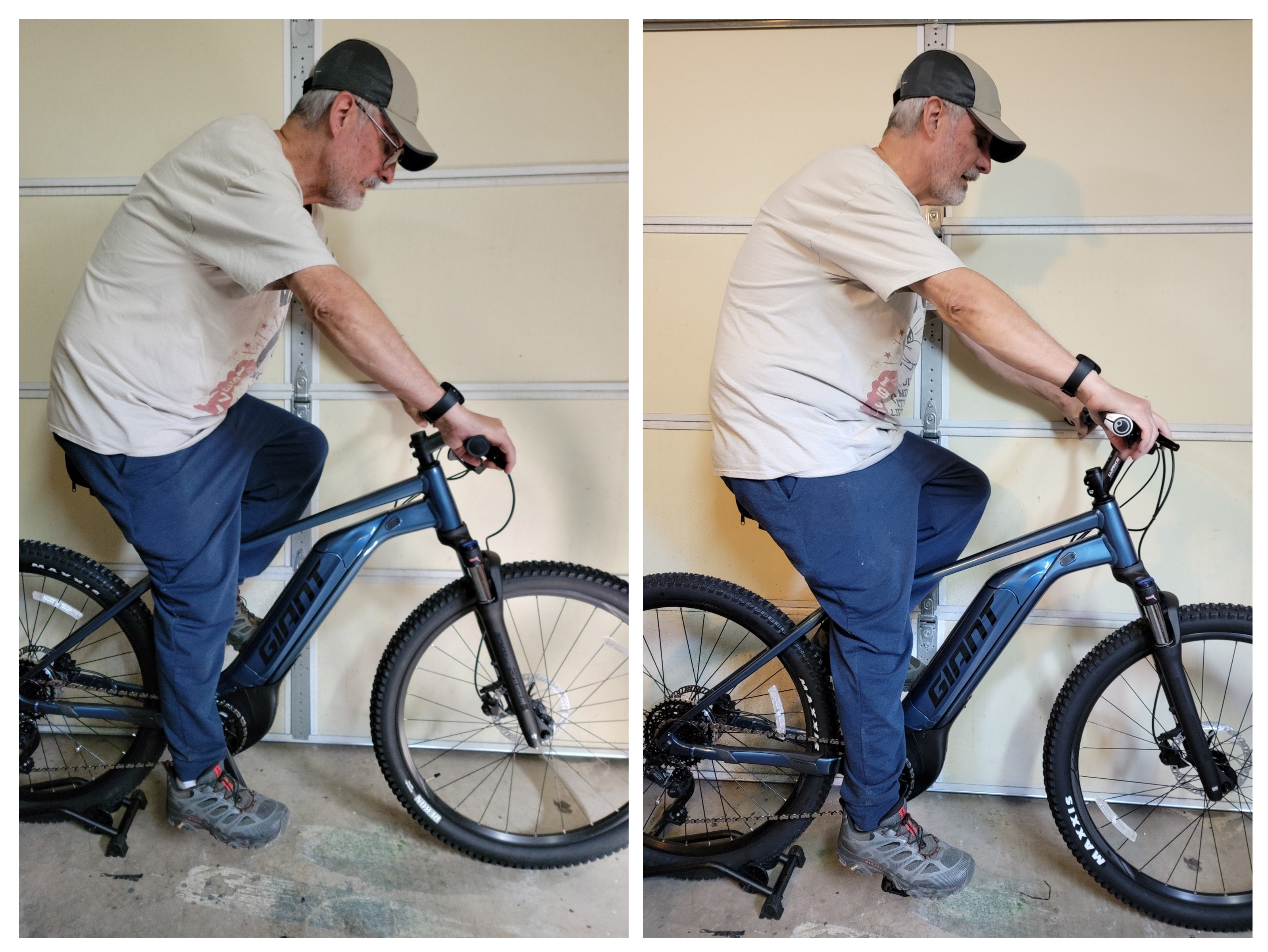

............one tuning aspect I forgot to include a bove ( but was suggested by a couple of folk earlier in the thread) is saddle position. I was amazed how much difference both saddle position on its rails and saddle angle can make. It is probably also influenced by the shape of the saddle and I use the EMTB specific Ergon saddle which has a raised back section.
Moving the saddle forward not only reduces reach to the bars a little but also impacts on both weight distribution and pedalling ( obviously when seated). A more forward saddle position puts the rider weight slightly more forward on the bike which may be a good or bad thing depending on the existing position of the overall bike+rider mass of your bike. Moving it back does the reverse of course. Moving the saddle forward may also bring your hips more over the BB and that affects crank rotation by your legs.
I think all of that is fairly obvious but I was more surprised by the impact of saddle angle. If you raise the front of the saddle you tend to sit further back, if you lower the nose you sit slightly further forward. Where I found this has the most impact is climbing. One of my bikes requires me to weight the front wheel to a void loop outs but then it was difficult to maintain rear wheel grip. Because of that I tended always to climb with the saddle slammed and adopting a crouched position not sat on the saddle. I found just by titling the saddle nose up a little I could climb a lot of ascents seated with the dropper about one third slammed. On your bike it may e the opposite but certaintly worth playing with the angle especially since it can be done when out on a ride with a multitool.
I've fractured my back a few times and my right thumb twice from bike crashes (among other bones). The last time I fractured my back (2 years ago) I wasn't able to ride. I put on both a riser stem and handlebar and went on a 10 mile ride with no pain in either... Here's what I bought:

The only issue I'm having is getting the grips at just the right angle.
Someone mentioned saddle rake, and I’ve found nose-up really helps keep weight off my bars. Flat seems like I’m sliding off the nose for whatever reason and I’m pushing back in the bars just to stay on saddle. Nose up a bit seems to take that pressure off the bars just enough
