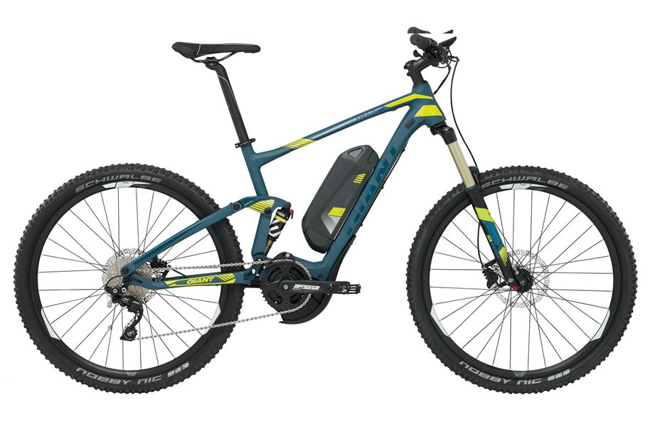

Hey Gents
Just doing a little Giant research. Is this 2016 the first release of the their EMTB?

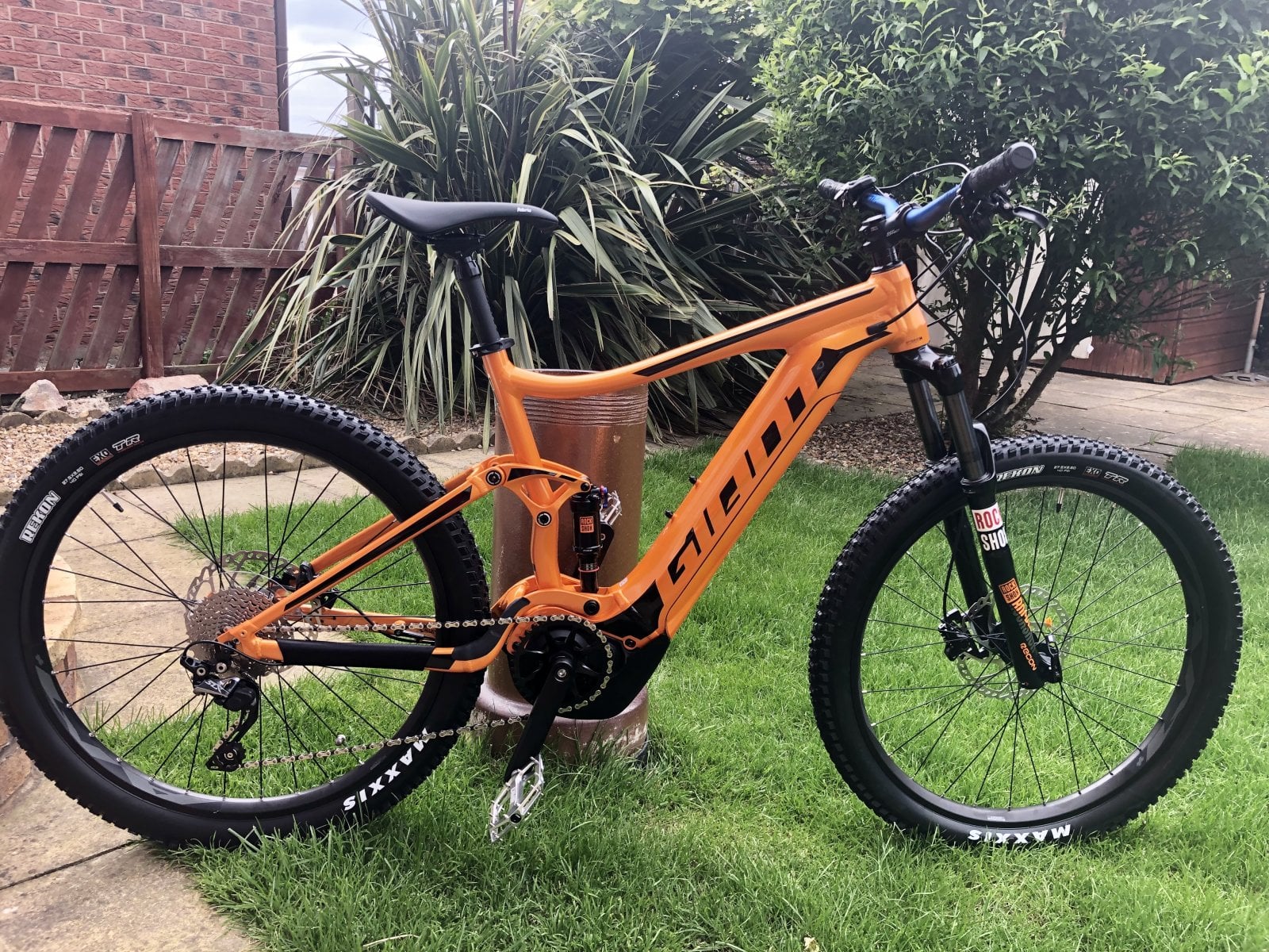

GIANT is one of the biggest manufacturers in the world that’s a fact I never knew until I started researching my fist e-bike.
I think there’s some brand snobbery in Emtb, like lots of hobbies and sports.
Had mine Stance E+1 from New in June
The bike is great at everything I want to do, it looks great as well.
Happy with the components and build quality
One minor issue with the controller, replaced by giant at my lbs GIANT dealer with no hassle in a couple of hours.
Over 300mls so far off road and no issues.
Every brand has issues and everyone posts them in forums, but you don’t hear from the happy owners.
