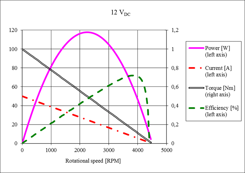

Also a bit about electric motor power and the 250W nominal power limit in the EU, as I see there seem to be some misconceptions about how an electric DC motor works and how the 250W limit is imposed on manufacturers.》》》》
The power output of an electric motor is a complex measurment:
P(Watt) = V(Volt) * I(Ampere)is only true in special circumstances eg when the load is a resistor.
It is not true in cases of an electric motor, whose real output depends on its Q factor, switching control, load etc.
This is because a motor gets pushed around its axle by solenoids, whose voltage across their terminals varies with time, the intensity of the current flowing through it is also a function of time, the output power is also a function of time with more variables than just V (voltage) and I (current Intensity).
Each function has also its harmonics, the resultant P is a complex function and it can be only measured in a lab environment.
The power is usually measured while the motor reaches its thermal equilibrium in a room at 25°C. Then there's also the factor of internal transmission that needs to be taken into consideration when looking at the final crank output numbers, if you look at some test diagrams from a german test lab the real crank Nm outputs are far lower than the speced motor are...
Also as I see a lot of people are confused about the 250W Power limit in EU, I did a little bit of online research about the European legislation EN15194, it is the standard that is most commonly applied, so maybe the bottom description will clears things up why such differences between brands.>>>>
There's effectively no limit in the European legislation EN15194, which It's all about the words and test methods, neither of which pin it down. The rules are that the manufacturer must not label the motor with more than 250w and a motor with a 250w label mustn't overheat when running at 250w continuous. You have to be careful about terminology and calculations. If you have a 20 amp controller and a battery at 40V, you can take as much as 800W from the battery, but at the low speeds where the controller will allow that current, efficiency will be as low as 25%, so the output power will only be 200W. When the motor is spinning fast enough to reach its 80% efficiency, the back EMF from the motor cuts down the current, so the maximum current from the battery might only be 10 amps max, so output power will be 10 amps x 40v x 0.8 efficiency = 320w.
From the attached diagram it can be concluded that the maximal torque of the motor is at very low speed. This is advantageous because it gives very good starting behaviour, but also means
high values of the current and the efficiency is small. So we have to deal with heating problems. The power reaches its maximum at the midle value of the speed, but here the efficiency of the motor is still very small and the problem of heating still persists. The highest value of the efficiency is at 4000 RPM close to the maximum value of the speed. This could be a good operating point, but here both the torque and the power of the motor are rather small. There are also some mechanical constrains to be taken into consideration. The shaft speed of the DC motor is 4000 RPM. This corresponds about an 80 km/h speed of the vehicle if the shaft of the DC motor is connected directly to the shaft of wheel. At a such kind of speed the power need to drive the vehicle would be much higher than that DC motor could deliver, that's where the internal motor transmission comes into play.

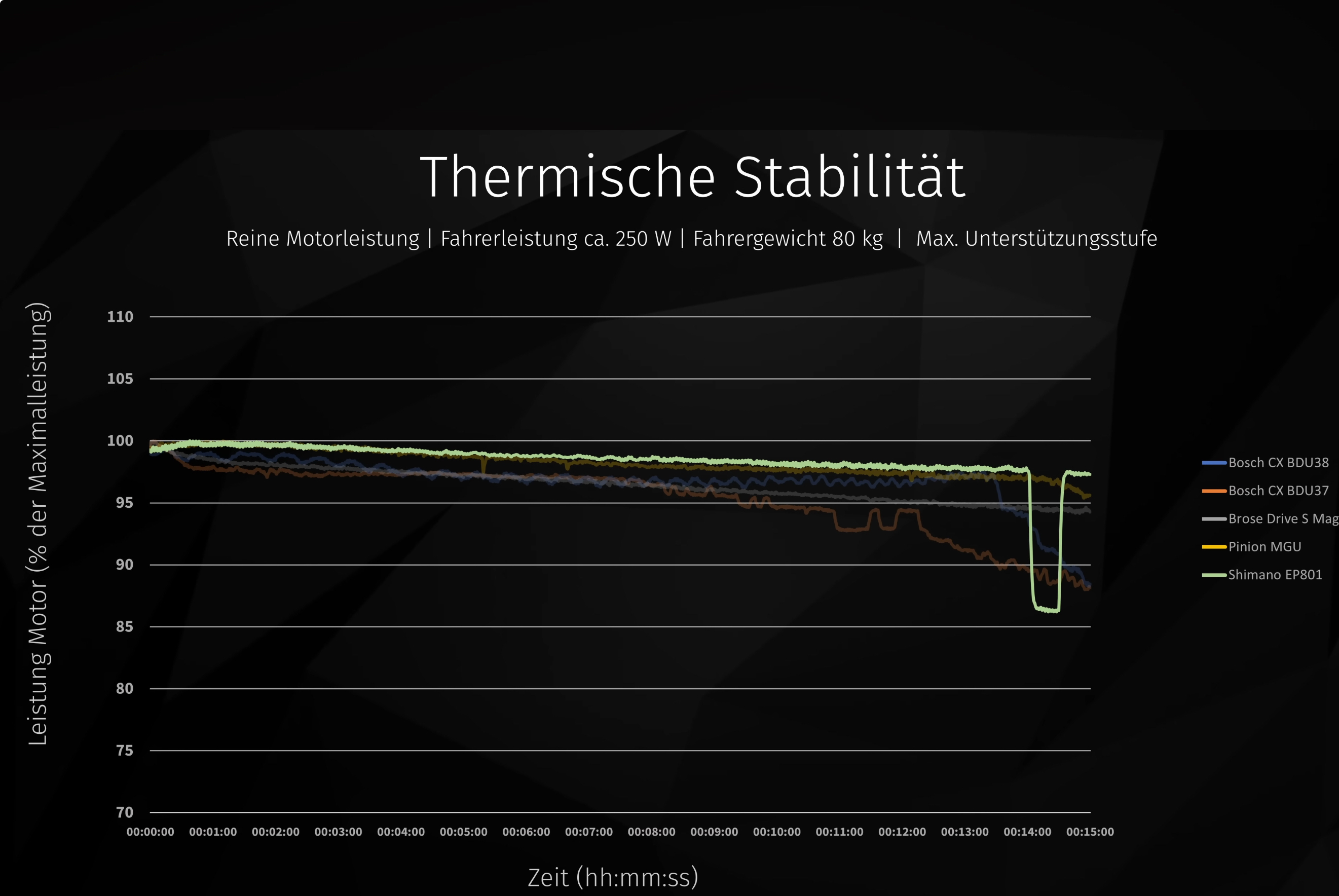

Just out ofcuriosity as these things interest me, I am still waiting to see what a real lab test of the Avinox will show...the mass of the motor is small, so thermal stability is a question here...

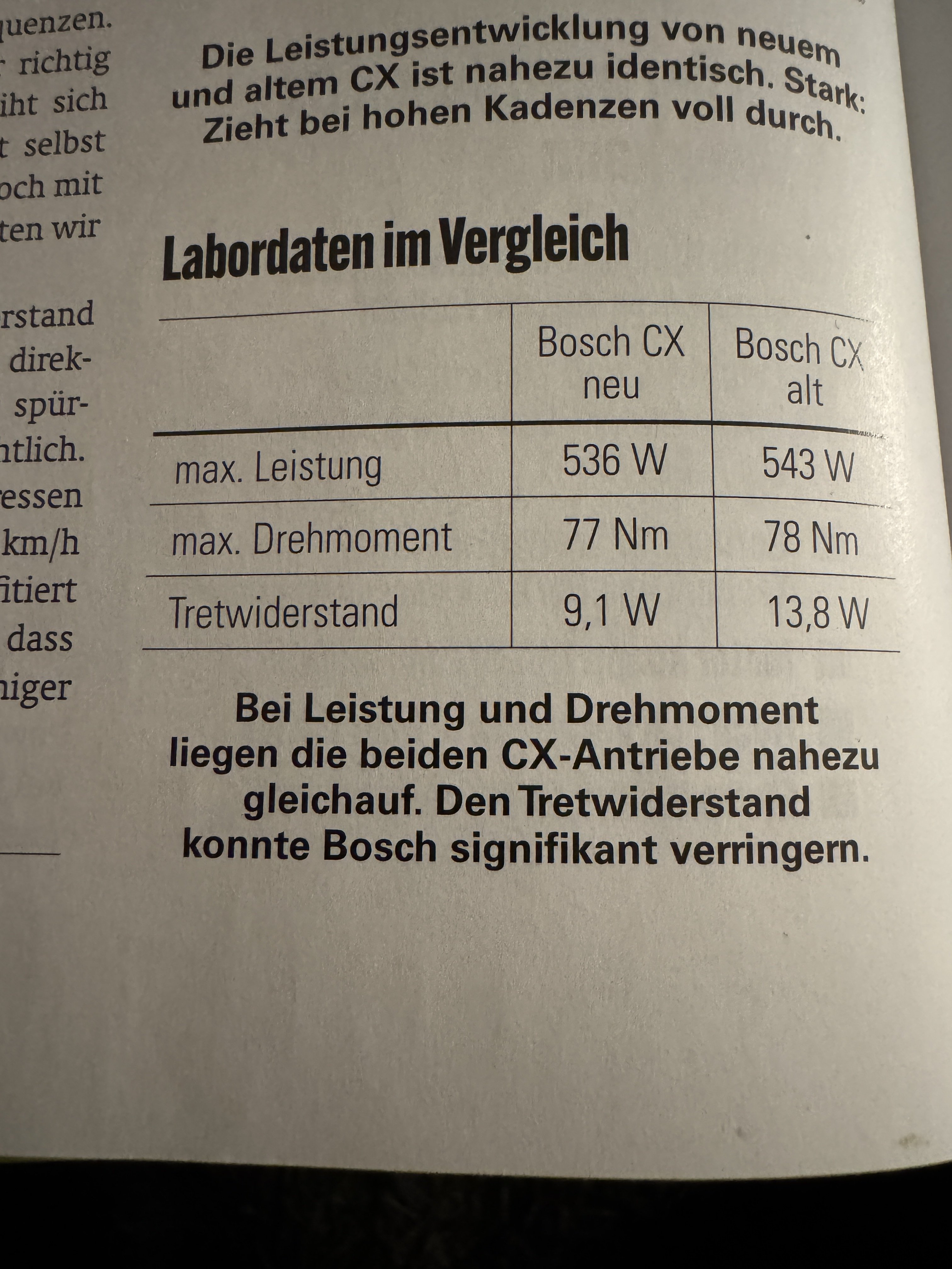

Everyone thinks the new Bosch BDU38 is a miss, I don't think so, I think this motor is just a base for the next step.

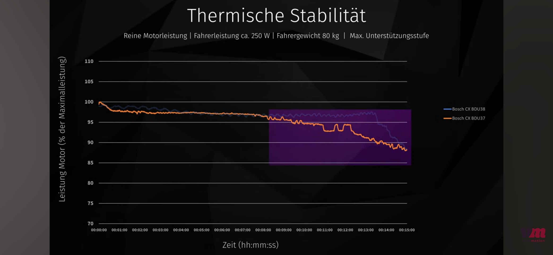

The most interesting improvement i think is that the Bosch gen5 has a significant improvement in the thermal stability area, it's thermal stability was high before but now it's really high and longer lasting as can be seen in this diagram.
Derating starts massive after 13 Minutes, this is no real benchmark , how many steep HM can you go in 13 Minutes?. The test ist done with an uncovered Motor with a big fan below. Something that is not happening in reality (Velomotion is only doing that, to have a neutral view for comparison, not being affected by different frames or covers)
Gen 5 falls down below brose after 13:30 minutes rapidly and is below Pinion.. so don‘t know where you base on the „thermal stability“ of Gen 5

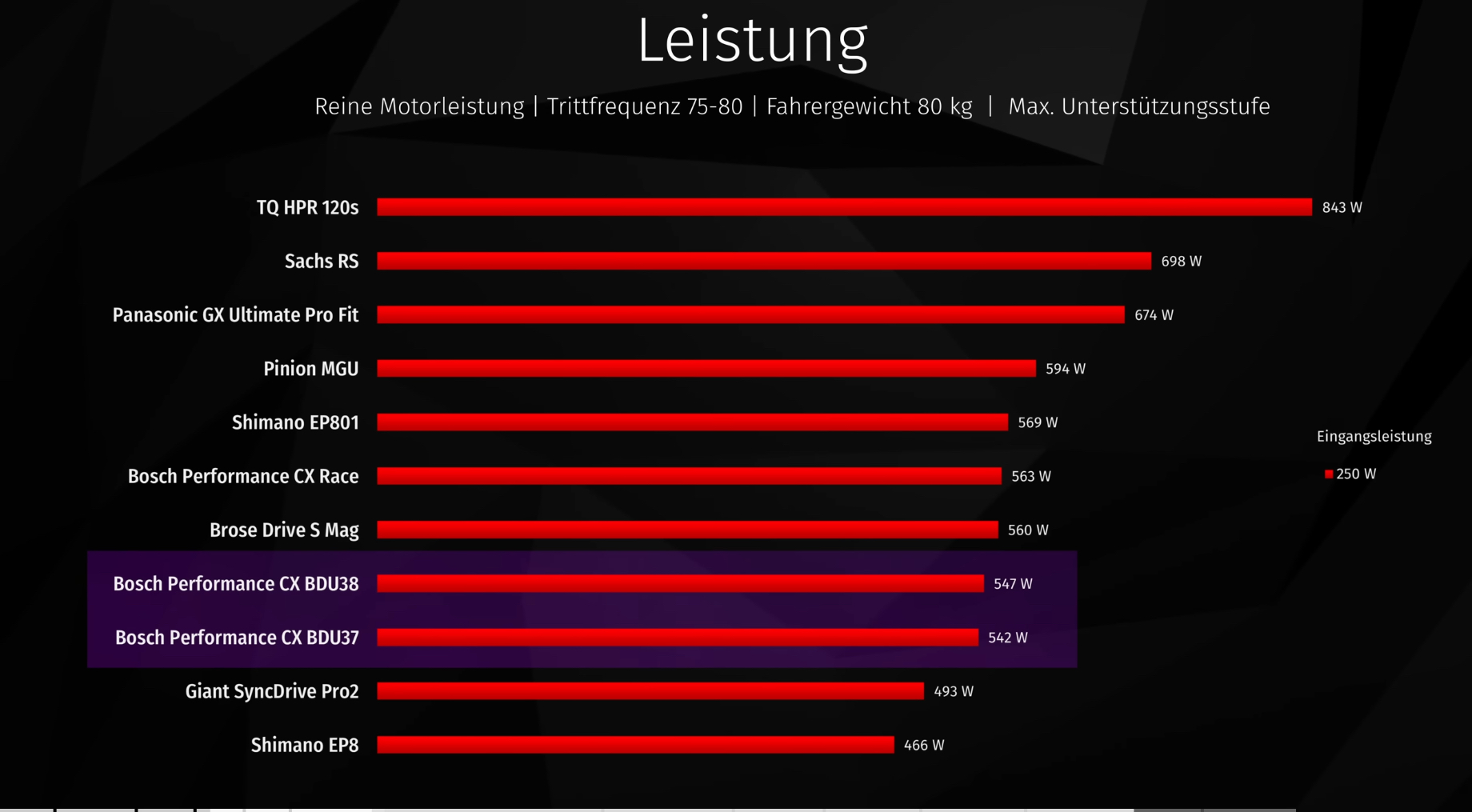

Two test benches, nearly same results input 250 watts.. So Bosch above 600 watts peak seams to be a fairytale

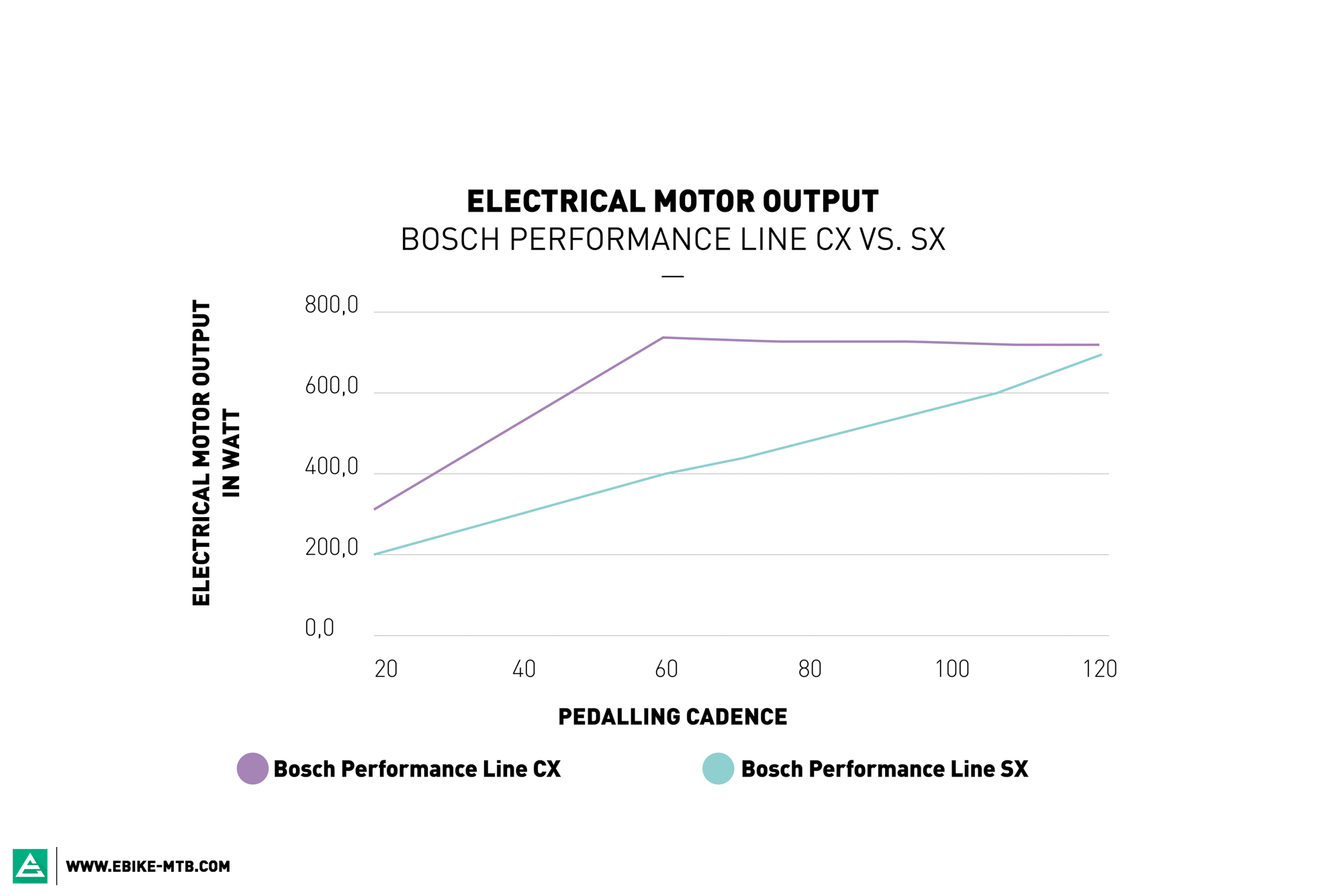

Does seem to depend on the publication though, as Ebike-mtb's testing shows a different result. Unfortunately I don't speak German so it's not easily for me to follow exactly how they do their testing, so maybe the testing method is different, giving different results. I do see in the comments though they are planning on testing the DJI soon, so it will be good to directly compare results to the Bosch along with the thermal tests they do.
Does seem to depend on the publication though, as Ebike-mtb's testing shows a different result. Unfortunately I don't speak German so it's not easily for me to follow exactly how they do their testing, so maybe the testing method is different, giving different results. I do see in the comments though they are planning on testing the DJI soon, so it will be good to directly compare results to the Bosch along with the thermal tests they do. View attachment 148546
Is it that one is measuring Electrical output and the other is measuring mechanical output at the rear wheel?
To my understanding ebike-mtb is measuring electrical output and the others mechanical output at the chainring.
In their technical data Bosch states 600 W max motor power for the CX motors measured at the chainring.

Yep u are right they are different, are u surprised, well I am not.
Do you know each test bench standards(cadence, test duration, input power, tires, bike gearing, point of measuring(wheel or crank), is it electrical or mechanical power, weight, room temperature, etc..., most probably they aren't the same...
Yep the Brose almost doesn't derate, why don't you tell the reason also (it's in the video) let me say, because it has set an extremely high temp limit(can confirm myself) riding along my budy his levo motor heats up all the way to 89°C(we checked in app after a 1000m average 9% climb)...you could fry an egg on his motor.
From my understanding ebike-mtb power figures were either at the wheel or tested at the wheel but then because they calculated for drive train losses removing them in their figure. I'm not sure which one they are referencing for there figure though. I don't know what the German testers use, maybe they are quoting at the wheel with losses and thus the large power loss? Here's the quote from the ebike-mtb site:
The laboratory test procedure​
There are different ways to test motors. For us, there was just one option worth considering: to test the motor system as a whole, i.e. in a complete bike, because that is the most realistic. And we were able to do just that at Velotech! Below, we’ve outlined the lab test procedure for all the nerds amongst us.
To prepare for the laboratory tests, we fitted all bikes with control tires running identical pressures, checked the drivetrains, and lubricated the chains. As a result, the energy losses incurred by the rear wheel and drivetrain should be similar. Then the bikes were clamped to a test rig, which looks a little bit like a large, industrial roller trainer, with a roller resting on the rear wheel. The cranks are turned by an external motor, with a continuously variable speed and power. The speed and power of the external motor simulates the rider’s pedalling power and cadence. Drivetrain losses and rolling resistance can be calculated and accounted for by pedalling the bike with the motor switched off at a certain input power and then measuring how much of that power is transferred to the roller. For practical purposes, however, it’s important to understand that the actual mechanical power put out by the rear wheel is what counts.
First, Velotech project manager and physicist Florian Edelmann helped us determine the power and support ratio of the motor. To do so, the pedals were turned at a fixed cadence while simulating a linearly increasing rider input power, allowing us to measure the electrical and mechanical power. We also had the motors in our eMTB motor comparison set to the highest support mode. Why? Only the highest mode is comparable, because this is where the motor performs at its maximum. All other modes differ from manufacturer to manufacturer, or may be tuned by the bike brand, and therefore don’t allow for an accurate comparison. In addition, the various modes offer numerous customisation options, which makes them even less comparable. The power curves we obtained during this test provide information on how much the electrical and mechanical power output increases, what the ratio is between rider input and motor output, how many watts of rider input are needed for the motor to unleash its maximum power, and, finally, at what power it reaches its limit.

I’m still riding a Kenevo with SMag and the derating Strategy Starts much earlier (1st step around 70 degrees ) than at 89 degrees in several steps and you can feel it significantly . I didn‘t write that the Brose isn‘t derating. I just showed up that the Bosch is not better than the others. Hence not having more power than species. Hence no “derating reserve “ to be pushed to 100 NM or 700 Watts.
As I’m a real heavy rider I get every motor in Derating.. and 13 minutes are a joke in any way

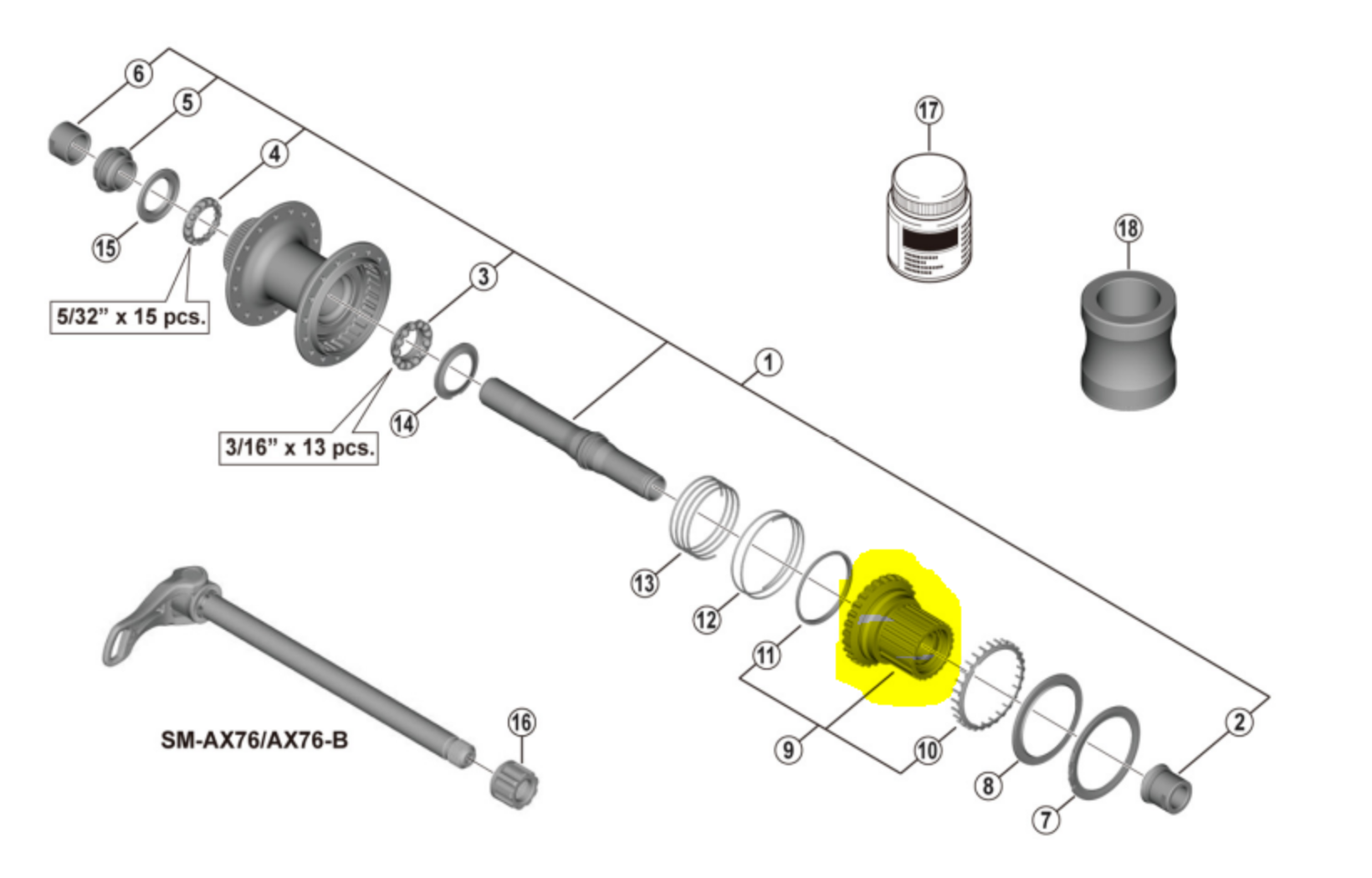

I'll do better than that. I'll provide you with an exploded drawing. It's a Shimano SHIMANO SLX M7110. I've highlighted the hub.
If you knew of a HG hub that is that shape and fits. I'd really appreciate it.
