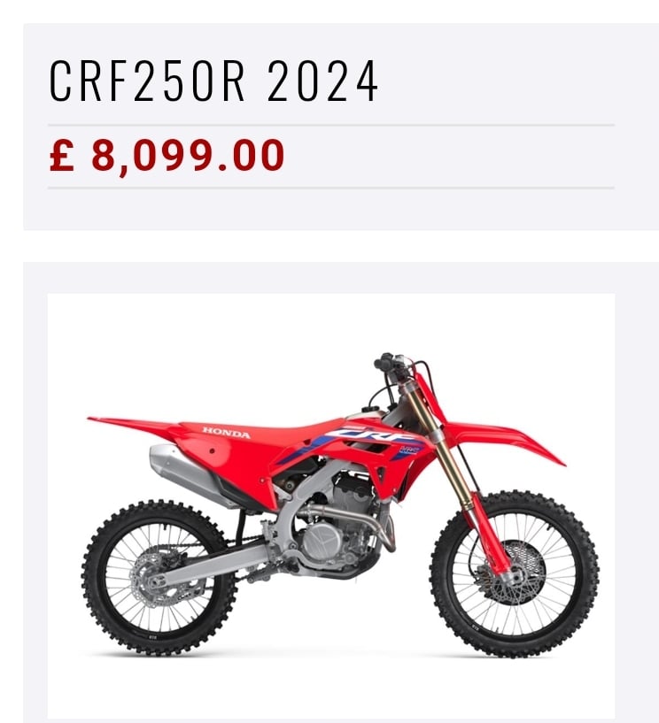

I have been more wondering how no brand has managed to seriously undercut the competition. These are bicycles, not cars, and yet a bargain e-mtb costs $5k?
Plenty asking the same question . . bicycle £10k, motorbike £8k

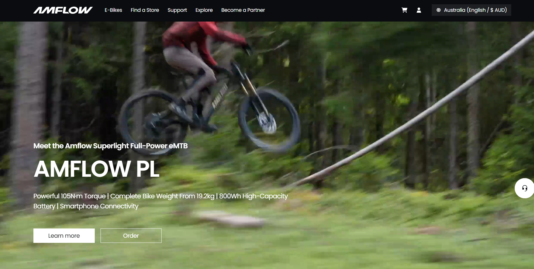

Is doing jumps at all considered not covered,
They have guys jumping the bike on the website home page video. This would make the case that these smaller jumps are within the bikes normal operation. Otherwise they would need a caveat saying that what is being shown on their website is not allowed.
In Australian consumer laws. You cannot show the bike jumping as your advertising. Then claim it's not allowed, unless you have fineprint on the video, saying the advertising is not what the actual bike can do.
