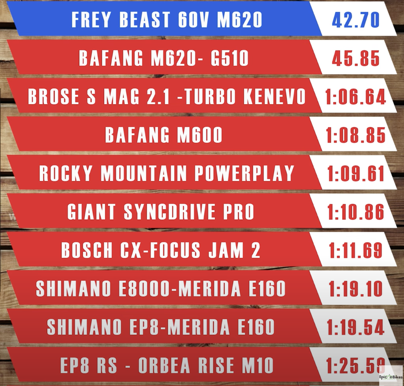

Amazed at how much quicker that DJI got up the ill compared to the Bosch, if you look at the results of similar tests done by Epic Ebikes, the DJI is on-par with a Bafang M620 when comparing performance gains over the Bosch
