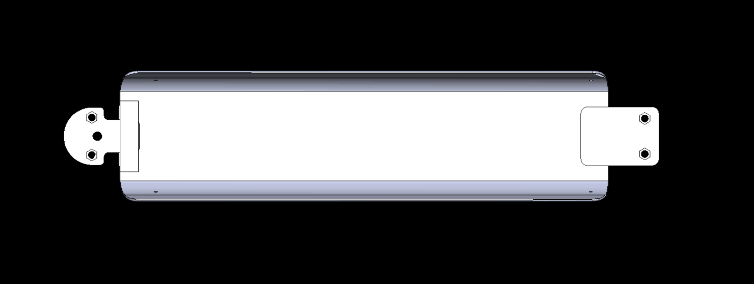

Bafang BTF03 cover modified to use with DIY battery. Files need to rework, Done lot time ago and i don't find other, sorry. I hope that could help somebody. if somebody want original file.stl or STEP, send me mail address in private message and i will sent it Battery cover-1.jpg
I just found it's not necessary to change the file extension to share it. the compressed file (.zip) can be uploaded directly here

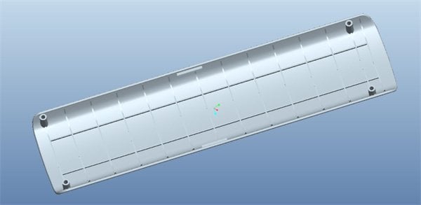

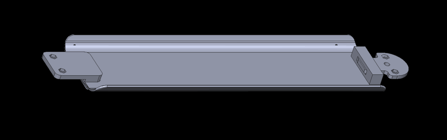

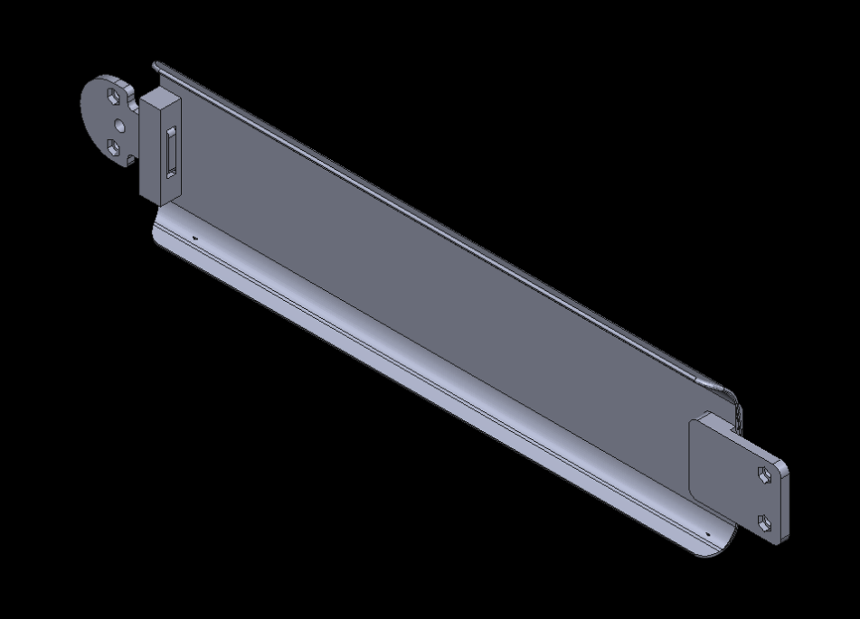

LCES004 BATTERY HOUSING COVER
Made by @merc123123 (Thanks to him)
merc123123 comments:
"I did modify the cover to be correct since printing my version because I noticed that the opening curvature is not symmetrical, but it still fits ok as is in my version and I don't want to spend another 8h printing it the correct way.
In the files, you will notice space to press in M4 nuts (heated with a soldering iron) and they attach to the frame with M4 screws lengths around 13-15mm. There is also an M6 bolt, just screwed in the upper retaining "lip", so that it can be manipulated from the outside locking the cover, before being screwed to the frame holes."

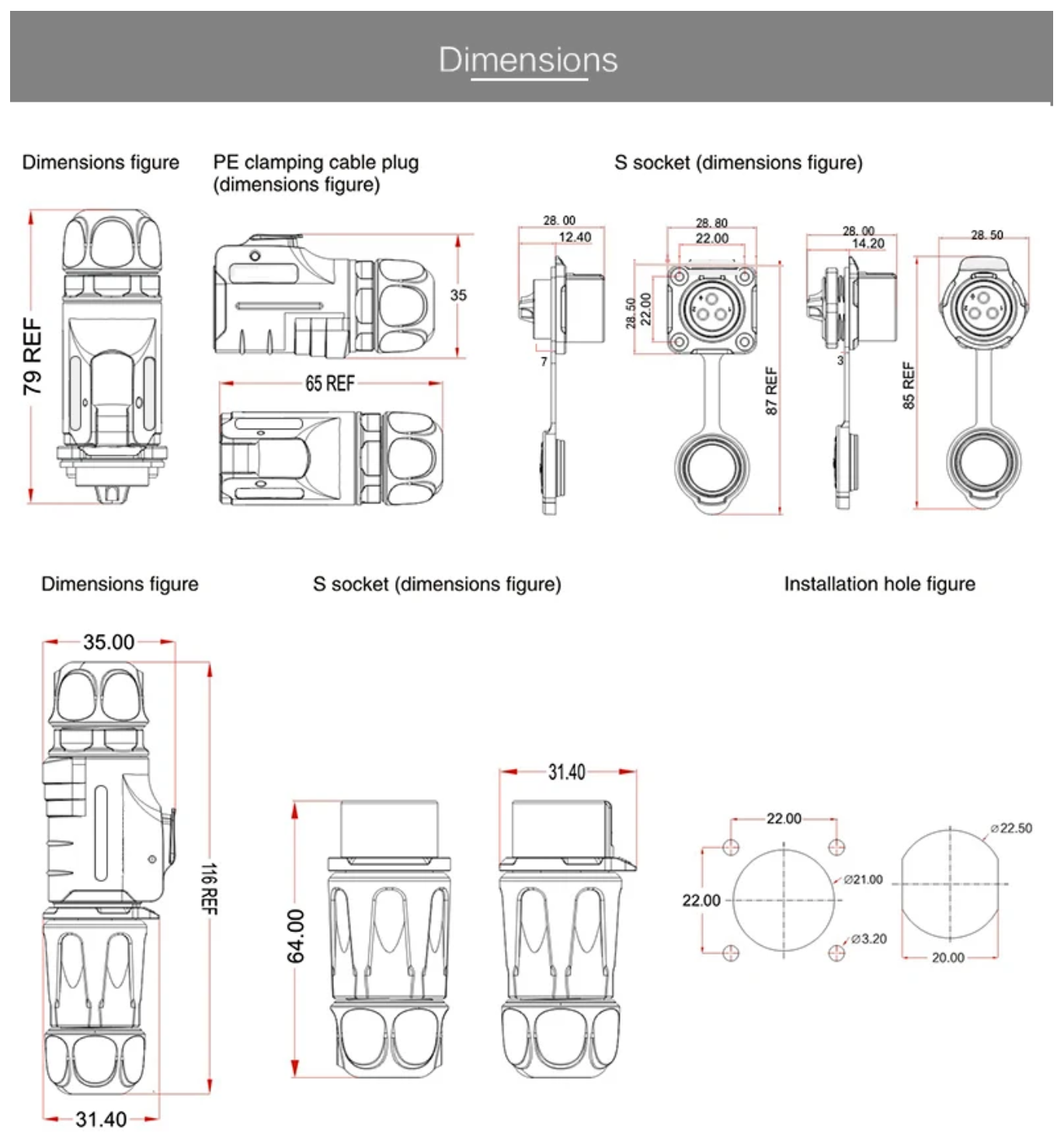

I have not checked the dimensions of the file but I suspect the Jellyn XHE20 might well fit into this. I am not sure if it will protrude too much.
