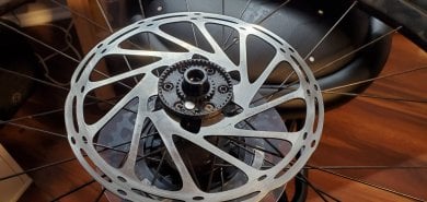

Not a new idea, there are a few other designs out there that do the same. However, having access to CAD and a 3d printer, I decided to make yet another one and make it available to others for free. I took it out for a 10 mile ride today, and while I did not get to speeds higher than 20MPH because of the trails, I did notice at the end of the ride that Mission Control only tracked 5.XX miles instead of 9.XX miles, so it tracked the reduced rotation of the magnet and it didn't fall apart, so that's a plus! I will try getting it up to speed tomorrow to test the higher speeds.
I printed the parts with Nylon, but the gears themselves don't have much force/load on them, so maybe other filaments would be suitable.
It's still a work in progress and there may be some changes, I just got the bike this week and wanted to get something on ASAP.
This is for the 2020 Levo Comp. You can find the files here: 2020 Specialized Levo Comp Speed Limit Remover by usmc59

View attachment 25618View attachment 25619
Awesome , keep us posted if you make any improvement/ change to the design . And a big thank you for sharing it for free
Was able to get it close to 30mph without having the motor cut off. Very happy with the results, no more dragging the anchor.

However, @LD.MTB - nice work! It looks like you actually have involute splines and everything. Far better work than the LSS ever was. Module looks slightly too big, so your planet teeth are rather undercut. I'd say remove 1 tooth from the planet and use a small positive profile shift coefficient so the planet's teeth get wider, but since the module is such that you have only 12 on the planet, it might just be a better idea to use a next smaller module and then remove 1 tooth from the planet & shift the profile. It'll just be more durable and look more "natural".
