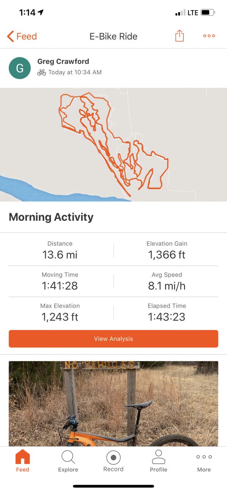

I was really hoping to put my Rance E+ 1 Pro to the test yesterday. I was taking it to the most technical trail that was close to me and I really thought I could get for laps on one charge. Long story short, my battery died on a shortend 2nd lap at the base of the last hill clim “called cardiac hill’. I’ll copy and paste what I posted to some friends. I’m now either going to have to buy another battery or make a switch to a Levo with longer range or a Trek 9.9 Powerfly since my girlfriend rides a trek and I could use here battery when she doesn’t go with me.
This post will be for my MYB buds.
Kinda a disappointing ride today. I had plans to put my GIANT E-Trance EMTB to the test. My goal was to ride 4 consecutive laps at Horizon on one charge. . Based off my rides at Fall River with Stef, I figured I could easily ride 2 laps each on the north and south trails there so I figured 3+ laps at Horizon wouldn’t be an issue. Half way through Lyles Loop I was reminded how demanding that place is for not only man, but machine. I did all of the main trials but I did end up riding Butt Crack instead of the reroute. I rode the “fairly new trails” going up Cardiac and then skipped out on the North Woods. I had to put a little air in my rear tire because I got a small cut just after moonscape but the sealant worked so I didn’t have to stop long. As soon as I started my 2nd lap, my battery dropped from 3 out of 5, to 2 of 5. I was riding in the 2 of 5 mode 85% of the time and the other time I kicked it up to 3 on some of the steeper climbs. I knew I wasn’t going to make it a full lap but I was going to try. I cut off the reroute right after Lyles and dove right into the old trail. Rode everything else but when I hit the river bottom, I took a right and and only rode the 2nd half of it towards Cardiac. Made it 1/4 the way up and I rode all the juice out of the battery. Nothing like being at the bottom of Cardiac on 50 lb bike?.
Looking back at the Fall River ride, I rode the exact same amount of time and still had over 50% left before I slit my tire. Kinda bummed I wasn’t able to ride longer at Horizon. I’m sure it was the difference of the terrain and riding pace. I’ll head to Fall River next week and ride until I completely drain the battery and see how it stacks up.

14 miles and 1400ft of climbing? Loads of people with the new Giants have been getting extremely good range, so either you have a problem with your battery or it wasn’t fully charged at the start.
Someone on here had an issue similar, then realised there is a button on the Giant charger that charges the battery only partially for long term storage. My money is on that. Time to read the manual! ;)
Wow, that seems very short on range - A bit of a surprise as in other threads people are raving about the range available with these bikes - e.g. 25 miles and 4000’ of climbing with 40% + left in the battery. Is it a new bike, as maybe it has a battery problem.

It was my 4th ride but my first with that much climbing. When I started my Giant app, it did only show 93% charge which was weird. I did have 90 minute drive in 30 degree temps so I figured the cold weather effected the battery.
