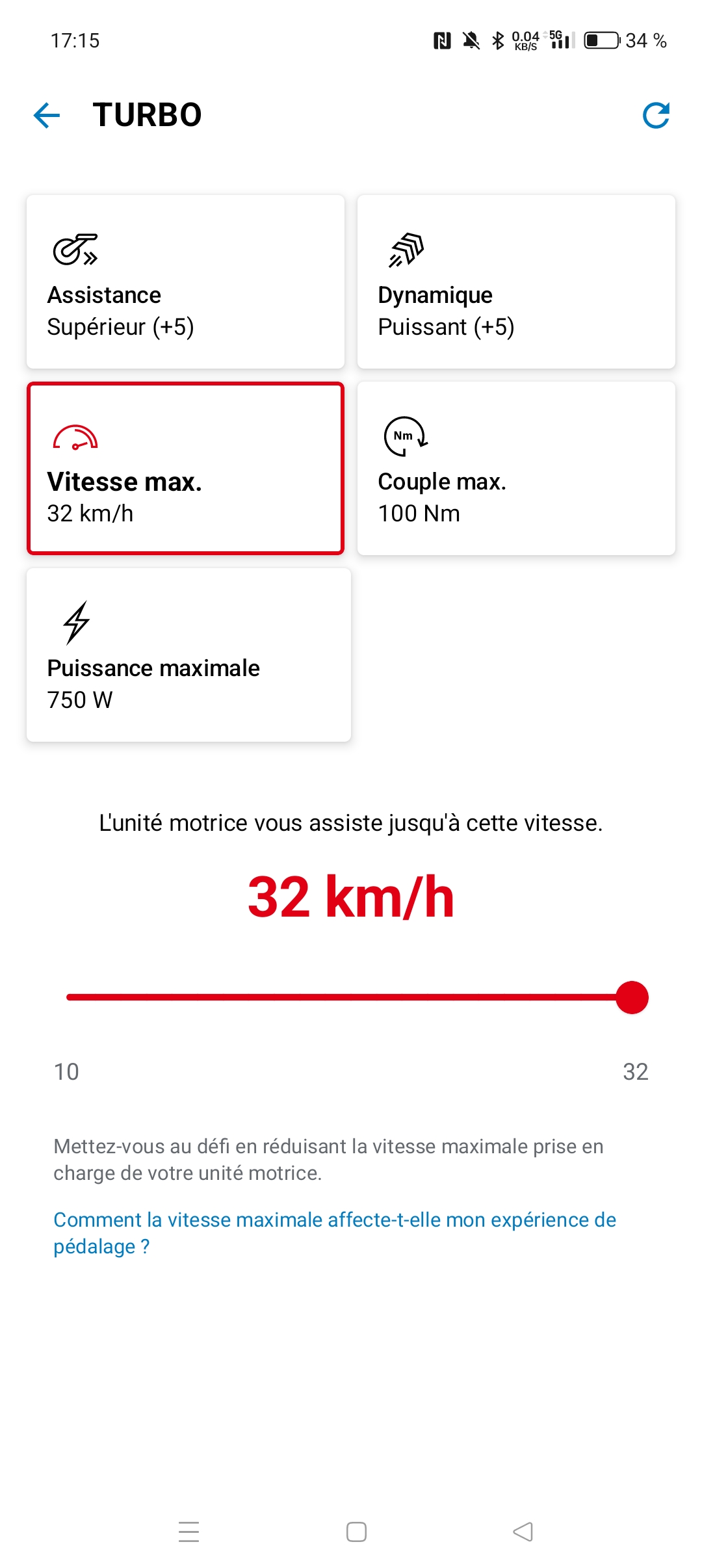

I mostly ride enduro and 32 km/h is immediately noticeable, the ride is much smoother, it's more natural, a big difference and I'm finally satisfied :)
Of course, you hit the limit early on the road, the engine has power, but for my riding there is no need to go faster

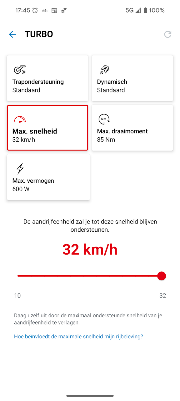

I test drove the US firmware yesterday and it was such a pleasure not to experience the abrupt disappearance of support at 25 km/h
I just test drove mine around the local urban city centre area and it's so much better :D
Mine seems to cut out at 19.6mph / 31.54314 kmh
Motor feels exactly the same as before just faster.
but I easily hit 21mph when doing a gentle sprint to pick up speed again.
Huge time saver if you use your bike for anything else than mtb trails
even on trails it feels so much better :)
I'm not saying I wouldn't like 35km/h, but we have what we have :D

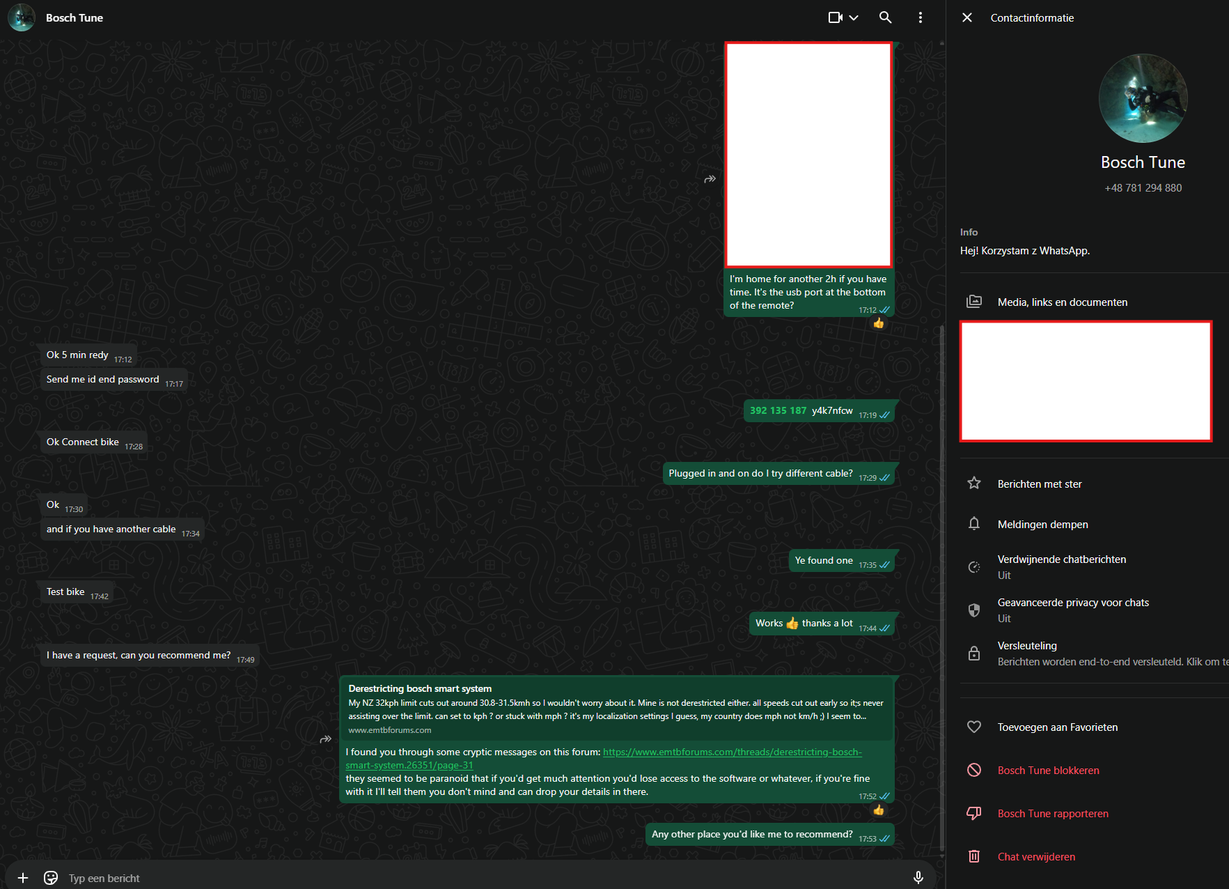

For me, sending €180 worked out at about £161. In my Lloyds banking app there are two fields for international transfers: one for your local currency and one for currency you select. If I choose to send in euros, I type in 180 in the euro box — The local currency will auto-fill. There’ was no sending fee with Lloyds, though the exchange rate likely isnt the best.
When I sent the money, the app said it wouldn’t process until 6:30 am. I then got a text around 10:30 am from him asking for my full name so he could confirm it was me (his bank shows him the sender’s name). After that he told me he could do it in 2 hours time.
I had my PC and bike ready a few minutes early, messaged him “Ready when you are,” and he started straight away. (you have to tell him the ID and password that teamviewer randomly generates, when he disconnects the password auto changes on it's own, but uninstall teamviewer anyway as you no longer need it)
The whole process took about three minutes. The longest part is downloading the ~700 MB Bosch diagnostic tool. He leaves it installed, and you can switch the language to English in the options. You can’t do much with it yourself, but it shows the same reports a dealer would see — with loads of hidden details you don't see in the flow app.
all the light ports on the motor are turned on with this firmware as well, so no issues with hard wired lights if you have them.
the actual flashing of the bike took maybe 30seconds, about 5 seconds for each component, with a few pauses as it went

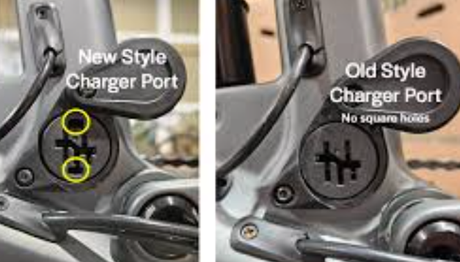

for power more I think your bike need the new style charging port.
maybe you can switch out the old port IDK, it looks like you can buy them, obviously the motor will be exactly the same, it will just be the cable the battery plugs into and running o the charging port, seems they come in different lengths.
you might wanna 100% check ther's no other cable to replace but I don't imagine there would be, it doesn;t put extra power through, just gives higher capacity..
Do you happen to know if it's an installer? I'd let him do it on a vm just because I'm paranoid but I suppose it could also be useful to have myself.
He installs these, both downloaded from google drive, it's the obvious method to use though and doesn't mean they have been tampered with, obviously it doesn't rule that out either.
Nothing on my end suggests they are doing anything.
The bosch app runs 2 services in the background
but they just seem to be standard crap and you can goto services and disable them anyway or set them to manual start
The actual config file must be on a USB on his end, unless bosch use some kind of USB FOB stick for protection and he has to share it and make it look like it;s local on your machine.
If he was doing something weird he wouldn;t say "download teamviewer" he would give a link and tell you to download a trojan version of it instead that hides as a service in the background and doesn't let you know if someone is connected
instead you download it yourself from the official site, he never gives you any links, just says what you need
which is install team viewer free and don't bother making an account.
and install the vpn in its settings
don't touch anything else.

my bike says power more ready, after the flash, but I still have the old socket.
seems you can buy the new style socket though, the normal battery end didn't change ? just the charging plug where the powermore connects as far as I'm aware.

Cheers, I know who/where and about the process from a different forum I frequent , so that's not an issue :)
The question I really wanted an answer to was about the firmware installation:
is he like using a VPN or does he have an offline version of the US firmware, or does he have an US Bosch dealer account which he uses to switch the region? basically wondering if you can replicate the process

you can not replicate the process without a bosch dealer id.
You can literally not change anything on the bike without one.
you can only see diagnostics and the configuration or service report.
even if you have the file he uses you can do nothing with it, you probably can't even clear an error code without logging in.
according to reddit dealers have a bosch security USB fob, it's probably what he shares over vpn with USB Network Gate software
My bike under service and reports literally lists his shop as the last place to service it, it's literally a shop with bosch dealer status not a jailbreak
Dealer services are locked down
