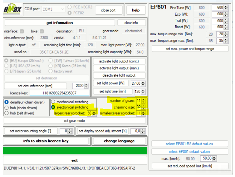

It's not an enormous hassle. Just do it yourself. E-Max provide a detailed explanation how to do it. And you have direct contact to Peter of EMax through the German Pedelec Forum as well as through EMax. He is brilliant and super helpful. You just need a laptop, programming cable and 120 Euros. I have done this 3 times. Twice myself, and once for a friend.
The Shimano EP801 and EP600, are one of the easiest motors to change the speed limit on. Just not using the Shimano software, but the E-Max software. I literally run a Shimano Motor as a spare bike because of the ease of making configuration changes to all facets of the motor. The combined Motor and Electronic Transmission, is second to none. And so much cheaper than any alternative.

If your programmed drivetrain configuration (chainring size, number of gears, smallest sprocket and largest sprocket of your cassette) on a DU-EP600 or DU-EP801 based bike does not match the real values, you easily can catch an E295 error and after you have received 4 times an E925 error you will get the final E299 error which will completely lock your drive unit and you have to unlock it from the Shimano service centre and your bike will be out of warranty forever (also after unlocking from the Shimano service centre)!
Chances for these errors when the drivetrain configuration does not match are extremely high if you e.g. go uphill slowly in a very small gear, because then the tolerance band of the "antitunig" algrithm of the motor firmware is at its limits and beyond. Via this algoritm Shimano tries to identify some of these bloody oldschool electronic boxes (called "dongles" sometimes) which manipulate the signal from the speed sensor (and will not work at all on a DU-EP600 or DU-EP801 drive unit). So, never ever use such crap tools (like SpeedBox, MBIQ, BadAss, RedPad, PearTune as well as Planet3 „mechanical tuning“, etc.) on such a bike, because it will miserably fail.
So, some bikers who very often are using these extreme drivetrain settings may easily been hit by these fatal errors, some others who are using their drivetrain not in such extreme postitions may never get such errors. But there is a high risk and every biker with these new generation drive units from Shimano should be aware of this high risk and much better do a correction of the programmed values if there was a change in the drive train components done.
Especially if there is no "real" display mounted on the bike (and e.g. only the SW-EN600-L remote control unit mounted on the left hand side handle bar, like e.g. on many Orbea bikes) chances are very high that the biker will not realize that he already had an E295 (because this SW-EN600-L will just blink red) and then just restarts the bike (which will work with a E295) and then will realize that after 5 of these situations there is no more motor support at all because he finally has got the final fatal E299, which is the end of the sad story...
So, again: Don´t change components on the drivetrain without changing also the related settings!
Take care: A local bike shop CANNOT reset any final E295 - the bike (or drive unit) needs to be sent to a Shimano service centre and they don´t do this job for free normally. I know that some bike owners have paid up to 300€ for this reset process.
With a cable bound SM-PCE02 interface you can easily do the correct configuration of your new chainring size by yourself already in the licence key free (and so completely free of charge version) of the Windows based miniMax - program.

It's only if you have electronic gearing.
If you have electronic gearing. You must set the Chainring teeth and cassettte type and size in the parameters. Shimano can then calculate what speed you should be doing, for a particular gear.
If the calculated speed doesn't match the actual speed. Shimano assumes you are trying to drive the motor faster than the legal speed. You get 3 warning errors to fix the issue before they lock the motor.

Sorry, this is not completely correct...
Even thought the antitunig algorithm from Shimano motor firmware is much more sensitive on bikes with electronic Di2 derailleurs (in this way the firmware exactly knows in which gear the bike currently is and so can exctly calculate the transmission rate between motor output axle and rear wheel speed and so compare these values internally), also with a mechanical derailleur (or e.g. a hub based system like Rohloff) will be checked via this antituning algorithm and so it is also important to set the drivetrain configuraiton correctly in this situation to avoid any E295 and E299 errors!

Well that is interesting, because when I removed the mechanical derailleur on my bike and installed the electronic derailleur. The mechanical parameters were incorrect for what was installed on the bike from the factory.
Infact it wouldn't let me download the parameters after selecting the electronic shifting, because they didn't match the 12 speed cassette. That's how I realised the parameters were wrong. It wasn't until I set the parameters to 12speed, 10-51T that it let me download.

As written in a previous post, there are a huge number of bikers which have wrong settings of the drivetrain and never will experience an E295 or final E299 error because they are mostly not riding in the extreme conditions which will trigger these errors (like going up a step hill slowly in ther very lowest gear for quite a long time).
However, wrong drivetrain configuration settings on a DU-EP600 or DU-EP801 drive units are ALWAYS a ticking timebomb.
See e.g. this German forum post which is related to some guys how had E295 errors due to a wrong configuration of a mechanical Rohloff 14 speed hub (for the root cause of this post see some posts before, e.g. here and here).
