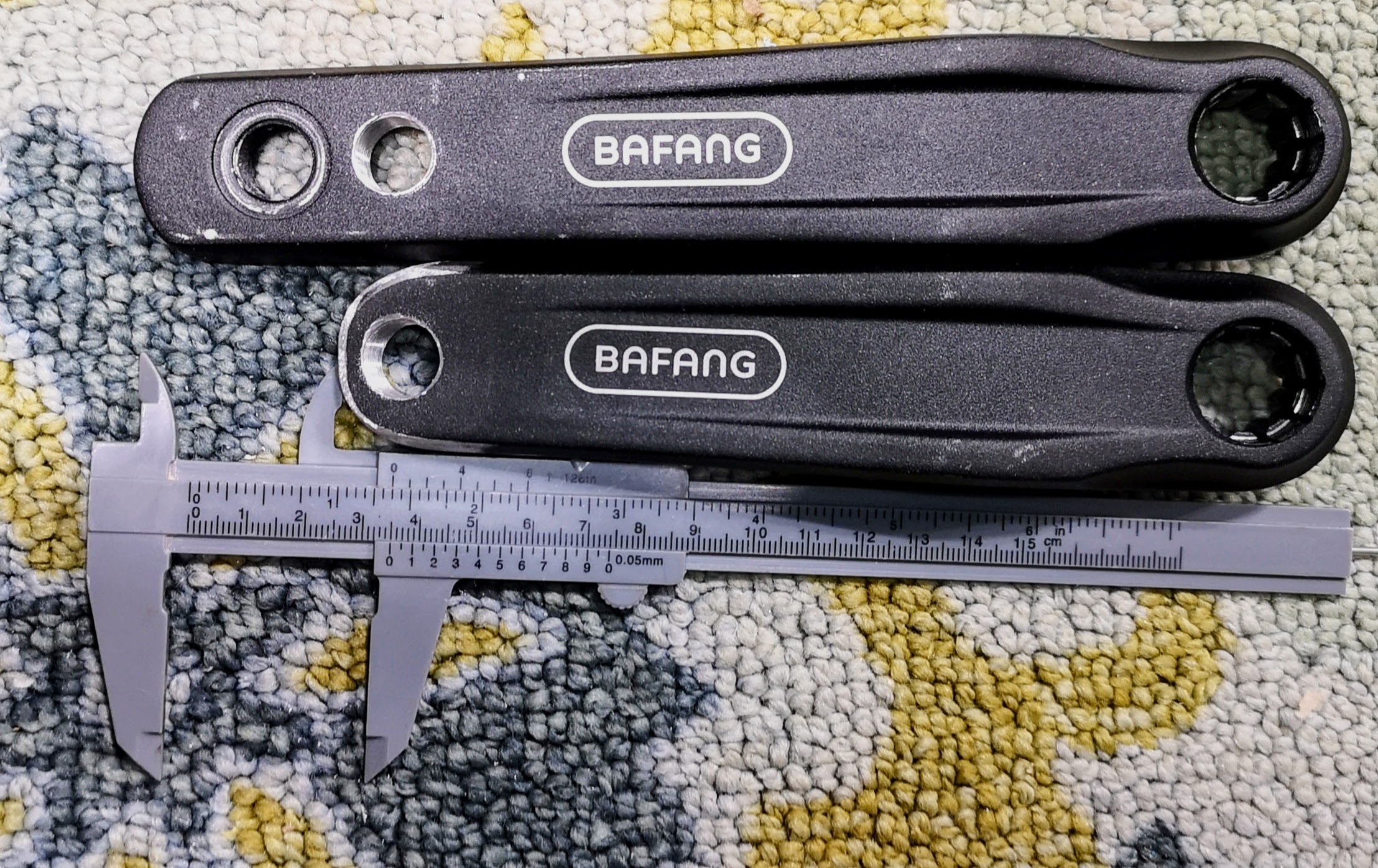

Cutting the cranks saved a whopping 35mm, because bafang left a LOT of meat on the end of the cranks which seems completely unnecessary...that and i can still add a thingamabob to the shock to increase ramp up, and add offset bushings if needed.

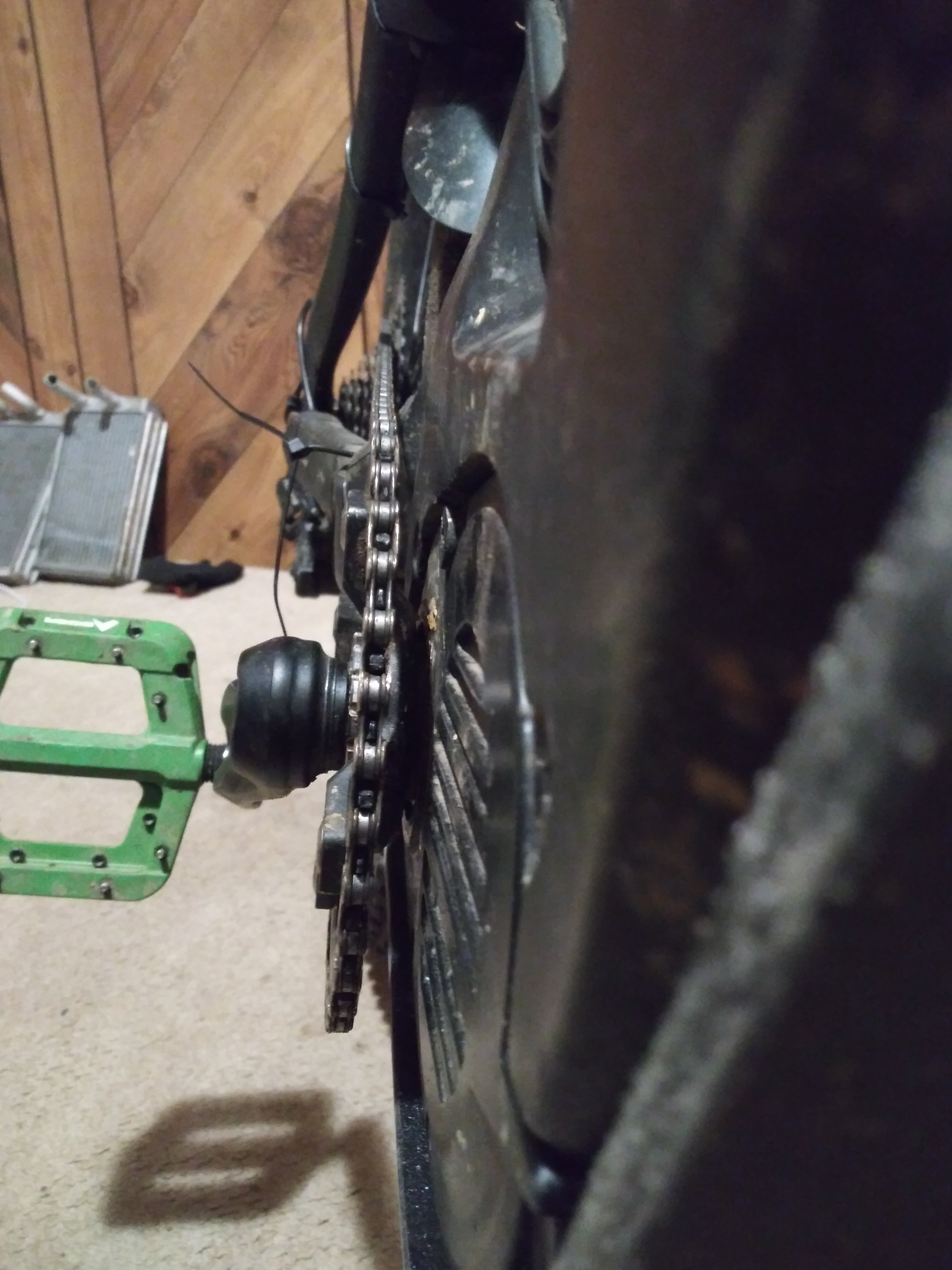

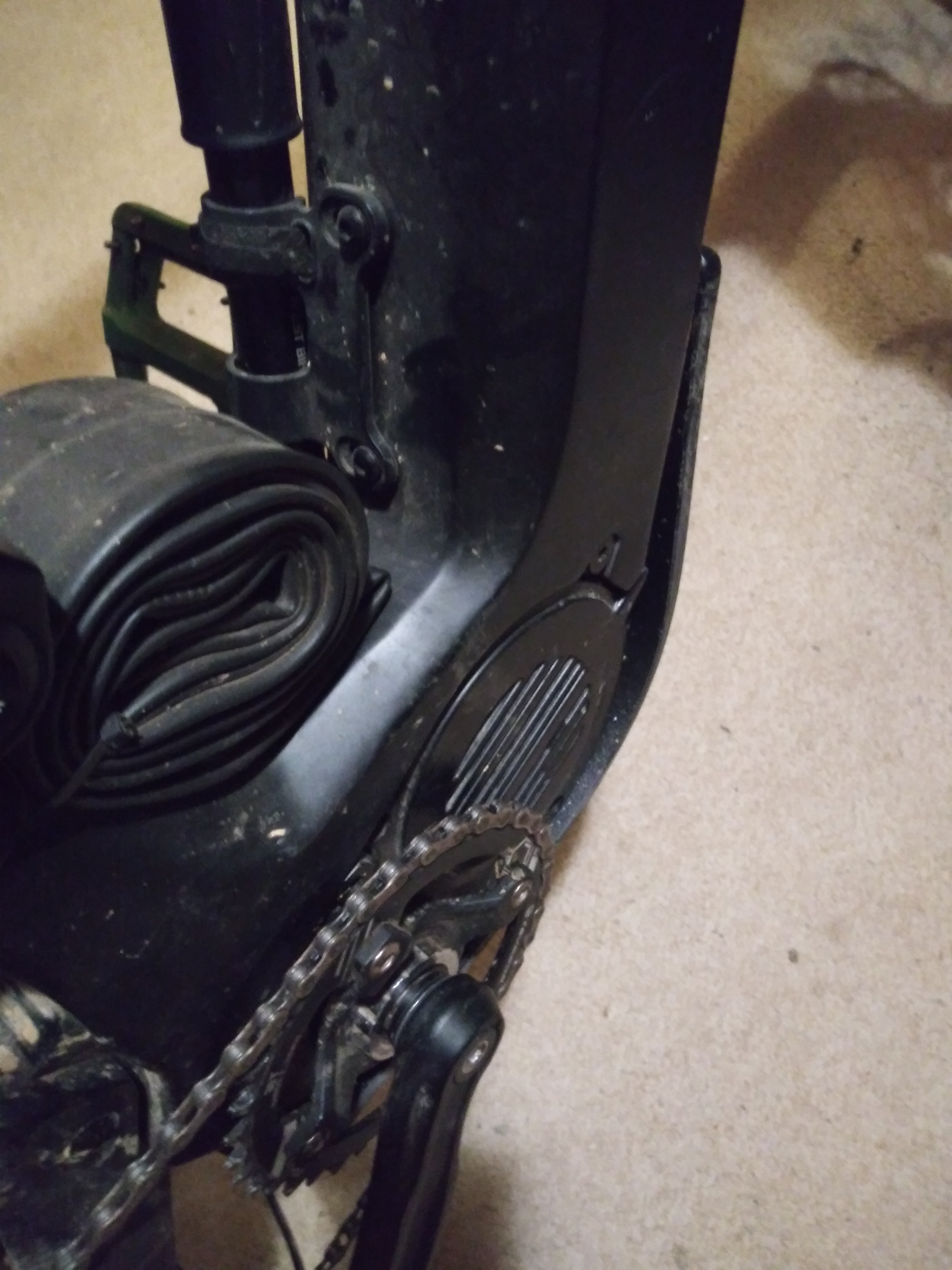

went on another test ride - Im really bummed about this build....pedal strikes like crazy again. the bb height on my setup is 333mm. My other enduro (Devinci AC) has 360-370 (adjustable flip chips) mm bb height, and pedal strikes are not too frequent on it. i have it on the 360mm setting.
for this ride I had upped the rear shock pressure to 280 - thats a hair more than recommended for my weight (220 lb with gear) and there's already max tokens in the shock so i cannot reduce air volume any more. still blowing through too much shock travel too easily - will try a rediculous 300-320psi (max is 325). short of going to a strong coil shock i really don't know what else to do about the shock.
Im running a 170mm fork and 27.5x2.8 tires. it seems this wheel/tire setup is not a good choice on this frame.
In addition to going to 150mm cranks (which still wont be enough imho),
I could go to a 180mm fork
and 29x2.5 or 2.6 tires - that should get me ?? hopefully 30-40mm more ground clearance/bb height.
Has anyone tried a shock longer than recommended like a 235-240? looks like it could be done and still not contact the yoke. Im so frustrated at the thought of having to change wheels, fork, shock possibly just to be able to climb rough trails normally.
Has anyone measured their actual BB height? care to share?
I'd ditch the 27plus tyres, and fit a regular 29/2.4 or so. Those 27plus tyres might be getting up around the same diameter as a 29. But they will squish in a heap more unless you run ridiculous pressures or baby it around the trails. And that may reduce your ride height at crucial times increasing pedal strikes. (And i bet feel sluggish and squirmy when they are pushed/ridden hard too.)
With regards to putting a longer shock in. You can put a longer STROKE shock in provided you offset (and pin) one or both of the shock bushes. But I don't think you could put a longer length eye to eye shock in, unless you find a similar size inch measurement shock maybe?
Putting a longer stroke shock in, and offsetting the bush's will have a minor effect of slightly extending the rear suspension, which will slightly increase your rear height all else being equal. But it won't be a massive difference either way. Just a minor adjustment.
I have a longer stroke shock in mine (same eye to eye measurement). With the offset bush in the yoke. It effectively gives you just a little more travel, with the additional shock stroke. I like it on my bike, as with a coil shock, you can tend to blow through the travel a little bit on big hits.

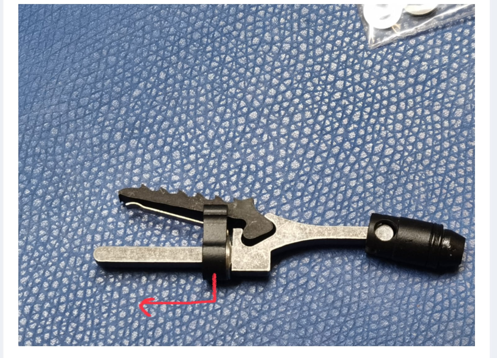

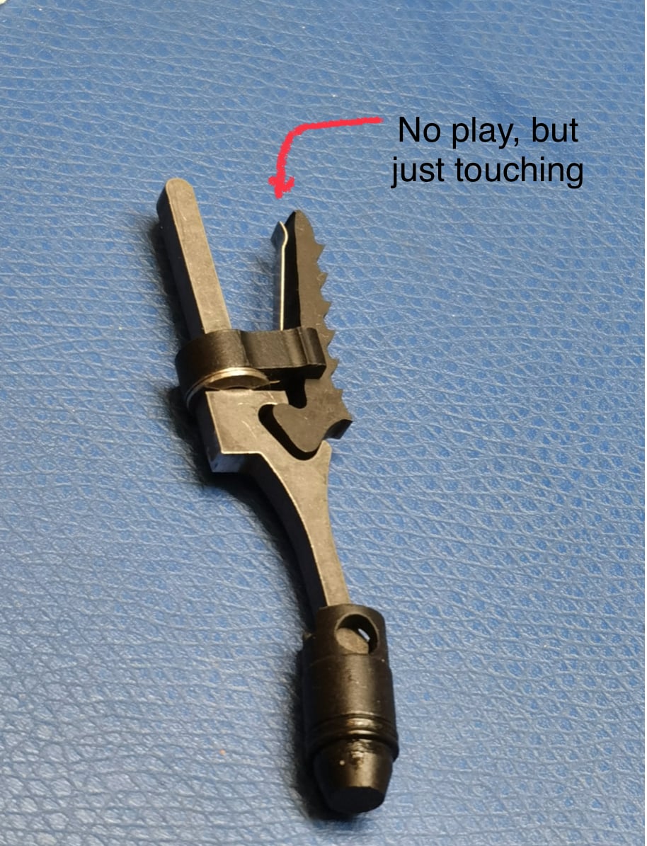

I would recommend you to disassemble the shifting block completely (the one which actuated the gear hub), inspect it, inspect the seals, clean it, lube it, assemble it back and fill with fresh hydraulic fluid (I filled mine with Magura Blood Hydraulic mineral oil). The mechanism of the shifting block which connected to the gear hub is pretty simple, so it should be easy. You might want to see what is going on on the shifter lever mechanism if rebuilding the shifting block will not fix the issue.
Your thorough feedback assisted me to find another possible solution.
If I may use your image.
The following resolved the shifting matter for me
Bend the spring loaded plate underneath the pawl back slightly, to ensure that it keeps the pawl in position.
Slide the retainer out to do this.
From what I saw it looks like this insures that the pawl will follow the designed and desired path to be out of the way after the shift, or engaged when shifting is required.
The image might do a better job at explaining.
It is however crucial that you ensure all the air is out. Tilting the onesie while bleeding resulted in air trapped in the chamber to move out, while bleeding.
This Kindernay now “Shift”’s 😀😀, so nicely.
Hope this helps someone!

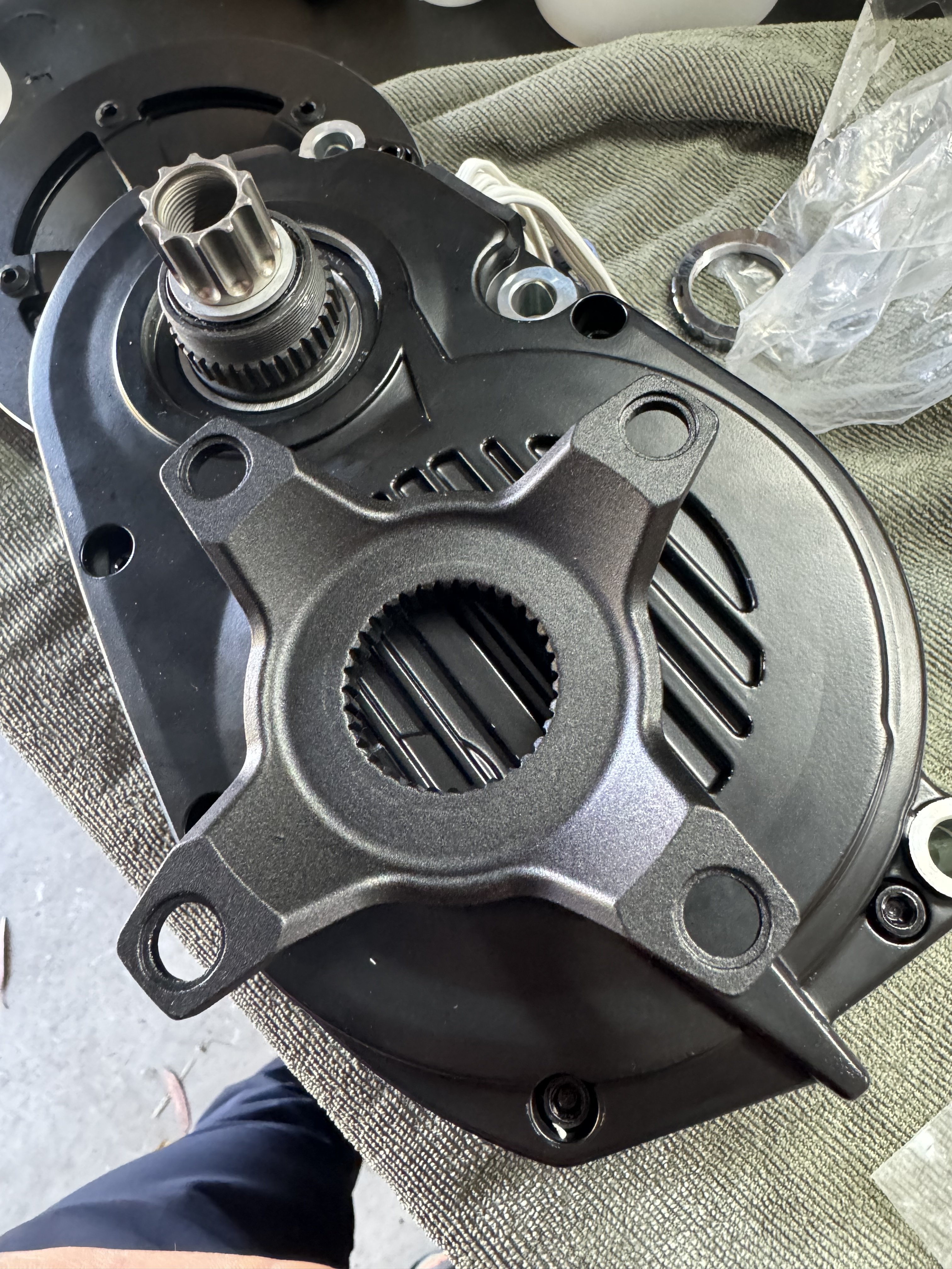

Thanks for th which reply! I just received my e22 kit from greenbikekit. I’ll be using a electronic drive train (sram eagle GX AXS) and curious if I could use sram crank arms…

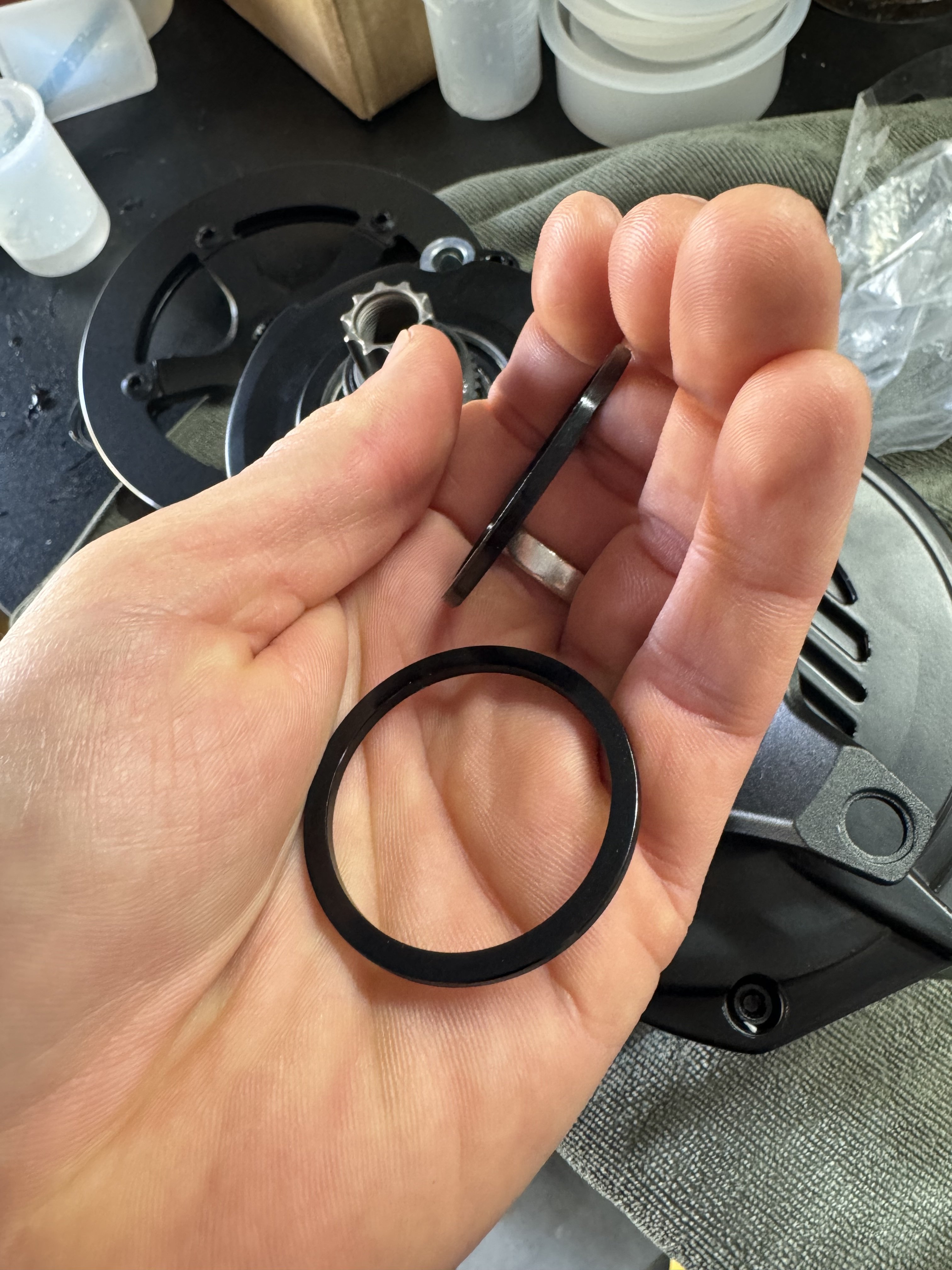

I picked up a greenbikekit and opted for the spyder chainring adapter so that I can run the SRAM Eagle GX AXS system. It came with these two metal spacers. I’m able to use the spyder without the spacers. Has anyone else gone through this, if so did you use the spacers?
i made a video on the subject. i believe the spacer will be required perhaps only so the silver reverse thread nut will not bottom out before it clamps down!
Thanks for the quick response. I didn’t quite make out when you put those on. Did you put a spacer on under the chain ring adapter or on top of the chain ring adapter? Just want to make sure I do this right!

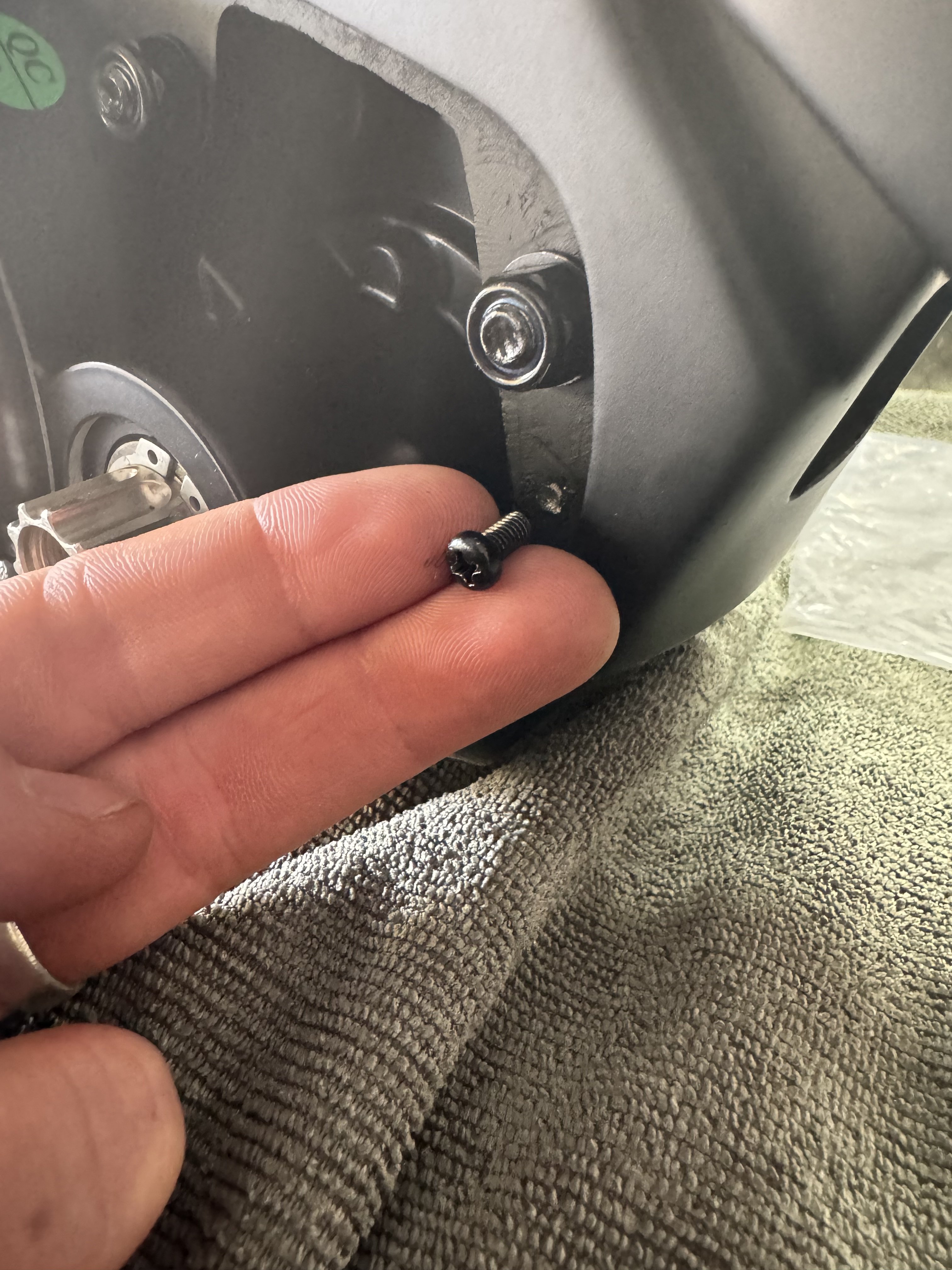

I used 1 thicker spacer then the spider. my bike kit is also from greenbikekit. for the motor plastic cover i ended up using small silver torx screws which look like some you might use at the handlebar clamp

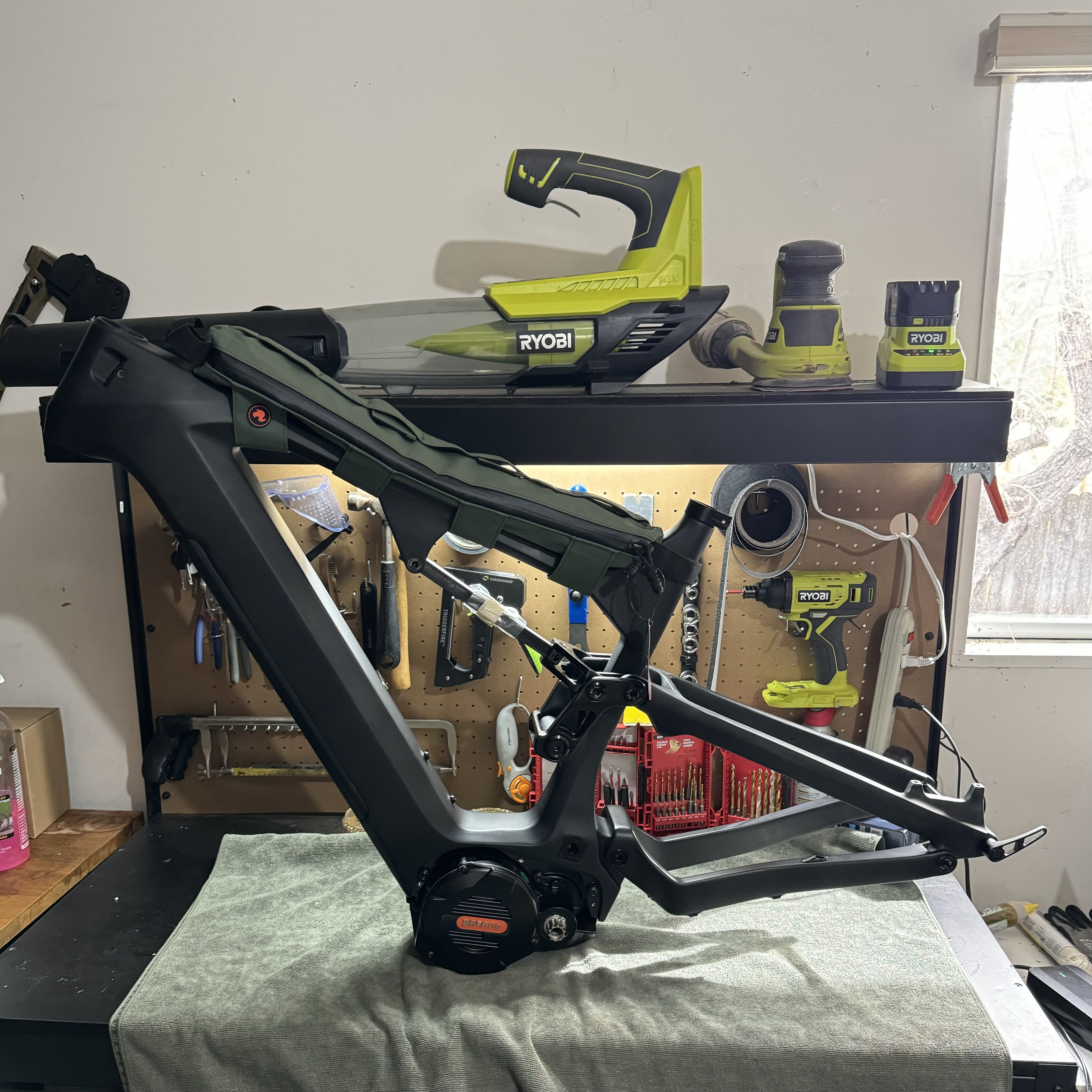

I bought this e22 frame kit from greenbikekit. Really excited to receive all the parts I ordered and dial it in!
Originally I was going to paint this frame but after a few quotes ($1000+😅) decided to focus on the components instead.

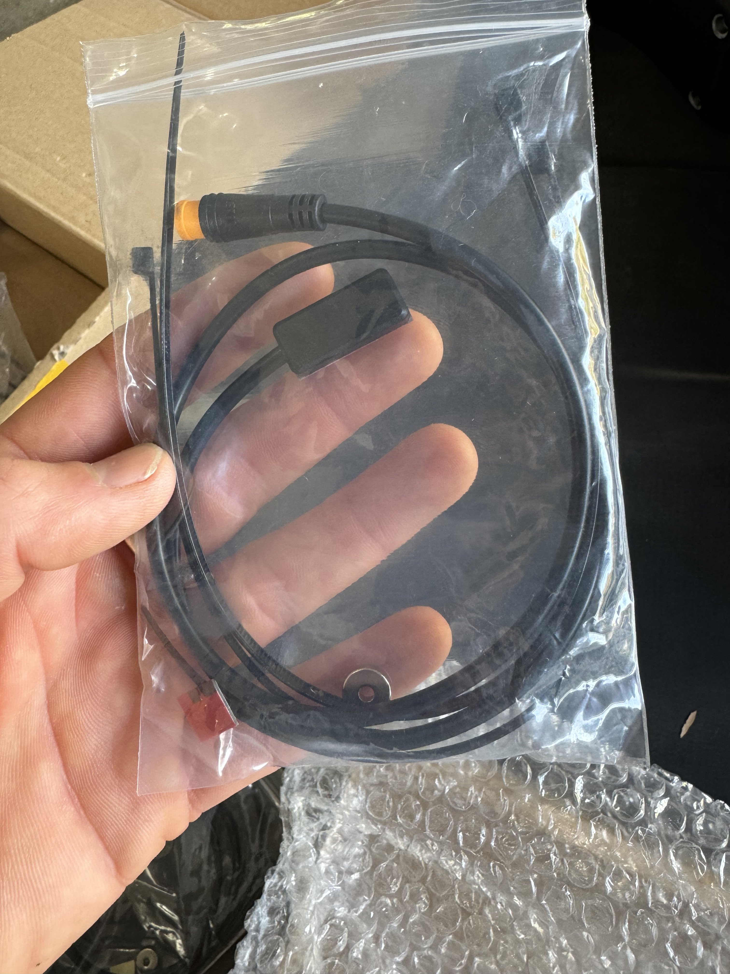

Putting together my e22. I’m using sram stealth brakes that don’t have brake sensors. Do I need to use these or can I just leave the brake sensors unplugged?
@BafangGang , No.
As long as you're using 4piston brakes with 200mm rotors front and rear at the very least, you should find that you won't need brake cut-offs for the E22.
In addition, brake cut-offs can hinder you getting the best performance out of the M620 in an Allmountain situation👍🏿
@BafangGang , No.
Thanks for the info Neeko! I’m running 220mm up front and 200mm rear. Most importantly wanted to know if I didn’t plug those brake sensors into something if it would affected the computer?
