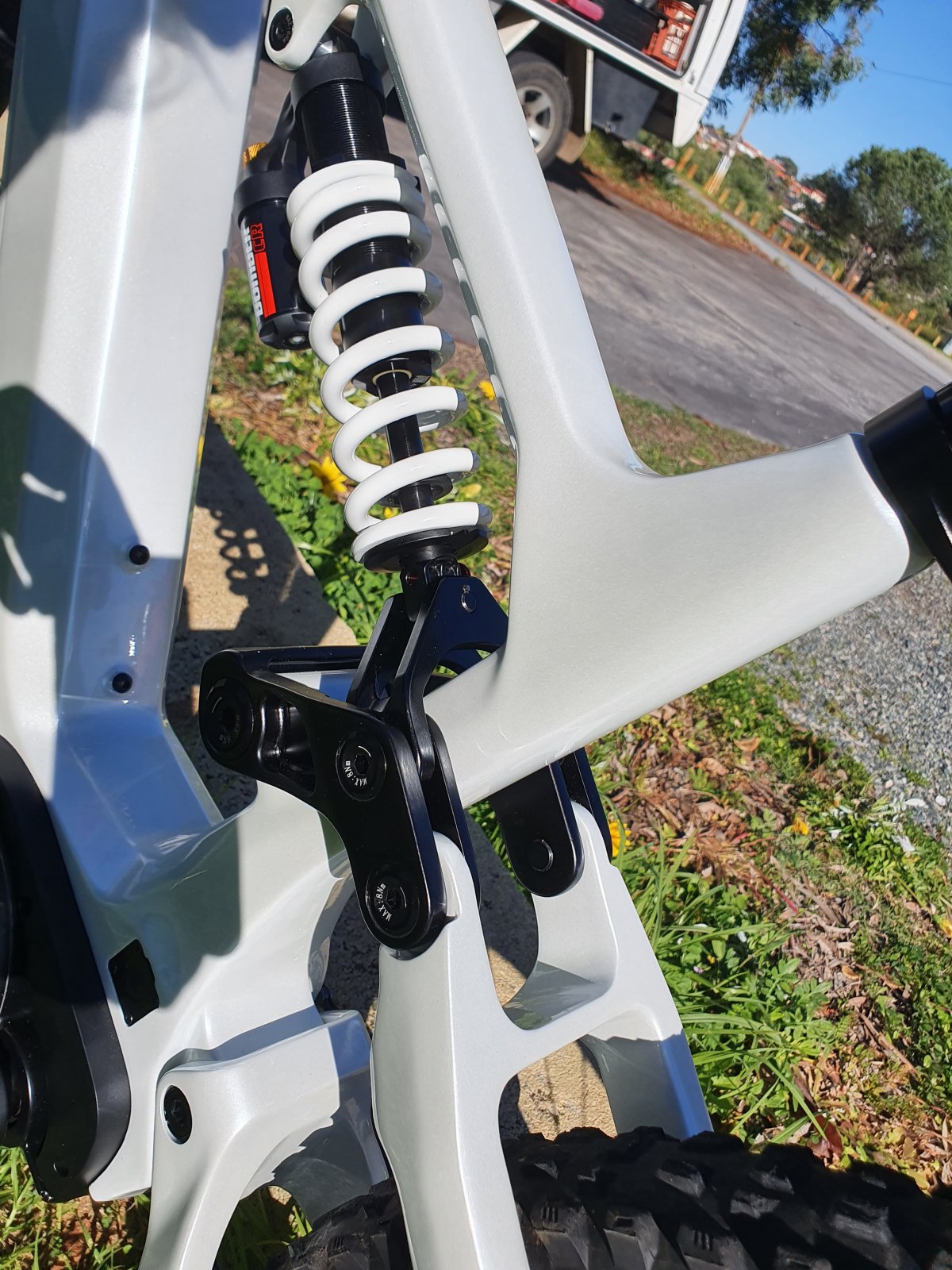

Rear shock is in. In the end i used the offset bush's which allows me to run the 230/65 shock without any problems.
With standard concentric bushings, there is just about 10mm clearance between the shock yoke, and the forward edge of the seat tube. (As seen with the blue allen key as a feeler guage)
Each offset bushs adjusts by about 2mm. Adding the 2 offset bushings increases the effective length of the shock by about 4mm to a total of 234mm.
With the offset bushings installed, the gap between the shock yoke and the seat stay closes down to about 5-6mm. Which is ample clearance.
The 230/65 shock, with offset bushs, bottom outs out at almost the exact same posistion as a standard 230/60 shock with standard bushings. Well technically, 1mm deeper into its stroke. Which is no problem, and does not cause the seat stays to foul the seat tube at full bottom out.
The only problem I can see with this setup is the potential for the offset bushings to rotate over time, which would them throw everything out of whack and potentially cause fouling on bottom out.

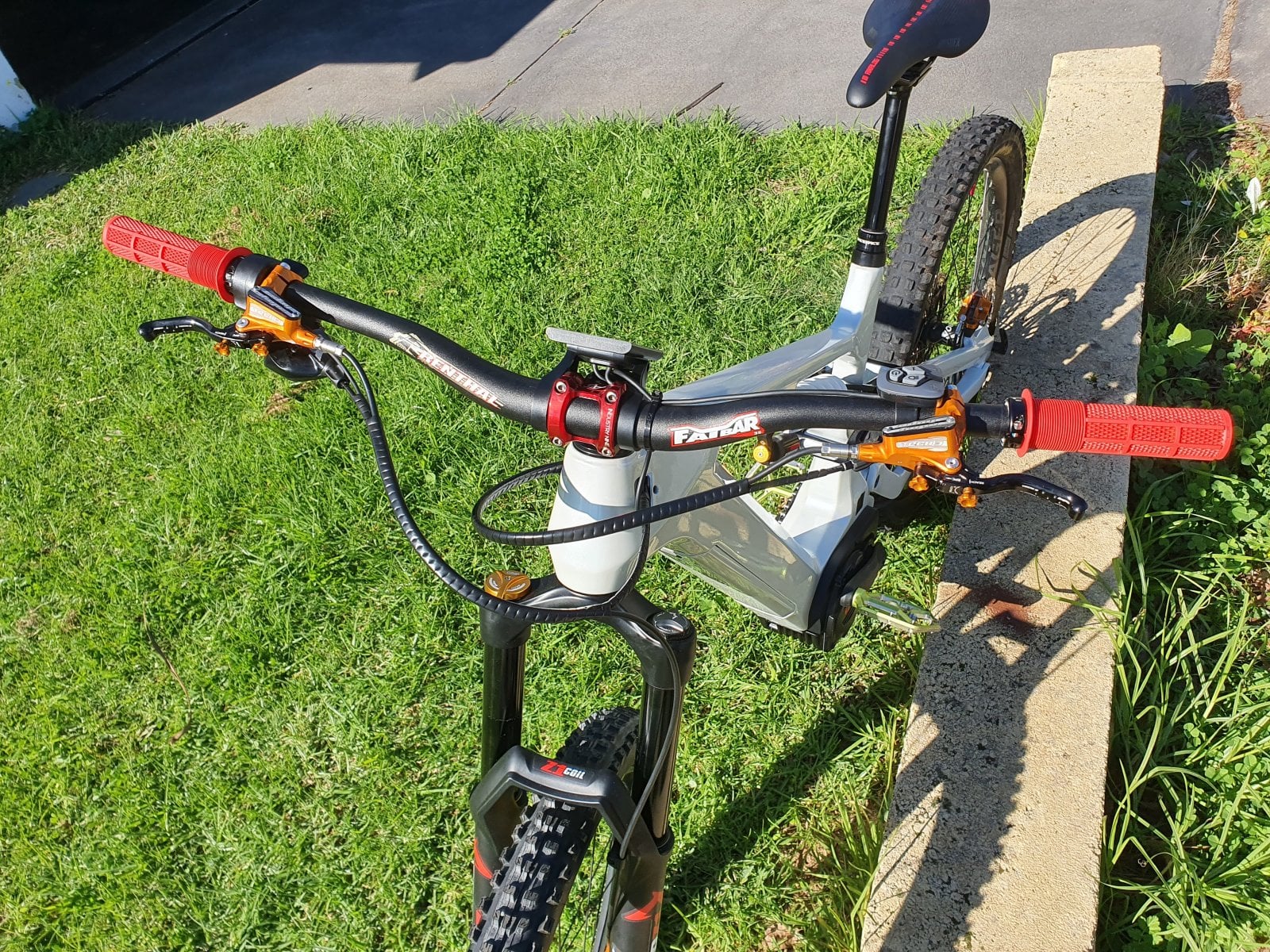

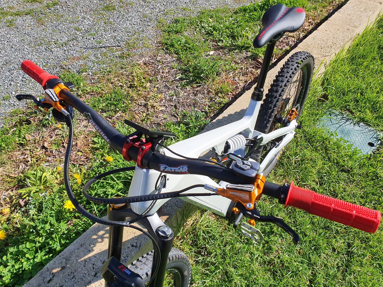

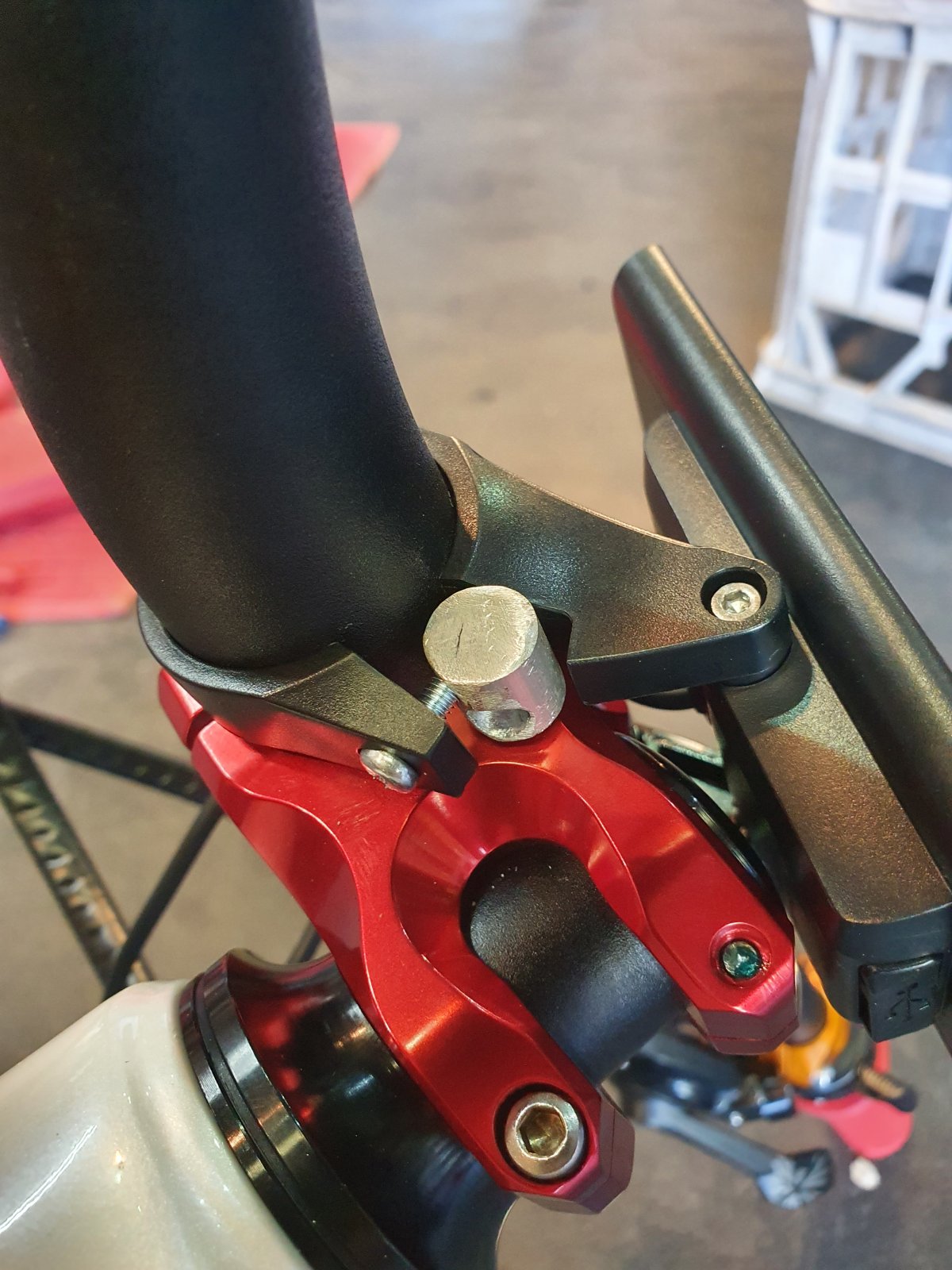

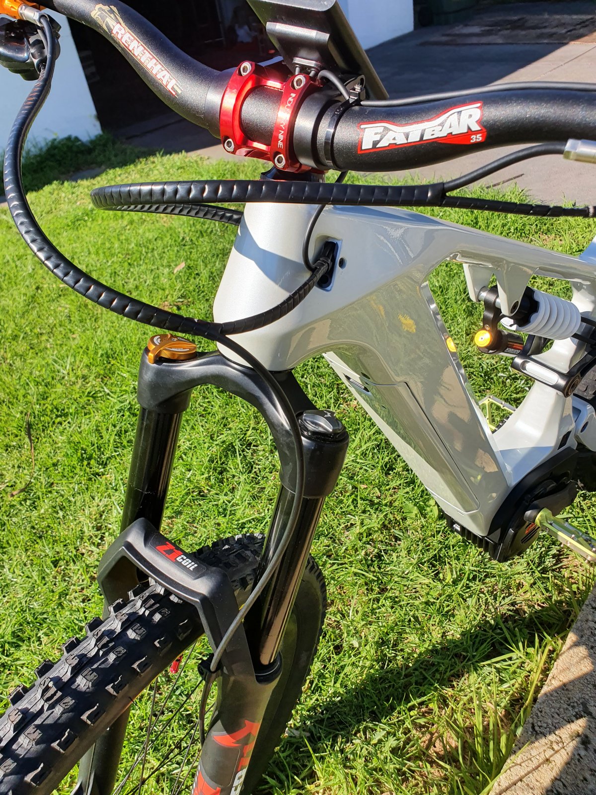

I got the steerer tube cut down, and fitted up the stem, bars, grips, brakes and controls. Mounted up the front brake to the fork. And put the throttle on the right side above the shifters. My thinking was that way I can't simultaneously shift and give it gas at the same time. It was tight and I wasn't super happy with the alignment of everything.
I stupidly tried to adjust the GX eagle shifter blade position, and didn't realise its not actually adjustable, and when I undid the central screw, the entire shifter mechanism fell apart, with springs and what's its going flying in every direction. It took me a good few hours to reassemble the shifter mechanism. What a night mare. I am used to the X01 on my other bike which has an adjustable trigger posistion.

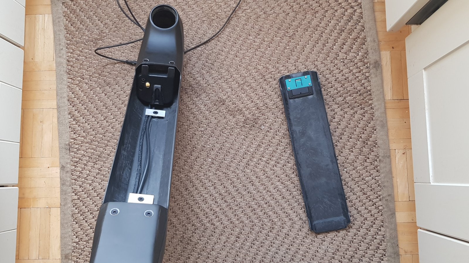

Apologies for the delay.
Yes, the battery case is accurate for the E22.
Unfortunately, I have to refer to old images of my E22 as the bike is currently with my suspension chap as he is unearthing the leverage ratio curve based on a 2.5:1
Anywho, the above images hopefully will illustrate the battery mounts for the E22.
In theory, the frame (if purchased on its own) should come with the mounting hardware and bracket for the battery (as well as the battery hatch.

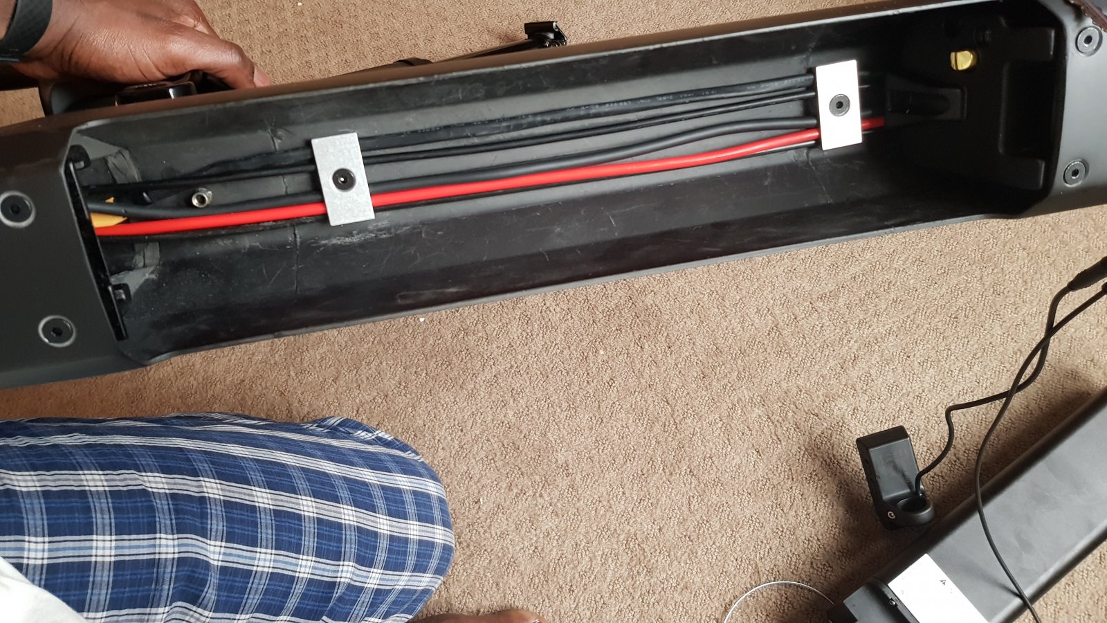

The battery mounting hardware is basically 2 pieces of aluminium that connect to the frame.
One piece goes at the lower end of the opening in the frame, and it has the electrical contacts that correspond to the battery case, it then has wires/plugs coming out that connect to the motor.
The other piece goes at the upper end of the opening in the frame. It has the latch mechanism that secures the battery case in place. It has a key/lock mechanism that lines up with the round hole on the side of the downtube, so that you can unlatch the battery.
There is also the cover that covers the battery opening in the frame. This is made of carbon, and has a metal sliding latch mechanism at one end to secure it to the frame.

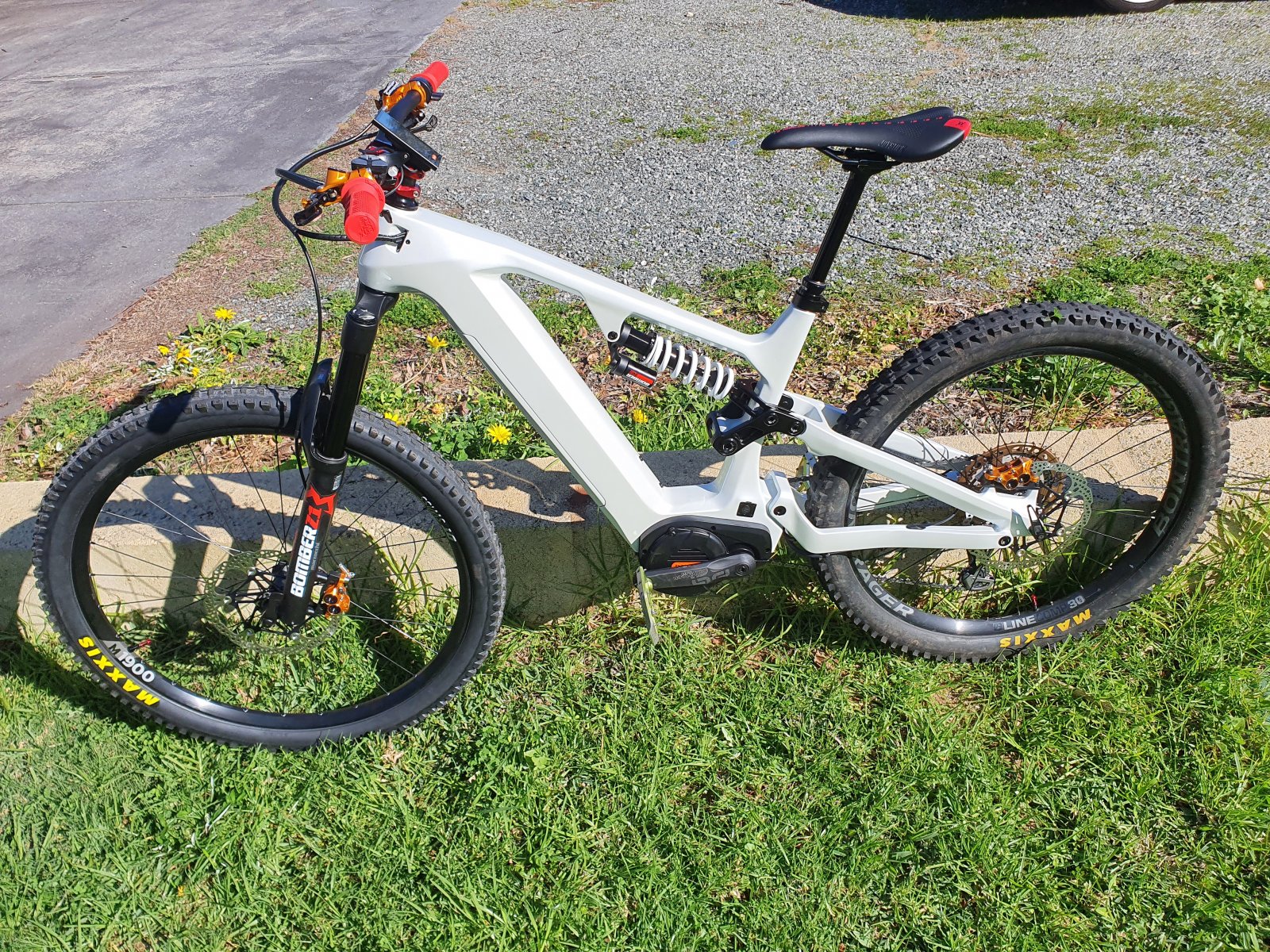

Well it's all up and running. About to go for a shake down run after lunch.
First test in the driveway I was wheelstanding on the first crank. Luckily I forgot the magnet on the spoke, and it cut out with speed error. Otherwise it could have thrown me lol.
Need to set up the suspension a bit. And possibly bleed the front brakes. They feel too spongy.
