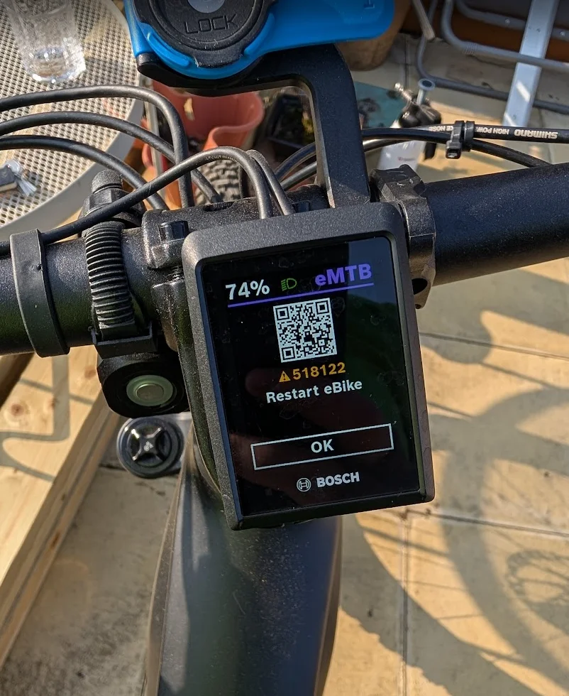

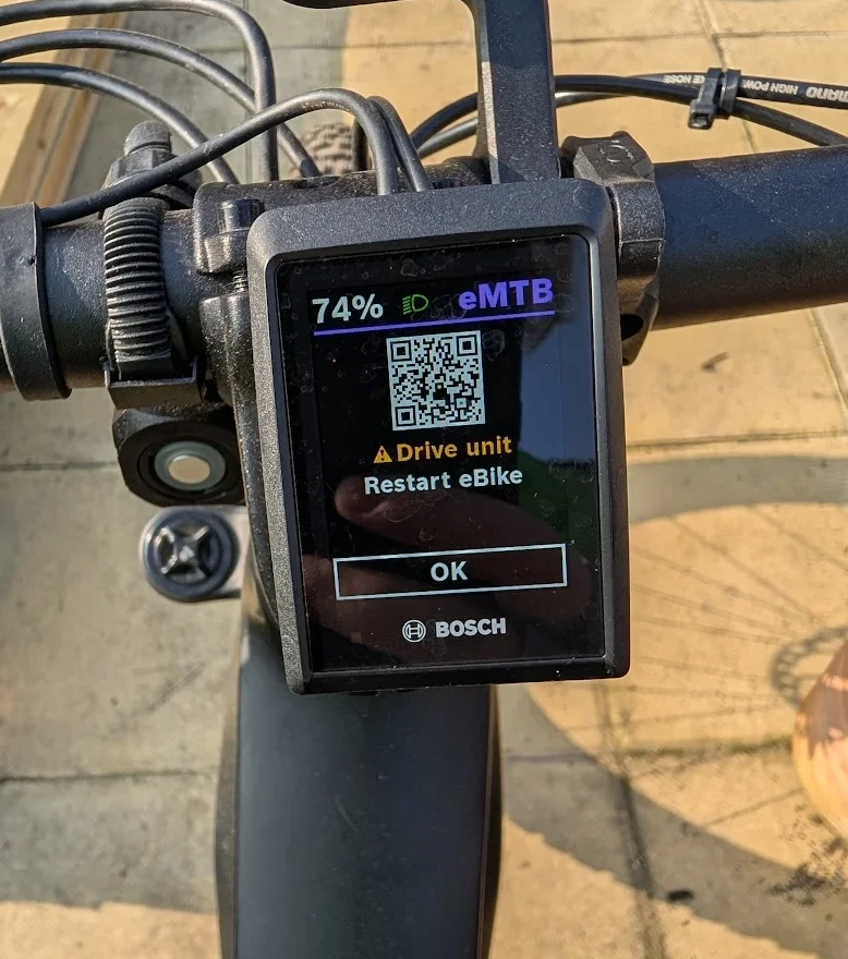

I need to share my experience here as a warning to others, because what happened to me was frankly unacceptable.
I used Rudie's service to get my Bosch Smart System unlocked. After a few rides, my bike completely stopped working and threw error code 518122 (see photos attached) - On the other hand my partner's bike working just fine, so I have no idea what's happened. But whatever the reason I've got a bricked bike. Useless. I tried to reach out to Rudie to report the problem and get help — and he had completely vanished. No reply on WhatsApp. Nothing. Gone.
To make it even worse, he went back and quietly edited the title of his original post in this thread — the one that confidently claimed he could unlock ALL Bosch motors into ALL BIKES LOCKED — and just disappeared, leaving everyone who used his service stranded with no support whatsoever. No website. No contact details. No accountability. Just silence. That is an absolutely disgraceful way to treat people who trusted him and paid for a service.
I was left completely alone with a broken, unrideable bike and zero recourse.
The only thing that saved me was finding eBikeDoctor. What a difference. Professional website, clear information, and he responded almost immediately. He fixed my bike completely for free in under 15 minutes. I was genuinely stunned at how smooth and professional the whole experience was compared to what I had just been through with Rudie.
I cannot recommend Rudie's service any more. If something goes wrong — and as you can see from my photos, it can — you will be left with nothing. No help, no response, no way to even reach him.
