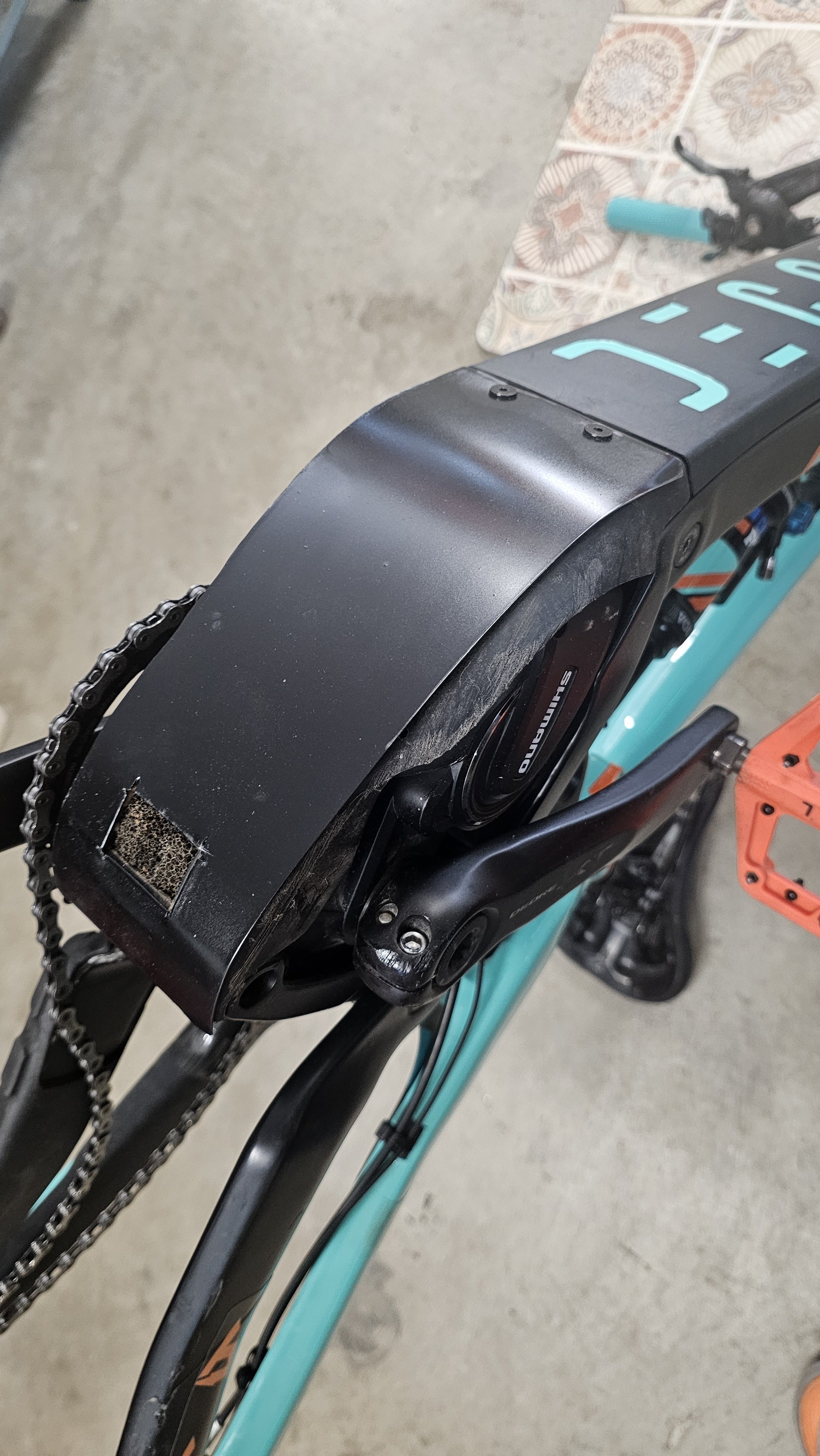

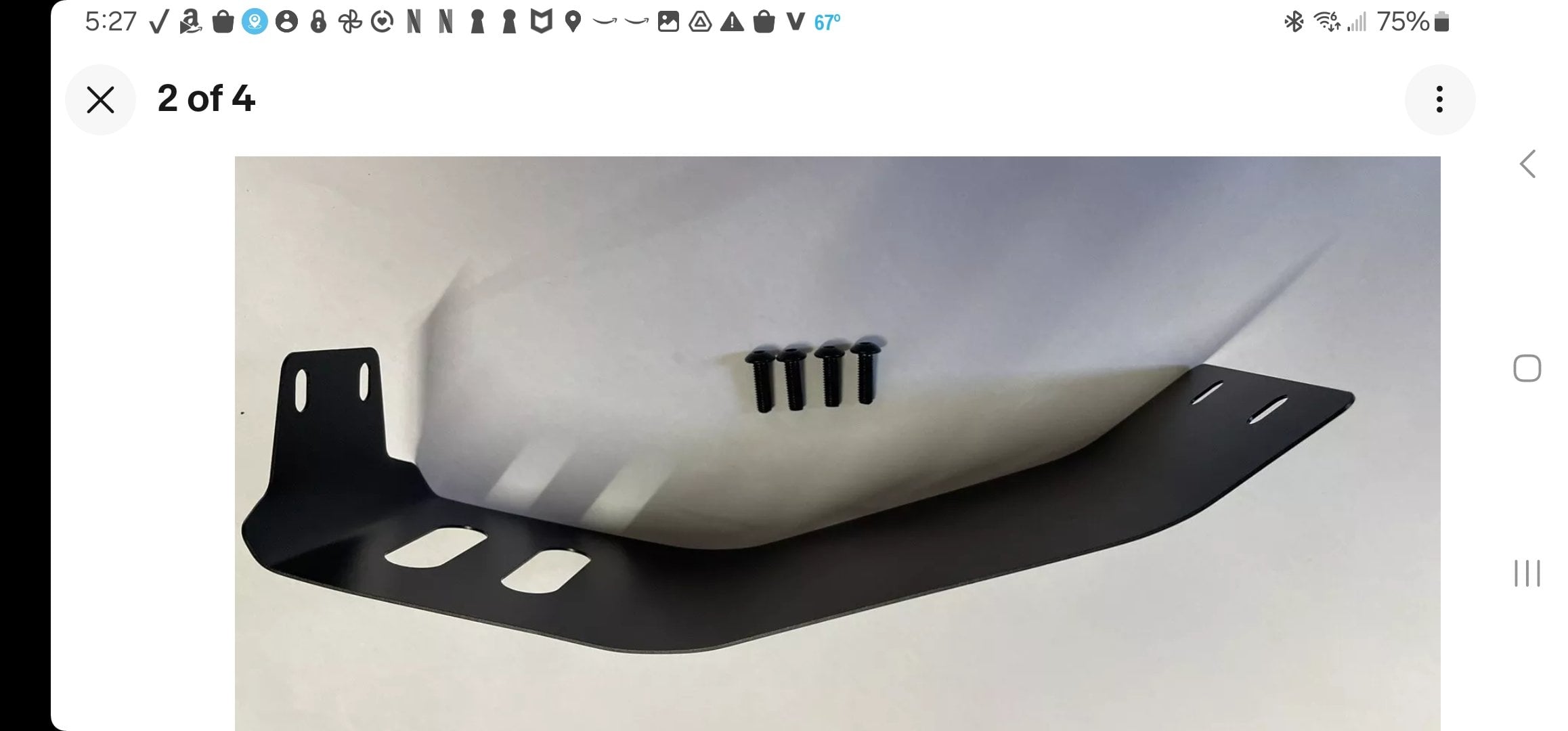

I broke I 2 stock skid plates in 3 weeks from the knarly trail I like to ride so I made my own from steel x sheet metal. I also bought one on eBay for my new decoy. Both work fantastic, with zero issues
