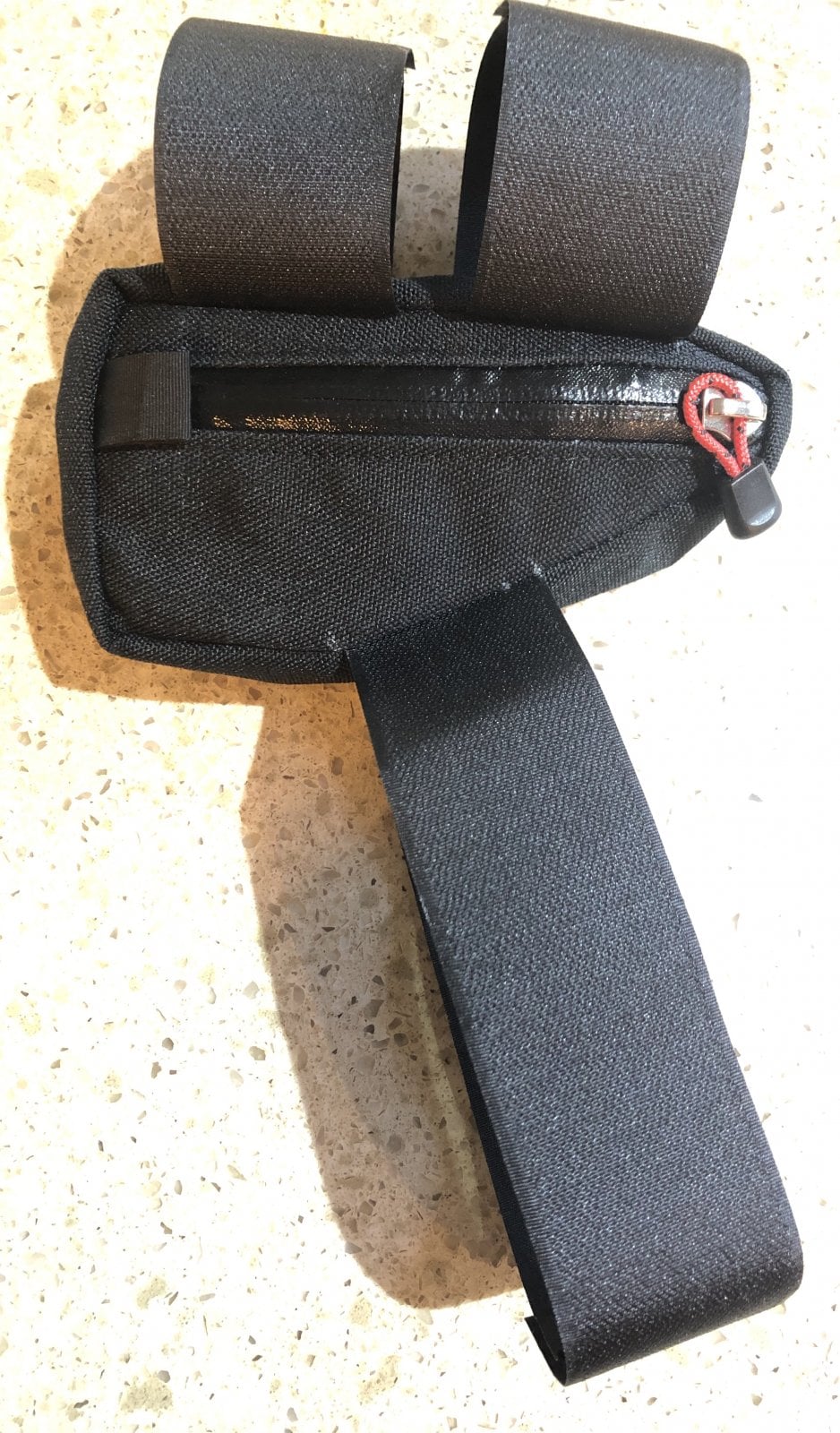

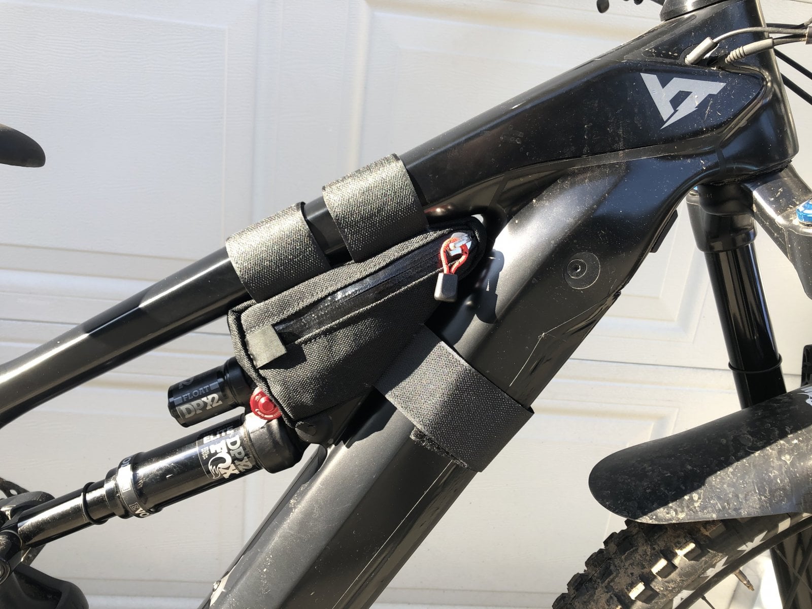

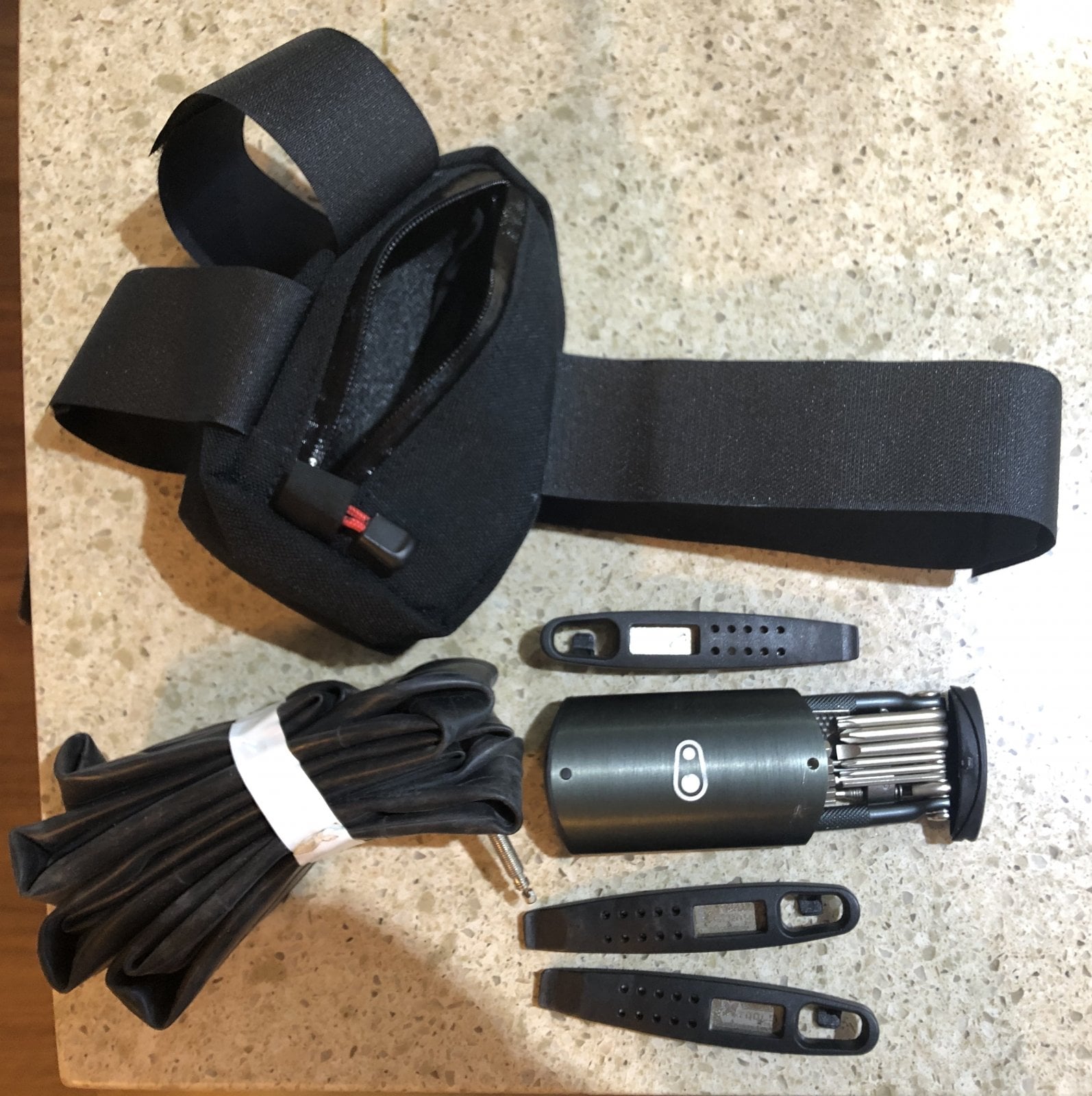

Had this made from a guy in Calgary/Canada. This was the first one he's made for the Decoy, so I had to send in a template. Gets a few metal objects and a tube out of my backpack.
Performance Satchel
Something like this (4mm thick)?
https: //www.amazon.ca/ dp / B07PBSBNRM/
