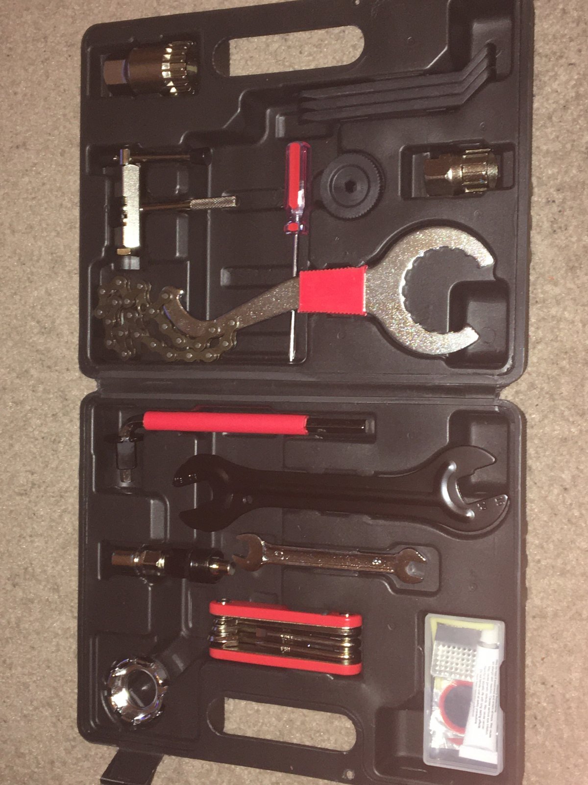

Spotted a tool kit in Aldi today (£24.99), pretty similar to the ones on Amazon that are about £40+. Obviously not up to Park Tool standard but the tools from Aldi are usually sufficient for an amateur like me! They also had some other bits and bobs in, I think someone was asking about panniers on here the other day (although it may have been on the Facebook group) so thought I’d mention it.
Hate to say this but I'm with Gary on this one, it's probably best just to buy what you need when you need it.
Always laugh when you see people buying these massive tool box's with 500 items in there thinking they have got themselves a good deal, when they get home and take a peak they find half of what they bought is imperial and the useful parts are metric ??
