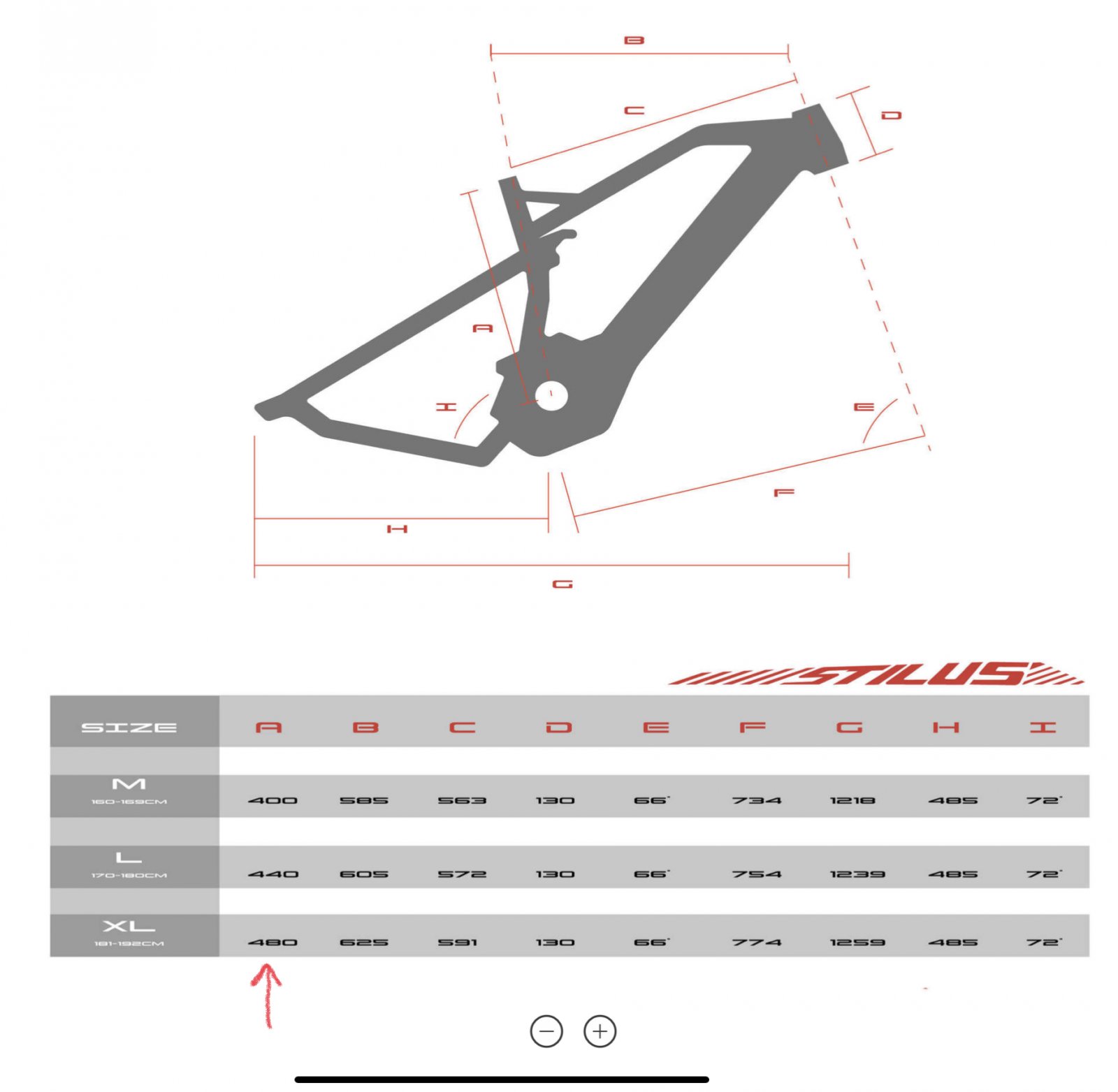

Incidentally I can’t see a size on mine. Although it’s listed as a ‘48’ which I hope is XL

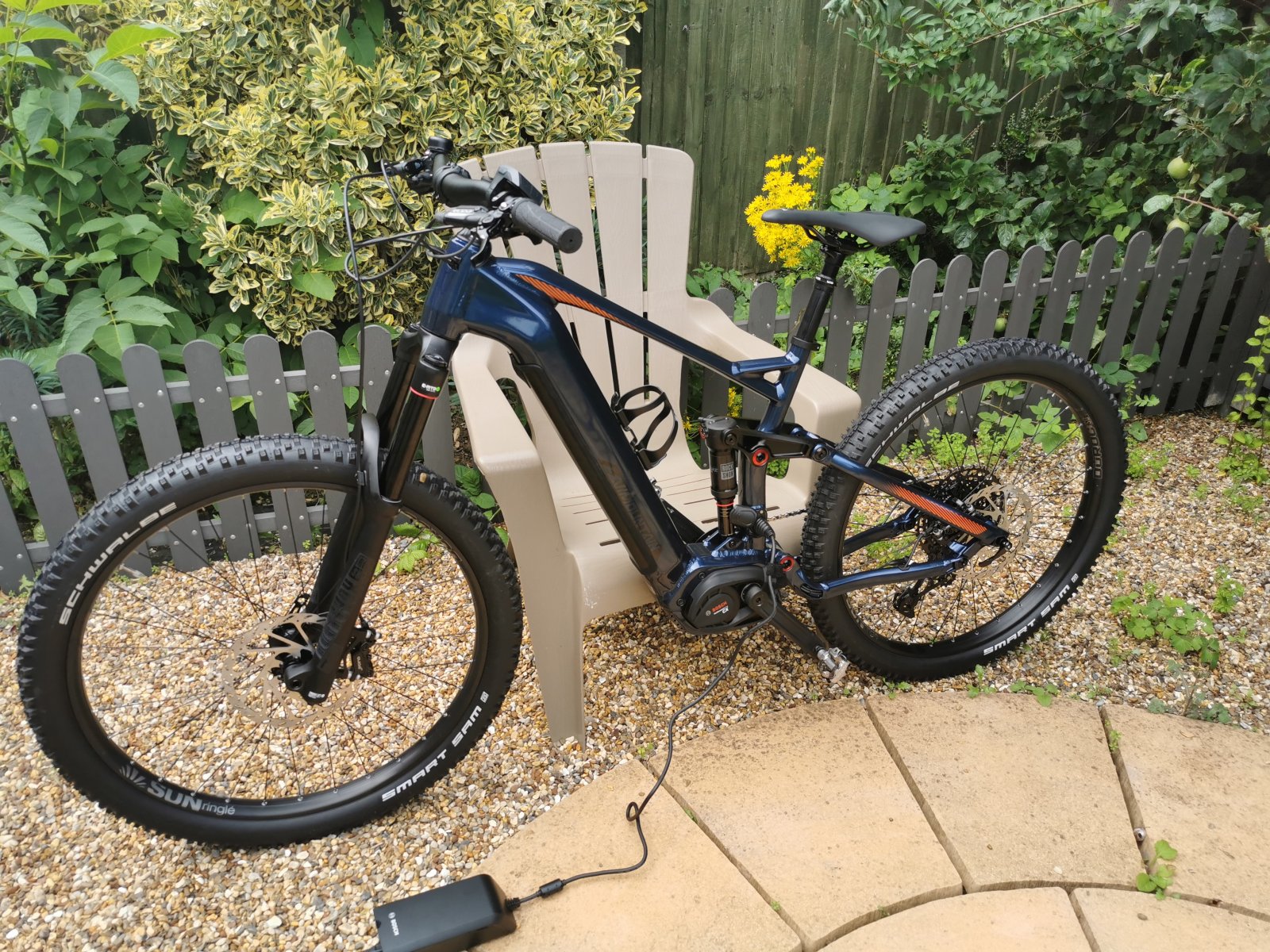

Super surprised it has the 6a £150 fast Bosch charger included though. Even some £6k bikes come with the cheapo 2a charger.
I thought I read somewhere it takes about 6 hours to charge, then mine turned up with 6a chargers......i had looked into getting 1 myself, anyway which would you prefer 6a charged or stem bolts...cant please some people...???

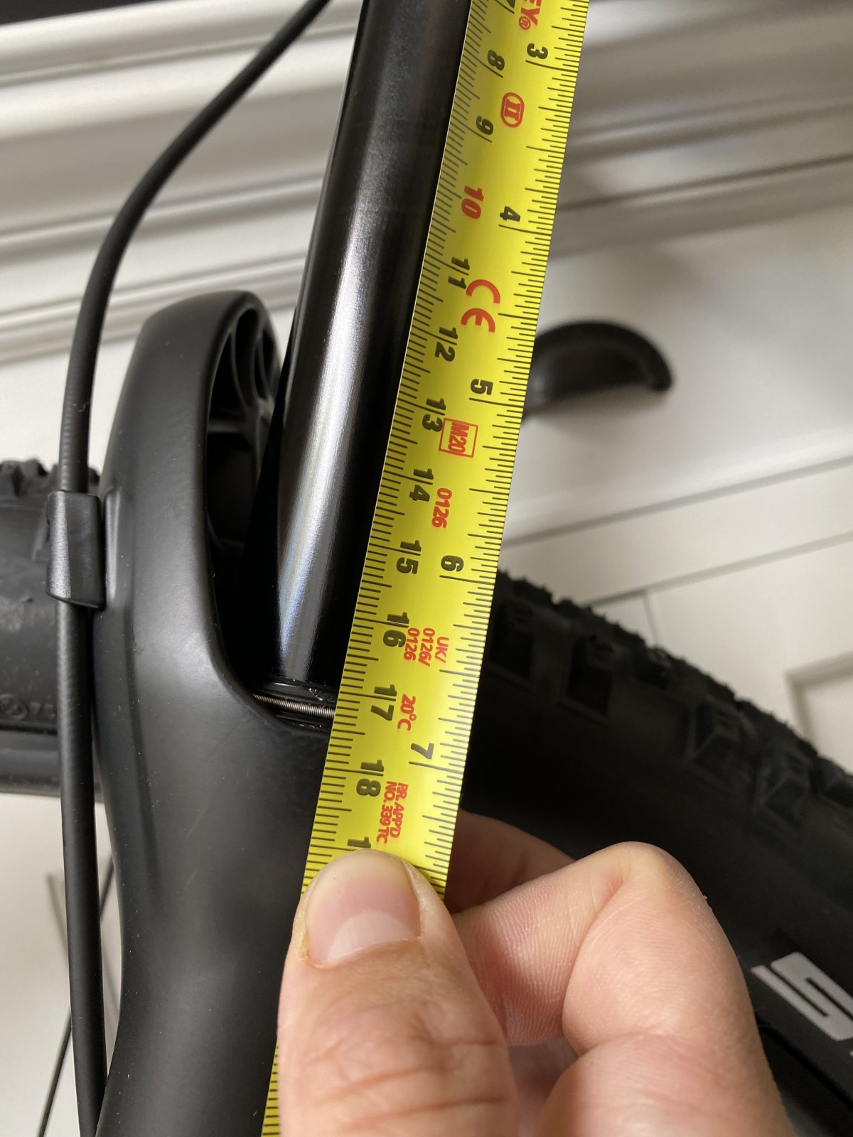

Head angle on the XL is measured at 65 degrees with my digital gauge. Not 66 as they quote.

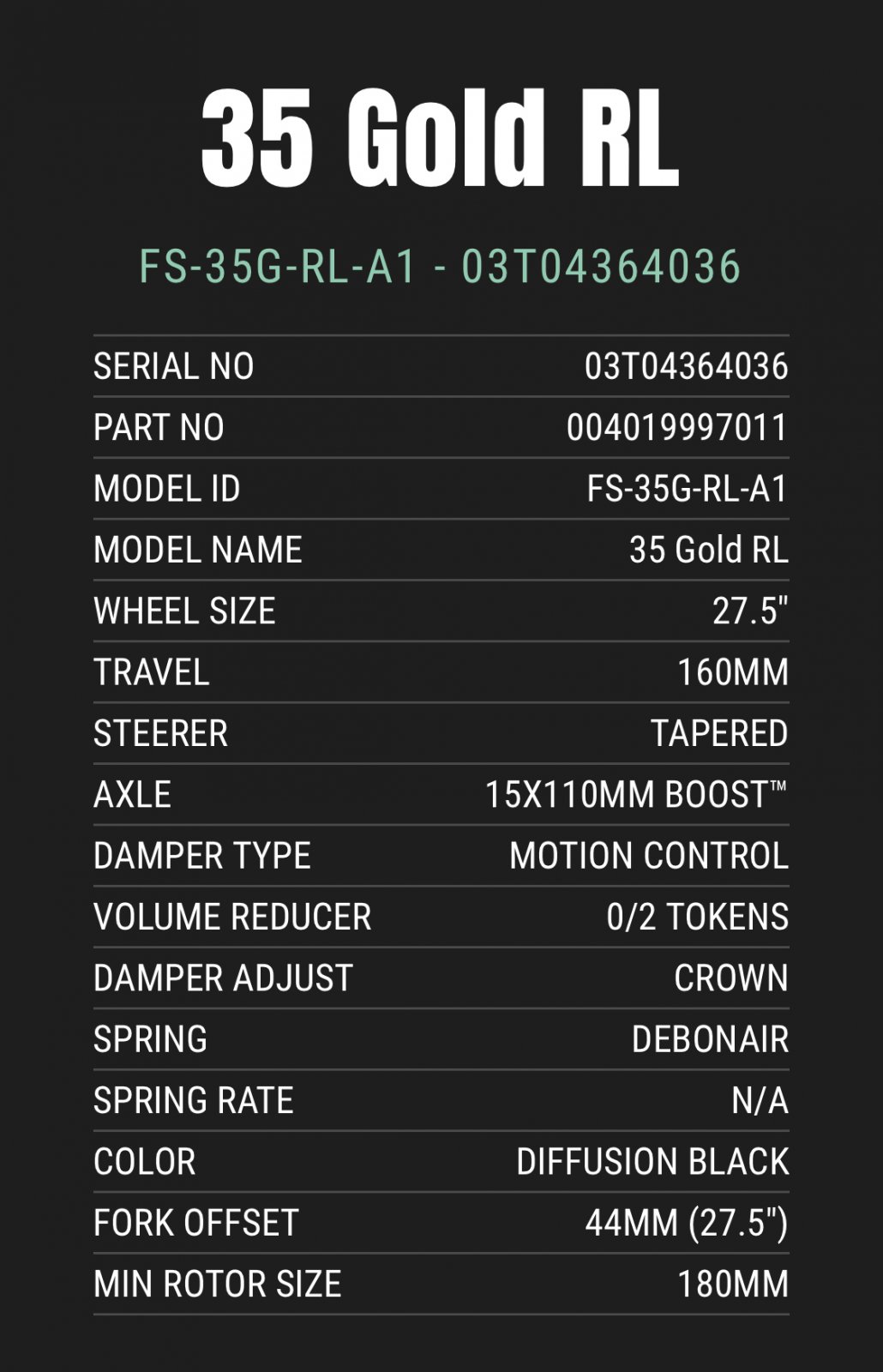

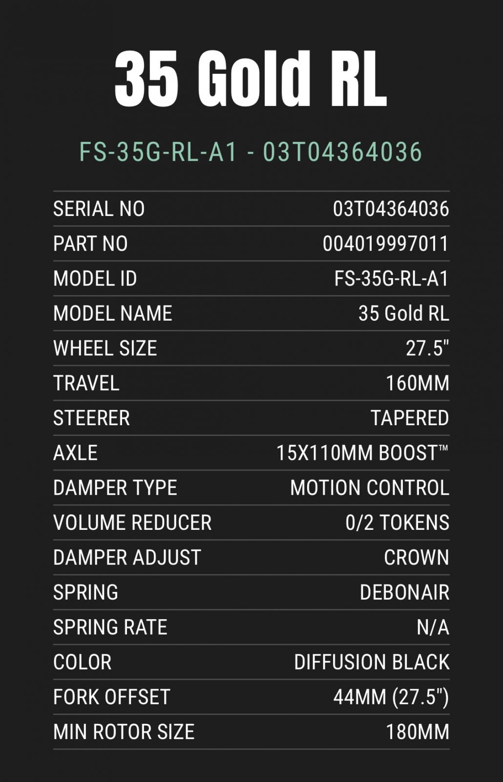

EDIT: my fork measures 170mm ?
Bottom bracket height from centre of BB to floor is a pretty low for an ebike 335mm
Stilus: The bike that just keeps giving ?‍♂️
not sure how much travel through that 170mm I’ll get so it’s likely a 160mm fork

Hope mine hasn't got a Rockshox Quadra/elastomer/60/80mm travel set up as they seem to be a bit haphazard regarding components ?.
That's interesting coupled with the 65 deg HA. ?. Slap on a 200mm and riser bars Ever and recreate Easy Rider moments as Peter Fonda (film reference for the older contingent/bikers amongst us) ?.

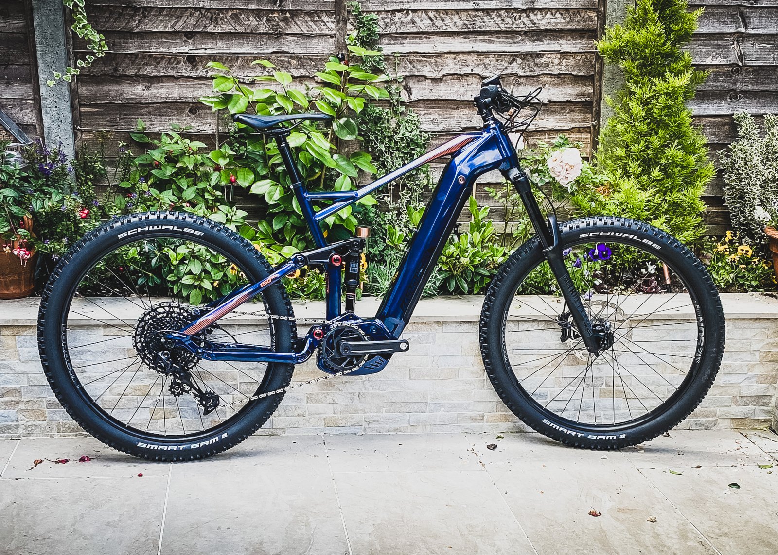

Yes for sure it’s going to be a project bike. After the initial rides / Videos I’ll put a mullet and my 160mm Puke Ultimate on it. And decent tyres.

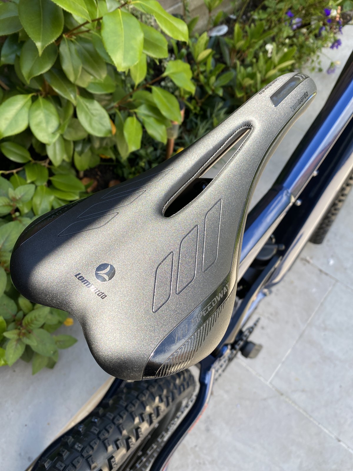

-I have the seat without the hole in it. The material is coming away where not glued properly.
