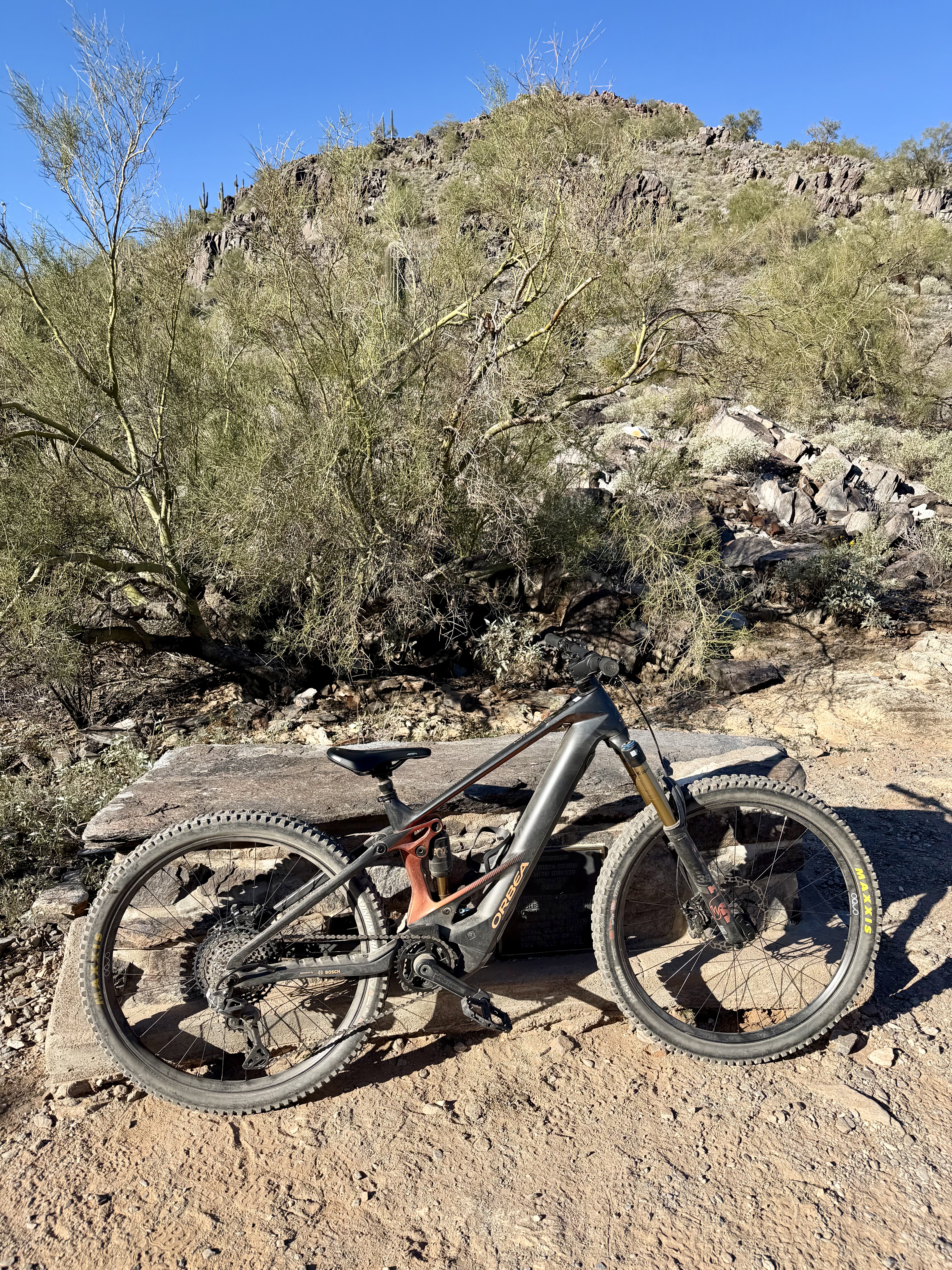

I highly recommend the Rockshox Zeb Ultimate on the 2026 Wild over the Fox 38 and you may be able to save sone €. Just switched mine out I really like how well it tracks while climbing, rides higher in the travel and feels more plush than the Fox 38.
