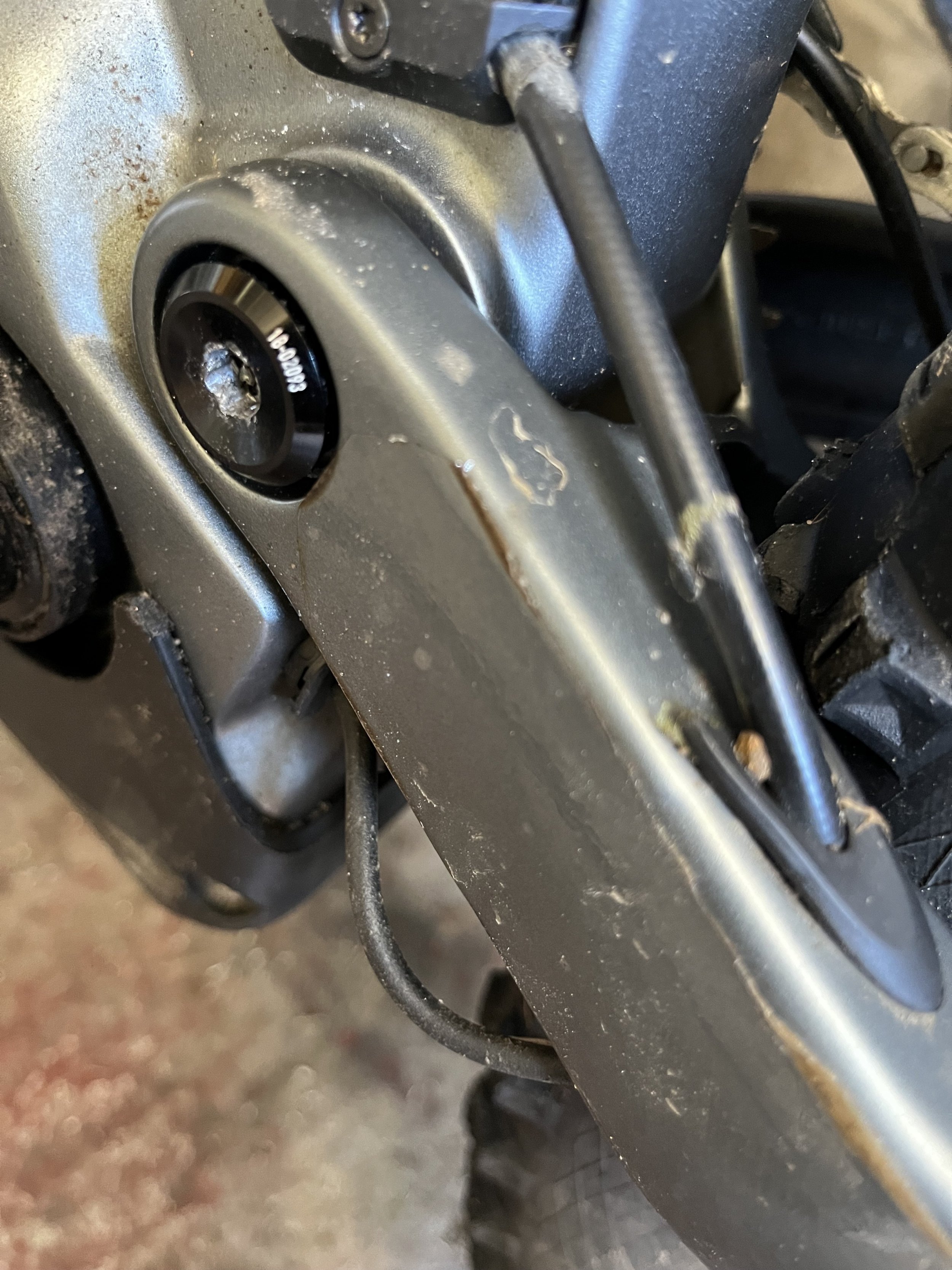

Although with my specific CUBE AT 160 HPC 500 (2019) you can't knock each bearing out from the opposite side.
There's only one side open, like a Smarties tube. Open one end. Except, for a 5mm hole on the drive-side, behind the chainstay protection tape. Non-drive side is open.
Photos:
Non-Drive Side Access to Main Pivot/Rocker bolt, and bearings. Completely blocked by cable runs. Rear speed sensor, and rear brake cable. Poor design. (Photo #1).
Drive Side Main Pivot Bearing Access, nothing but a thread where the Pivot bolt threads into the frame (Photo #2).

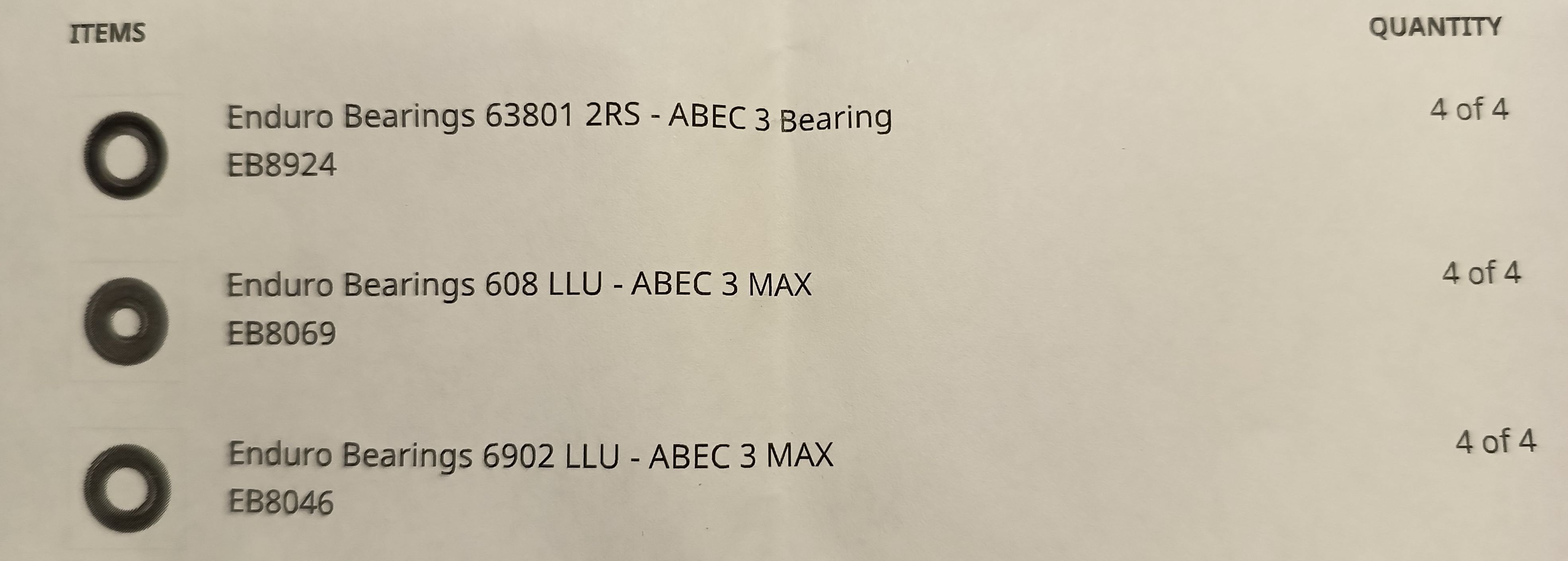

Bearings needed, for full frame service. 12 total. Not including Main Pivot/Rocker Bolt.
Main Pivot/Rocker bolt (or similar, this is not an exact match, I'm currently trying to find a MY19 Rocker Bolt):
Regards,
I think its still as I described, but you'll need to do a bit more disassembly to get at the bearing 'carrier'.
The whole lower swing arm needs removing, and you'll probably need to remove the two cables shown in your drive side picture.
Unscrew the long bolt from the non drive side and either lift up or down the 'arm' and you should see a bearing on each side of the main frame. You'll also probably discover a shaped 'washer' that will fall out of each side as you move it.
I haven't seen a 2019 frame in the flesh so I'm going on pictures I've seen in posts on this forum.
HTH

Yeah, viewing it in the daylight, it's quite obvious that the bearings should be in the main frame, and not the swing arms. Pity I went and rounded out the allen key main pivot bolt ending. I tried first with a mini-tool, that fitted but not enough torque. So I took out my torque wrench, and tried that. It turned, but far too easy. Looking down, it had rounded the hole. Turns out the torque wrench allen key size was about 0.25mm too small. Doh.
This is looking more and more like a bike shop job now.
Thanks for the help anyways. :)
If you use a Torx bit that is a bit too big and hammer it in, there's a good chance you'll be able to unscrew the bolt.
A careful spray of penetrating fluid/WD40 etc may make things easier. You'll probably need a new bolt now though.
Also check out the last post on @Beaker2135 build thread (linked on his post above)
It shows everything that you want to do.
The thread itself gives a great example of how you can build the 2019 Stereos from scratch
