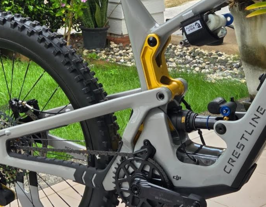

You see this guys custom cascade links? From the FB group

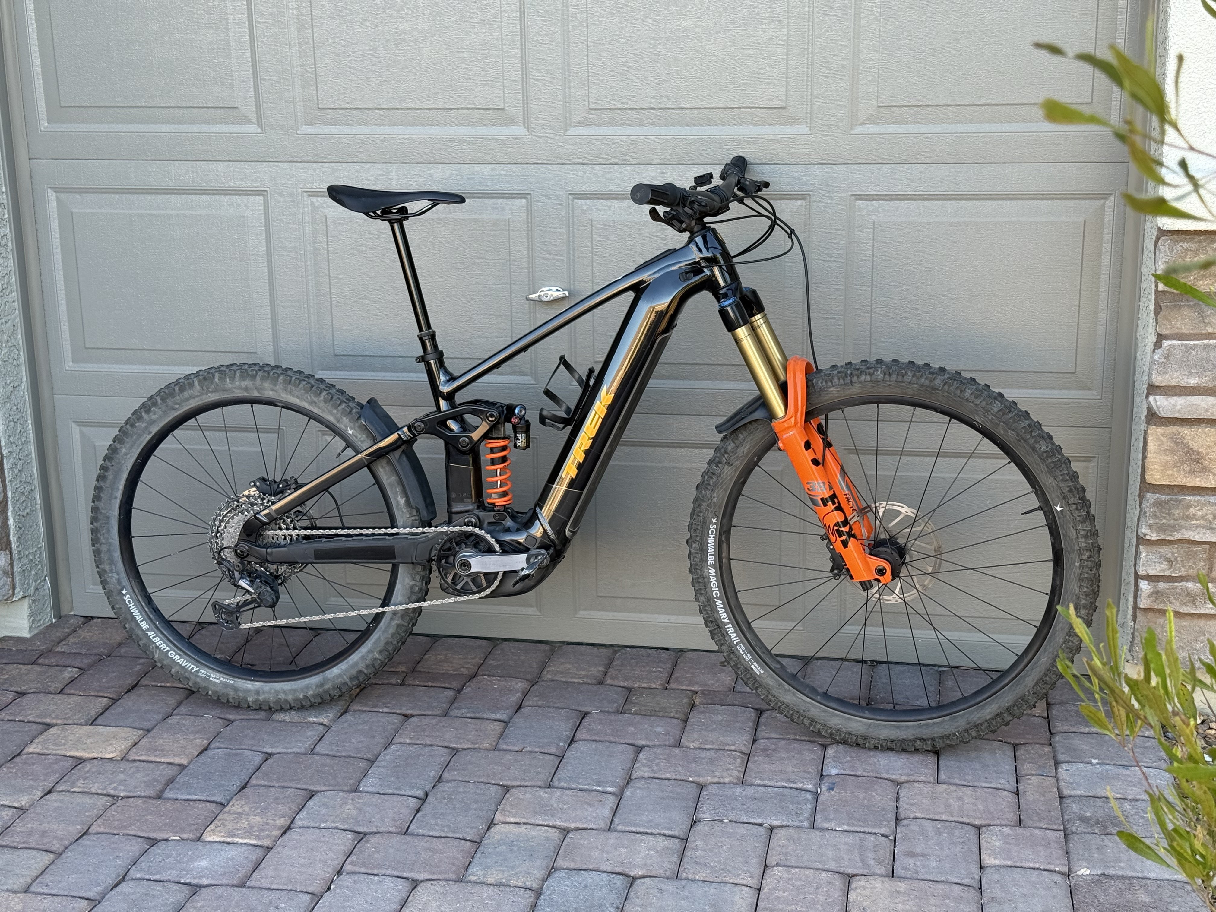

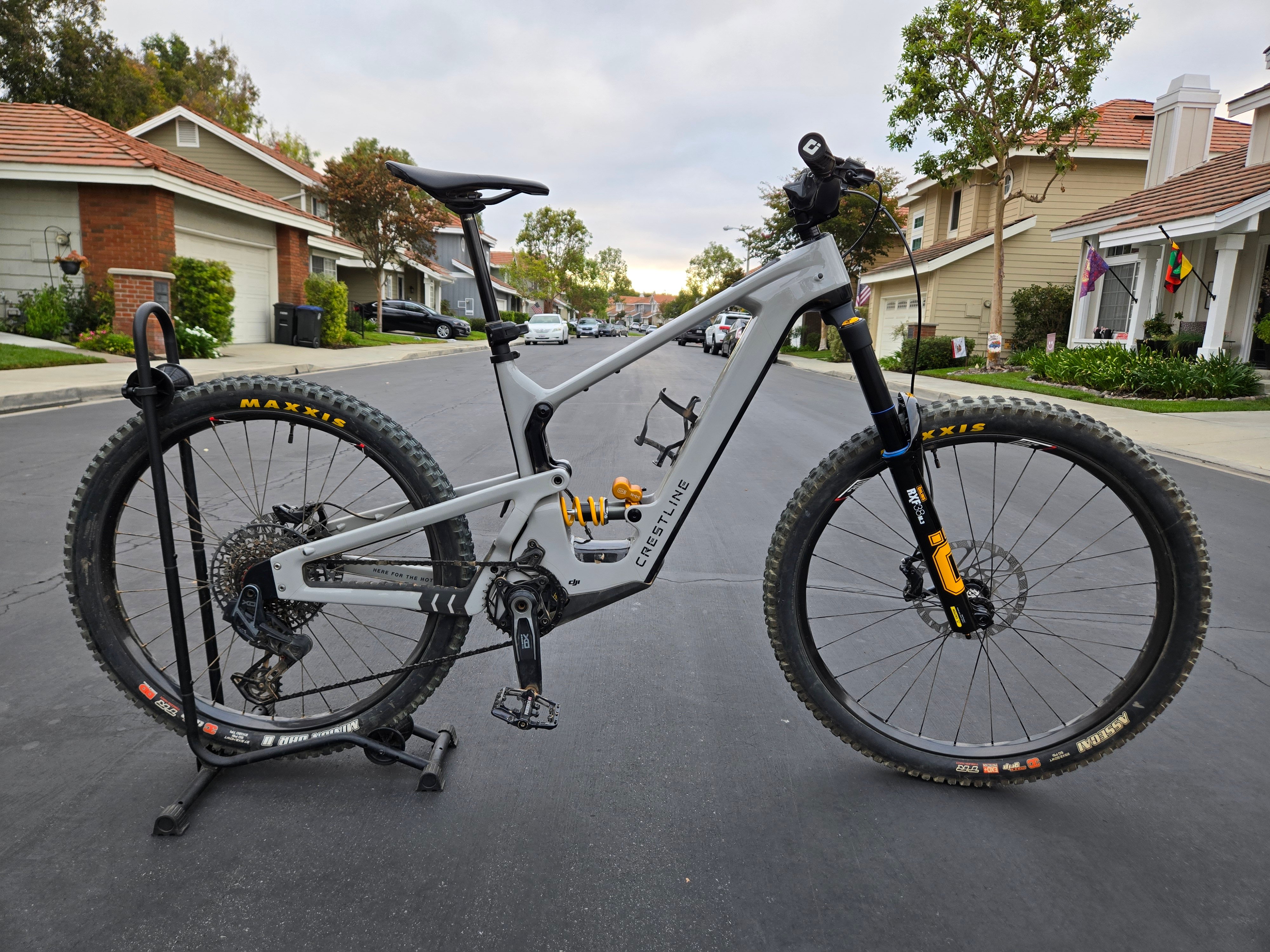

Switched to ohlins front and rear and really enjoying it with an air fork over the push nine one. The extra weight loss from the fork made the bike more playful and the bike doesn't pitch forward as much.
I tossed on a Mezzer which shaved 300g or so from a 38mm Zeb/Fox. The front of the bike feels extremely light and lively now. Unfortunately, The Mezzer is not going to win any beauty contests but it feels the most coil like of any Air sprung fork I’ve tried. No more arm pump and the bike is well under 49lbs.
Switched to ohlins front and rear and really enjoying it with an air fork over the push nine one. The weight loss from the fork made the bike more playful and the bike doesn't pitch forward as much.
Weight matters, and it's notable when it's hanging off the very front of a bike.

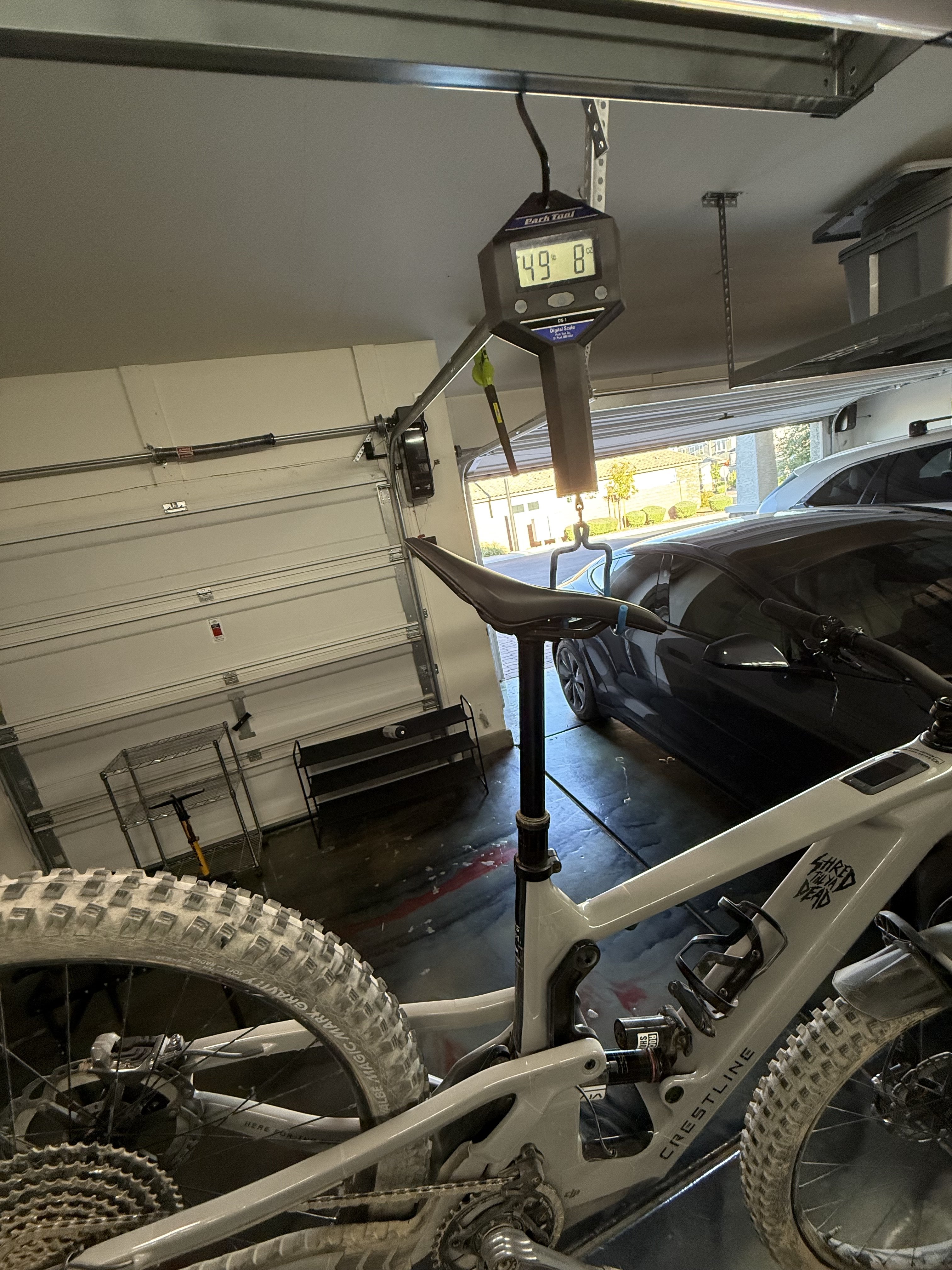

49 lbs is impressive, curious what else weight reducing components were installed. Mine (RH3) weigh 53 lbs with Fox 38, Conti Endurance (trail) tires, pedals.
49.5lbs with pedals, 48.7lbs without pedals.
Size medium. MM Gravity out back, MM Trail up front. XTR brakes and Freeza 203mm rotors. IBIS CARBON 35mm wheelset, Oneup bars, oneup 180mm dropper, 180g lightweight saddle. Of course the fork is pretty light at 2000g but it’s 37mm stanchion and reverse arch feels much stiffer than a 36 but a hair less stiff than 38. As a lighter rider, it’s been great for me.
Should be able to get it lighter with a few other changes (Mabe under 48lbs with a Superdeluxe and XX drivetrain) but not worth the extra spend for such marginal gains
Impressive weight!

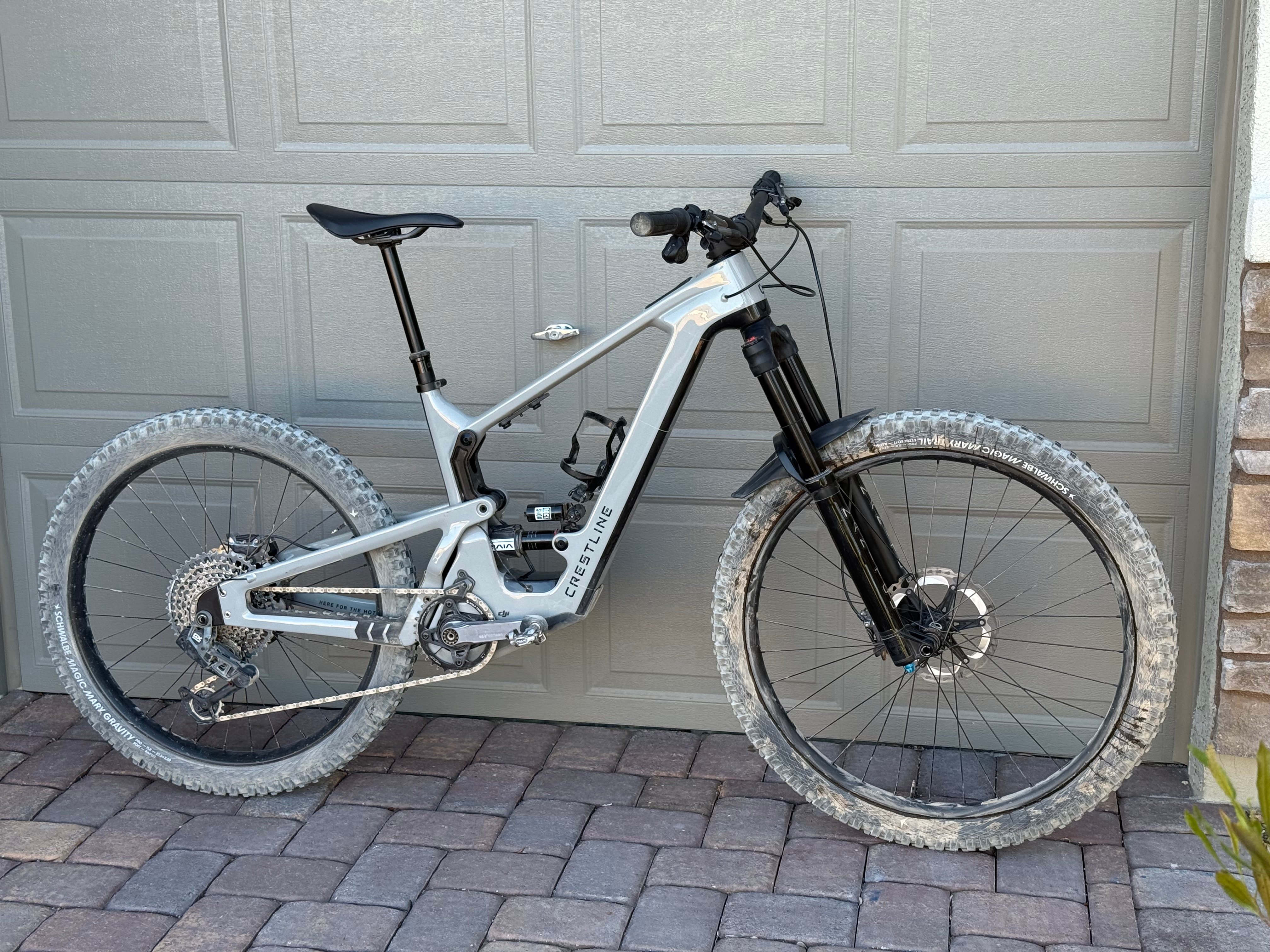

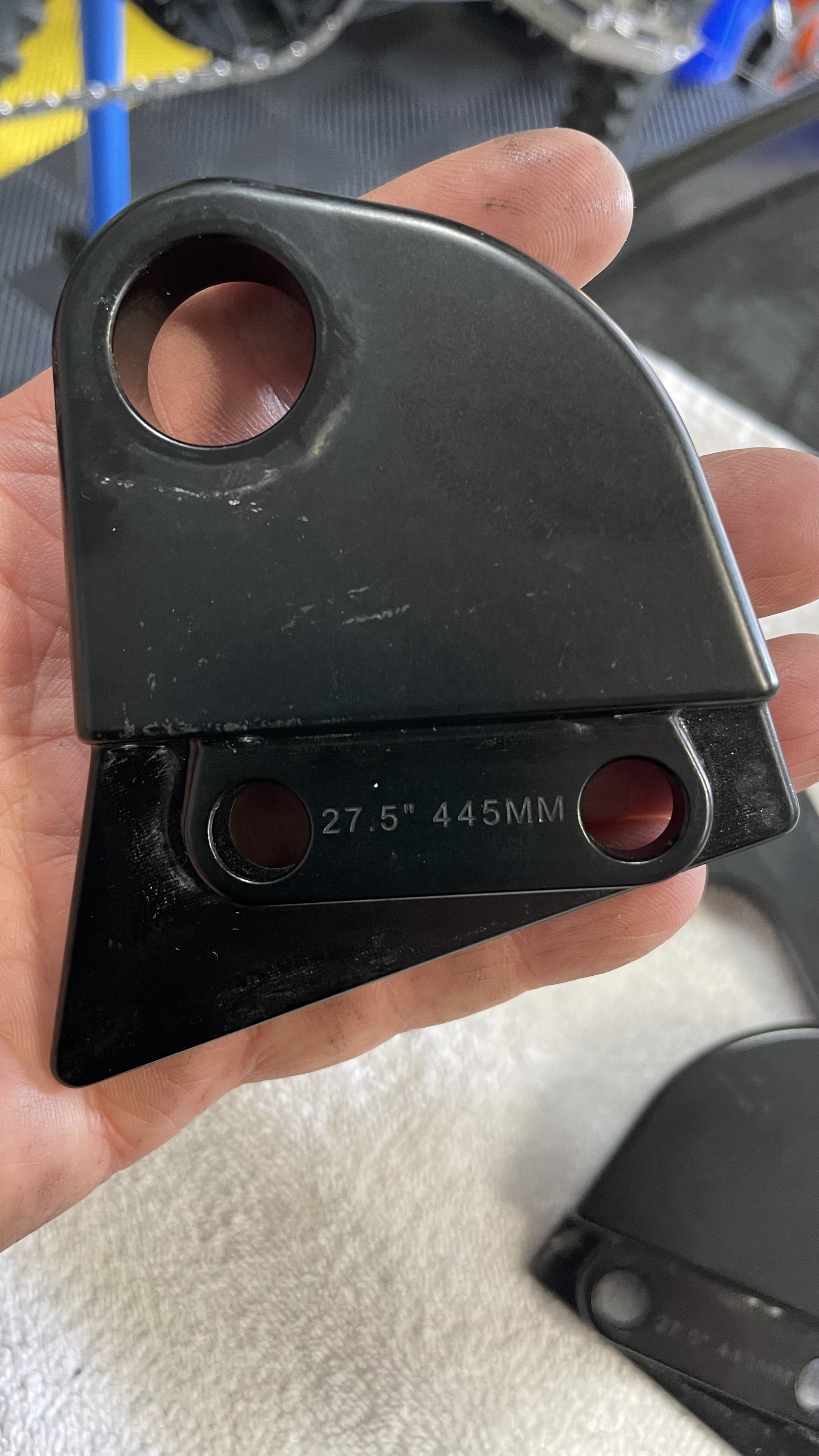

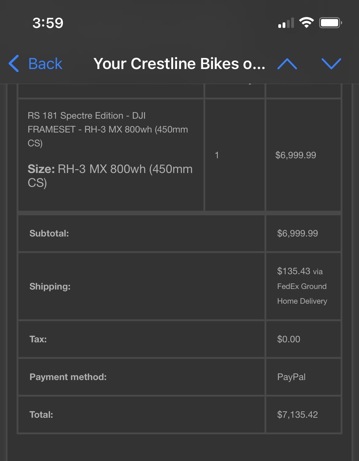

Check your dropout size!
I was swapping out the original 450mm dropout to shorter 435mm and discovered the original dropout is 445mm, not what I had ordered (450mm).

Be certain to report back with your bike and body size and the handling differences you perceive dropping from 445 to 435.
It's funny though that you requested an even longer CS length and are still apparently finding those are a bit too long.
I've wondered if a 450mm 27.5 is the same as a 450mm 29 drop out? Axle hole has to change to keep the BB/HTA the same, right?
FYI, affter checking bolt torque after the first few rides the dropout bolts were the only ones that loosened for me. That woudl be bad!
It's the same but it seems easier to rotate the bike up and manual on a 27.5" rear wheel, just because the axle is lower in the rear than the front I think.
