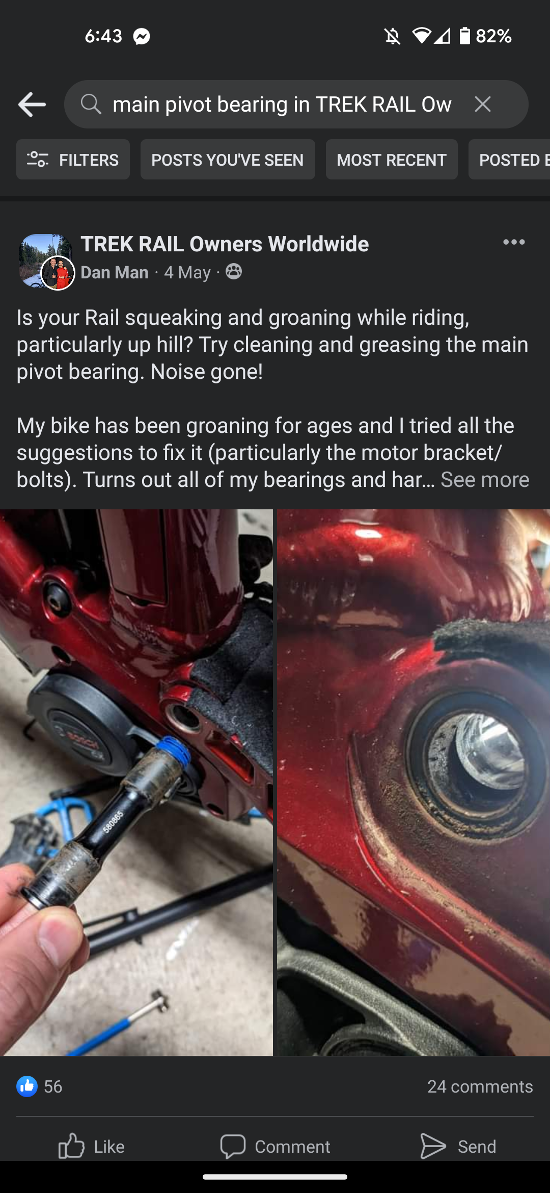

I was chasing the creeking noise around on my Rail shortly after it was new. Turned out to be the bearings at the pivot. LBS replaced those with better bearings. It’s been almost 3+ years now and no creaks. The rattling drove me crazy too…battery compartment cables.

Main pivot bearing mate. They come from Trek with barely any grease on them. Take it out, clean the bolt and bearings and reinstall with a generous amount of grease. I do this after every muddy ride.
