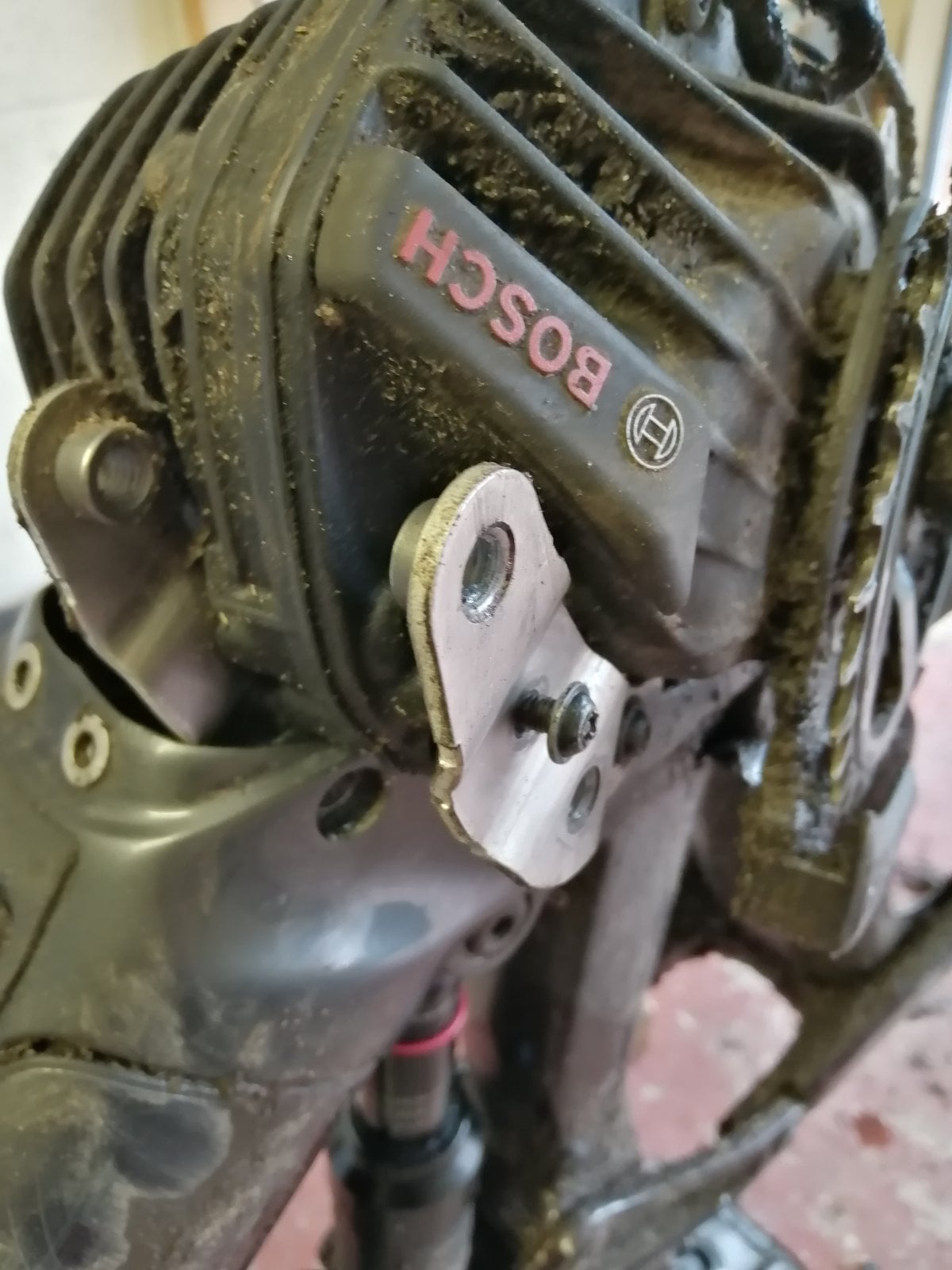

I had your symptoms.
It was a loose motor-frame mounting plate (4 in total on motor using 8 bolts)
TS25 5 point star tamper proof.
Link
Nov 22, 2020
151
139

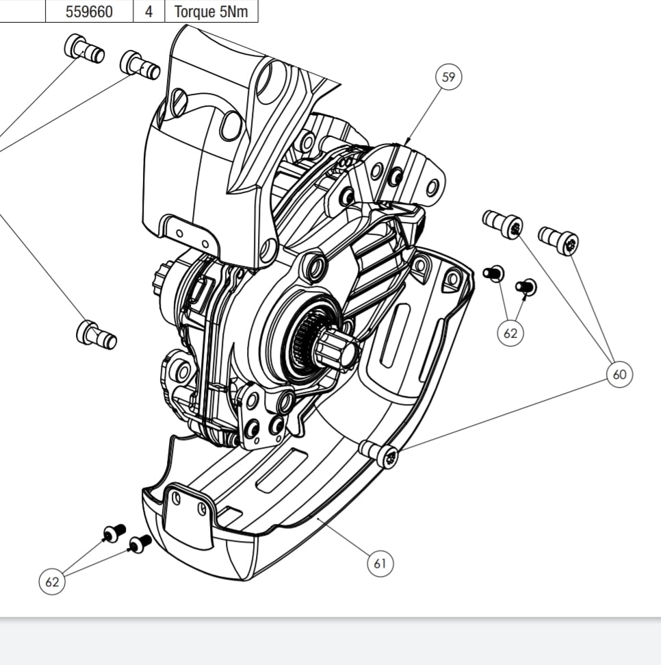

Which bolts are those ?, I checked and tightened these 6.
JMD
Jul 26, 2019
96
65
Staffordshire
So did you have to remove the motor to get to and tighten the plates ?
Yup,
Take off bash guard
Remove 6 TX40 bolts
Lift up motor, no need to unplug any wiring
1 of the aluminium plates was loose, I could move the screws with my fingers.
Luckily I caught it before it damaged the plate severely.
& A dab of paint on all 8 bolt heads to see at a glance if bolts move again

Yup,
Take off bash guard
Remove 6 TX40 bolts
Only M5 thread so just screwdriver tight, don't damage thread on motor casing.
Didn't have locktite on bolts originally, so didn't use any kept it standard.
Possibly because motor heat could 'unlock' the locktite.
The 6 TX40 bolts do have blue/medium locktite on as standard.
Ok, so the original clicking has gone, but then at the end of the ride I got another creak ! ?, Same place or origin, the motor/bottom bracket. I have done as you adviced to check those bracket bolts but my cheap tamper proof torx have a too small hole in them so I cannot check them. Ordered a set for tomorrow. Will check they are tight. Failing that I am going to put a bit of copper slip into the mating surface between the mounting plate and the ally plate in the frame. There will always be a small amount of movement so could be the cold which makes the small amount of flex make a noise. The bike was silent for 2 hours into the ride than after a few muddy puddles and 3 hours of zero degree weather it started creaking. Fortunately I can make it creak by pushing on the crank arm so should know when I have fixed it. Oddly after I washed the bike and gave it a quick test ride the creak went away, so it's def a small amount of movement induced by the cold.
Did you put extra Loctite on the 6 motor bolts ?, They have some on them from factory
JMD
Jul 26, 2019
96
65
Staffordshire
I did put blue/medium locktite on the 6 TX40 bolts (that's what's on them from new)
The 8 bracket to motor bolts aren't torx tamper proof.
They are TS25 5 point star tamper proof.
Torx are 6 point.
One of my mounting plates was so loose I could move it and the bolts by hand.
If this is your issue you shouldn't need the tool to diagnose this.
