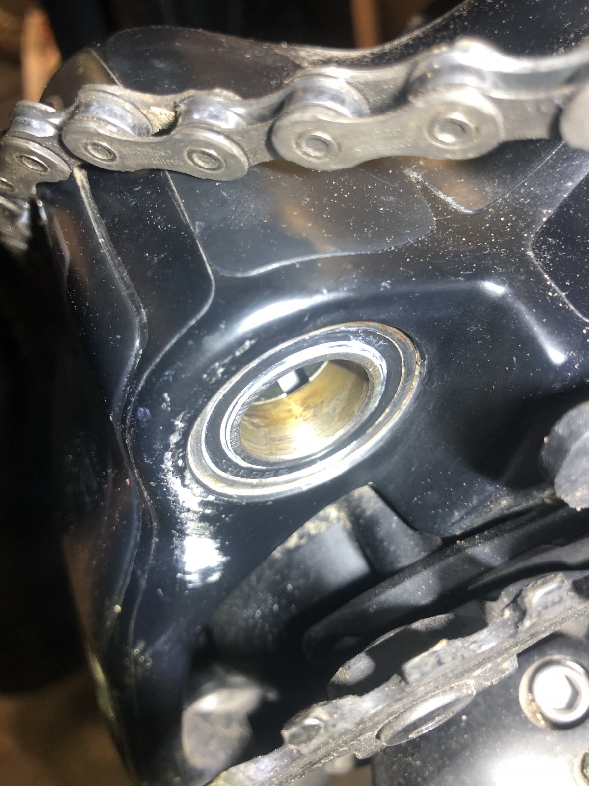

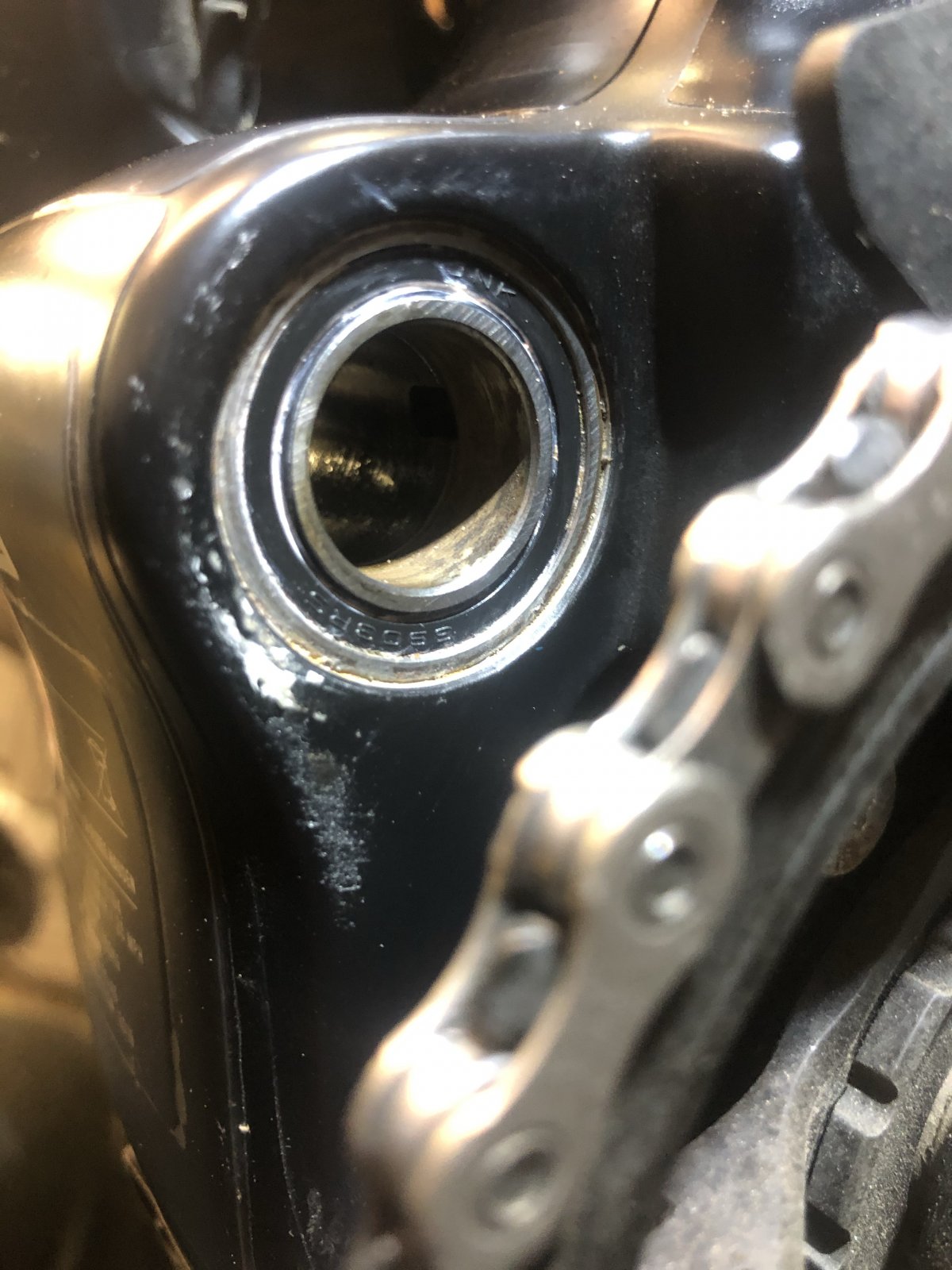

Found the issue. Grease gets displaced after a couple of rides and the taper washer rubs on the main pivot axle creating the noise in the video.(metal on metal contact).
Faulty design from YT. so unfortunate :(
I packed it with even more grease and increased the torque by 20% on the taper washer screw.

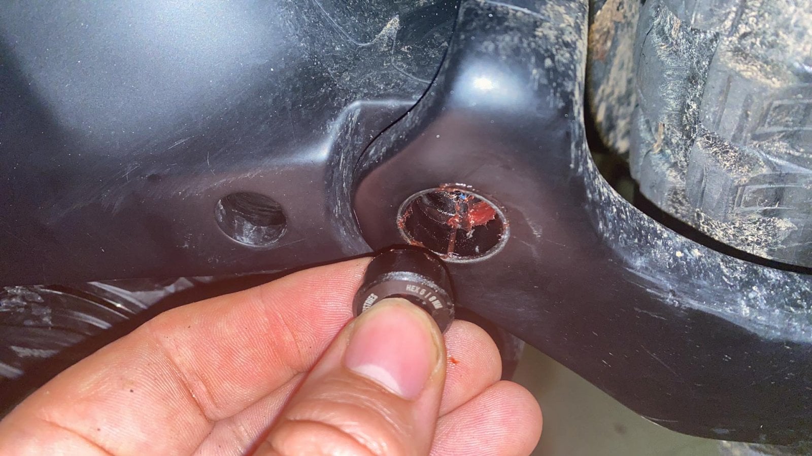

Ok, so it was the motor mounts for my bike. They just need to be snugged up a bit. A new one for all. I also have to say, once Again, YT USA was simply awesome. They led me through a entire scenario from top to bottom. First think they say was "sorry", and we'll get you taken care of. They were bending over backwards and had me know they would 100% take care of me. "call us back for anything". So for all the YT complaints out there, I can only say I've had excellent service and support. Way to go YT and my bike is soooo silent now.

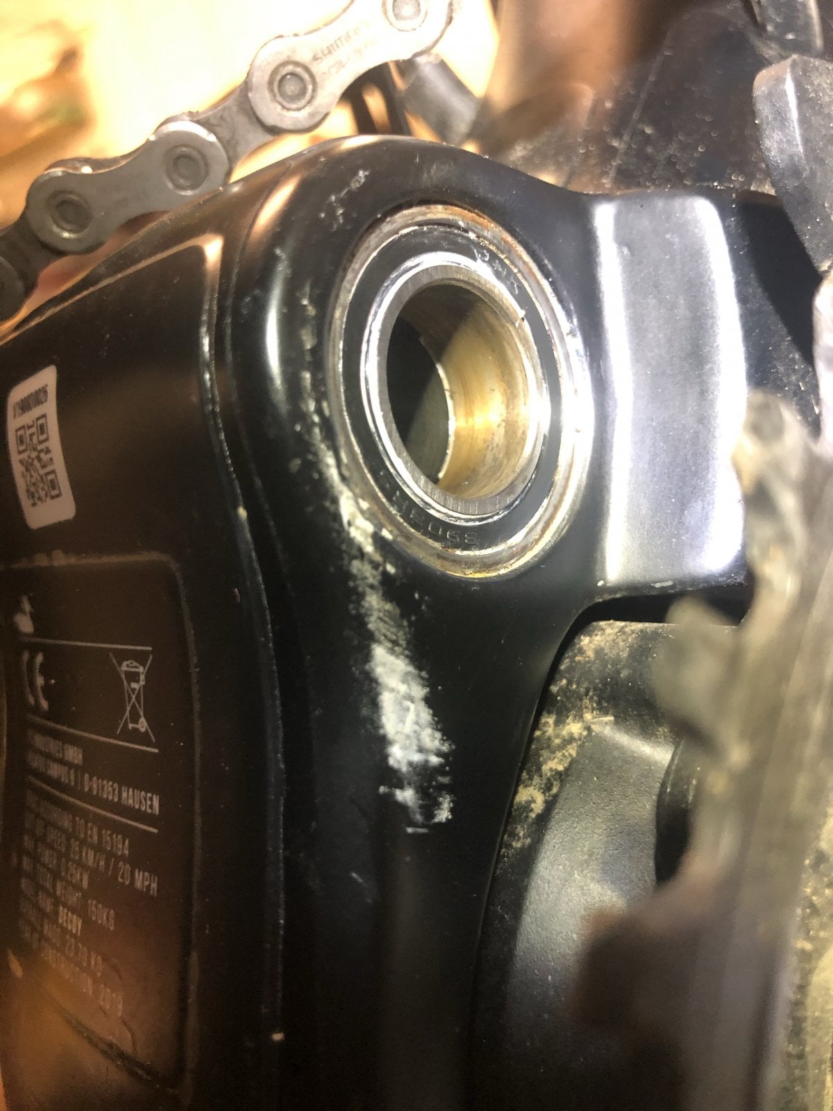

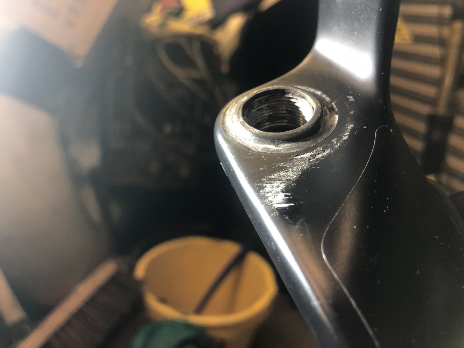

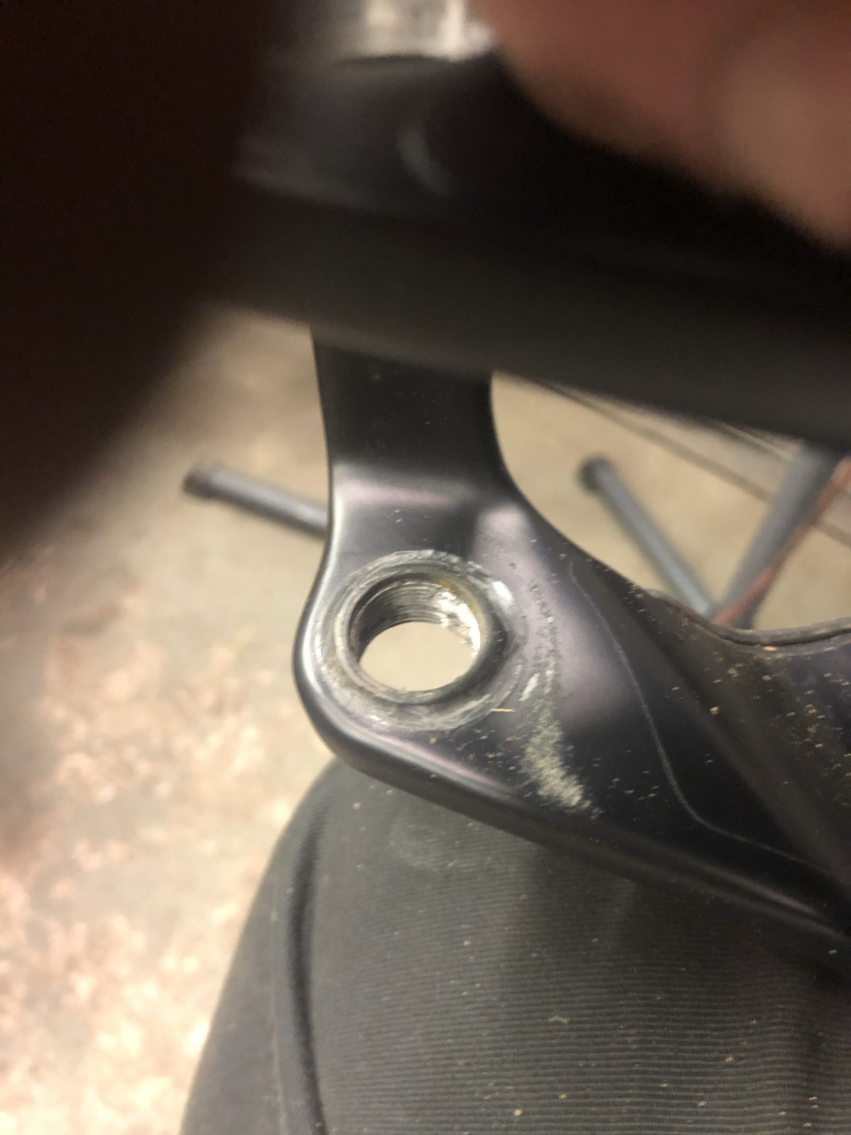

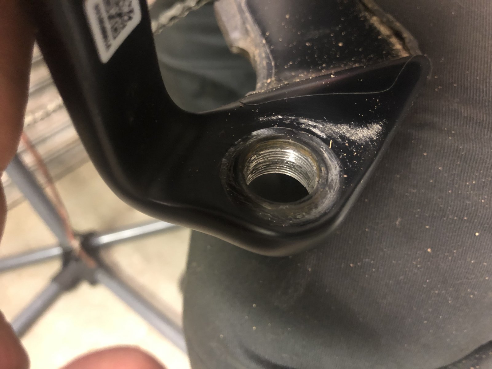

Yesterday I had a very similar noise so tonight after work I had a look if I ride the bike sat down no noise but when riding stood up the noise was present. So into the garage an lent the bike over and pushed the frame sideways an the noise was there held different parts an I could feel it creaking through the frame. I put it on the stand an started to strip it down an this it what I found. It seems like the chain stay is too close to the frame there is a small seal/shim between the bearing an chainstay, so just to prove my theory I made a shim to fit in there an space it out an it’s now all good it has clearance. Noise gone but surely that can’t be right I will be speaking to yt I would show vids but they won’t load at the mo

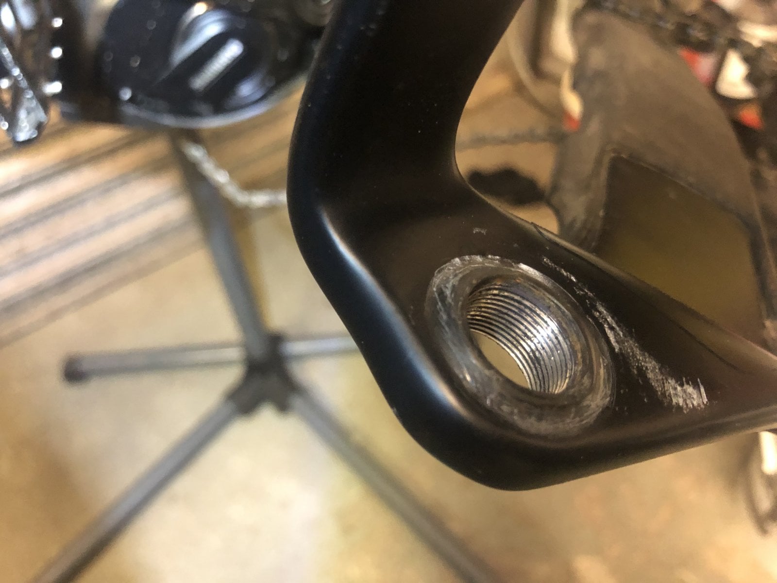

Did you ever find a long term solution to this? I have the same issue and can't get it solved. If I take out the taper washers and grease them the creak is gone for a couple rides, but then comes back with a vengeance.
In an act of desperation I put a little carbon paste on the taper washer thinking it would prevent any movement. It did and actually solved the creak, but as might be expected the taper washer was then frozen stuck in there. When I tried to remove it a couple months later and I had to mangle it to get it out and replace it. So it isn't a viable solution. So I just greased the new one again and the creak is back. Ugh.
