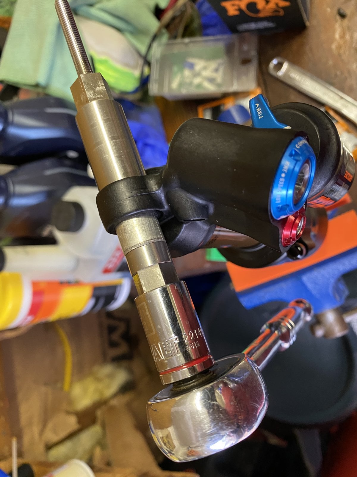

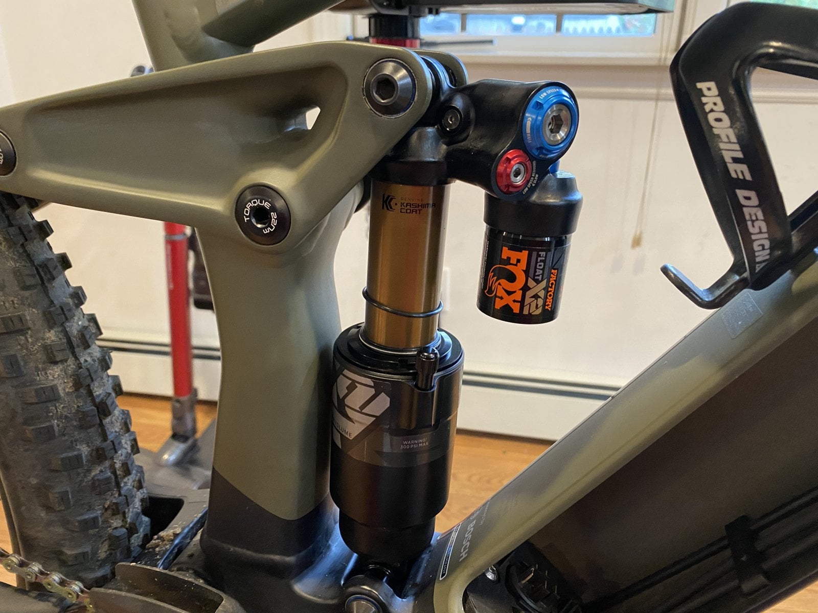

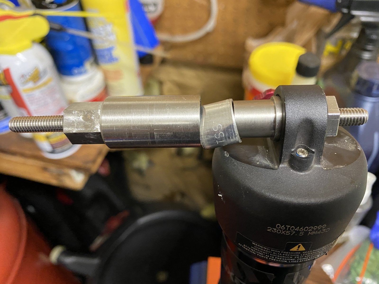

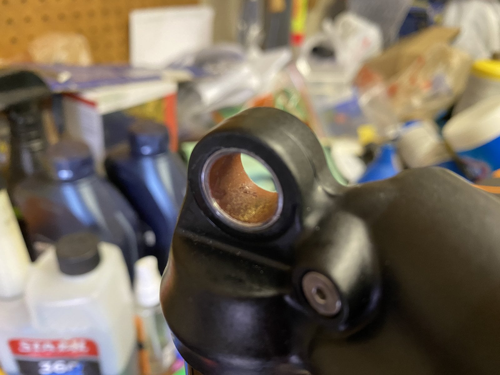

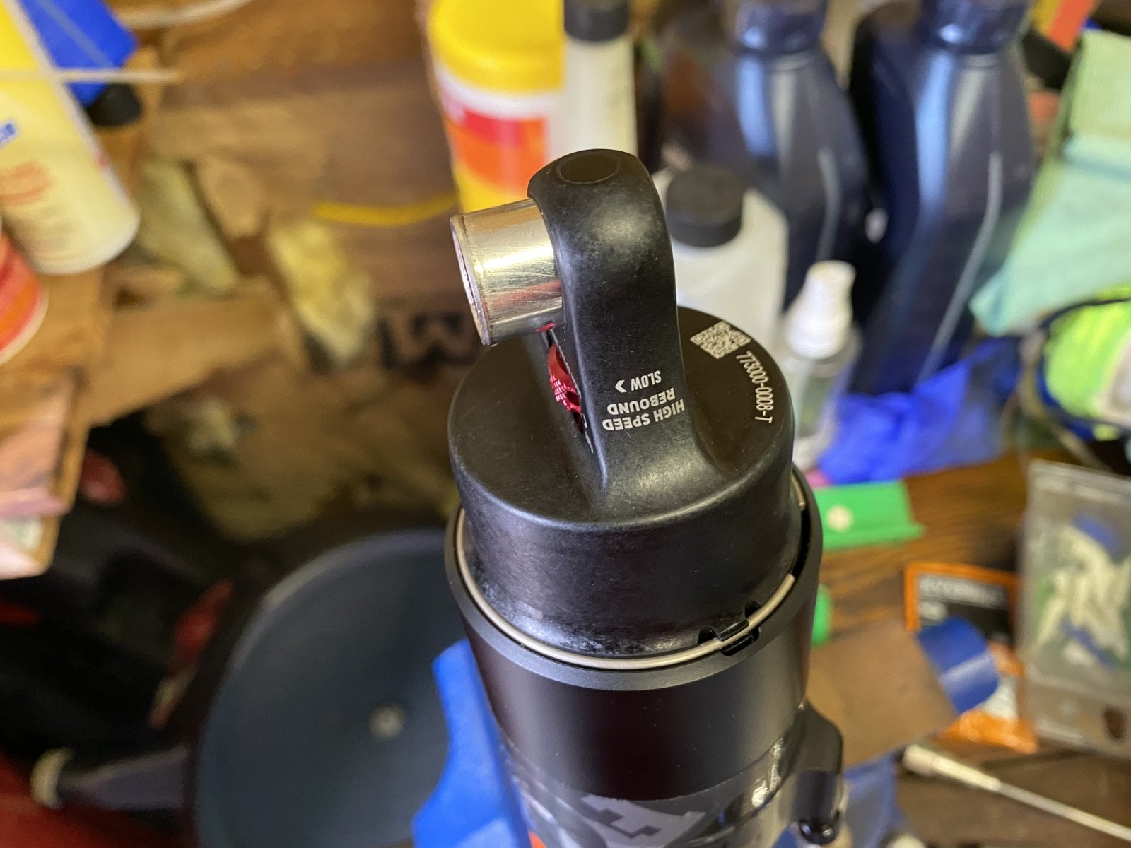

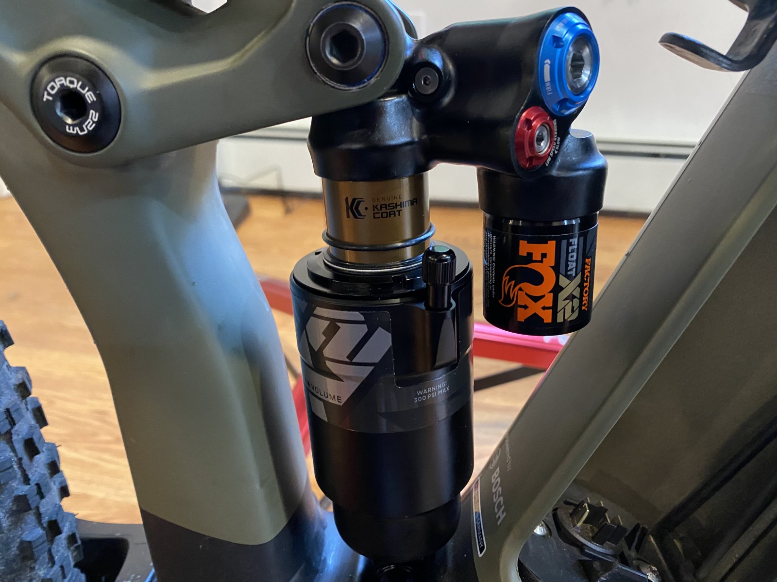

Just installed a Fox Float X2 on my Trek Rail 5. Got differing information as to whether or not I would need entirely different hardware to mount a different shock or if I could use the stock mounting hardware.
Have confirmed it can be used.
Using bushing tool to press out DU bushing from stock shock.
Old DU bushing about to be pressed into new Fox Float X2.
Pressing old DU bushing into new shock.
Old DU bushing now in new shock.
Fox Float X2 mounted to Trek Rail 5 using mounting hardware from stock Rockshox shock.

Hi Budd
What size frame ???
What stroke is the shock???
And deffo doesn't hit frame on full compression????

I can't compare to the Reactiv shocks. I did this upgrade on my Trek Rail 5 which comes with a Rockshox Deluxe Select+ and not the Reactivated shock.
For my riding I needed low speed compression adjustment which the Rockshox did not have and more range of adjustment for high speed rebound. The X2 has a more high speed rebound adjustment range than the Rockshox.
I still have more dialing in to do but the X2 is more in tune with my riding more than I could get the Rockshox.
