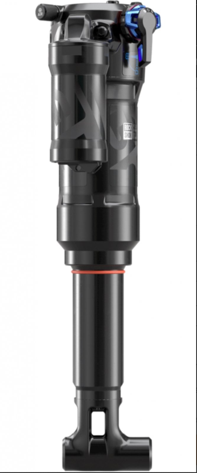

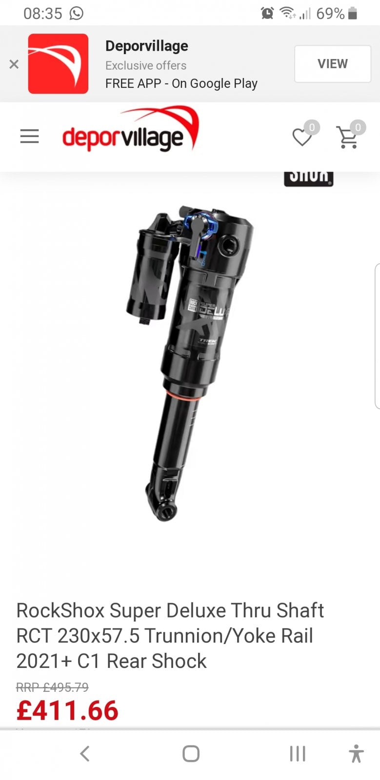

So I was in the process of swapping my forks and shock over to fox , brought a 38 and dpx2 but couldn't get on which the 38 , so went back to the lyrik which I love , but I cant have fox on the rear as my OCD wont allow it , I'm thinking of buying the rockshox super deluxe that comes with the 2021 models what are peoples opinions on it ?

I have one, really nice shock. I run a coil most of the time as I prefer the feel but the ultimate air is super plush on the small stuff, not a million miles from the coil. Impressive.
I just had one fitted to my 2020 Rail as a warranty replacement.
It's night and day better than my original re activ one.

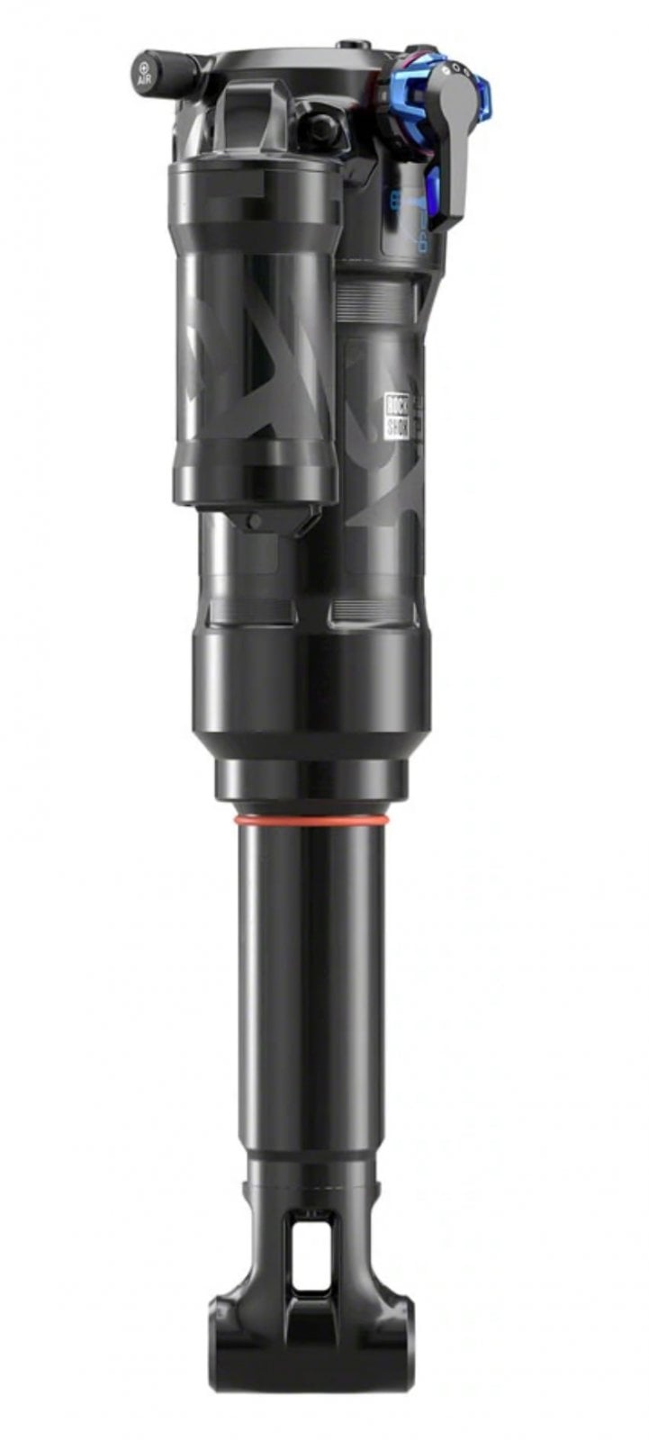

I finally found one. I ordered it from the local Trek dealer. It’s much better than the Deluxe Select + that came with the bike. I’m very satisfied.
Looking to do the same thing, (2020 rail 7 large). After reading about reservoir clearance problems this thru shaft looks like a winner. Other than replacing the two top shock bolts is this a direct fit?
Yes it is a direct fit. You’ll need the top and bottom bolts. They about fifty bucks U.S. for all four. Make sure you get the shock with the 40mm bottom mount not the 50 mm asymmetric bottom mount.
Thanks Bupkus, looking at treks website they list this shock as a replacement for the slash with two travel options (M tune on compression and rebound). Is this tune correct for heavy rail? With gear I'm 185lb.
Doesn't mention anything about reactive (which I do not want).
The Slash/Remedy shock has the 50mm offset bottom mount. You want the shock that is Rail specific that has the 40mm bottom mount.
