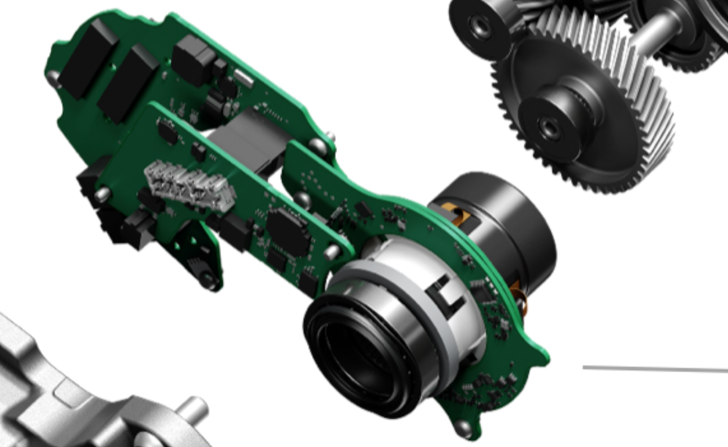

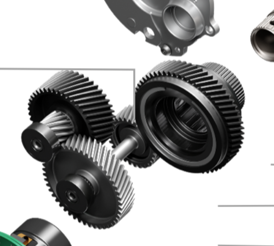

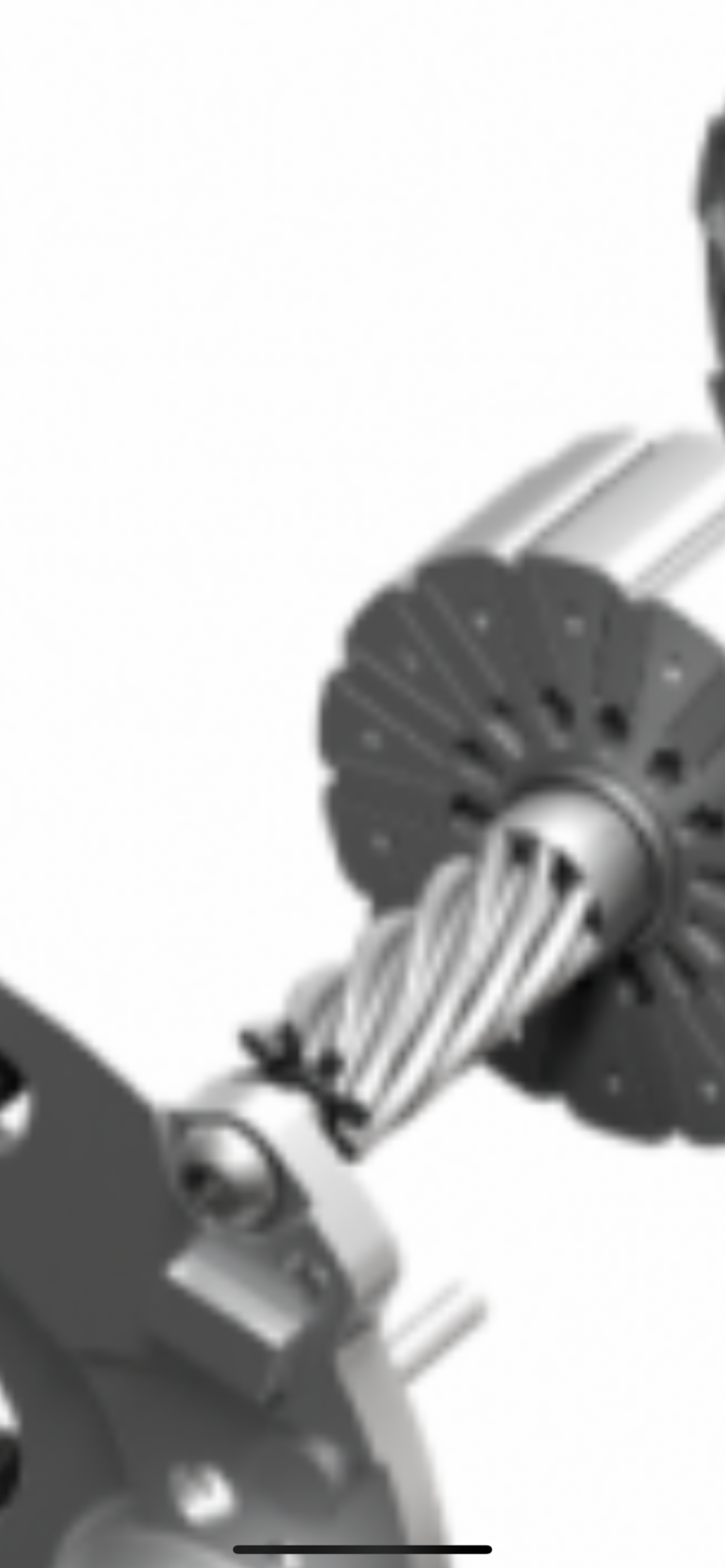

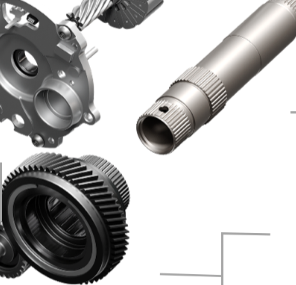

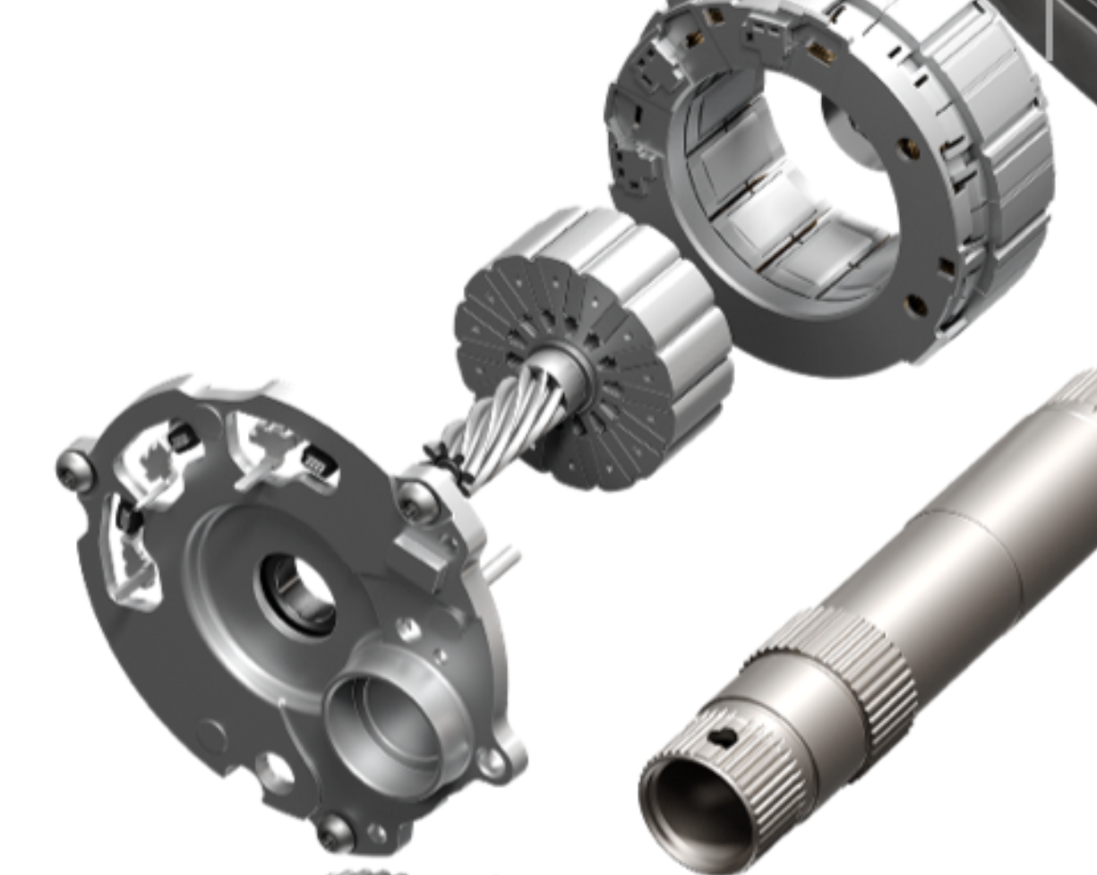

You can clearly see the problem :
None of the gears or parts touch each other ! ;)
@Bearing Man any thoughts .. this could be our first EP8 failure ...
Some zoomed images ..
I can confirm that the twisty component shown below is widely available in assorted colours.

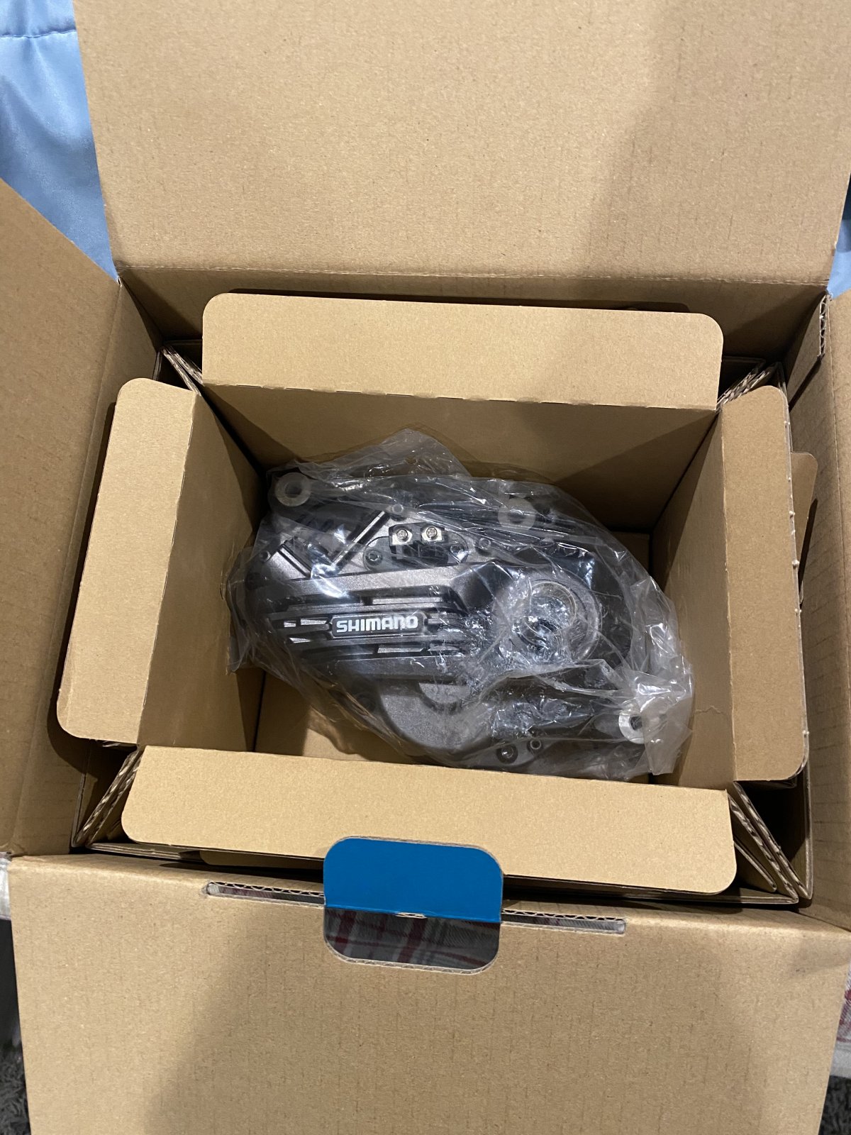

Update: Shimano approved the warranty claim and said they should be shipping out a new motor within 7-10 days.
Don’t like that this happened in the first place, but seems like both Commencal and Shimano corrected the problem as soon as possible given the holidays and heavy back orders on everything.

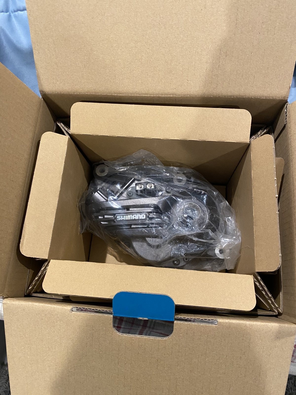

I was more than happy to do it myself. I don’t like other people working on my bike, and I also don’t like being without my bike for an extended period of time. Commencal had Shimano ship the motor to my doorstep, and asked nothing in return. I am able to swap the motor in less than an hour with only the tools in my toolbox. Everything works perfectly fine, and I was able to complete this small service item from the comfort of my own home.
And I sold the old motor on pinkbike for $600. Just kidding, lol. I do still have it though.
