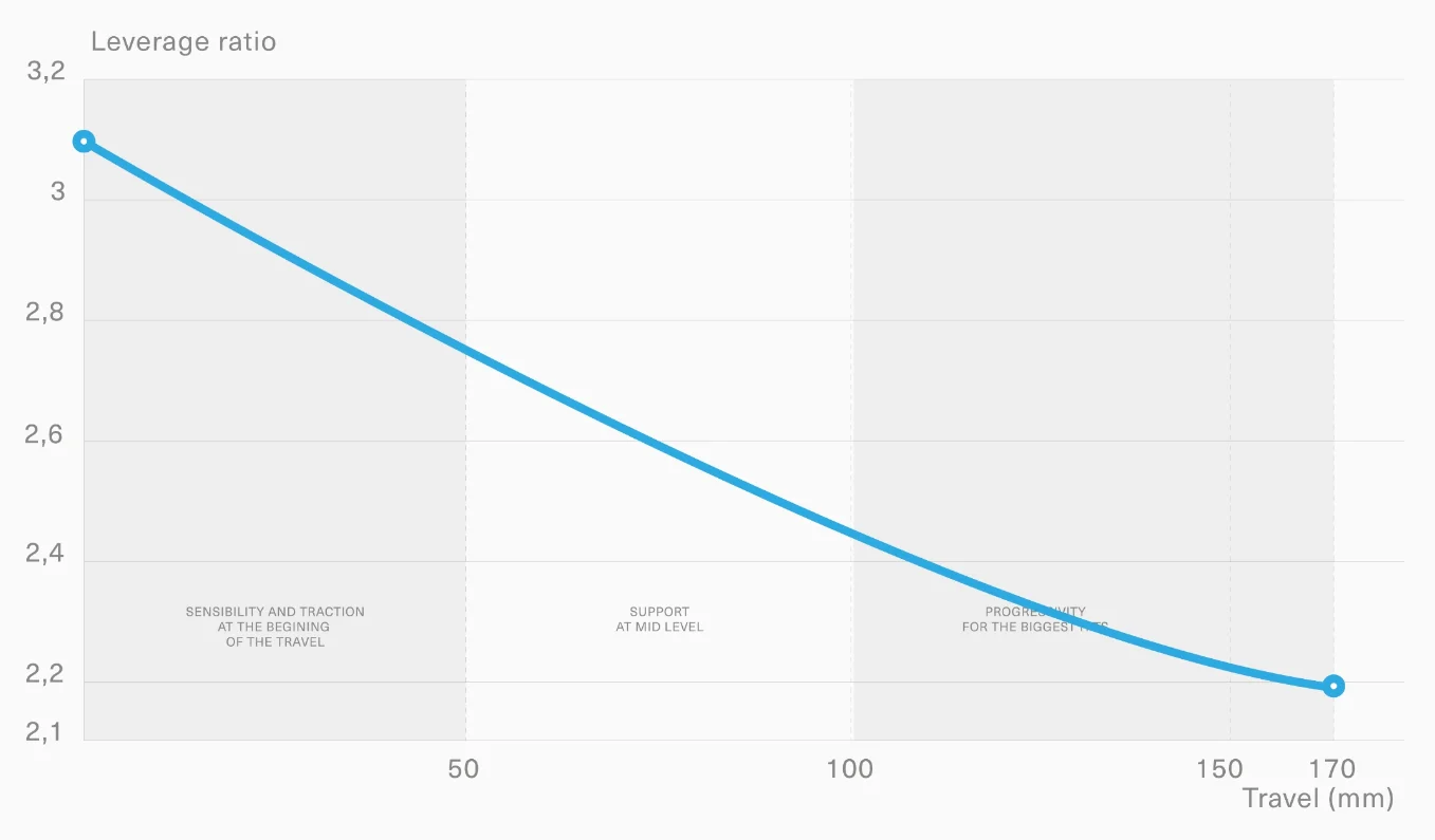

I know that you are an experienced rider but combining a very progression rear suspension design of 170mm of travel, with a progressive coil spring, generally is a bad choice.
Usually, it results in a suspension that is really squishy off the top that typically pedals poorly (plush!) and then hits a massive wall of progression and sort of feels like you are smashing into a solid rubber ball at the end, usually well before all travel is utilized.

Definitively not arguing, just opening the lines of communication.
Below you will see the current Orbea Wild's Leverage chart, which I would consider ideal for a 170mm travel bike at 30%.
A few things to keep in mind are: 1) once a bike starts hitting 35% progression, they really don't work that well unless they are short travel or they are bikes used for really huge hits, think rampage. Below 20% on a 150mm + bike sort of sucks too. 2) the more travel you have, technically the less progression you need for the same hit as you now have more time to absorb the energy from the impact, 3) more linear, definitely pedals better as progressive bikes tend to be more plush off the top and then sag in the middle. With my trail bikes I always run the least amount of overall progression that I can live with by running the least amount of air colume tokens that I can get away with. On an e-bike, well it's much less important to pedal well. But still, even on your big bikes you don't want to have it crazy progressive unless you use that on the regular, 4) Also worth noting the leverage ratio shown is the bike frame kinematics and different shocks to not change the inherent frame progression.
Given all this, I wouldn't even test a progressive spring on a Wild, but then I have no intention of testing the air shock either.
The guy I ordered my Wild from has one and he really raved about his coil shock with a linear spring, which is what I would expect when paired with that leverage ratio. He said it became very plush, with great mid-stroke support and he could finally use all of the suspension. I'll be running my own Wild with a coil shock.
One adjustment I did make was to bump up the LSC a couple notches thsn when I used a linear coil.
A few things to keep in mind are: 1) once a bike starts hitting 35% progression, they really don't work that well unless they are short travel or they are bikes used for really huge hits, think rampage. Below 20% on a 150mm + bike sort of sucks too. 2) the more travel you have, technically the less progression you need for the same hit as you now have more time to absorb the energy from the impact, 3) more linear, definitely pedals better as progressive bikes tend to be more plush off the top and then sag in the middle. With my trail bikes I always run the least amount of progression that I can live with. On an e-bike, well it's much less important to pedal well. But still, even on your big bikes you don't want to have it crazy progressive unless you use that on the regular, 4) Also worth noting the leverage ratio shown is the bike frame kinematics and different shocks to not change the inherent frame progression.
