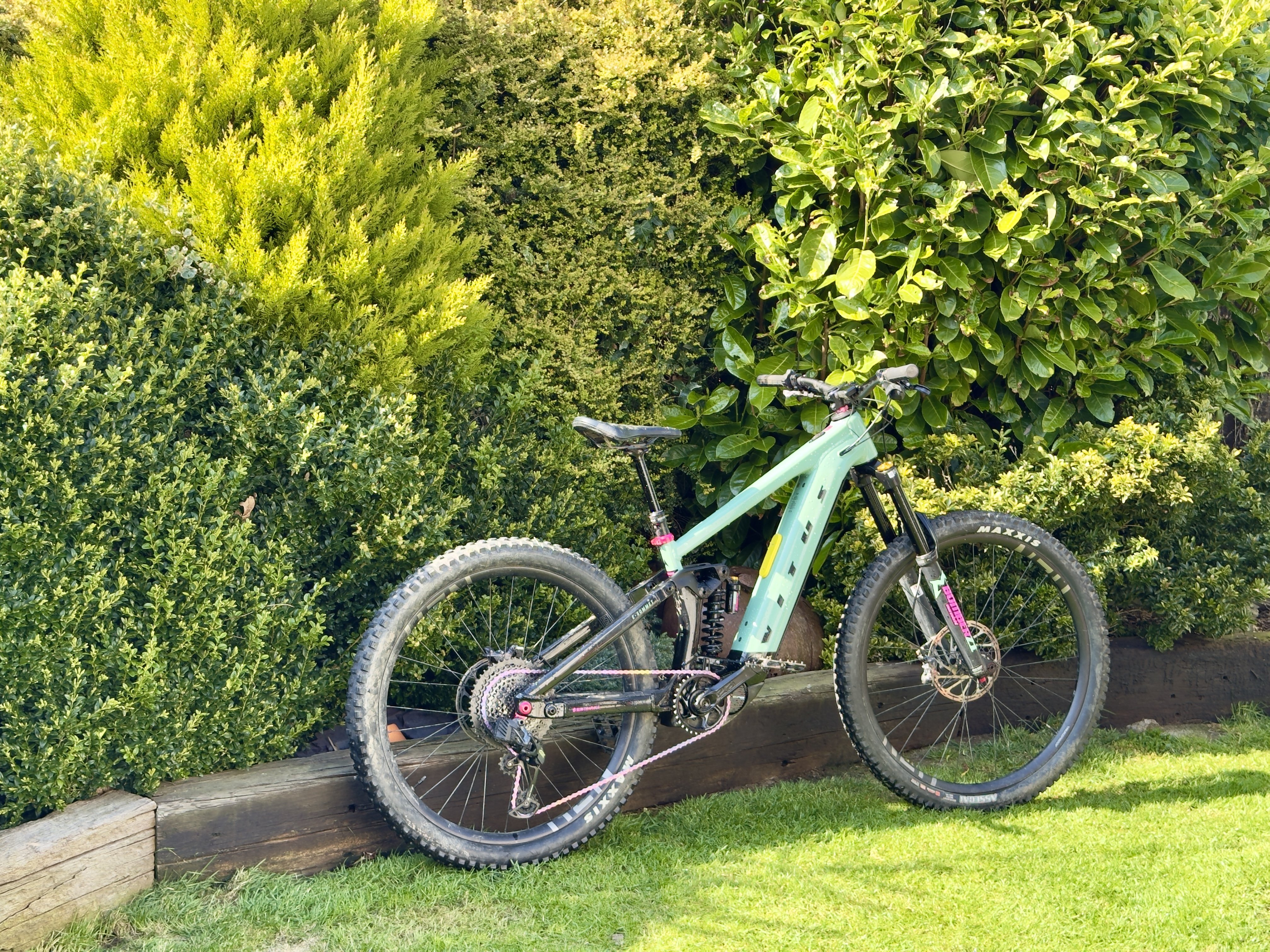

So recently i swapped out my rear shock to coil and wished I'd done it sooner.
Now looking at fitting either
Marzocchi Z1 coil or DVO Diamond.
Anyone recommend or have experience of either ?
I come in at around 95 kgs so a firm spring going by the charts
The DVOs come in a near match blue to my frame so 1 point for them ( as I'm a bit of a bike tart )
Have spare Rockshox Zeb Ultimate A2 which I'm thinking of putting Vorsprung Smashpot V2 coils in, but a lot of weight gain from my current MY23 Lyrik Ultimate (which I prefer to the Zeb).
Wonder how the coiled Zeb would compare with the Marzocchi Z1 coil and DVO Diamond ...
