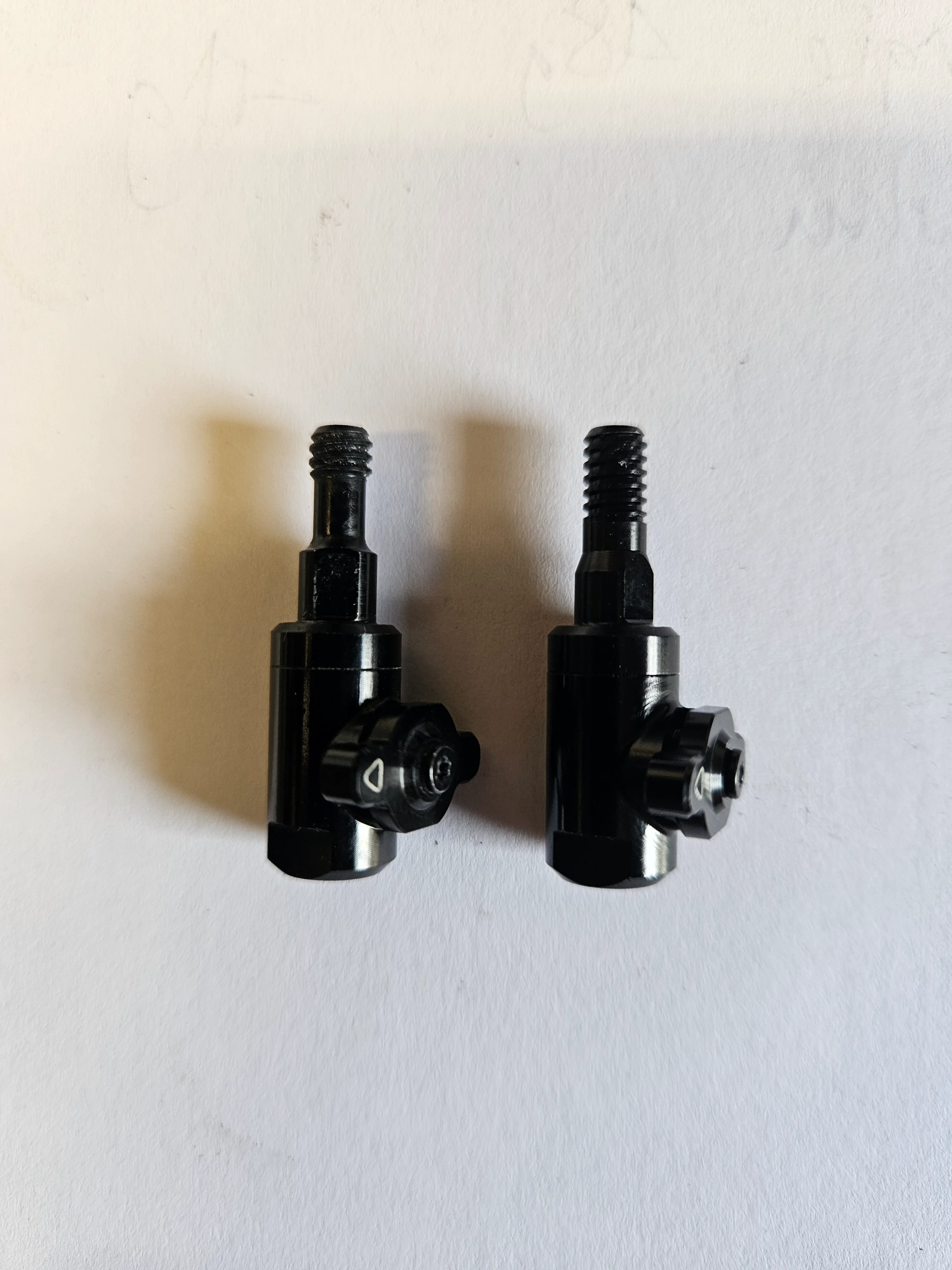

When I had a really good look could see that the new Muc-Off Big Bore Lite valves have been revised - look at the photo (old valve on left, new valve on right).

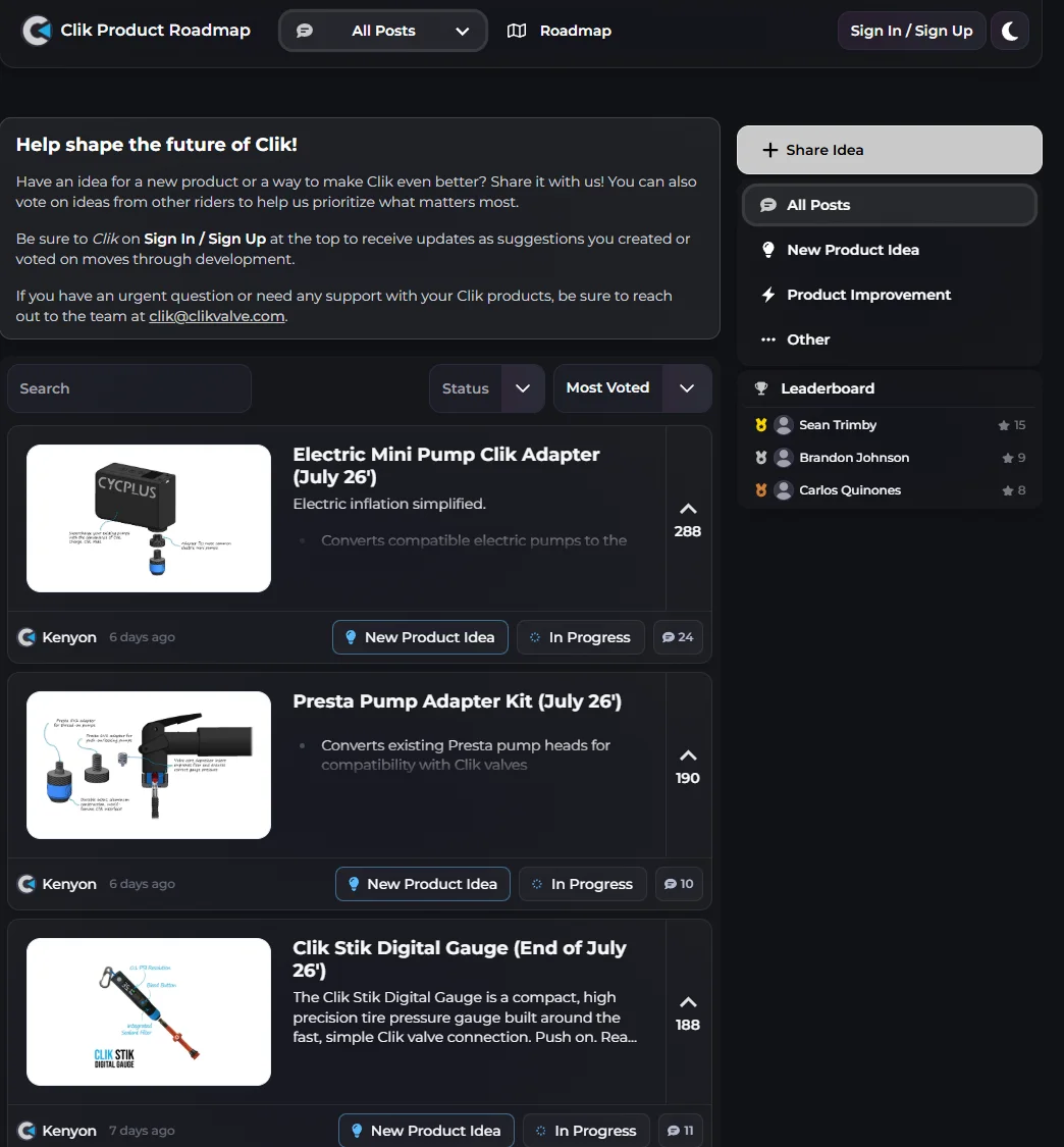

This might be interesting to some, Clik Valve released their roadmap, check it out here.

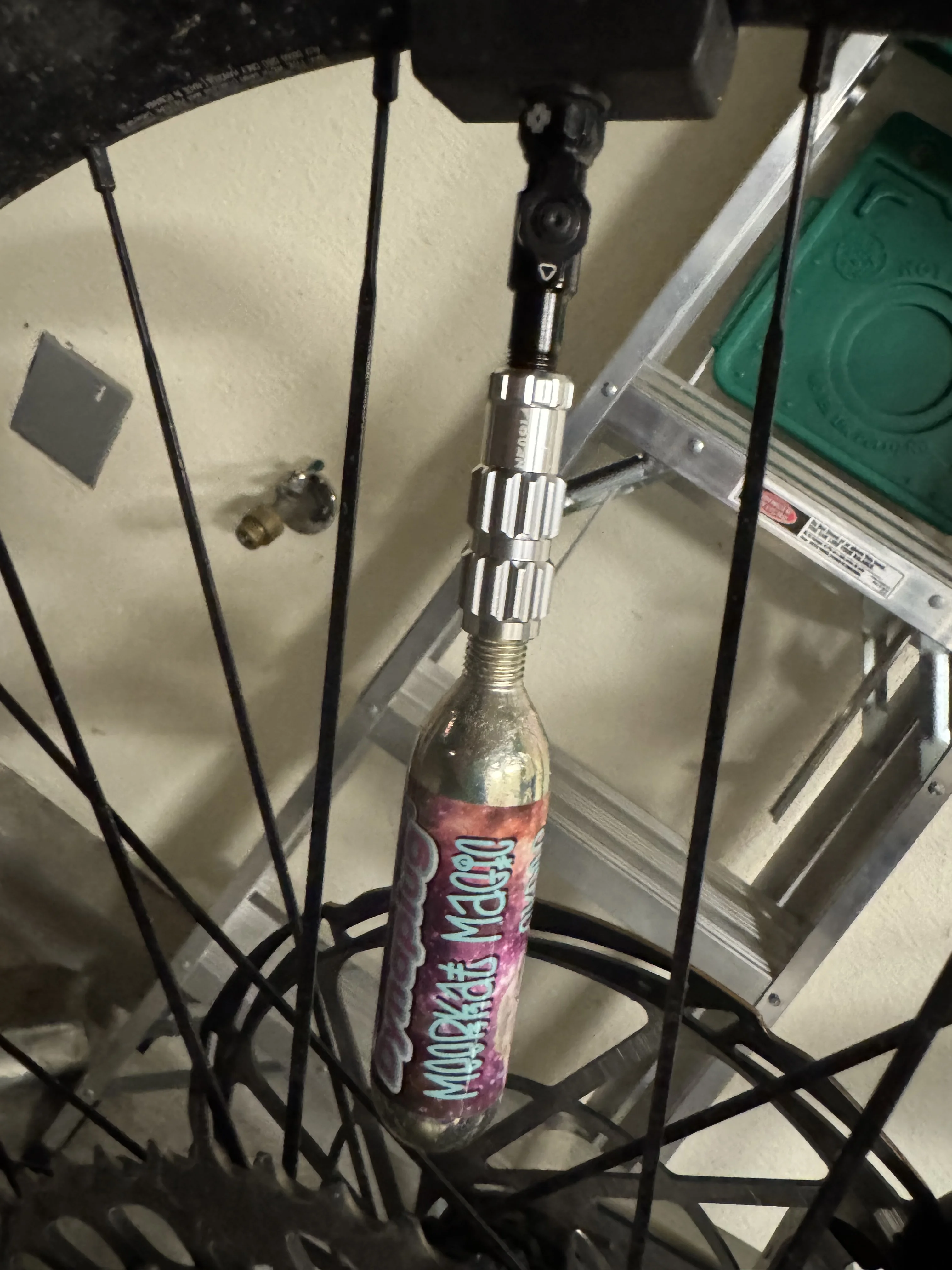

Basically you thread the inflater on the valve, then thread the cartridge into the inflator. Then open the Muc Off valve to let the CO2 in. Close the valve and then unthread the inflator. Works like a charm.
