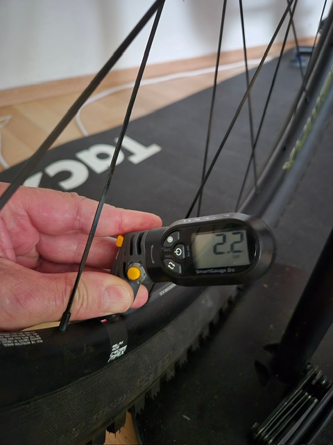

Do you think that the adaptor would work on something, like Topeak Smart Gauge D2? I just cannot rely on a floor pump for precise pressure, this would be very very bad for me. I need such tool to pump and decrease towards specific psi.
Agree, seems very strange that there are no compatible pressure guages available in Europe. Really surprised that Schwalbe who offer these valves and appear to be promoting them do not also offer a Klick Valve guage.:(
Not sure about that specific pump, but check the following video starting around 4:00
Yeah it is not gonna fit at all, the topeak or some other I have, there would be no way to screw an adaptor.

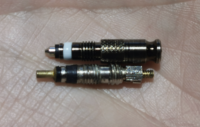

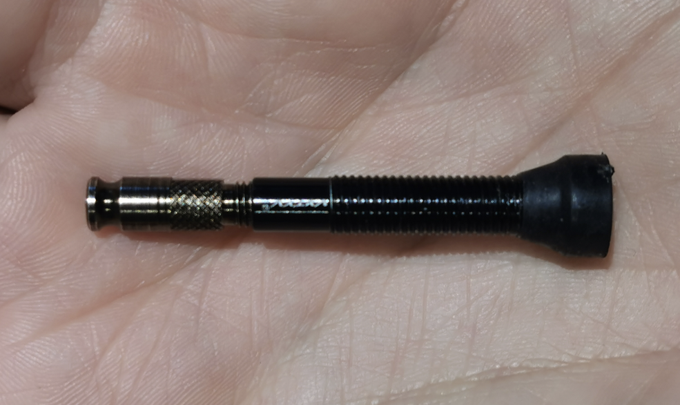

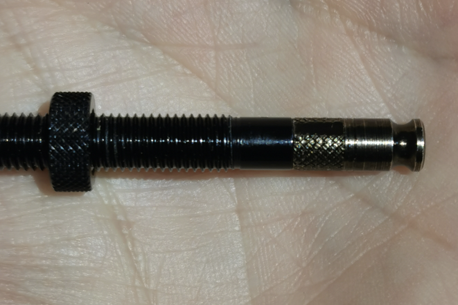

Did anyone have issues retrofitting Clik valves into existing presta tubeless valves? I have these VYTYV tubeless valves, I like them because they are extra short, but sadly I cannot get Clik valve cores threaded deep enough to make a proper seal ... They go in for ~2 revolutions and won't go any further, it's the same filling as if thread between the two would not have the same pitch ... Meanwhile presta valve core threads in without problems, also if I try to put this Clik valve core into another Roval tubeless valve it's going in all the way without a problem ...
No, that's strange. It does seem that there is no written standard for Presta valve seats which is a pain.
I have had issues in the past where when removing the presta core the little white sealing ring has been left behind preventing the next one going in OK. Maybe see if this has happened.
No, this is not the issue with mine, because the seal is still fine on the removed presta valve core ... and I tried to put a Clik valve in both VYTYV valves and there is same issue with both of them, thread just gets stuck after ~2 revolutions, this is way before the seal part of the Clik valve can get any near of seal seating within the presta valve ...
Must just be a slightly shallow thread then? If you look at Presta cores the thread often looks pretty thin and rounded, maybe the Clik valve thread is just a touch sharper and taller.
If you can track down a tap of the right size then you could try chasing the threads out. The correct size is 3/16" 40tpi
The thread is deep enough, presta valve core goes all the way in ... I did a measurements over the threads of each valve core with a digital caliper, presta shows ~4,53mm while Clik valve shows ~4,60mm, it's a small difference but I guess enough to cause problems, and I think I can see that Clik threads are sharper, more defined compared to presta ... Here I took some photos how does it look:
Clik & Presta valve core side by side:
How deep Click goes into VYTYV valve stem:
It goes all the way into the Roval valve stem:
To my surprise, the Topeak gauge seems to work without the adapter. The little bit in the middle of the Topeak, for depressing Schrader valves, also works for Clik!
This is what I meant by the thread is "deeper" larger major diameter. Get the tap and chase them out and I imagine it will work fine.
I wasn't comfortable using a tap, I may damage seal seating and then it will not work at all ...
I ended using Roval valves which worked fine.
The point of the story is, not every is tubeless presta valve is Clik ready ...
I ended using Rovale valves which work fine.
I think it would be fairer to say that not every Presta valve housing is made to tolerance. The tap being used the day they made yours was probably a bit worn out.
PS I love my Clik valves !
In deed the Topeak Smartgauge D2 seems to work in some cases with Clik Valves

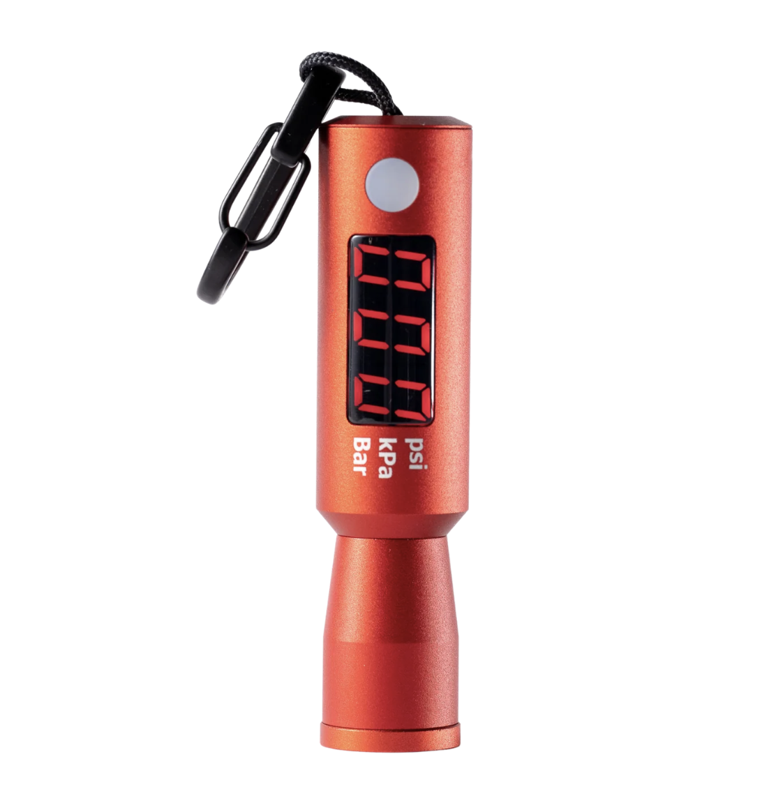

I just got an email from Clik about preorders opening for a new digital gauge. It looks like it must be made by the same manufacturer as the Fumpa digital gauge. I have one of those and have been really happy with how it works on Clik valves (set up for Presta, but with the pin for Schrader valves pointing out).
