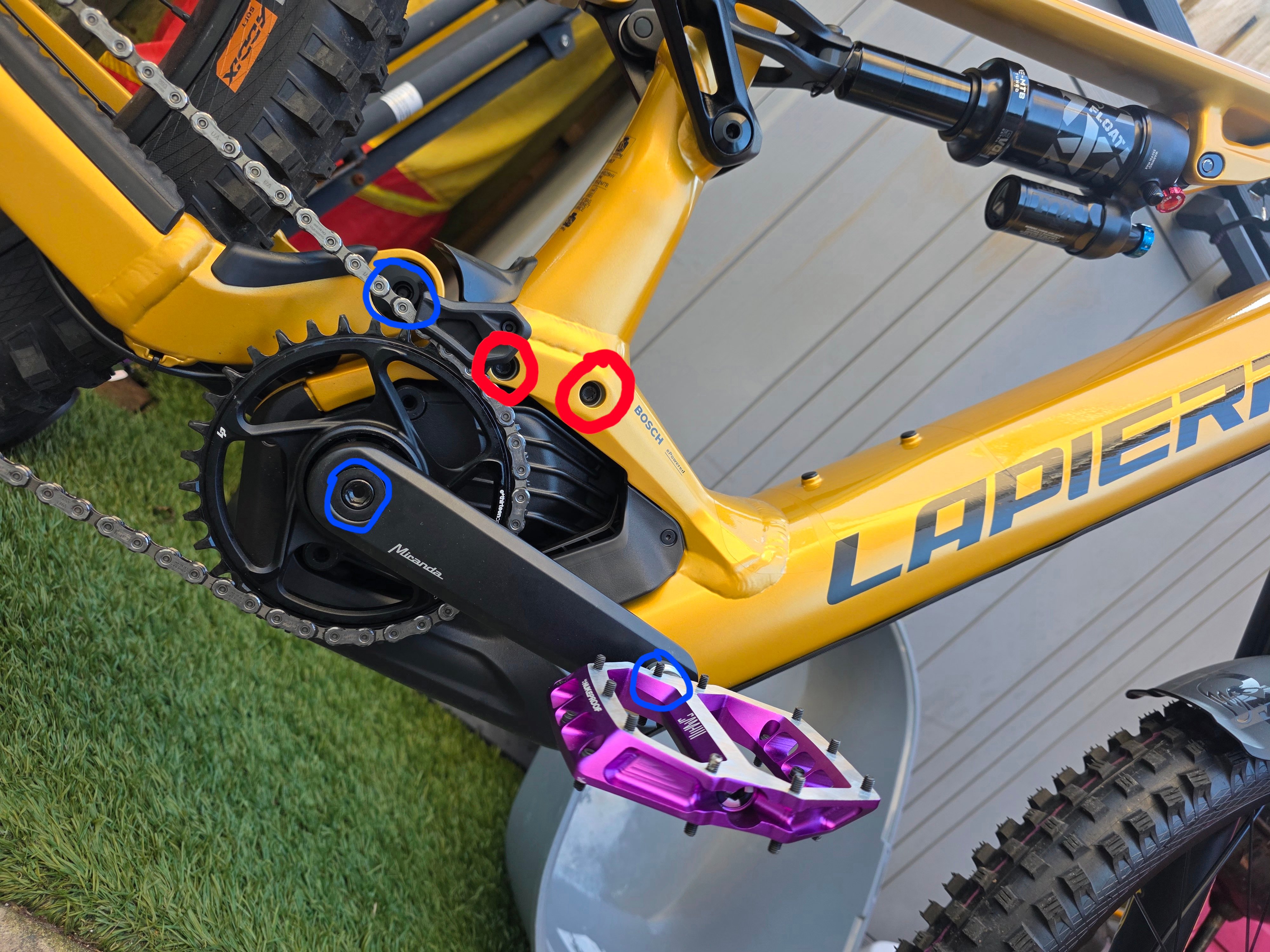

Thank you, I'll also check these then as he didn't do that today at the bike shop - literally just checked 2 bolts each side that was accessible - basically just checked everything circled here -
If that is a gen 4, then there are more motor bolts than those. Check Bearing mans answer above. I also have the creak, been waiting for delivery of torx plus bits to do it properly!
Maybe I’m missing something or I misread. Did you check the 8 bolts that secure the brackets (4) to the motor. You must drop the motor to see these or have access to them. Not the 6 motor mount bolts.
Hey, nah you didn't misread - these are the only bolts my bike shop guy checked. He just quickly went over them whilst I was there. I guess if I asked him to book it in to check then he would have done a more thorough job but he took it for a quick spin and says he didn't hear anything.

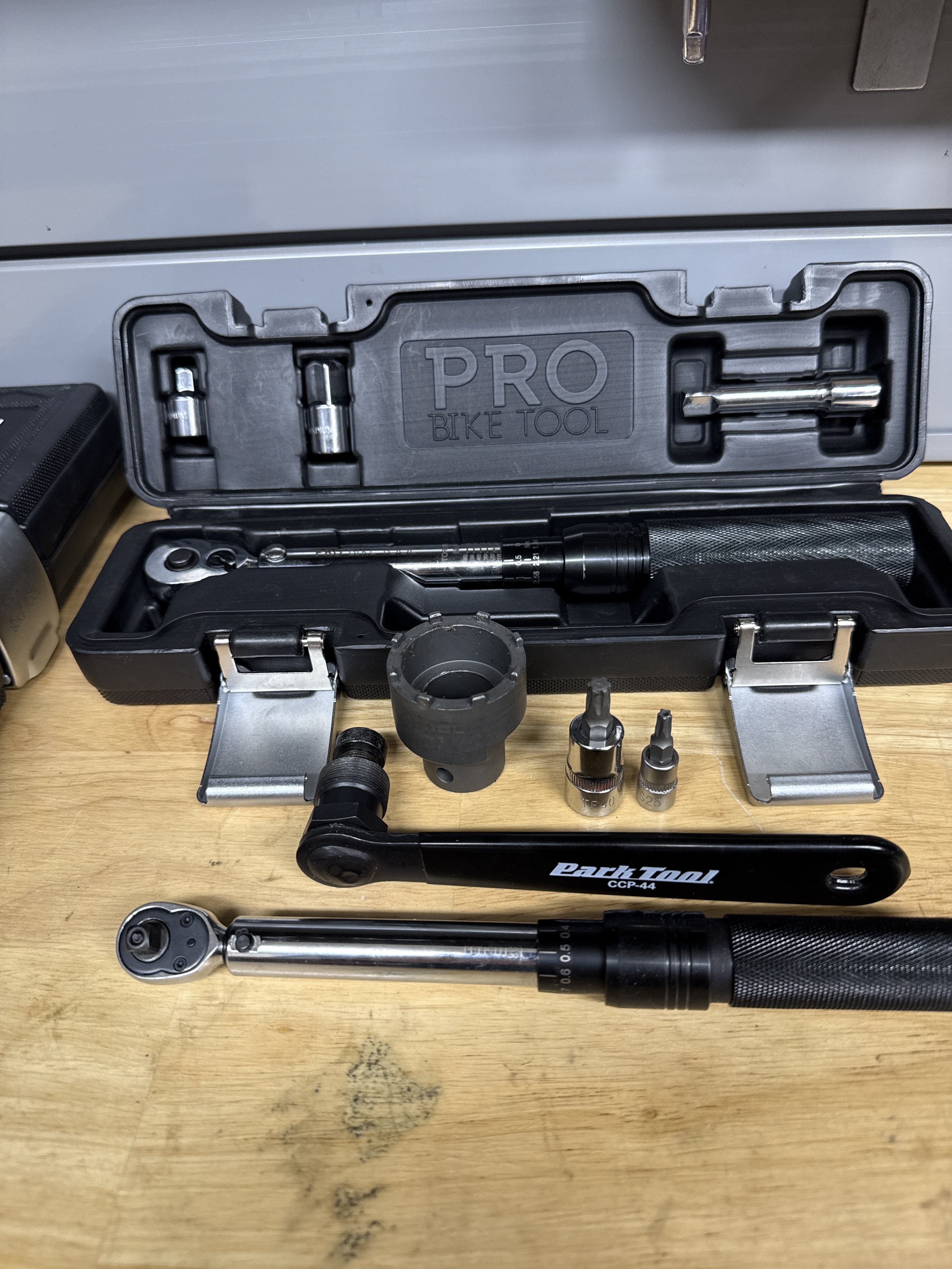

This is not high end tools but it does the job.
Does that probike tool measure torque in CCW direction? I have only the smaller one, in the papers it said CCW accuracy +-6%.
Yes they measure ccw and cw. I’m not sure of the accuracy though.

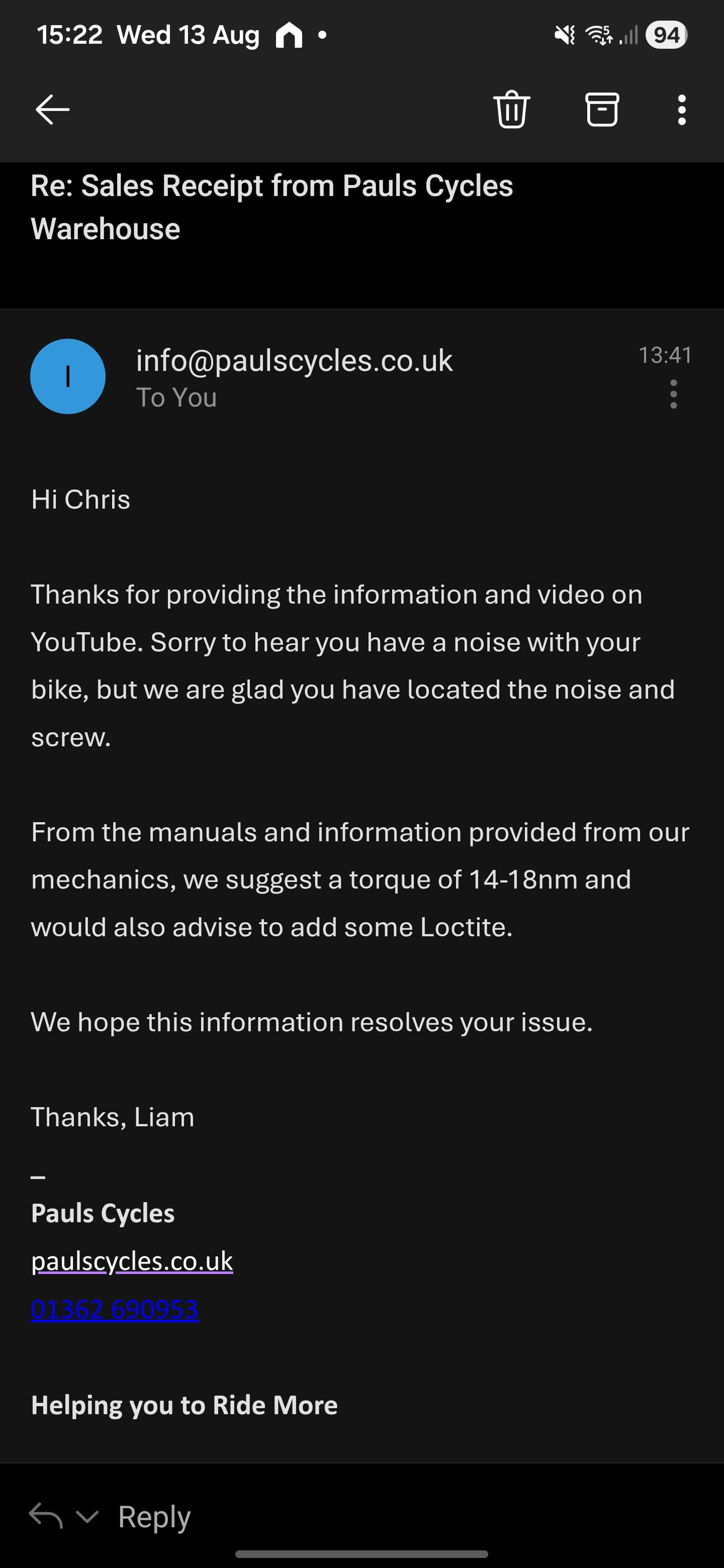

Ive found it!!!!
Its the rear triangle! The bolt was very loose! Ive no idea what the torque should be so just nipped it for now until I hear back from Lapierre
Ive found it!!!!
Cool, result. Pretty sure it should be blue loctite but see what Lapierre say.

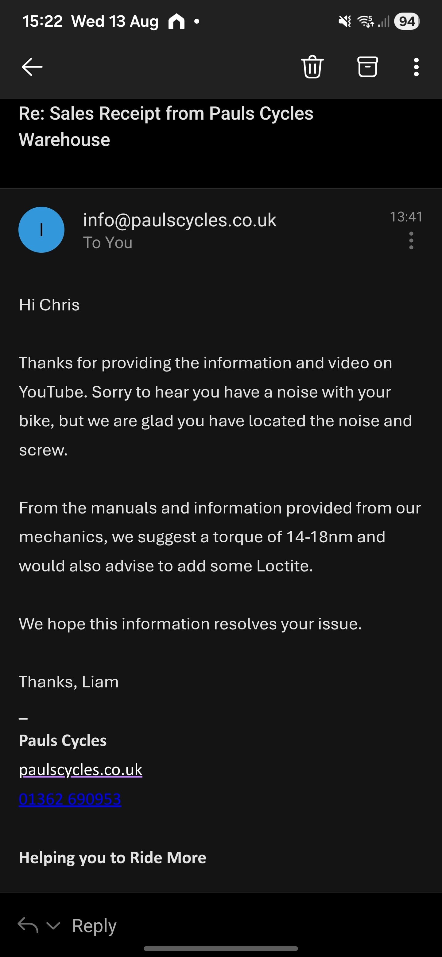

Shop i bought from replied saying their mechanics suggested 14-18nm with loctite as you also suggested (y)
Buzzing I've sorted it! Could have saved money on the new torque wrench, lock ring tool and socket though - £60 unnecessary spend hahaha!
