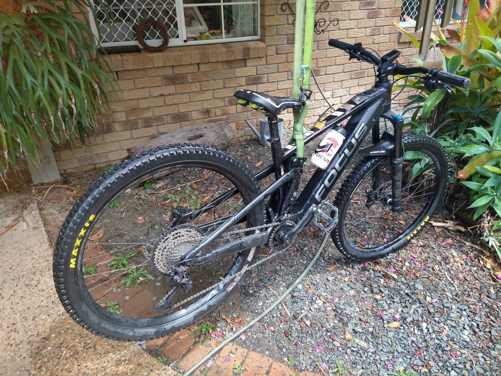

I use my MOABS 1 see photo so it is easy to pedal forwards for chain post ride chain clean. My back is so knackered I can't do the bending over thing.

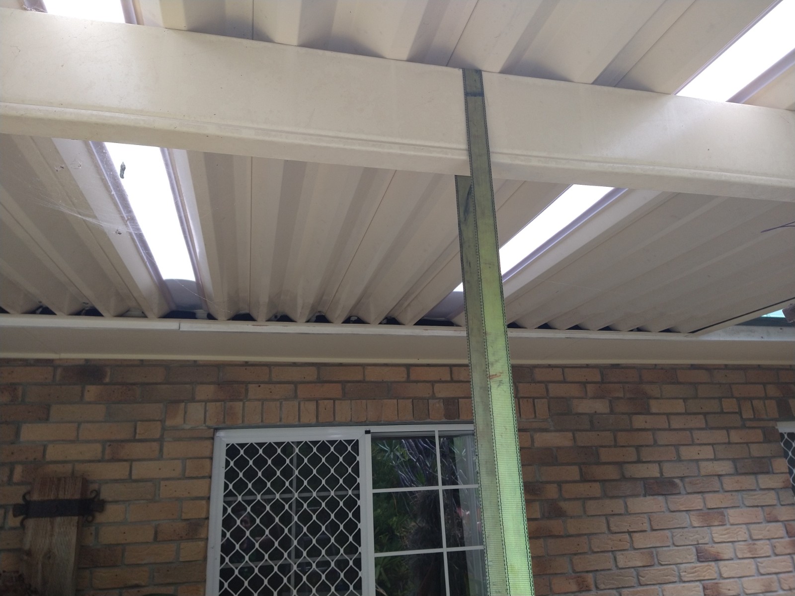

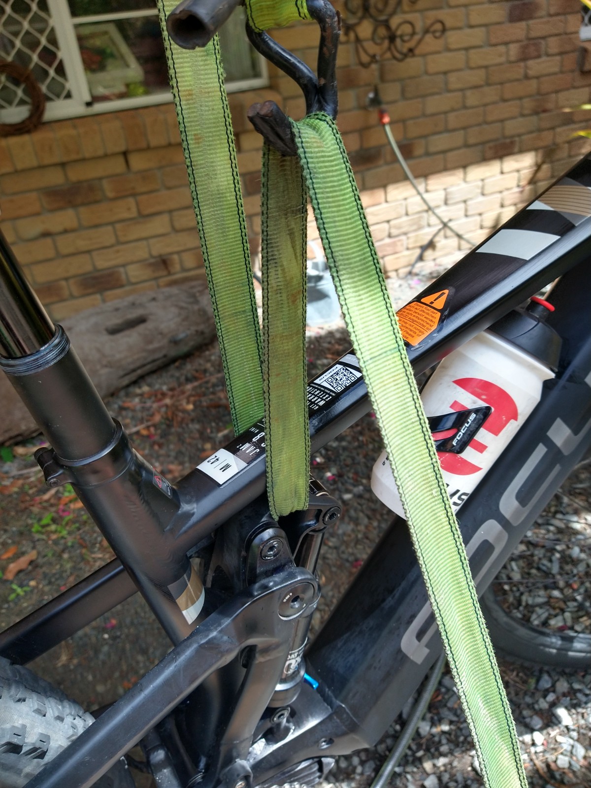

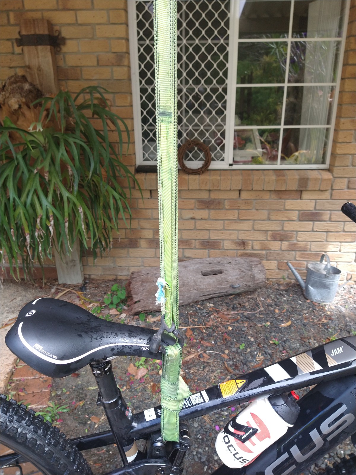

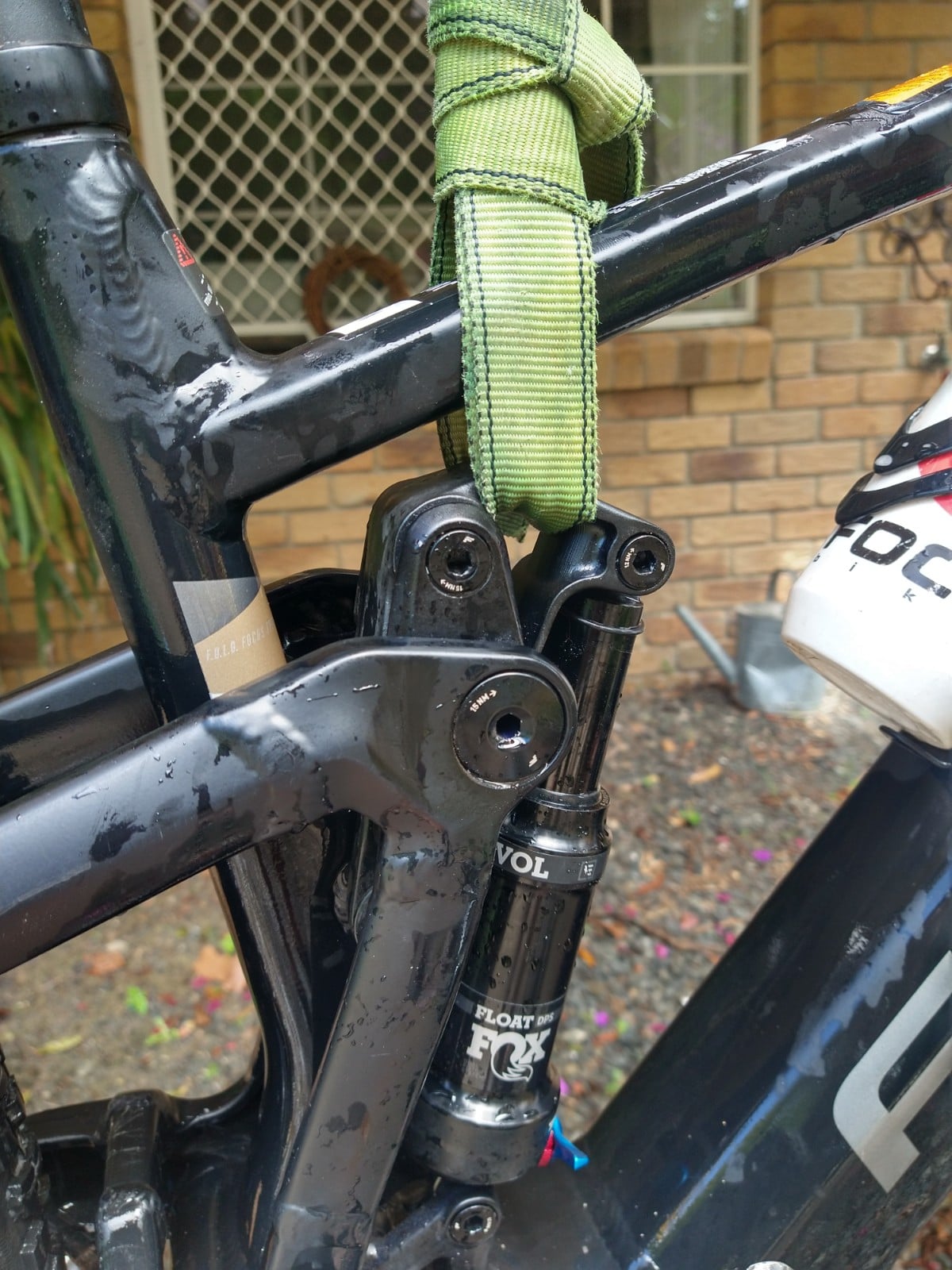

Just cleaned mine.....with a simple contraption......
Hope this helps...
