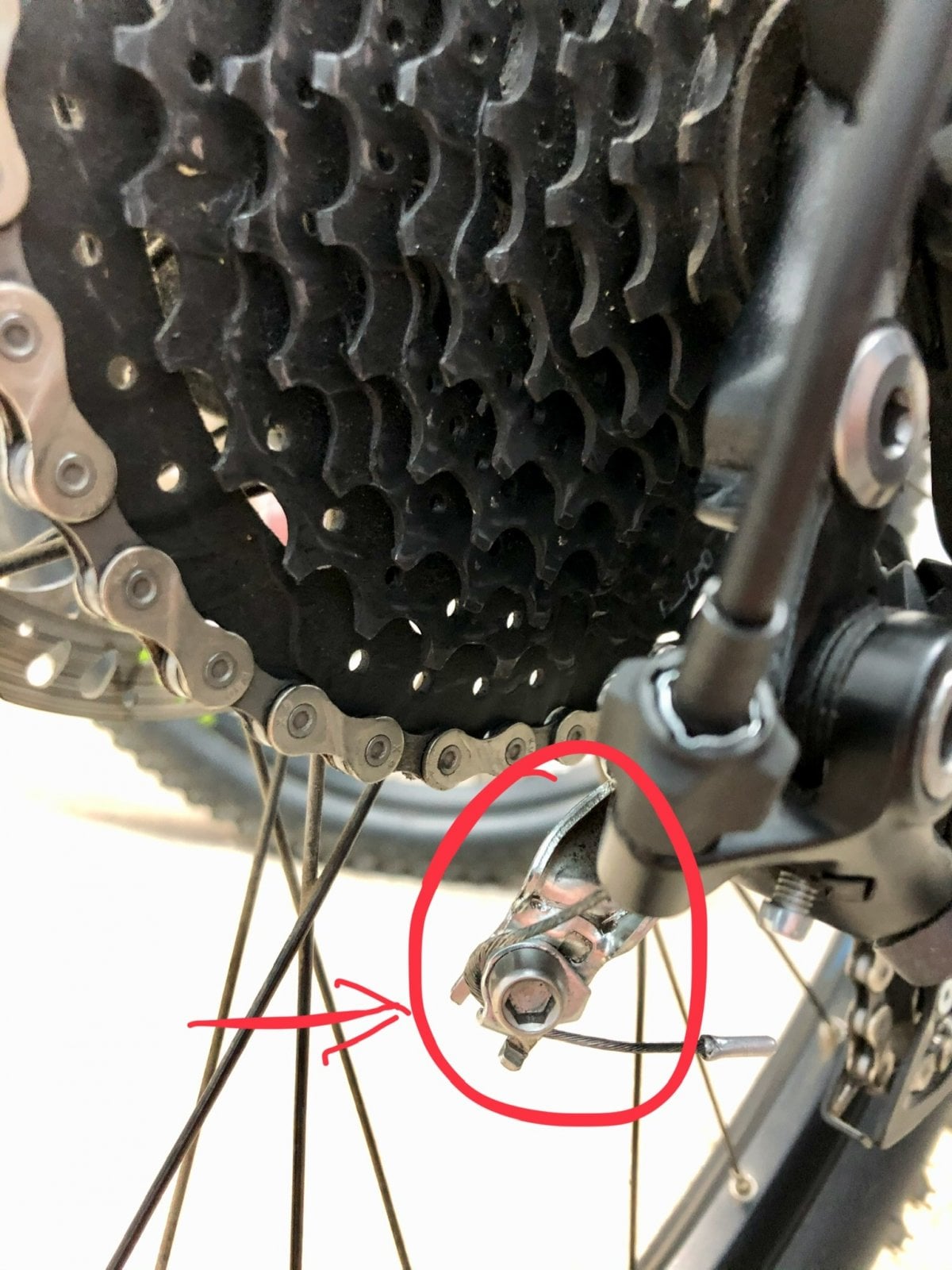

its a Shimano Altus M2000.... 9 speed.
I think ive found the problem. the cable tensioner is bent, i bent it back but slowly loosing its position again... thats not helping.

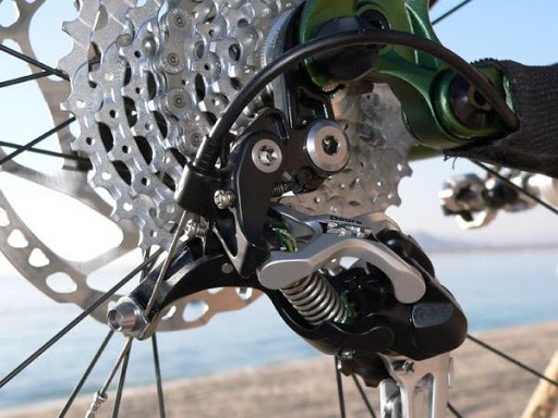

Not the same mech, but this shows what I mean. ? Hopefully its as simple a fix as it looks from that pic. It’ll be snagging the cableas you release tension, that’ll be why its not liking the lower gears.

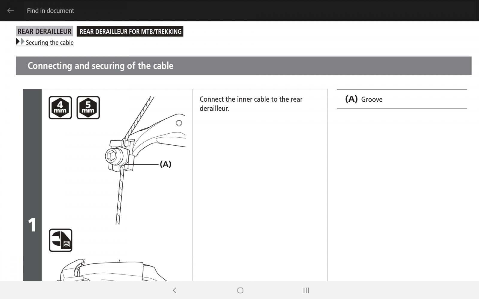

Cables routed round the wrong side mate, it should be on the right of that bolt being clamped by that protruding part of the washer I think. That solves the alignment of it as well.
Yes, does look to be routed wrongly, if that wasn't noticed when you took it to your local bike shop, chances are it was they who did it.
