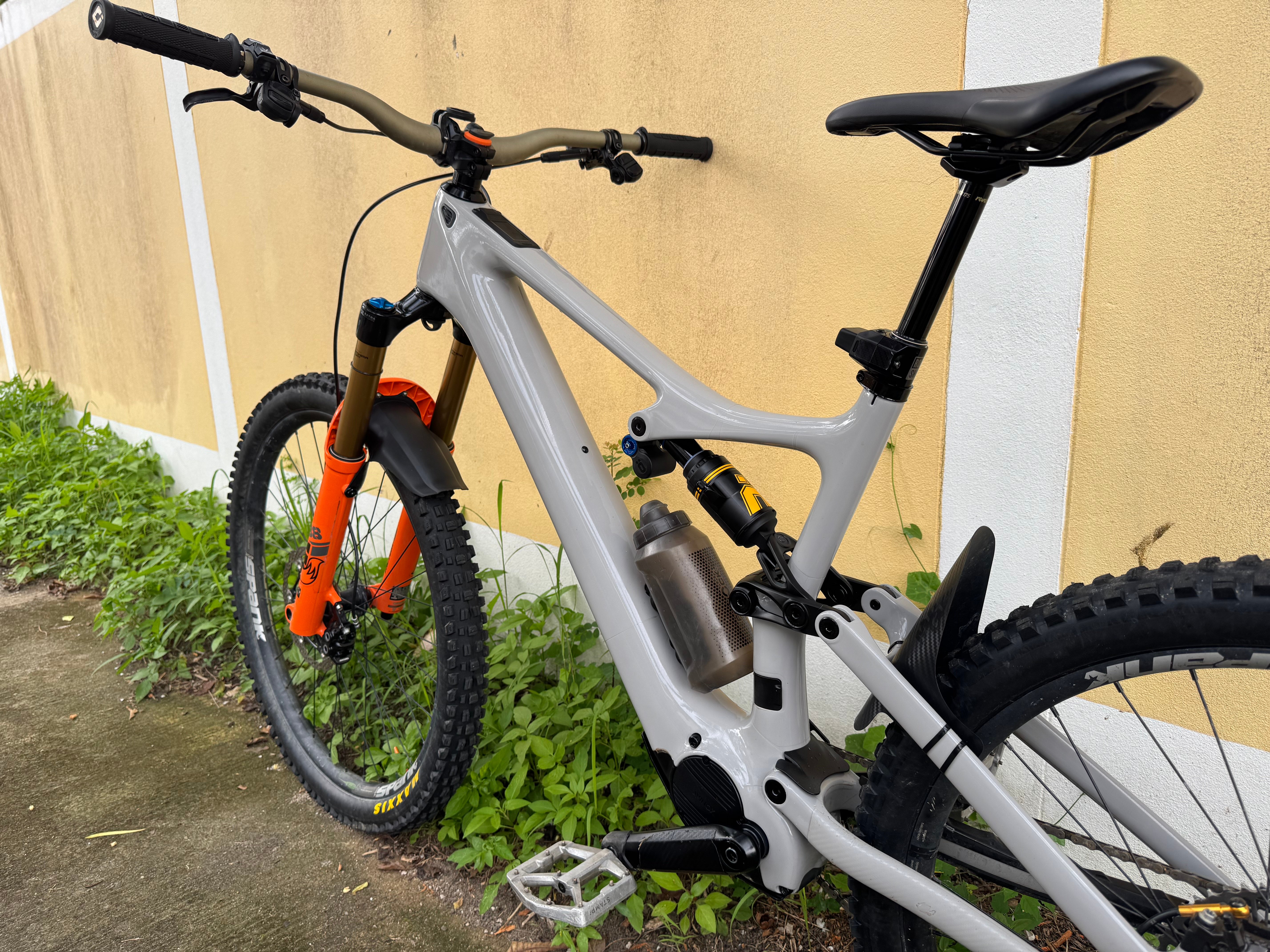

I opted for a 2022 grip2 fox 38, since i am not convinced that the x/x2 is for me.
My bike is near it's final form although i don't know about the rear shock yet. Something is not perfect for sure, but I am a bit unsure how to fix it. The very high pressure makes rebound damping tricky. I wish they had made the stroke longer than 55mm.

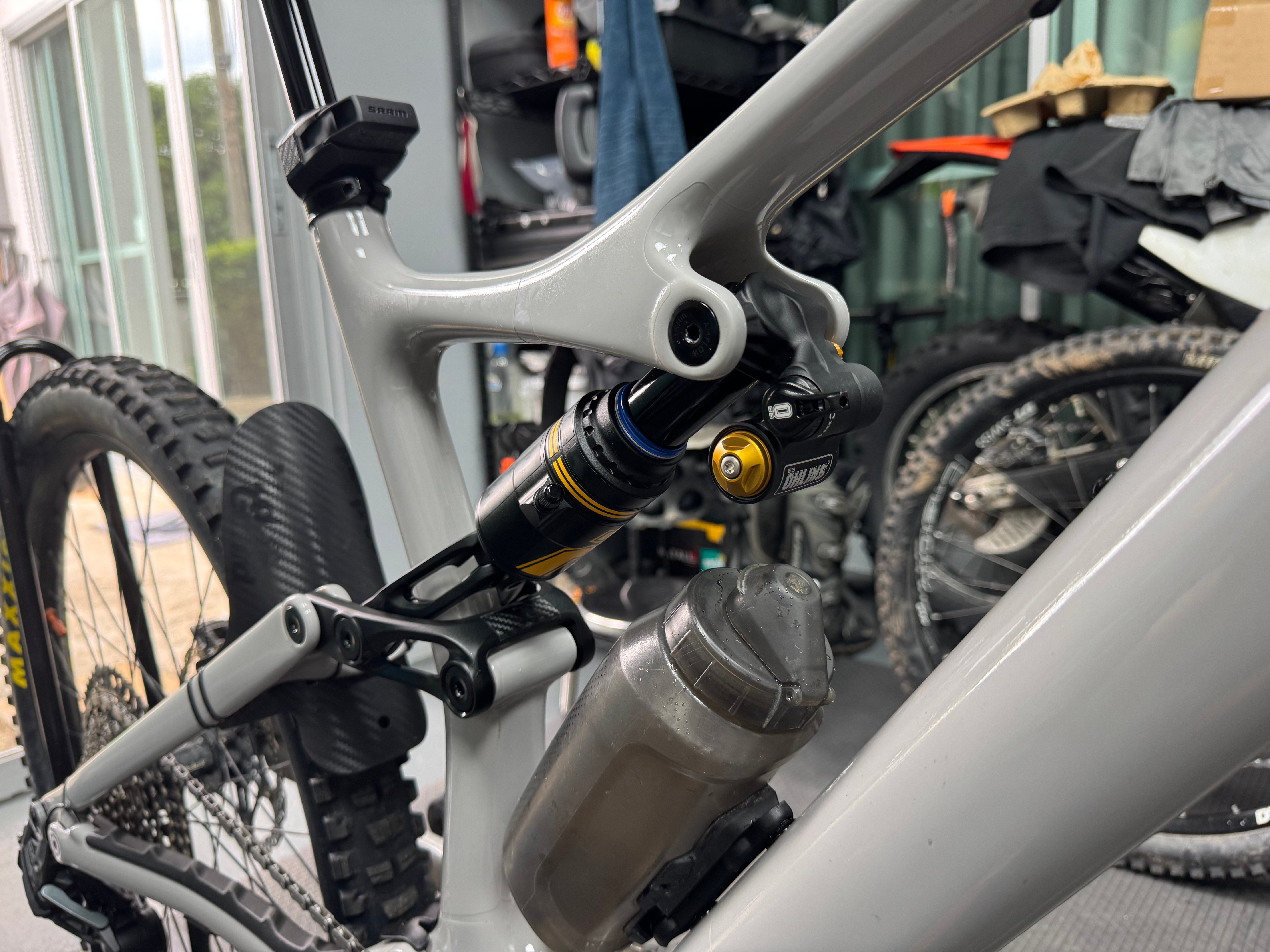

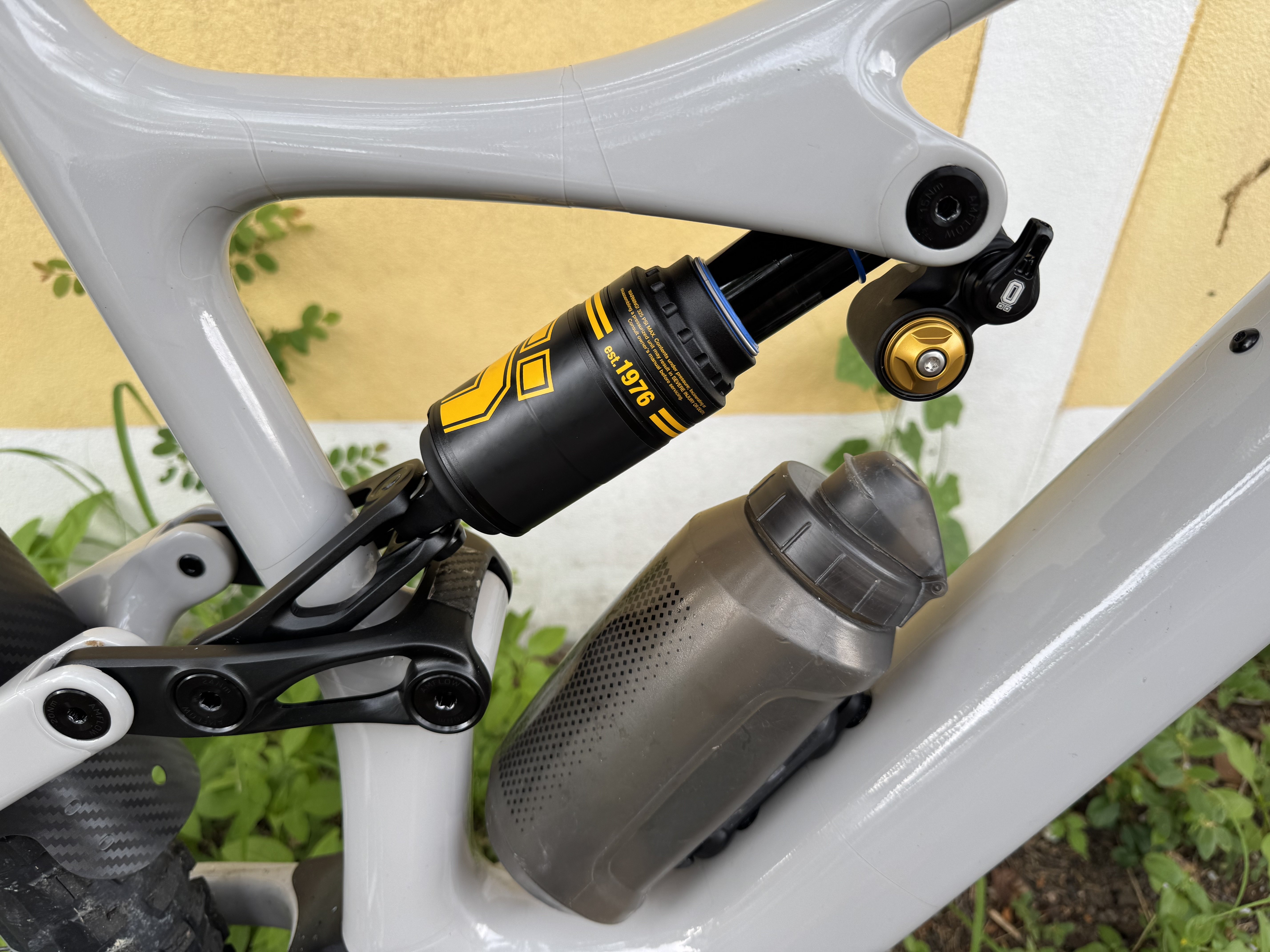

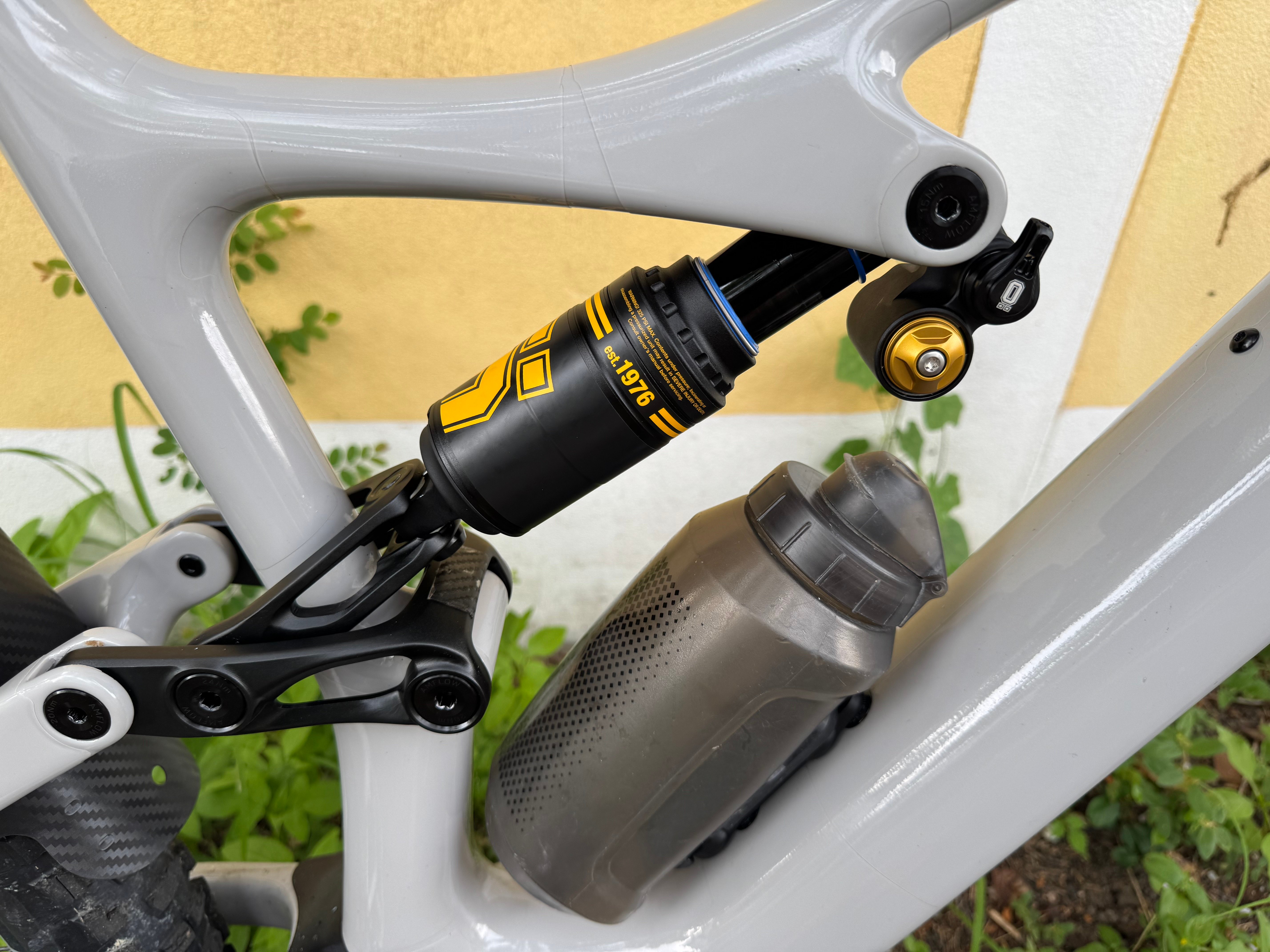

I finally got it and installed it. Set my sag roughly (I’ll do it more accurately when I’ve got all my riding gear on tomorrow) but just around my street it feels really nice right out of the box.
I found the original Float shock quite linear and clicky (although it wasn’t on the same level as my Fox 38 Gripx2 up front) and I could feel that imbalance.
The Ohlins feels much smoother and balanced with my fork - quite similar to how I have a Fox Float X Factory setup on another bike, which I really like.
Full test and setup tomorrow and for bonus points there is a tonne of clearance for my 750ml Fidlock twist!

View attachment 167120 View attachment 167121
I have been looking at that shock myself. I hope to get some ride impressions :) how much pressure do you need?
Manual said to start at 175psi but I’m 92kg so I knew that wasn’t going to work. I put 250 in which is about 25% without my hip pack, riding shoes and helmet, so I’ll see how it looks when I’ve got those on.
I’m going to start at 30% sag and do some clicker bracketing tomorrow and take a shock pump with me

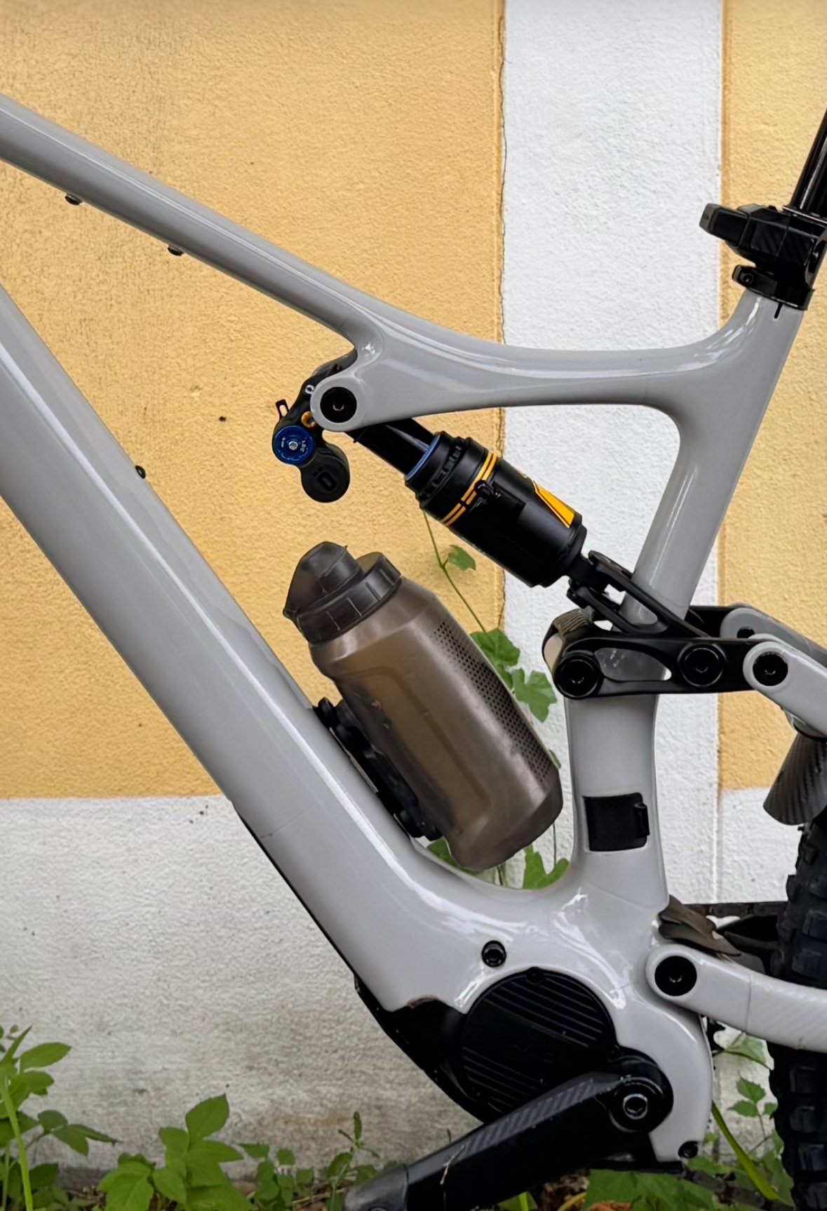

First ride, 245psi for 30% sag with the HSC position 1 (soft/open), LSC and REB both as they came from the factory, bang in the middle.
A little surprised how well it climbs wide open as it bobs quite a bit peddling on the flat. But the traction was great and no bouncing me off roots and rocks like the Fox Float.
DH it’s a different world. Much more tractable, just ate everything on my local enduro loop, and the rear end felt more nimble and turned sharper. Sag ring is about 10-12mm off bottom out.
I just hit my joint Strava PB on this bike on a 3 minute downhill, which is pretty impressive as it’s been raining solid for 2 days and I felt like I was taking it relatively easy. In the dry I’d say I’ve got at least another 10-15 seconds in me just changing to this shock.

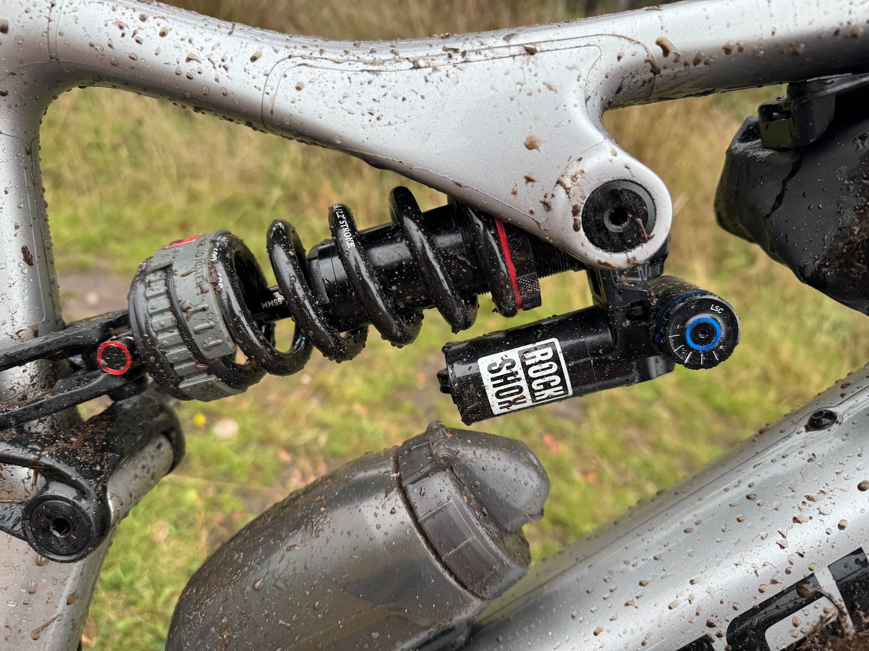

A used vivid ultimate came up on ebay so thought I'd give that a go. Later read that the rockshox springs may hit the frame on full compression so I've bought a sprindex so it wasn't quite the bargin I hoped for - £350 for both.
Not had that much riding on it but the initial plushness is night and day and highlights the base pl for my weight (90kg) doesn't perform all that great at small bump stuff, my vitus e mythique with a basic rockshox shock is much better(maybe weight helps here?) but the coil rectifies that.
Where on the frame would it hit on compression?

2026 Fox DHX2 is fully compatible and the smaller piggy would give better clearance for a bigger bottle if needed.
