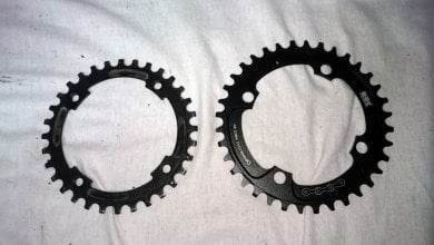

Old and the new

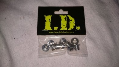

The original chainring had threaded inserts, replacement ones do not hence new chainring bolts

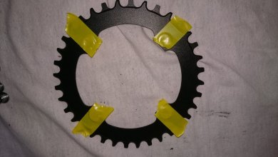

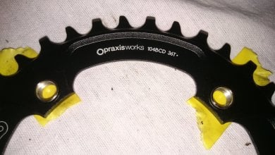

You'll need to use some tape to hold the nuts into the chainring to make it easier locating the bolts once fitted.

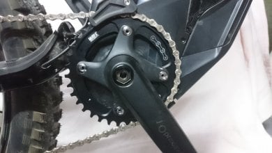

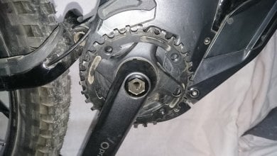

New chainring now in place and ready for the bolts

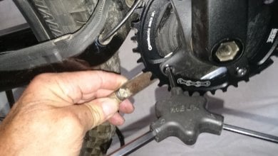

Here's the scraper holding the back of the nut whilst tightening the bolt, with threadlock applied to the threads of the bolt first. Nip up as tight as you can further tightening will be done later once the chain is on and you can then get more leverage.

On the Praxis Wave Tech rings the chain has to go on a specific way

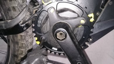

Finally nip up the bolts and don't forget to position the chain guide and retighten!
Here's how the 36T ring looks with the original chain.

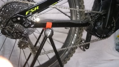

Put your bike in it's 2nd biggist cog at the rear and let out all of the air from your shock. Now flip the bike upside down and collapse the suspension (simulating a big hit) and whilst pedaling shift to the largest cog. This will replicate the maximum chain growth that your bike will experience. If your happy with what you see and there is no danger to your mech, chain or mech hanger put the air back in the can and you're good to go. If not then you will need to replace or lengthen the chain by any of the methods above.
Riders with coil spring suspension could unbolt one end of the shock.
